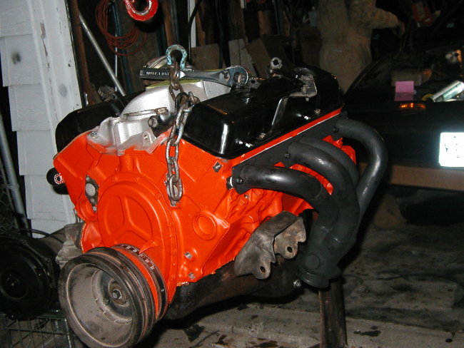

i dont remmeber the part number,, just look it up in jegs or summit. i have emmisions to here. Depending on the checks they do there (no under the hood visual) you can get away with these. they dont come with the ugly air tubes, so youll have to get a pretty good cat, and make sure you get it really hot before you take your test. And they didnt come with a o2 sensor, but you can buy a o2 bung and get it welded in. i got a bung for 2 bucks, and had a friend weld it in. since i got rid of the air tubes, then you can ditch the whole air system all togeather, kinda helps clean your engine bay up. well good luck with whatever you choose.
Old Mar 26, 2002 | 10:25 PM
fattie92's Avatar
Posts: 1,519
From: Addison. Il
here is a pic

Ok so what if I go with the Hedman Headers, HED-68470 $105, the Hedman Y-Pipe, HED-17470 $100, the catco convertor and the hooker cat-back, 520-16822 $200. Will all fit togetherin a nice neat package and be a 3" system? Thanks for putting up with me guys. By the way Gunny I put the part numbers in there for you...
Old Mar 26, 2002 | 10:48 PM
fattie92's Avatar
Posts: 1,519
From: Addison. Il
no its not gonna be a "true" 3 inch system. ok the headers are 1 5/8, down to a 3 inch collecter. then the y pipe is 2.5, but 3 at each end. this will be a nice torque build up for your low end. then run 3 inch from your cat back.
