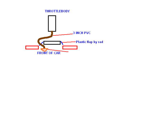

I know this has been covered before. But please bare with me.
This is a cold air intake a friend of mine and I are looking at making. the stock air box will be removed. The PVC pipe will go between the rad and the front of the car. The rad will be moved back a little to alow for room.
Its just in theory right now.
My concern is too many bends.
Thoughts?

Ok, I guess it passes with all y'all.
The plan shal be set in motion.

And if youre talking to me, the two red rectangles are ment to be the front of the car on either side of the rad.
