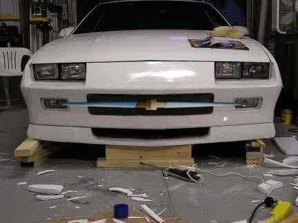

Started my custom ground effects today, what do you think?
I obviously have a base model camaro without ground effects. I thought about just putting on a set from another camaro but we've all seen that. It looks good, but it's stock. I would like to know what everyone thinks of them so far. They are not done, this is just to get a rough idea on what I want. Voice your opinions good or bad, but please be tactful. Should I incorporate vents, lights, make it taller or shorter, etc. Let me know what you think. Thanks a lot
Oh yeah, what about the lenses I made?

hey man great work! i like the idea my only suggestion would be to make it angle forward more. much like the stock gfx just because i think it works well. try to match the angle that the nose piece goes out and mimic that on the piece you made. if they turn out good are you going to sell them to anyone who wants to or is this just for you?

What material are you using? Looks good so far.

I originally had them angled out similar to stock but it just looked wierd. It was similar to stock but not similar enough if that makes sense. I agree that stock works very well, but I'm trying something different.
Are they for sale? Everything is for sale for the right price right? Um, I'm not sure I would want to make another one unless I had the car here because of fitment issues. My nose might be out of alignment or your fender or something like that for example. I wouldn't want to sell a part unless I could assure the fitment.
The material is house insulation (the 4x8 sheets of styrofoam) for now just to get the shape until I start glassing it.
Please tell me it doesn't look like an import...please

Instead of dropping it straight down, maybe try matching the rake of the nose. I think it would look more natural that way.

It looks really nice leave it like that! It does not look nothing like a import , so your ok. Good work man.

In the picture it looks like it is going pretty much straight down but it actually angles in at the bottom a little. I think I might angle it in more to flow better but I'm not sure, that's why I'm here.
Of course I am biased, but it does look better in person. Here's another shot, still doesn't show the angles very well but it's another view anyway.
Thanks a lot everybody, keep em coming

looks good,dont change anything.be sure to post finished pictures

That last shot looks sweet! Very aggressive for an SC!

Looks pretty good. I like the rib down the middle from a functionality perspective, lots of noses like that tend to flap around in the wind, and cast properly that should prevent that without having to make the bottom lip too heavy.
It would look more cohesive if you narrowed the opening down so it matched the diagonals set out by the original opening, like in the attached picture.
If it was me, I’d also flair the bottom of the sides out a little so the nose doesn’t look as tall (aerodynamically this should keep more of the air from going under the car/hitting the front of the wheels). Again, like in the attached picture (I didn’t spend any time on it, so you can tell that I didn’t get the 2 sides the same, but I got the opening pretty good and took out the seams that you can see between the sheets of foam). The way you’ve got it now it reminds me of the ChooChoo customs aero nose that I always thought was a bad execution of a good idea
Lastly, if I was going to go to the effort, I’d probably incorporate a road race style splitter to the bottom edge (I didn’t try to add this to your pic, since that would have required me spending a few minutes on it).

did u start witha 85 up nose. try it with a 91 up nose and i think that would look sick. id buy one off of you
jon

Great work! Your concept and workmanship is excellent. And some very cool alternative ideas as well. I was first thinking, that instead of a center support for the lower lip, you could use two, breaking it into thirds to mimic the slots in the nose. But I like the center divider. Also think it looks good with or without the flair. Kind of like it without much flair, looks clean and subtle.
The "import" version kind of reminds me of the '70 Z28, with the gaping shark mouth below the line of the headlights.
Ok, here it is with added vents, and possibly slim line headlights. By the way, your original idea looks great, but it's fun to try and come up with ideas. Also, I tried dropping the plate down lower.
Attached Thumbnails Started my custom ground effects today, what do you think?-airvents.jpg

heh Poncho, I don't think I like the headlight covers, but it does remind me of a ferrari daytona spyder.
The extra cutouts on the side sorta hide the funny angle on the sides as well as somewhat hide the middle cutout being too big. Nice idea, you inspired me… one more…

Good job, Crossfire. You have a good design sense, and good ideas. That looks pretty clean there. Where would you put the licence plate though? I live in CA, so you have to have one on the front of your car. Looks much cleaner without the plate, and I think some states don't require it. Maybe Missouri doesn't need one. Can't decide if I like bowtie, or no bowtie. A bit meaner without it, but it does add something--Chevy Power! Also, you could still have the central support member, but at the back of the central opening, and paint it black, have a few for that matter. Wouldn't see it, and the lower lip would be supported more.
What I like about the large opening in the new air dam, is that some air is still allowed in to cool the radiator--blocking the front too much would cancel the Third Gen "bottom breathing effect," I would think. I have a Bird, so I don't know, maybe the Maro takes in enough air from the front. What about GFX for the rest of the car? Diffuser for the back end? Exhaust outlets or ZO6 style brake cooling ducts on the sides? We need to get to work here!

Just like the one he linked to, I think the shaved turn signals make the grill opening look too small.

Yea, I don't like it without the front turn signals either. It looks too plain and gives a real feeling of wasted space… OTOH, I hate the markers used on the side fenders and on the rear quarters on the ‘birds. On my ’83 TA I ended up cutting the frames used on the back markers apart, bonding them to the quarter and molding them out completely. Then I took and installed the markers and block sanded them so they exactly matched the contour of the fenders (and got rid of the DOT markings…), polished them up…. If I thought that I could get away with it I’d get rid of them all together and weld the holes shut. I keep debating if I like the smaller side markers that the euro cars use just in front of the doors, that might be an option if I was getting rid of the stock ones.

eh it was another idea though.. but it does look to plain and the opening looks small.. but to me some of the other pics look a little "busy" to me...

Yep, like the turn signals, although without is interesting. Hey Crossfire, as for what mag you work for, just making conversation.
I don't mind the stock side markers on my Bird, plus they let people know I'm turning. I have a 91 with Weld style mags and cobalt blue paint, wouldn't change a thing on it. Well, I might take off the front plate, if it weren't for annoying rock chips. The old nose cone could use some touching up.
As for the latest photoshop, yeah a little too plain without the turn signals. Other than that, looking good.
