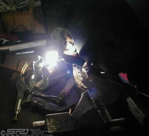

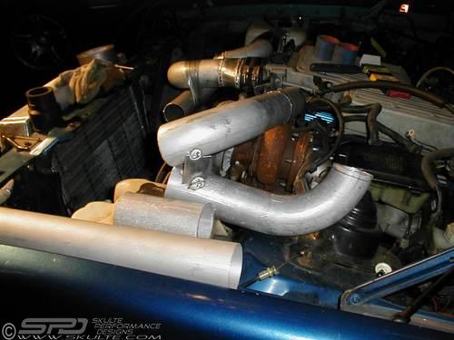

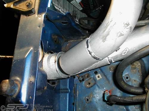

I finally added the IC fabrication pictures from 2001 to the Z28tt gallery at: http://www.skulte.com/gallery/view_a...umName=album02
Some pictures:
Some pictures:
