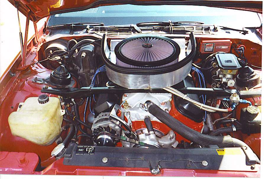

I made this in about an hour back in 1999 and it draws all cold air through the scoop.
Is this about what you were thinking?

hmm, yea that's the idea.... The idea on that website I linked uses just a big air cleaner base, and a small air cleaner top, so it'd have less flow area then yours, but looks a little nicer... however yours wouldn't need to screw up the hood... maybe I'll do that way
Is that just a plate of AL bolted onto the carb, then the air cleaner sits on it? that is nice and simple...

I used a thin piece of sheetmetal from lowes, cut a large hole in the middle, and welded it to an air filter base. I added a 3/4" or 1" lip around it (mcmaster carr sells long strips of it so no tedious cutting required). I also bent it in the back to both clear the distributor and for extra strength. The foam was glued on with 3M weatherstrip adhesive. My neighbor helped me trim the foam once it was bolted on. He used one of those really sharp carpet knives which cut the foam really well.
Mine was made in an hour with an old air conditioning duct, kevlar gloves, some duct tape, tin snips, some closed cell neoprene industrial insulating foam , some 3M weatherstrip adhesive, and a magic marker.
Ugly yes, but cheap and effective.
