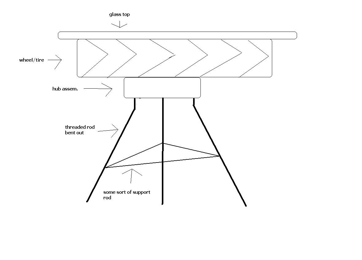

but what yall think would be best for the table legs? I havent found a hub just yet, but most of em Ive seen have three threaded holes to mount to the strut or whatever. Someone said get some looooong threaded rods, thread em im there and bend it out a little. Then weld some rods in between the legs to make sure they dont spread out. U get what Im sayin? Either way Im leaning towards some sort of tripod design, but I am open to all suggestions, even weird ones.
Here's a VERY quick drawing of what Im thinkin so far.

That would be pimp. I made barstools out of some old american wheels.

I was actually thinkin about a shop stool at first, but then you would be sittin on the "eye candy" and wouldnt really see much of it. I figured a table like this youd see it pretty clearly. What did you do for the legs on your stools, anything extravagant or just basically a bar stool with a wheel? Im interested in how you approached it.

I have a table made out of a rim, my buddy made it for me for a wedding present. Ofcourse it's and end table but it's sooo sweet maybe u might change your mind cause rubber tires in the house are kinda gross
use the rim as a base, find a 5" od chrome tube about 3feet tall ( depending on how tall you want your table) Now find yourself a sweet steering wheel and a piece of glass the same size as the steering wheel. Use a piece of ready rod to connect the steering wheel through the 5" chrome tube to the rim and glue the glass to the steering wheel.
Now you have the coolest end table ever.

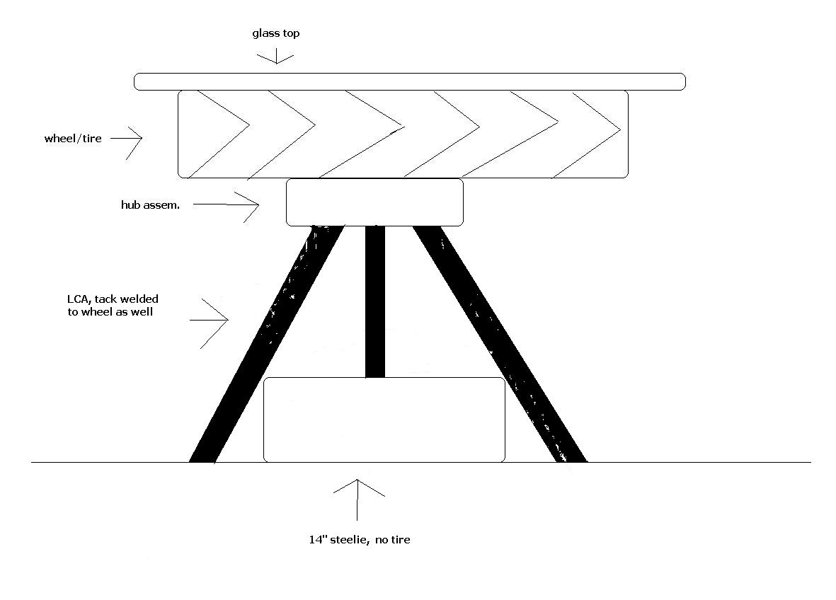

Im still havin trouble findin a vette tire (appx. 275/45 17) thats in decent shape. All the ones we got are bald, no ones come in yet with a nail or anything wanting a new tire. But I did have another brainstorm today . Someone suggested using some LCA from 98-99 Tahoes as the legs. Theres some kinda defect in them that makes em creek real bad, so we get TONS of them that we end up throwing out. I also found a perfect steel wheel, 4 lug, for a cobalt that was sent to us damaged, and GM didnt want it back. The lip on the backside is slightly bent, thats it. I was thinkin about using that wheel at the bottom for the base, then have the LCA come up as a tripod resting on the side of the wheel. Heres another GREAT drawing, still about the same.
I still dont know how I would attach the LCAs to the hub assem.

I don’t like the tire idea either…. Forget the smell, that will eventually go away (or is it that you’ll stop noticing it?), but everything that touches it will get a black mark on it that will get worse as the rubber starts breaking down with ozone and UV light. Tire dressing… well will just make things messier.
If you want to use a steel rim for a base just find a piece of roughly 3” tube and weld it to the wheel’s hub and then weld the top to the hub that you want to use if you want it to turn or to another steel plate that you can mount studs in (unless I had some old studs sitting around I would probably just drill and tap holes and then use some lug/bolts from some of the german cars).
Similar idea but never intended to be in a “nice” place so it’s not really finished nicely (I would have removed the rust off the post and probably cut up the rim to make it look cool and painted the whole base if it was), this is my welding table, steel wheel that I found, I don’t know, somewhere, 3” tube from a rusty old basketball net that my brother’s landlord was throwing out and the top is the center plate out of a tap robot that I disassembled when one of the local big banks was liquidating their machine room:

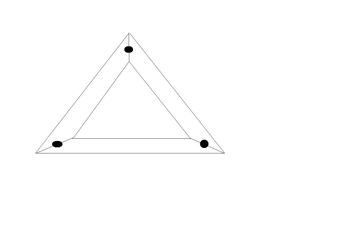

heres a rough sketch on what the base is gonna look like. The three pieces are identical, and make a perfect triangle (my math terminology is a bit rusty), 60 degrees at each corner. The black dots are where the threaded rods are gonna go through, 12" apart from each other. Lay a nice weld around the triangulated pieces and tack weld the rods in place, and walah!
