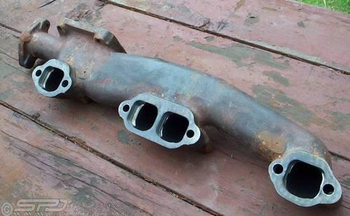

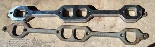

The 1.6 CompCams Pro Magnum rockers just clear the drivers side, and have plenty of room on the passenger side. I went through a few revisions of cardboard working out the min clearance needed for the rockers, and still have some distance from the turbos. So far it looks like they are sealing completely. To top it off, I CNC machined some 3/4" thick spacers to move the exhaust manifolds away from the head (digitized the port profile of the AFR210's. machined the spacers, and then CNC ported my manifolds to match), but that moved the exhaust into the steering shaft and brake lines. Over the winter I'll fab up some larger downpipes with the 4" ovalized (2.5" narrow width) tubing, and really get it flowing well.

I actually CNC machined some 1" thick spacers for the manifolds before I left Mallory Billet Aluminum, and CNC port matched the Gale Banks headers to the AFR210 heads. This had plenty of room for 8 EGT's at each cylinder too, but once I tried them, my downpipes started hitting the steering shaft, brake lines, etc. I'll re-do it all this winter, but that was the springtime, and I was hustling to get ready for NFME at Indy. The wedge flanges would put the bolts at an angle (into the heads), so the manifold bolt holes would need to get slotted, which is pretty much impossible with that casting. I thought of a wedge under each turbo, but there's about 1/8" clearance with the hood right now.
I put the manifold pics and spacers up at: Gale Banks Twin Turbo Manifolds
