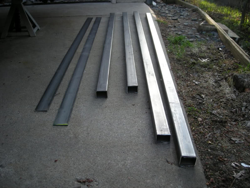

I decided on 14 gauge 2 x 1-1/2" rectangular tubing. and 2 -1/4 plate

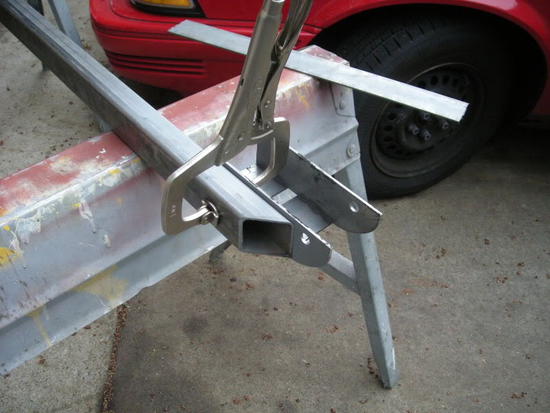

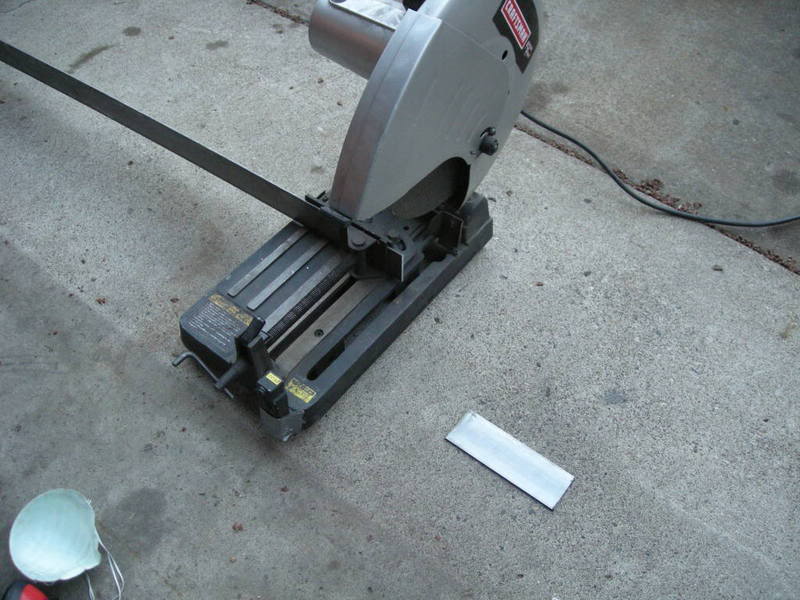

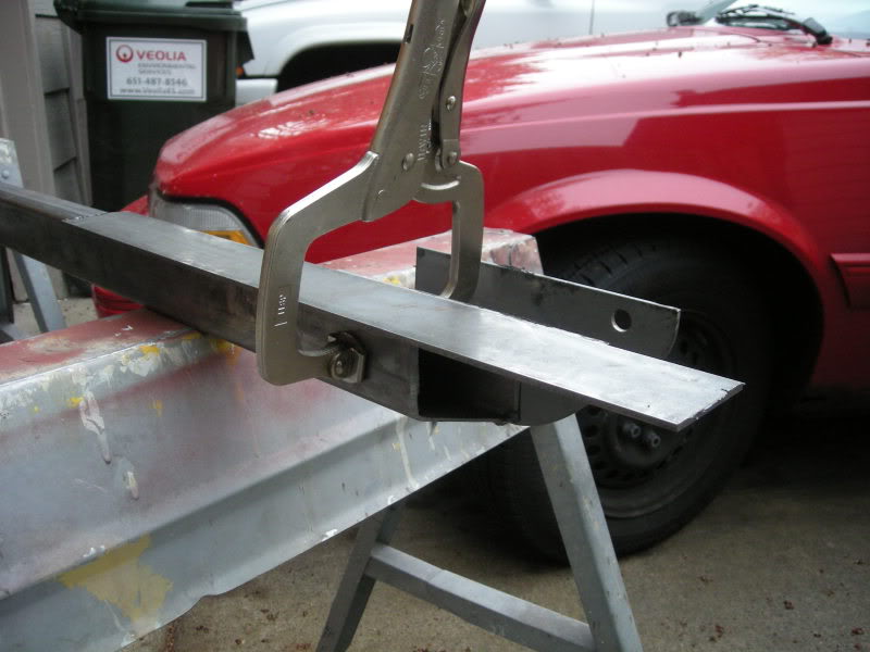

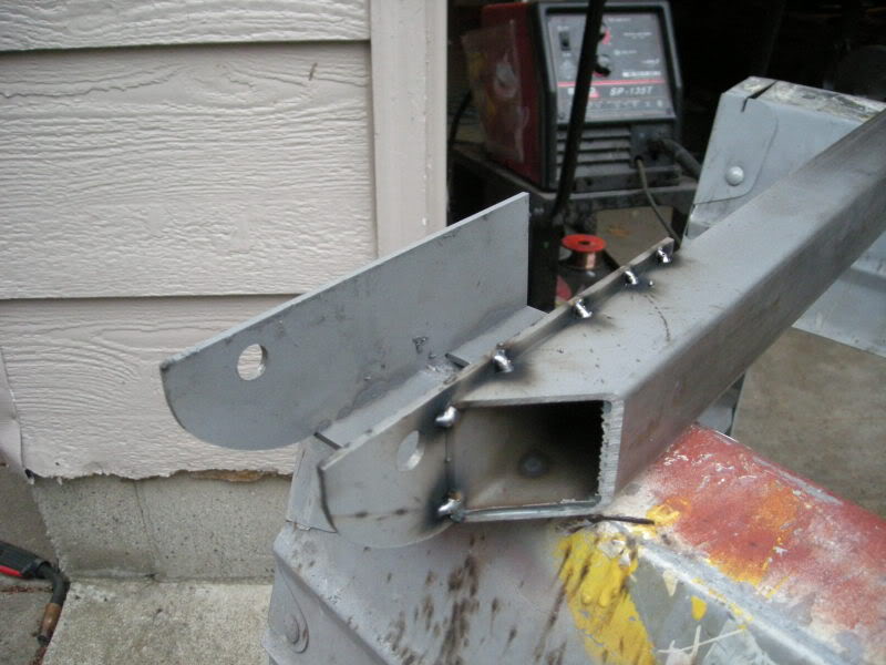

I already had a game plan before i started and that was to start making the LCA mounts frist.

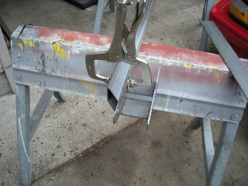

After i cut out four peaces about the same length. i used the LCA mounting point as my guide and took one of the four peaces and marked where i wanted a hole. then i drilled a hole in one of the peaces and clamped all of peaces together and tack welded them together. after that i drilled the rest of the holes so all of them where even then trimmed all the peaces to the same lengths.

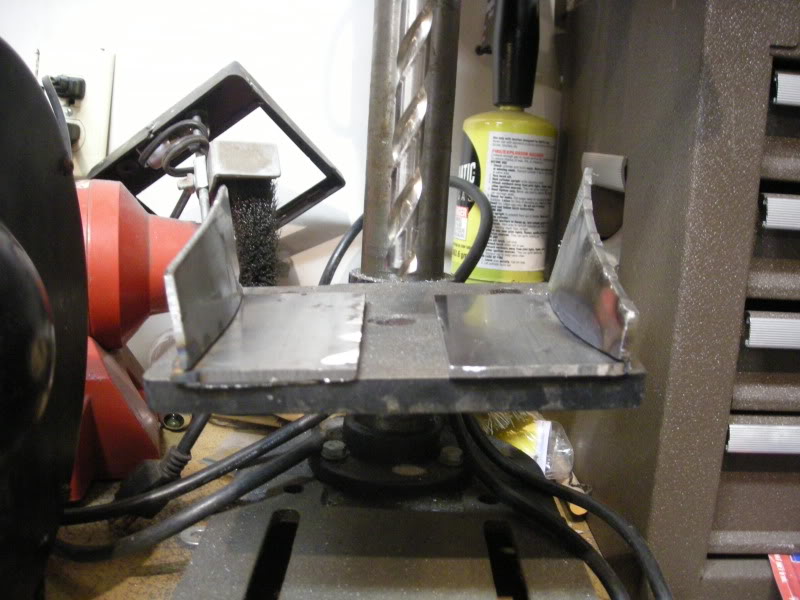

After that i used the LCA mounting point once again to mark some lines to shape the plates to the contours of the where the LCAs mount too

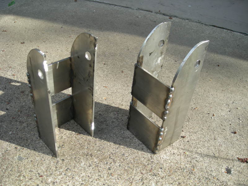

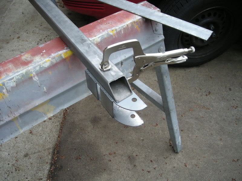

Ground down the tack welds. and clamped them where i wanted them and made some bottom plates.

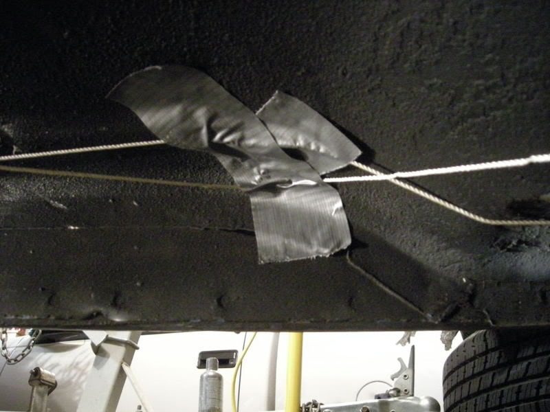

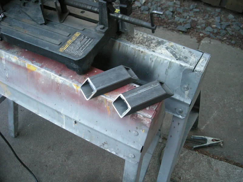

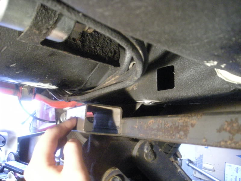

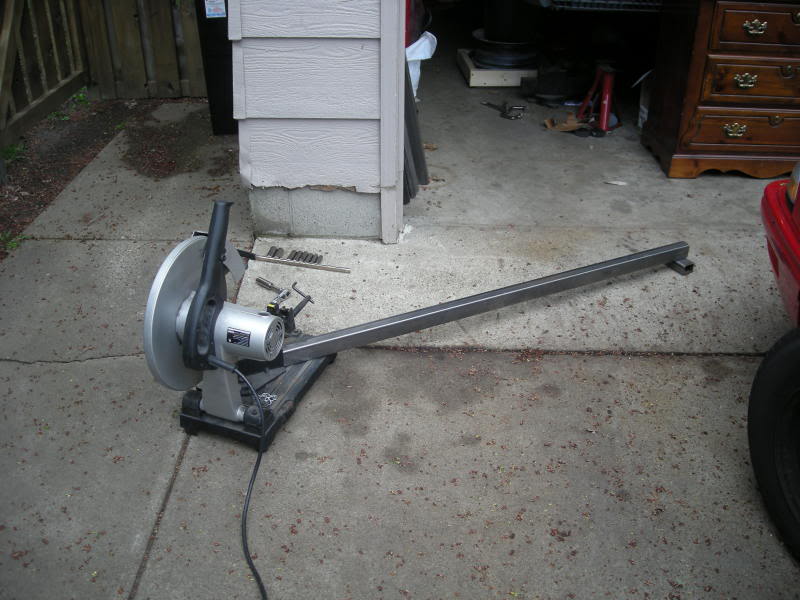

Next step. I started with about 80" long tubing i just eye balled them under the car and marked them where i was going to cut. The drivers side was easy. I cut it at 65" The right side (passenger side) i left even more since i was planing on over lapping two tubes.
i angle cut them and lined the tubes up to the LCA brackets where i wanted them and marked

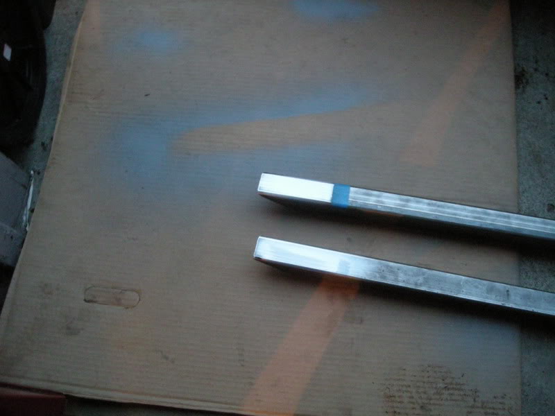

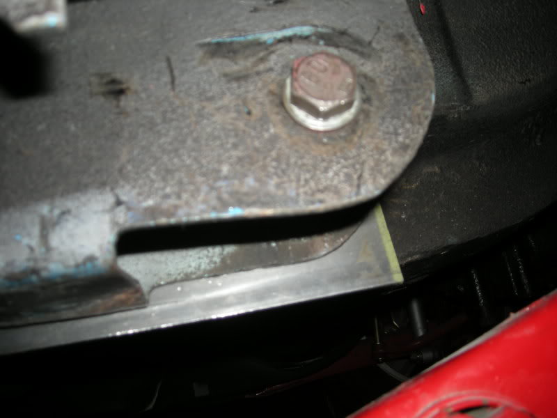

Since i was welding them metal on metal i used a weldable corrosion proof primer on both sides that where being matted together its not necessary but i like to

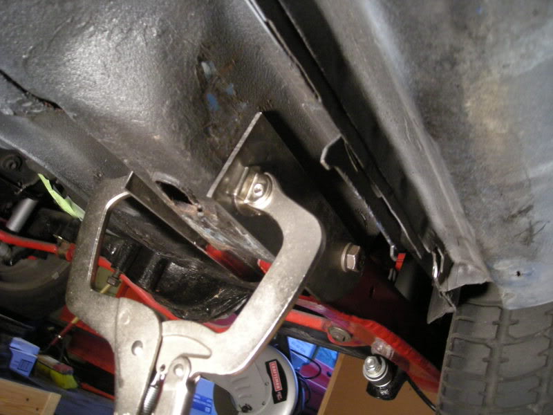

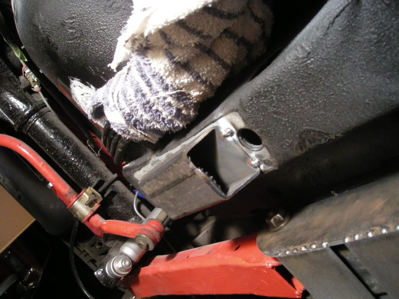

I bolted both in. the drivers side was perfect just needed to be trimmed. The passenger side was longer but i marked where i was going to cut it in the middle to have the other tube over lap it on the top. then angle cut it them

Re: Sub frames (final design and build)

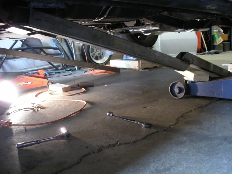

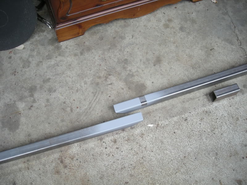

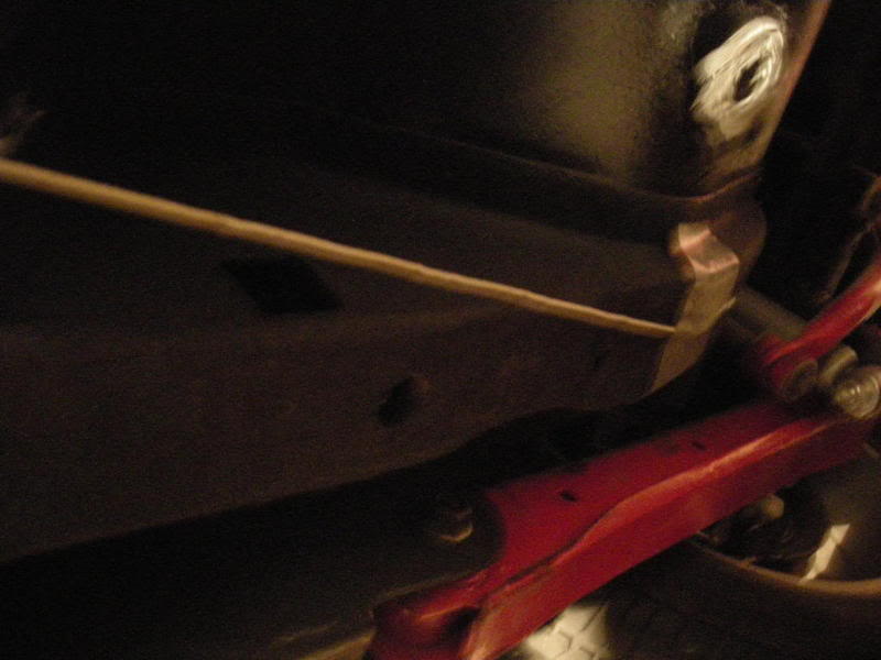

i marked the over lap under the car and since both where being over lap and welded i taped the line then cleaned them up and used the weldable primmer again
I used a few props to support the end of the tube and boards to straighten them out before tacking and clamping them down to do the rest of the sides
After that i bolted them up and swong them into place and marked where i was going to trim the ends

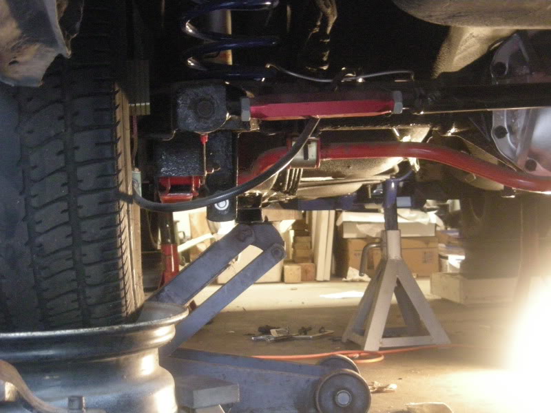

here is the end result. i have a lilte bit of modifying to do on the ends to fit the contours of the front sub frames.

Front plates. I started to cut and pound the sides for the frame rails into shape.
Then i tacked the bottem plates on. Heres what they look like they fallow the contours of the rails perfectly

I got done tacking the front peaces in and started on the the main inner sub frame tubes, but i ran into a dilemma with the 2 x 1.5" tubing. my plan was to notch the tubing 0.5" over the rear peaces so it would run really close to the floor boards. but after looking at it, its going to hang to low even if i notch it. here is example with exactly how low it would be the tubing in this pic is 2x1 im talking the bottom of the tubing not the top area from the tube to the floor pan just the bottom. this is how the 2x1.5" would sit.
(Sits lower then the rear shock mount)

Here is how nicey it was going to tuck up to the floor boards after i notched it
