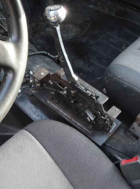

Waiting for the shifter cover to dry and will then be installing it, as soon as I do I'll be taking pics and uploading them ASAP.
Quick note, this is the shifter installed, without the black shroud and the top cover, the box is going directly behind it. For the cover, painted it on an old speaker bracket seen below.
