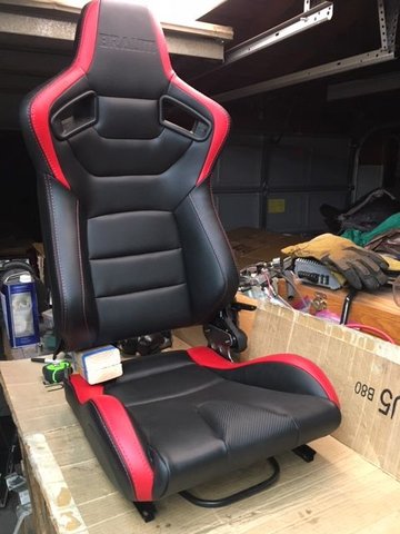

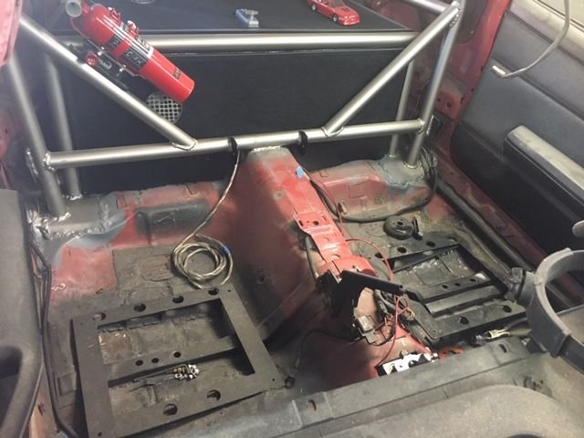

6'8" and shrinking here.
I fabricated my own seat mounting plates for aftermarket seats with built in slides and moved them back ~6 inches.
They are welded to the sub frame cross member for strength.
The wrap around high back seats tucks in nicely as the seat slides backwards providing critical cushion between my head and the roll bar.
I also modified the seat to raise the back up 3" to properly align shoulder height to seat belt cavities.
Plenty of leg room and sliding forward supports average height drivers although they are banned from this car.
