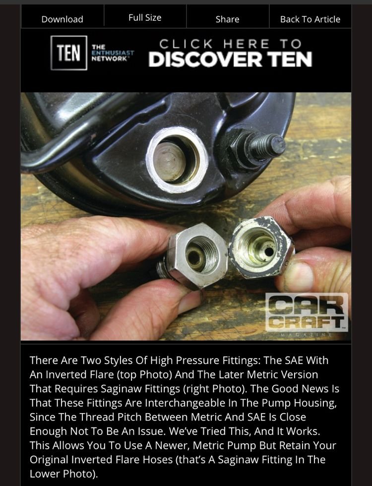

You can keep the inverted flare hose and install an older pressure fitting on the pump. Like this:
Or you can get a set of brass inverted flare inserts.
https://www.google.com/search?q=sagi...ha9lsRzRxtI7HM.
The other option is to adapt both ends to AN fitting. But that requires a custom hose.
