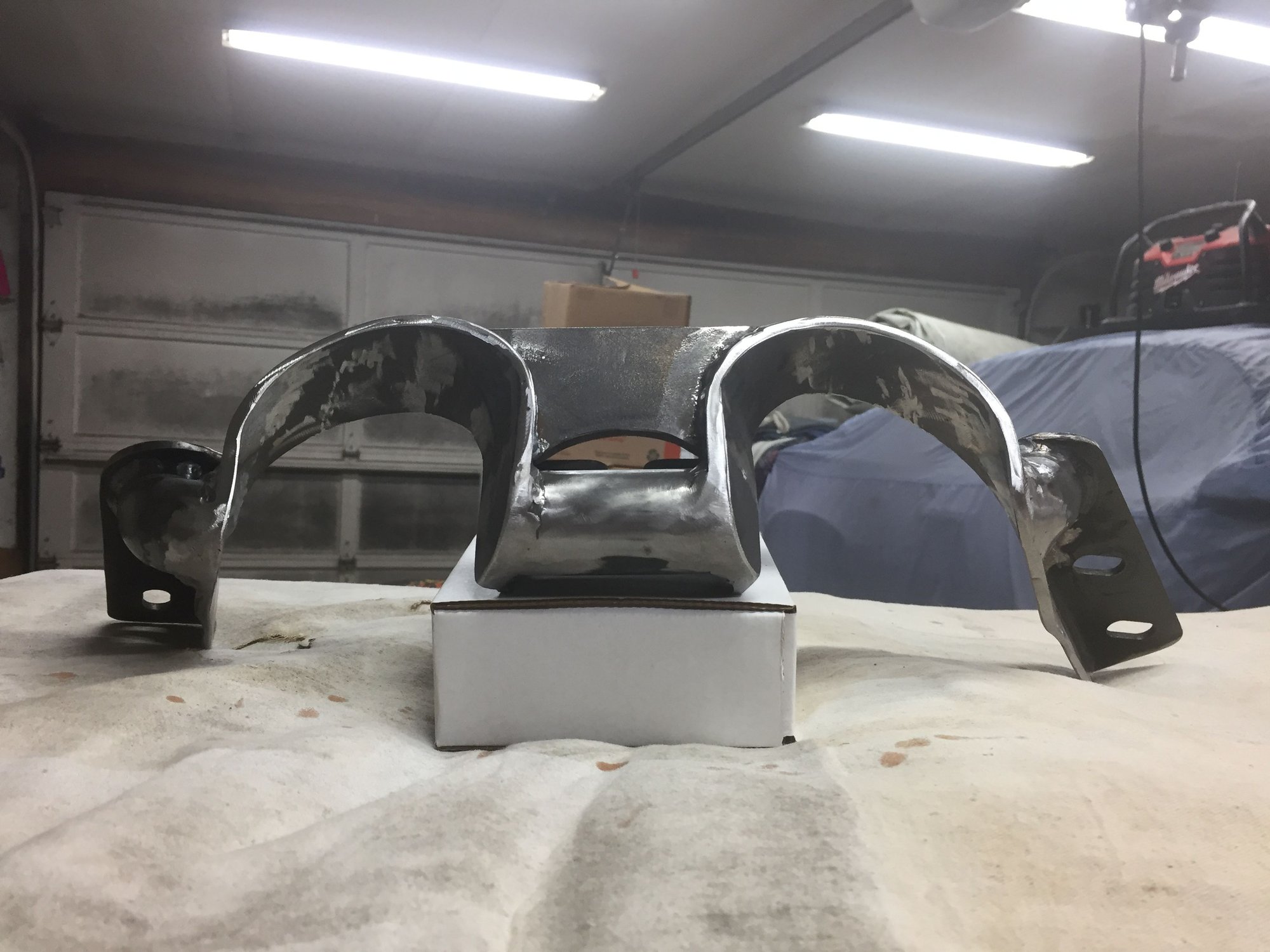

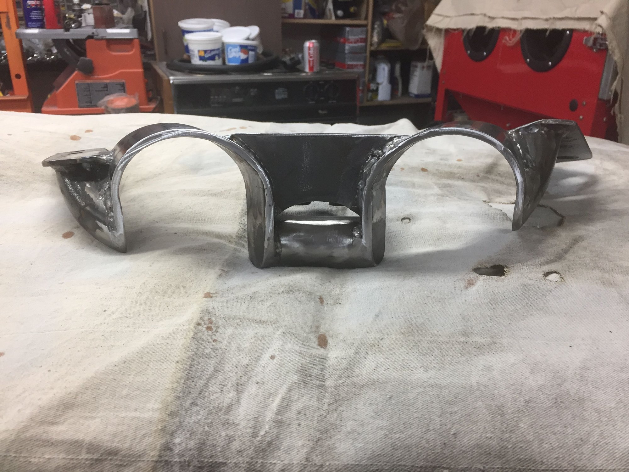

I made my own
Cut the frame rail on the passenger side to help with clearances.
Using 1 7/8" long tubes to 3" collector, then oval 3" to a single 4" over the axle .
I have SFC and a cage, so strength and rigidity is there.

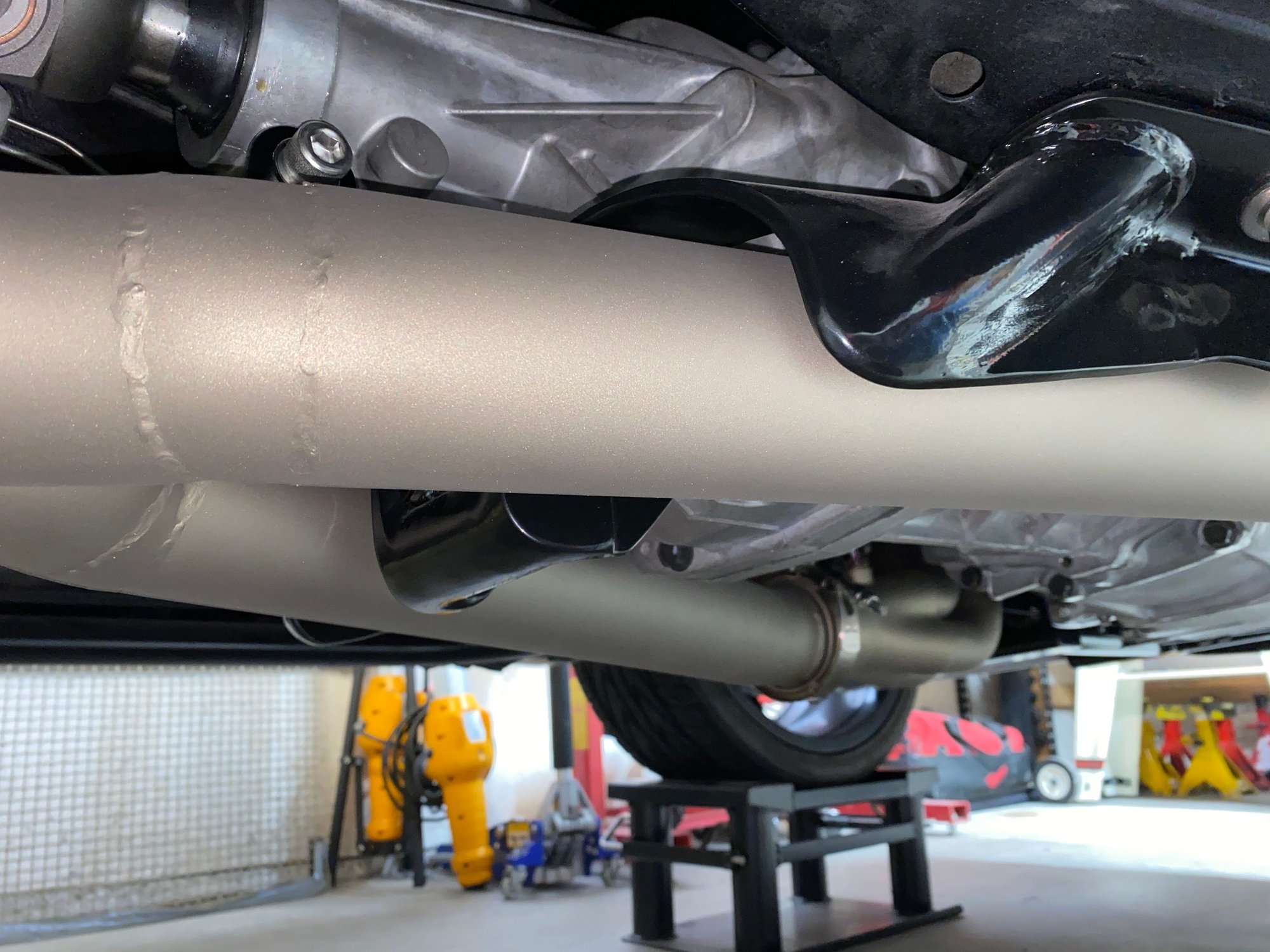

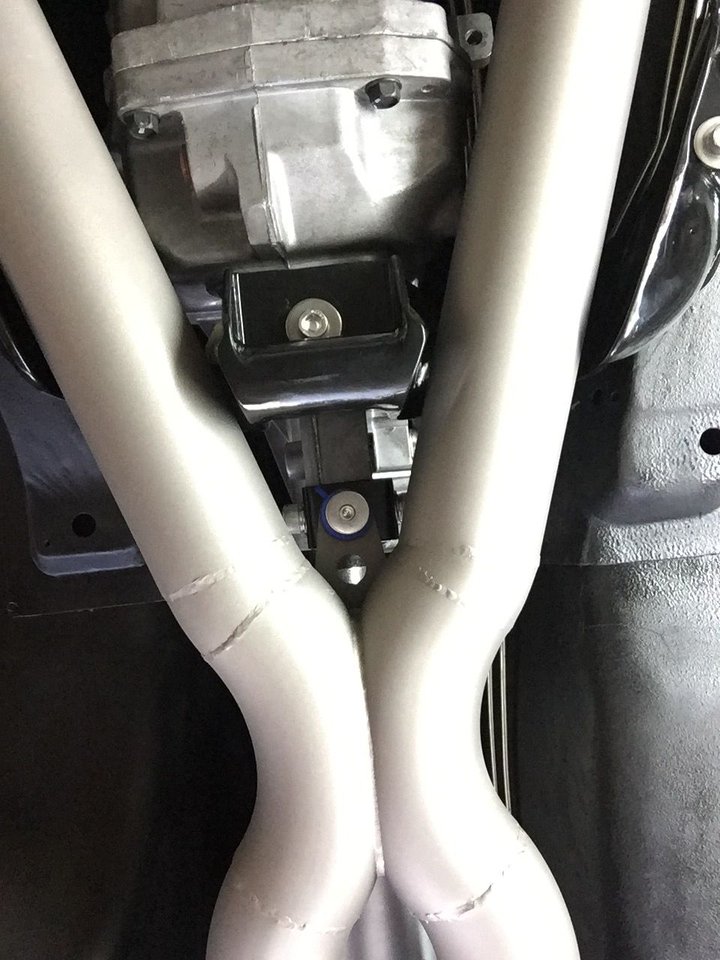

Custom cross member with long tube headers, 3” dual exhaust, and X pipe.
If you look at the pictures above, I do not see how a torque arm would fit with a true large diameter dual exhaust. This car has IRS and a 600 hp LS engine, and everything is really tight underneath.

I'm building a double hump torque arm mount crossmember to fit around Alston sub frame connecters. looking for advice from others that have built their own crossmembers and are running highly modified engines.
Post #789
https://www.thirdgen.org/forums/ltx-...ml#post6149848

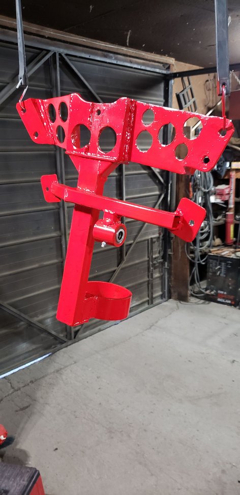

i have the hawks t56 cross member that im going to modify and weld a bracket to mount the torque arm. hopefully it goes well when i get to that part.
I've had one of those too. Not strong enough for torque arm IMO.

ill prolly beef it up a bit if i can.
