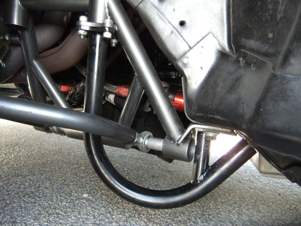

Racers use "wheelie skis". That way the skis crush and slow down the impact.
https://www.trzmotorsports.com/wp-co.../jpg505JPG.jpg
But that wouldn't be good for street driven car
