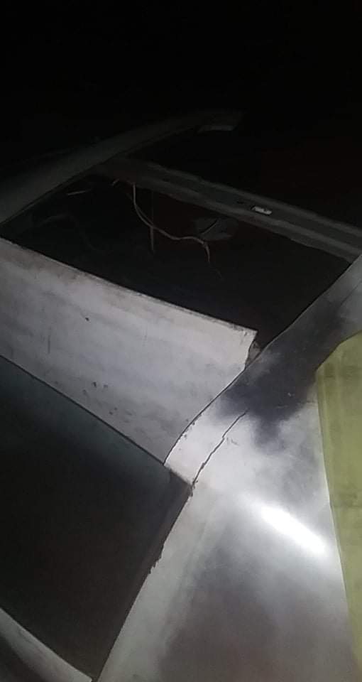

Hard top to targa project
Decided to turn a hard top into a targa using the old hard top this is just a rough draft no frame flex at all but I know better than to drive around like that with out reinforcement I'm gonna give it a tube frame

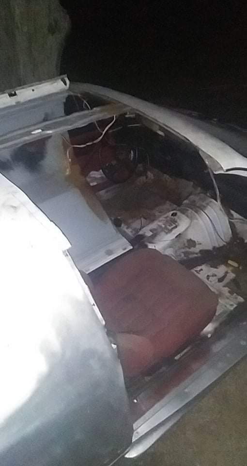

Re: Hard top to targa project
Better pics making the hard the cover gonna weld supports and top latch and seal it

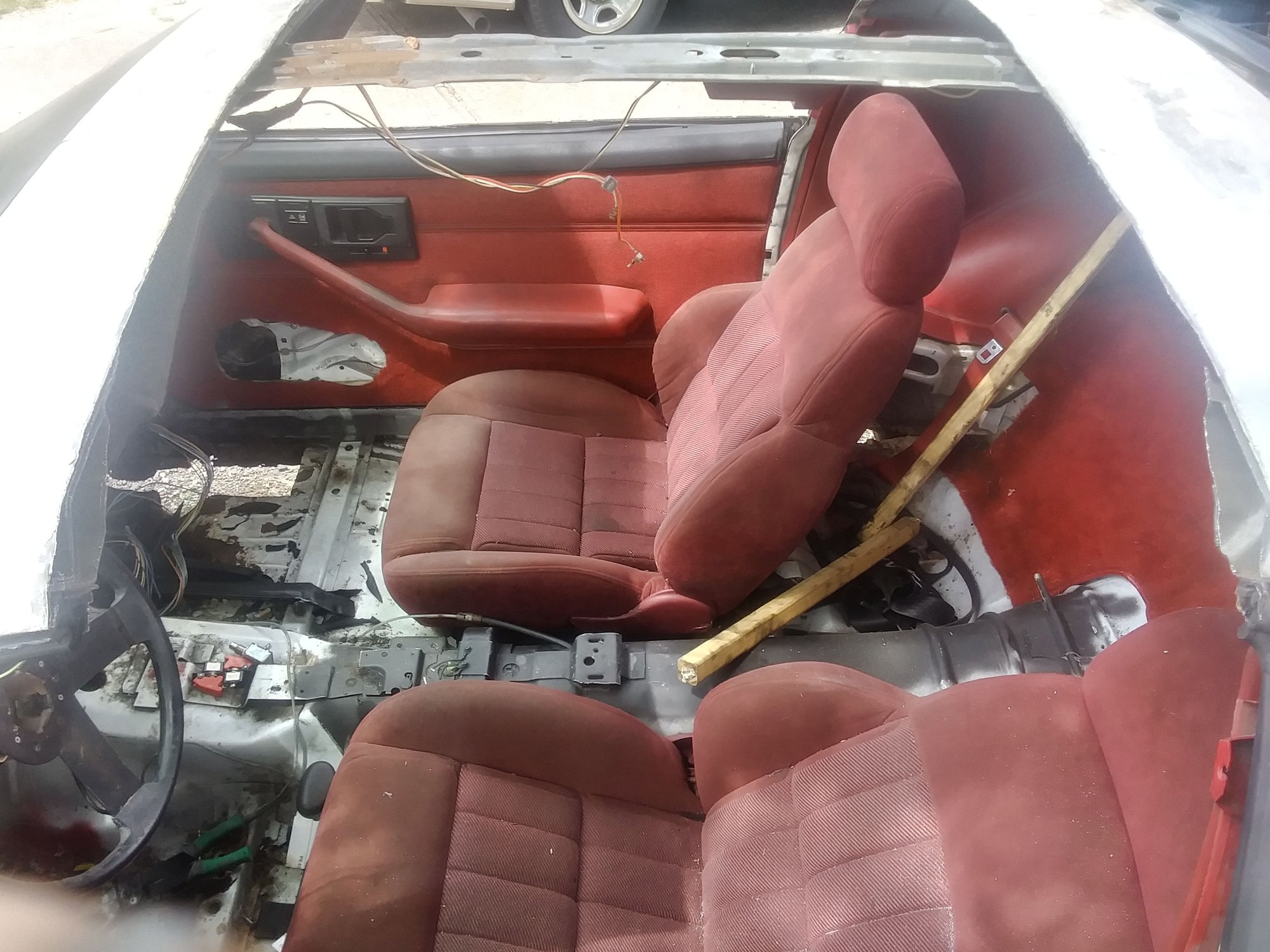

Trust me, its flexing.
Literally all the chassis stiffness there is coming from the trans tunnel as there is no direct connection from the front to back.
There is a reason that when people do things like this they weld in support bars to keep the frame from flexing.

The floor of the Car should really have been repaired (looks like there are some big holes/ rot) before starting this.
It would have been ideal to the install Sub-Frame Connectors with additional Tie-In Points as well.
Lastly, temporary Tubing/ Bracing should have been welded together inside of the Cabin to keep everything aligned as best as possible.
Otherwise the Doors may not close properly from misalignment/ shifting...
And the new Targa-Top also may not want to fit in place properly from misalignment/ shifting.

These cars will crack the B-pillar on hard-tops from repeated twisting of the frame.
The front frame horns require the triangular braces to prevent the frame from cracking where the steering box attaches due to the stress of turning the wheels. The stress is greatest when the car is at a stand still as compared to motion.
Taking the support the center bar provides out without adding in extra bracing while you build the Targa WILL result in a frame that is not straight. It could be fractions of an inch, but it WILL be off.
Its a well known fact that the unibody is a wet noodle. Most cars of the era were.
But, if you want to chance your #'s being off because the frame shifted, that's your decision.
Look at the bracing that was added by ASC for Convertible conversions.
