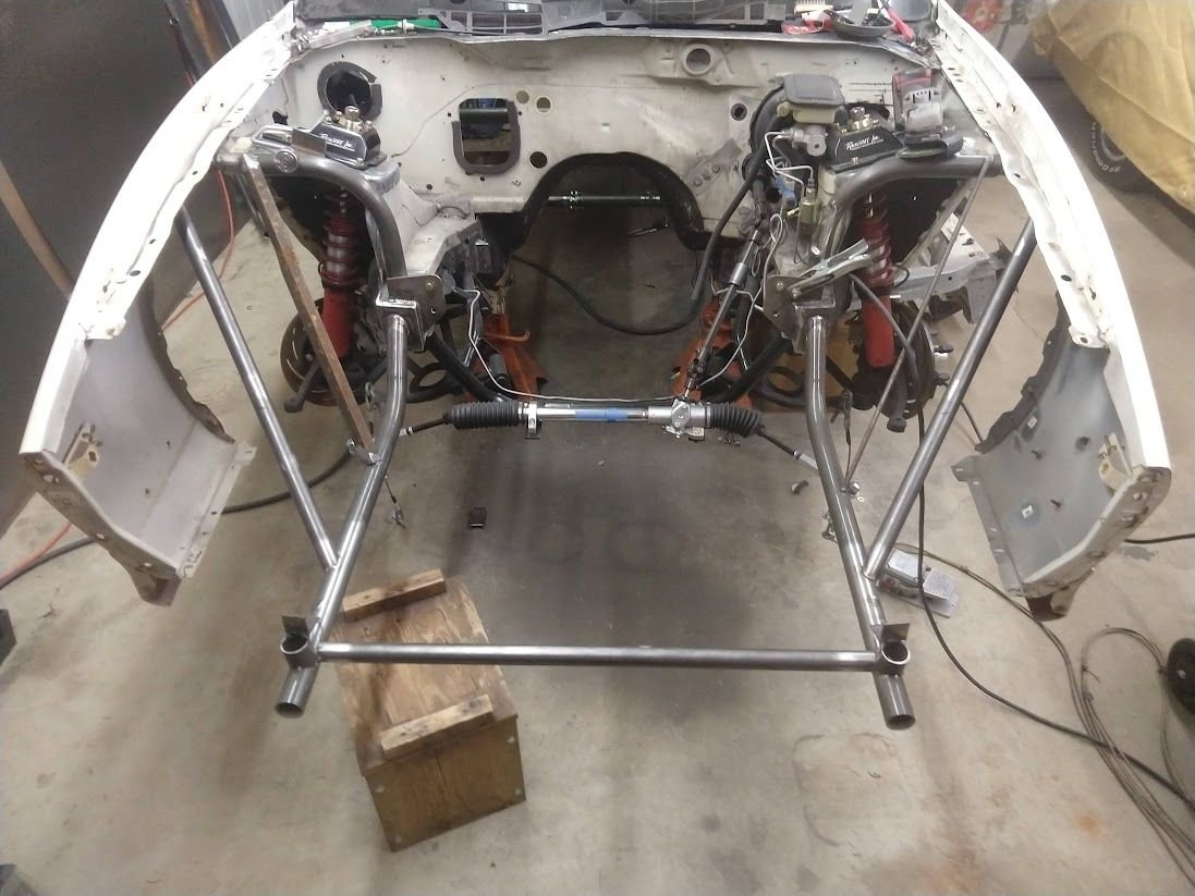

i have the rock solid one on mine. huge amount of work. well, i say that mainly because i was wanting my foglights, headlights to function and be in the correct location, and all the body panels needed to line up as good as i was able. once you get the main tubing installed, you will realize just how much work is left to do, because in my opinion you arent even half way done at that point. lol

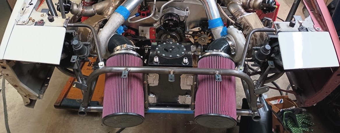

i wound up shortening it a few inches, but this is the basic part that you build off of.

headlight mounts

As much as I would love to have a tubular front end just to have more room under the hood, it's just too far out of my price range. I did the back half on my car and can easily see why just that could cost over $10k to complete. Front end would be even more. Looking at Digglers pictures, it's still not a full tubular front end. It's only been modified forward of the strut towers but still gives a huge amount of room. My BBC with Ed Quay headers would still have problems since it's still OEM behind the strut towers.

When people talk about tubular front ends now, this is what they are normally talking about. But you are correct, if my car was done behind the strut towers it would be a full tube chassis car. lol that is the only little bit of factory frame left, is the strut towers and down to the bottom of the firewall.
