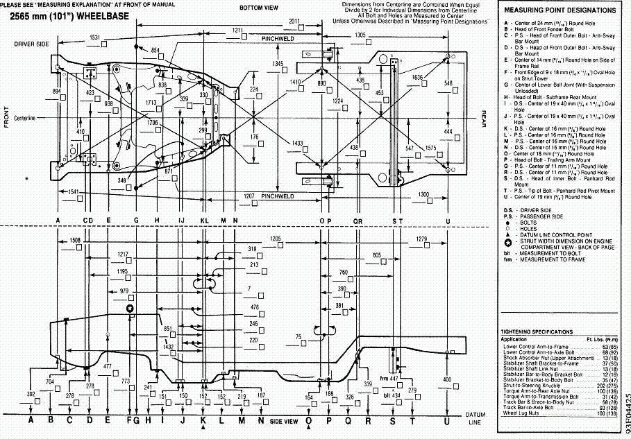

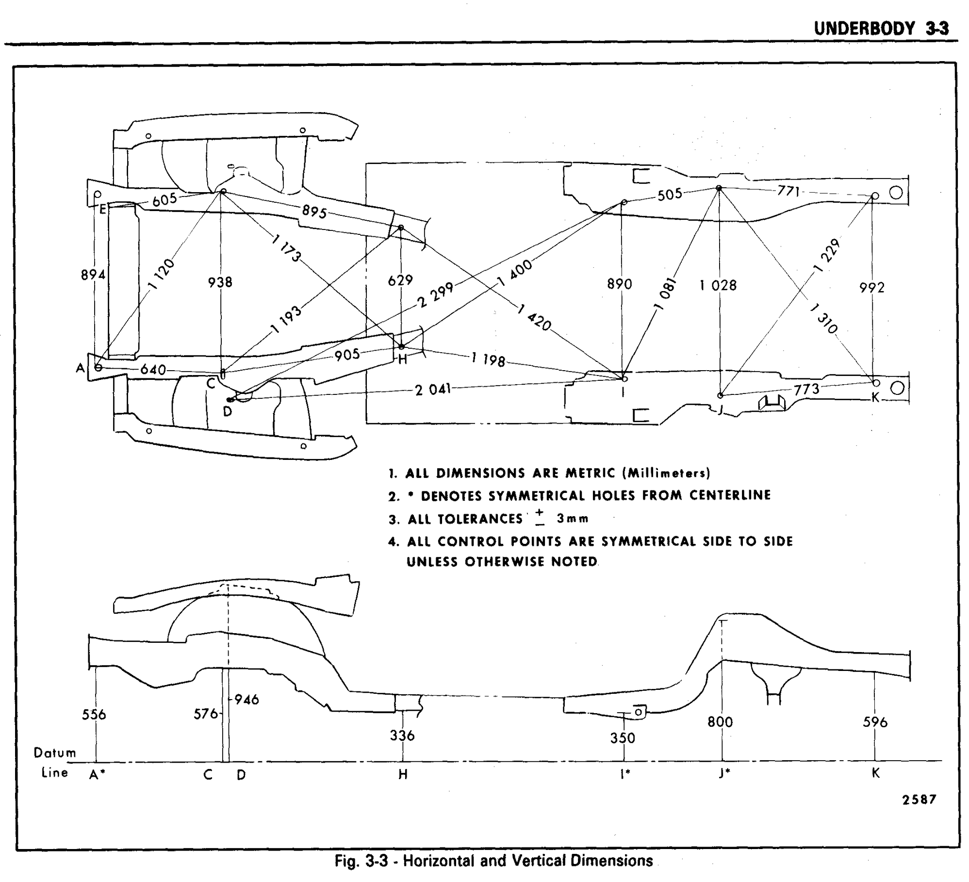

About the only datum point information I've come across are from images like these:
As I mentioned, any chassis work we've done (and this is regarding the hot rod chassis I spent a lot of time in) was always done on a jig. Better still would be a surface plate which offers even more adaptability.
I'd trust that QA1, et al, use something similar in their development. But as you say, how that translates to the chassis at hand can often be challenging.
