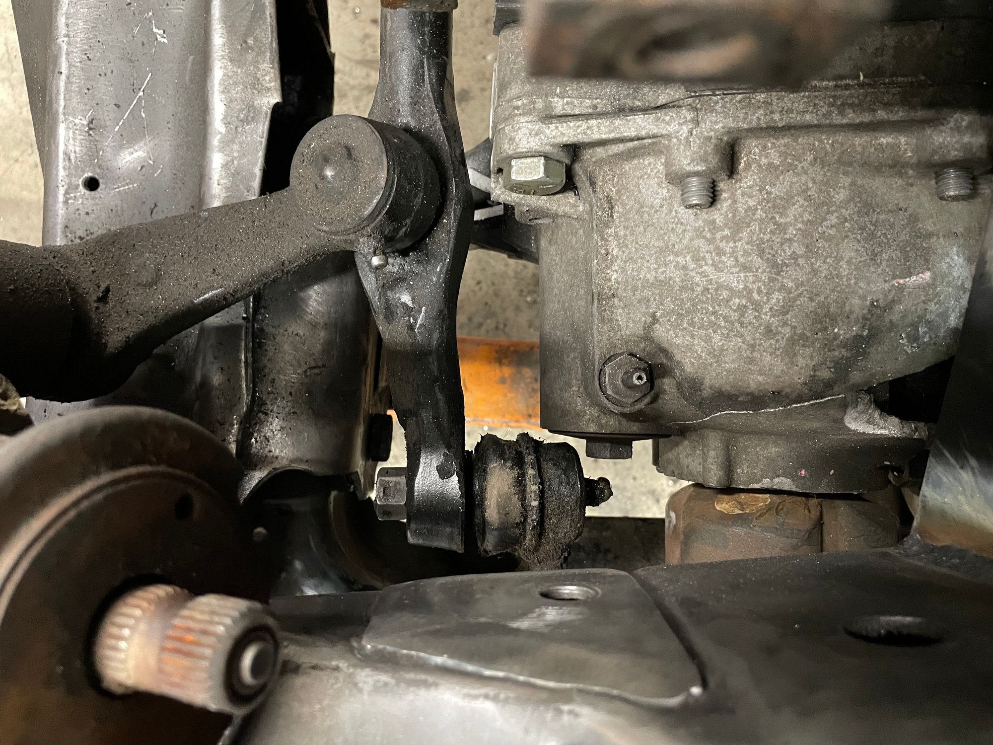

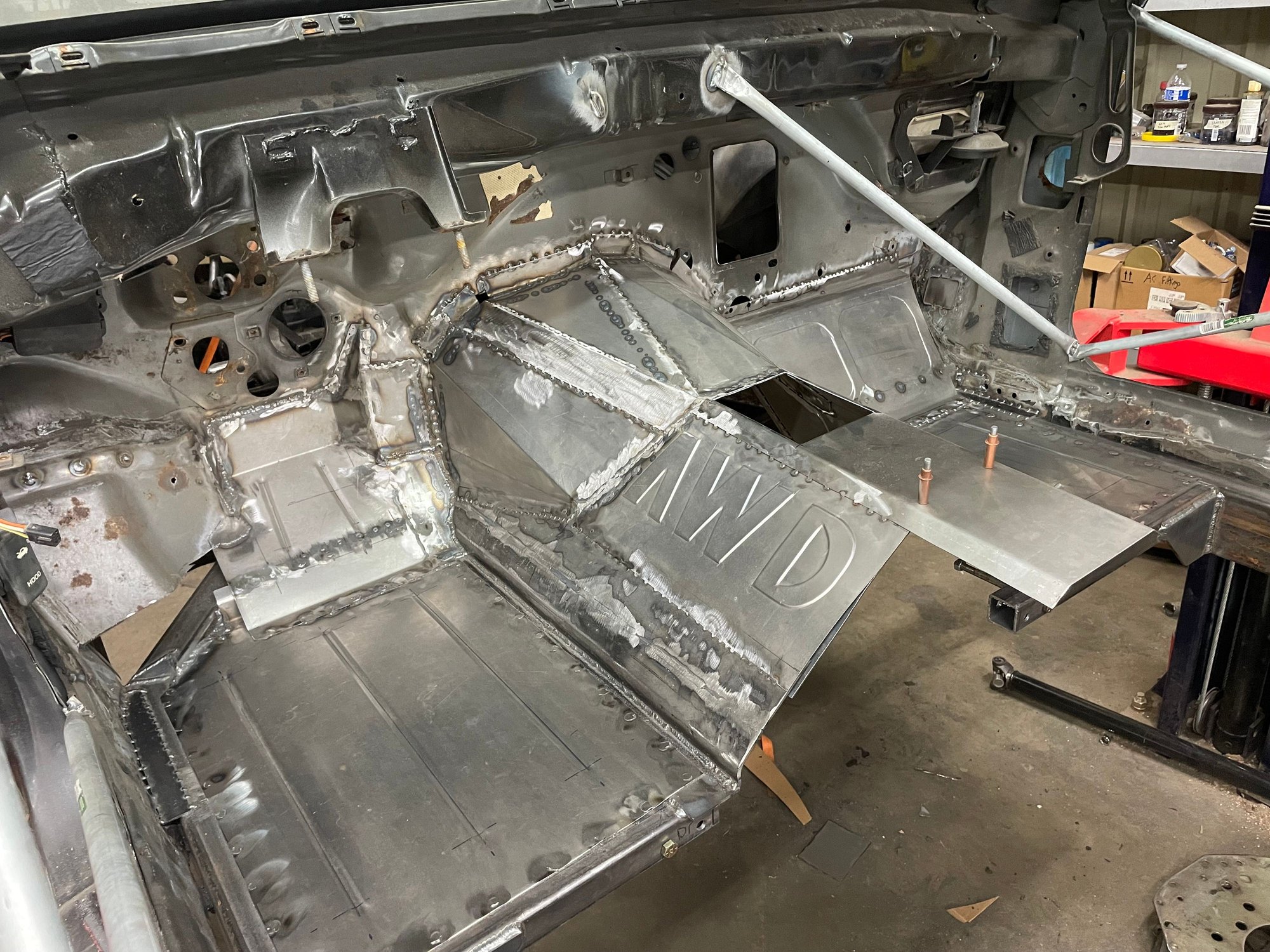

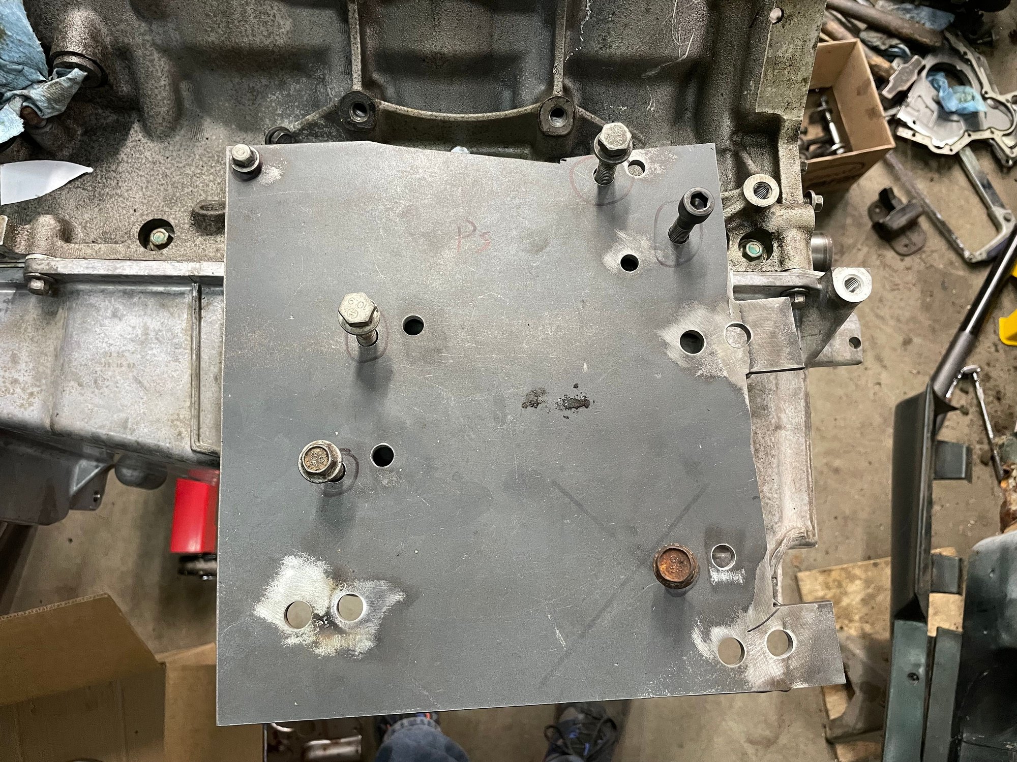

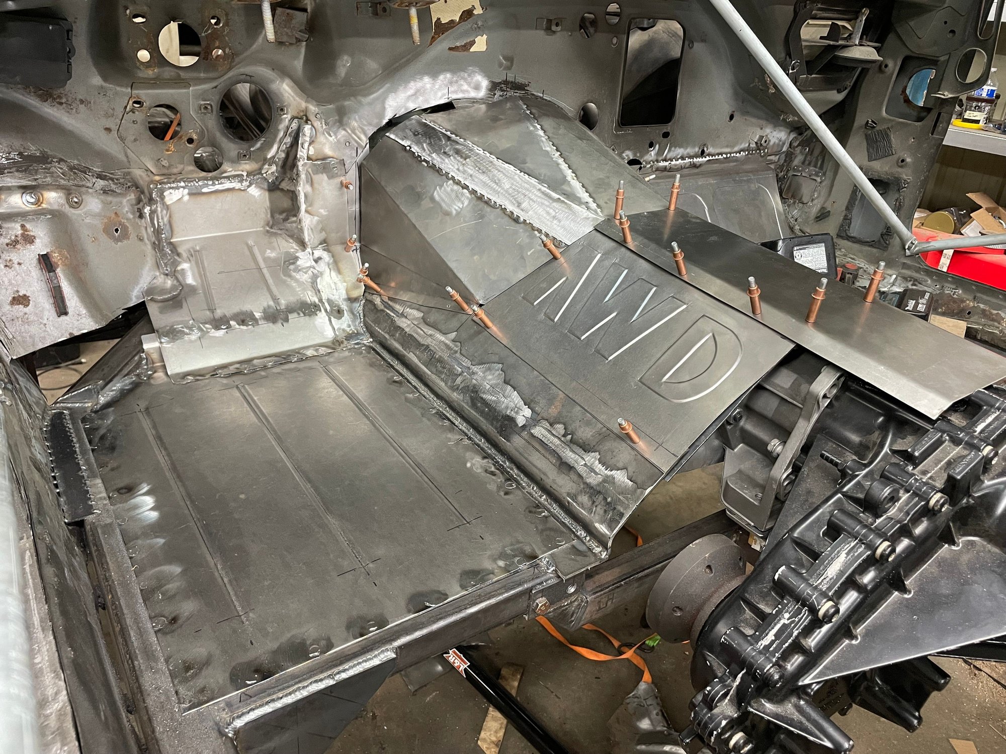

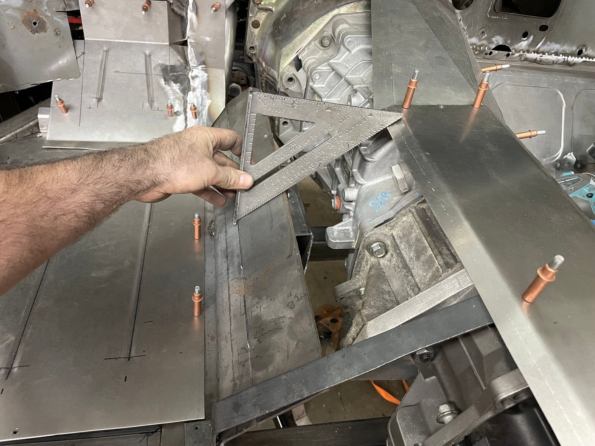

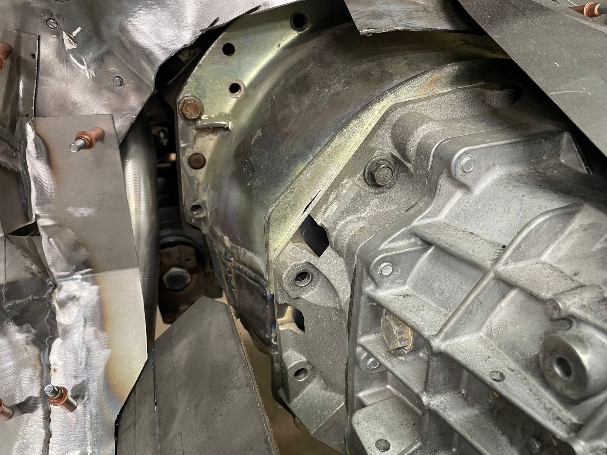

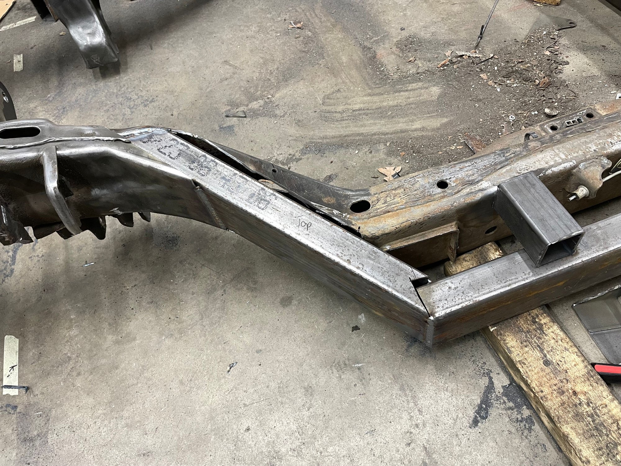

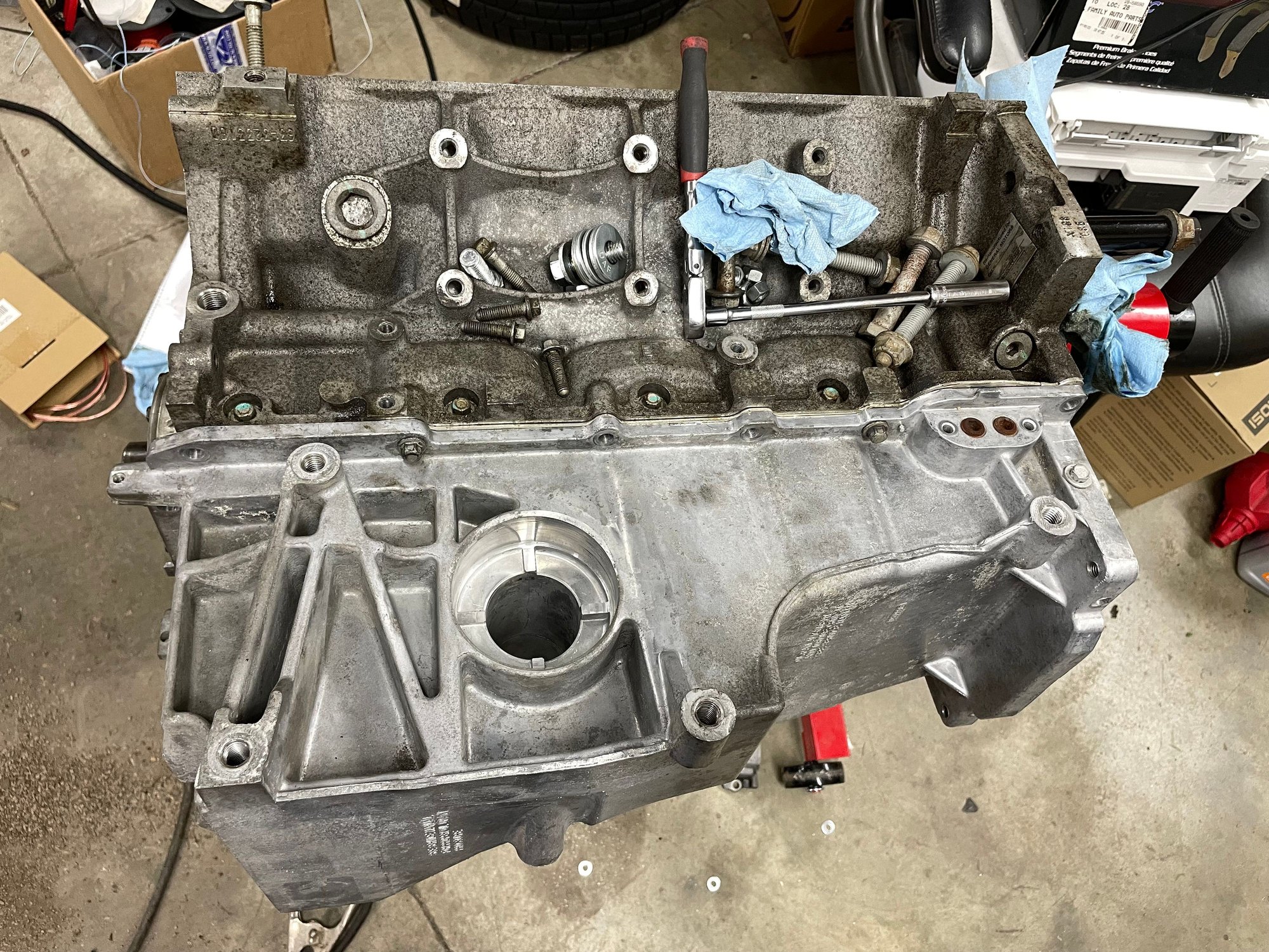

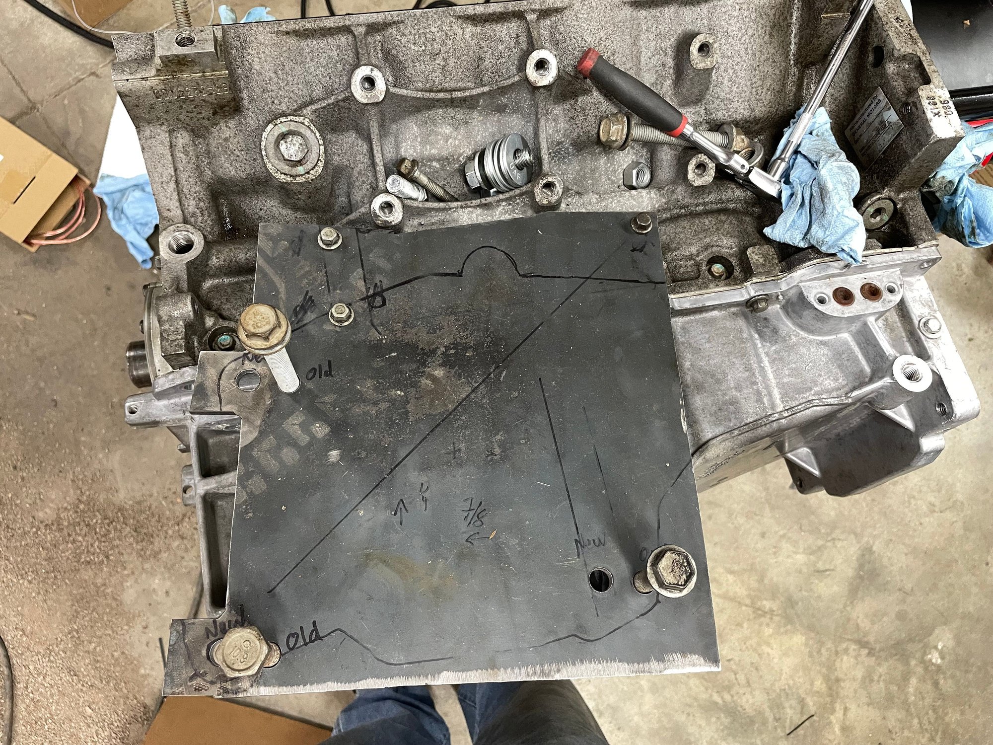

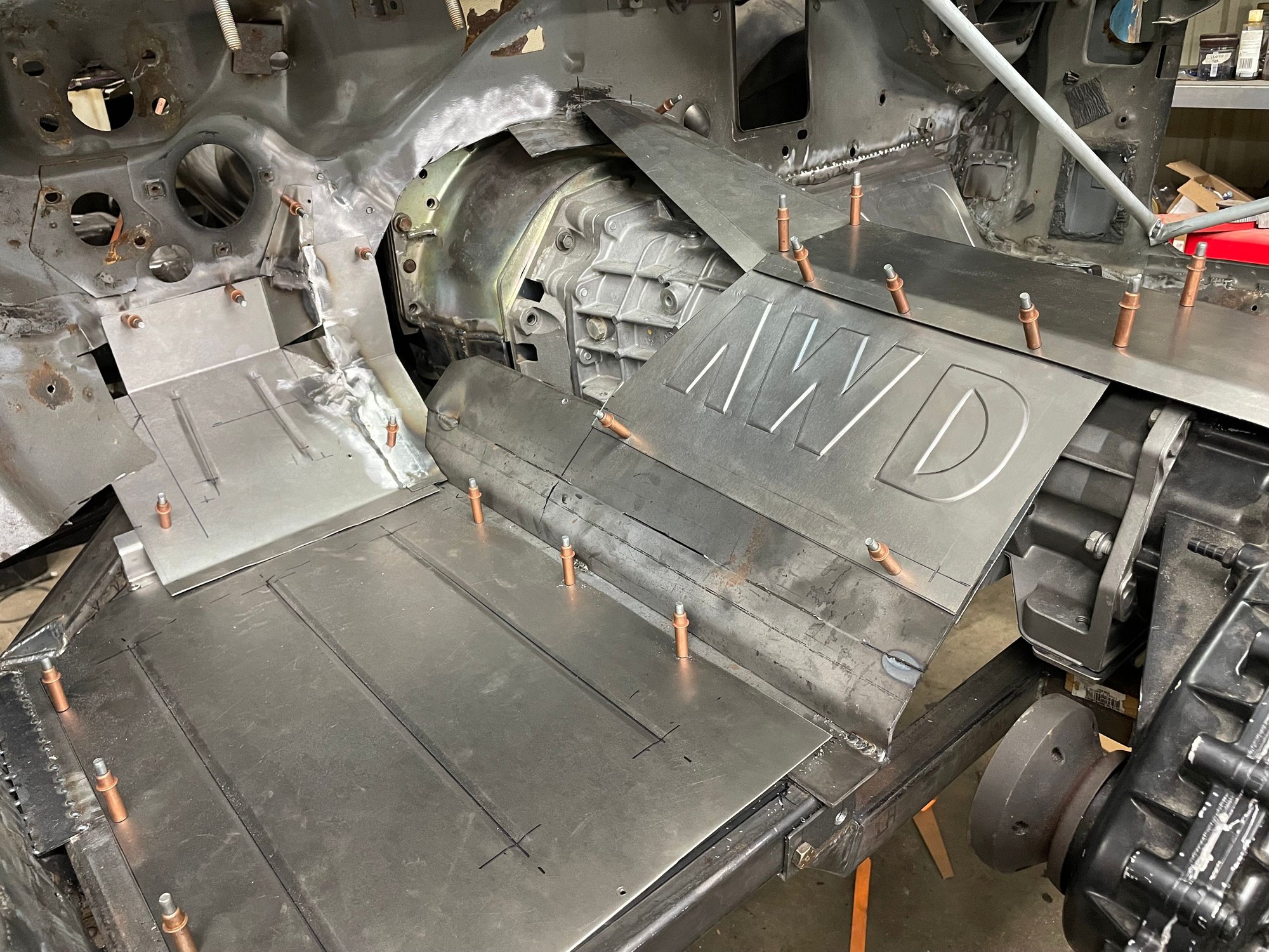

I sliced the top 45* of the plate to flatten it out. Then a simple flat sheet can be used
Front needs a little trim to clear the hydraulic lines
Totally unnecessary, but good practice on the bead roller. I probably should have mounted it backwards to be seen with the trans out. Sound deadening and carpet will totally hide the panel

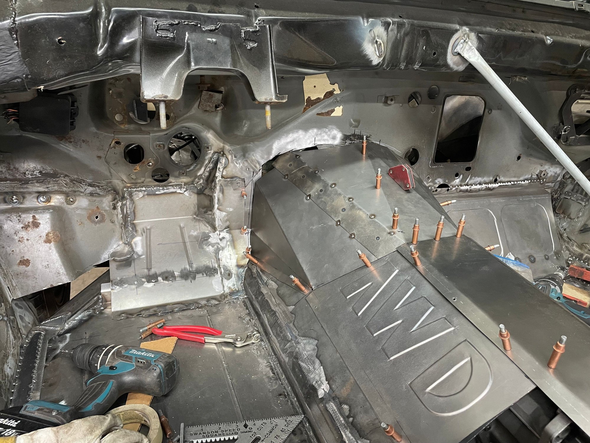

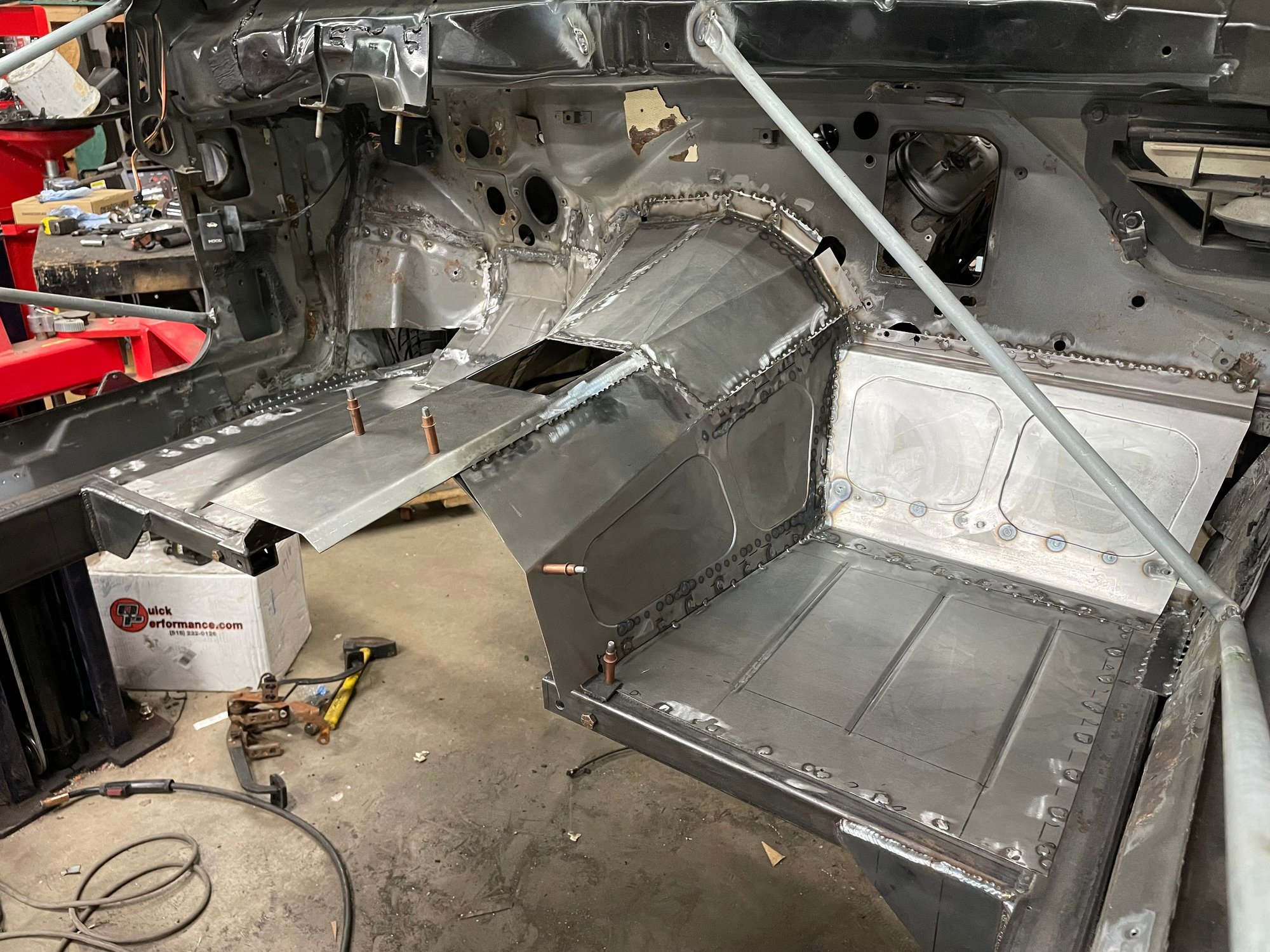

Welded the floor and toe board in to move to the LH tunnel. I goofed on the template for the tunnel, so there's a strip added
For the tunnel flange, I opted for short 90* pieces. Single piece would be nicer, but I was pressed for time already. The trans was pulled to button up the bottom. I'll have to pull the engine to finalize the front of the tunnel and fill the firewall holes
I cut the shifter hole and welded the top cap on. It'll probably need to be extended rearward for an offset shifter. I'll figure that out later
I have about 20hrs in the front section. Hopefully the rear is easier
Next up is the torque arm mount behind the t-case. It'll have to be VERY strong, while being removable to get the t-case out. TBD
Need to bite the bullet and order the frt coil overs. Once their structure is welded in, the wheel wells to frame can be filled in. That should be the bulk of fab work done

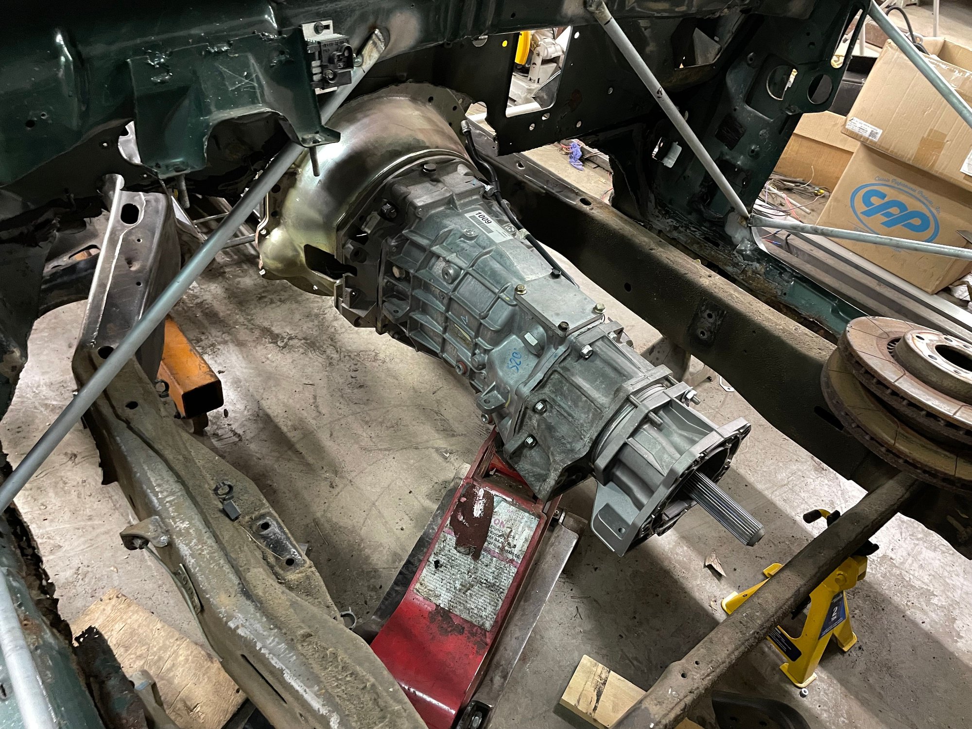

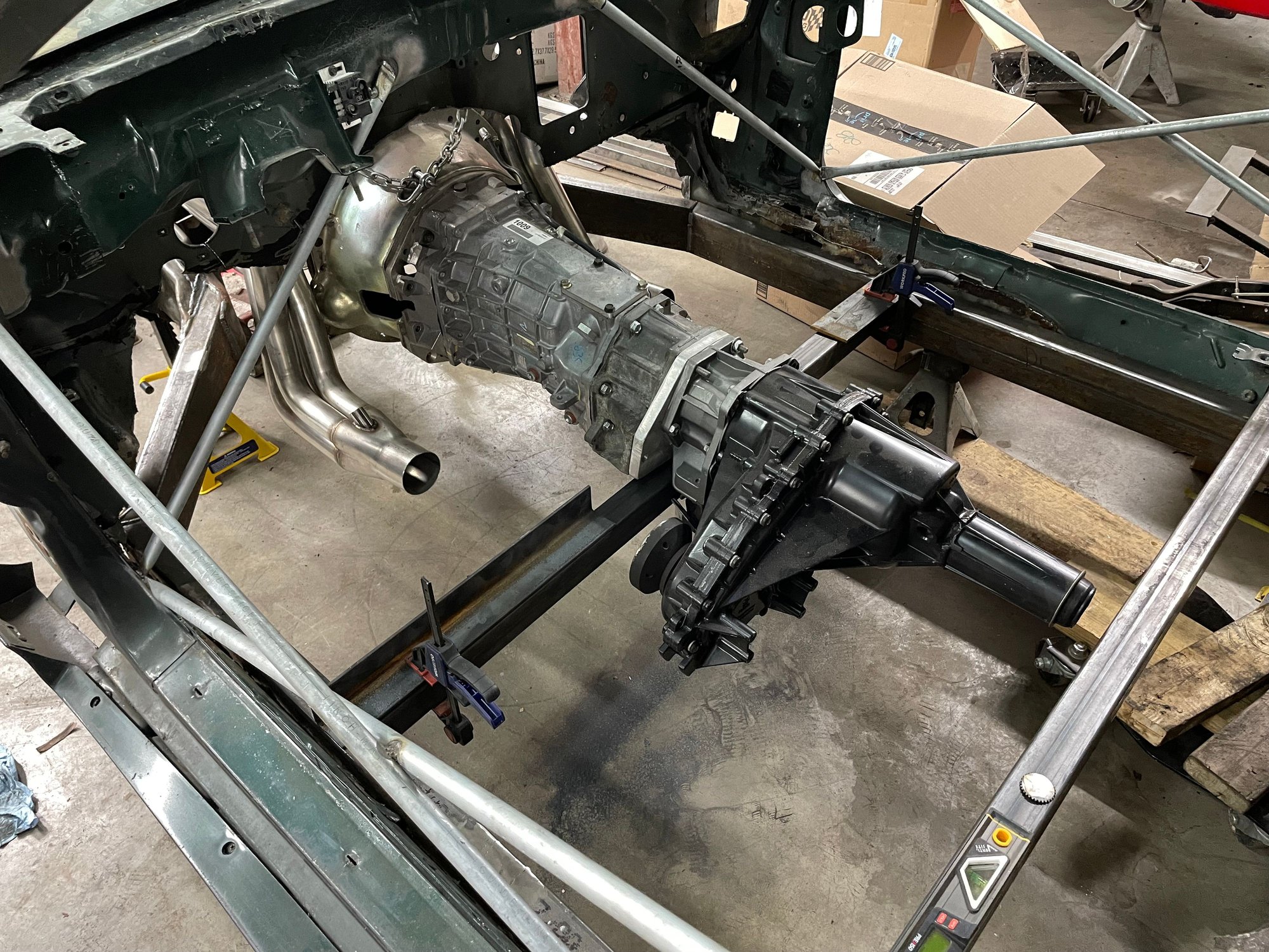

With that set, let’s get started. First up, modify the T56 magnum to 4x4 and select a transfer case. Since I’m using a magnum, it’s a little different
T56’s come in three main flavors
Classic T56- 93-02 Fbody, 2 pc counter shaft
Corvette/GTO/SSR T56, these had triple cone synchros and a few other unique pieces, but largely interchange with classic T56
TR6060, which physically similar outside, the internal components largely are not interchangeable. The mainshaft is the key piece I was interested in
On to the Magnum, it’s TR6060 based and the donor I’m pulling the rear extension housing from is C5 corvette T56. It turns out the countershaft bearing pocket is different. I grabbed two 4L60E 4x4 extension housing from the boneyard and designed a simple adapter plate from ¾” aluminum. The 5” centering hole was the only precision cut on the adapter. The holes were hand drilled. Thankfully, 3 of the C5 and 4L60E holes line up exactly along with matching 5” alignment hubs. Off to the machine shop
Figuring out a shifter is still on the to-do list along with a reverse lock-up mechanism

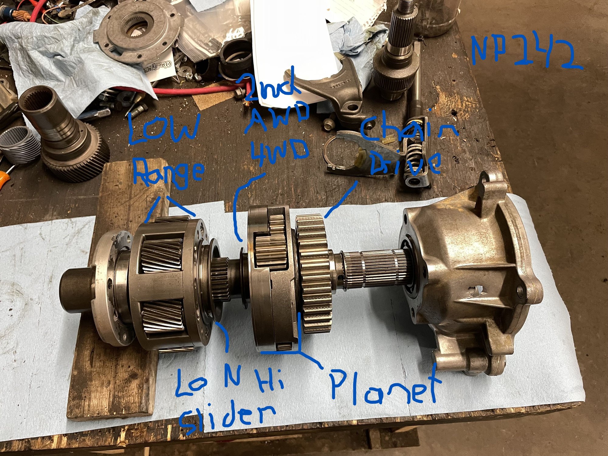

Transfer case: this took much more effort than expected. First, I’d like to explain the difference between 4WD and AWD from a transfer case design perspective as there isn’t a lot of specifics. Several auto mfrs interchange the definition and some designs kind of blur the lines. A couple models actually incorporate BOTH into the same units
The short answer is an AWD t-case has a center differential vs a 4WD locking the F/R outputs together. Much like a rear axle, the F/R wheels turn at different speeds, mostly in cornering. An AWD T-case will allow the axles some freedom, where as 4WD will not. Drive a 4x4 in a parking lot, feel the front wheels chirp/skip. AWD doesn’t do that
There are four main types of AWD T-case:
Open, these operate much like an open diff axle. If you jacked all 4 wheels up and spun one driveshaft, the opposite DS will spin the opposite direction
EX: NP203 from the 70’s
NP242 from Jeeps/Hummers/Durangos
Coupler locked, these are the most common and are fully self contained units that often do not require any computer help. There are some hybrid systems like what Subaru uses, but most people who think of an AWD t-case will think of these
EX: Syclone/Typhoon/Astro BW4472
Ford BW4404/4410
Escalade NP149
Jeep NV147, 247, 249
Active AWD, these require outside help to function. Without, they’re just simple open units. Often these will use ABS to apply brakes to one corner to maintain similar wheel speed on all corners. On the bright side, stagged wheels are an option for this type. Some OEM systems like Porsche come with staggered F/R wheels. With no ABS to fully use the system, some wheel slip is allowable
EX: Escalade BW 4481/4485
Most modern AWD crossovers, BMW, Mercedes etc
Clutch based is the last type, but is often frowned upon for custom builds. Some like Subaru still use a differential and the clutch locks or unlocks as needed. Some like the late Astro/Bravada lock/unlock exclusively via clutch and no differential. These often have a short life span, especially when the AWD is used heavily, EX 4 wheeling. These are in the gray area for AWD as they don’t fit the strict definition, but can still be classified under
Late S10’s, Astros fall under this category
Also worth mentioning is the Electronic Shift on the Fly (ESOF/ESOTF) 4WD. These are locking 4x4 units with no slip F/R but can engage/disengage so quickly that the typical 4x4 wheel hop is not felt. Ford often calls this AWD, but for a custom setup, it’s really 4x4. This was my back-up plan if a coupler based T-case failed. Use a Ford BW4406 with TOD. It activates by an electromagnet. Setting up if/then conditions in a Holley ECU, it can be controlled pretty easily with 2WD override for dyno pulls
A more common example is a Silverado NP 246

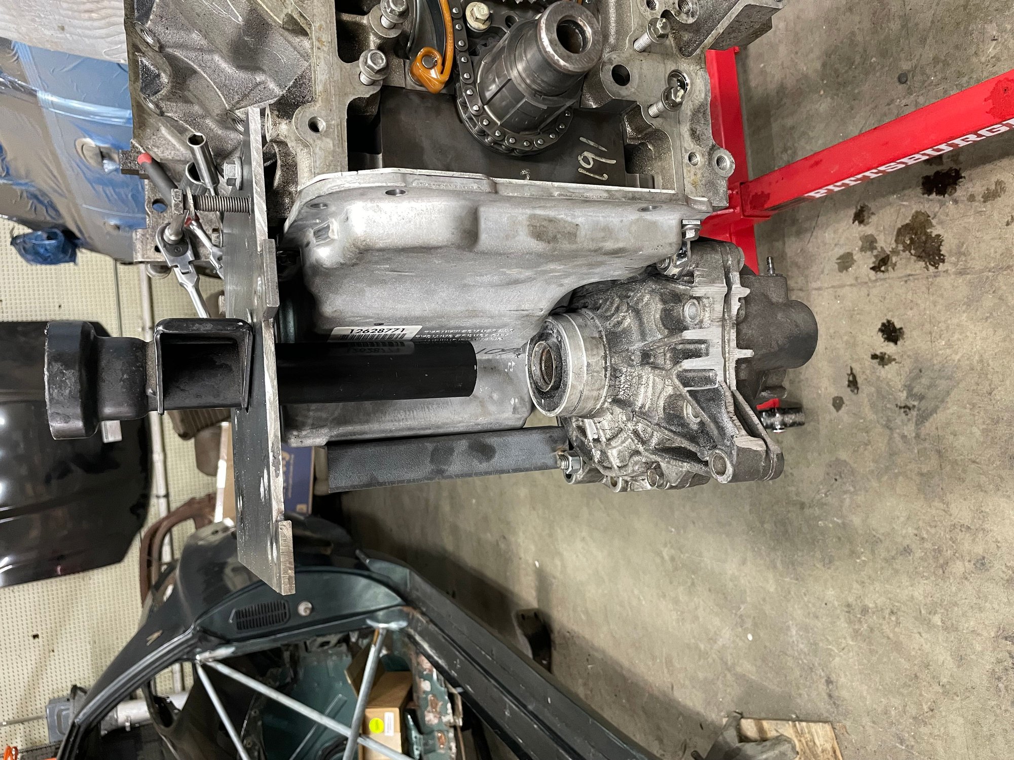

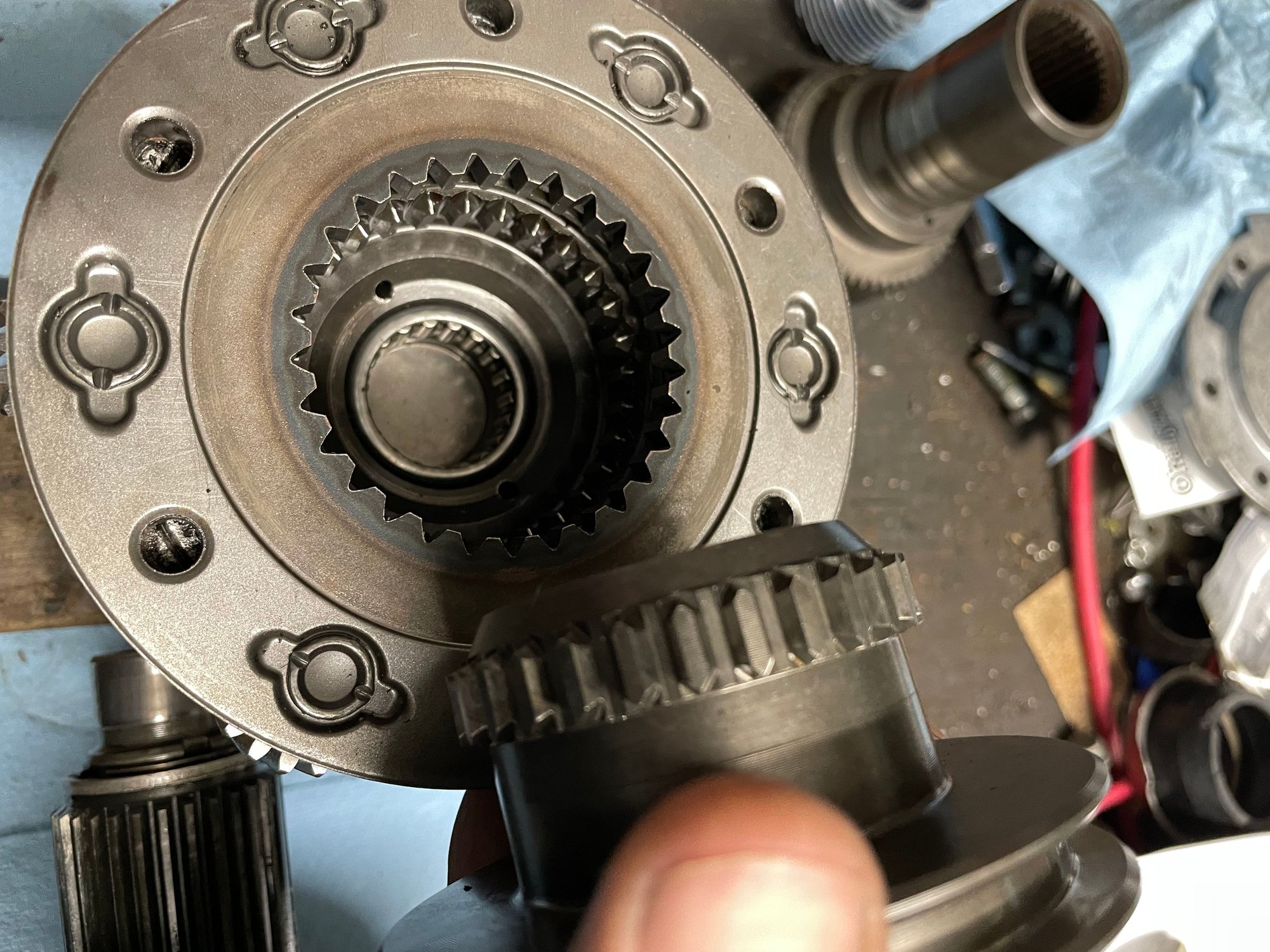

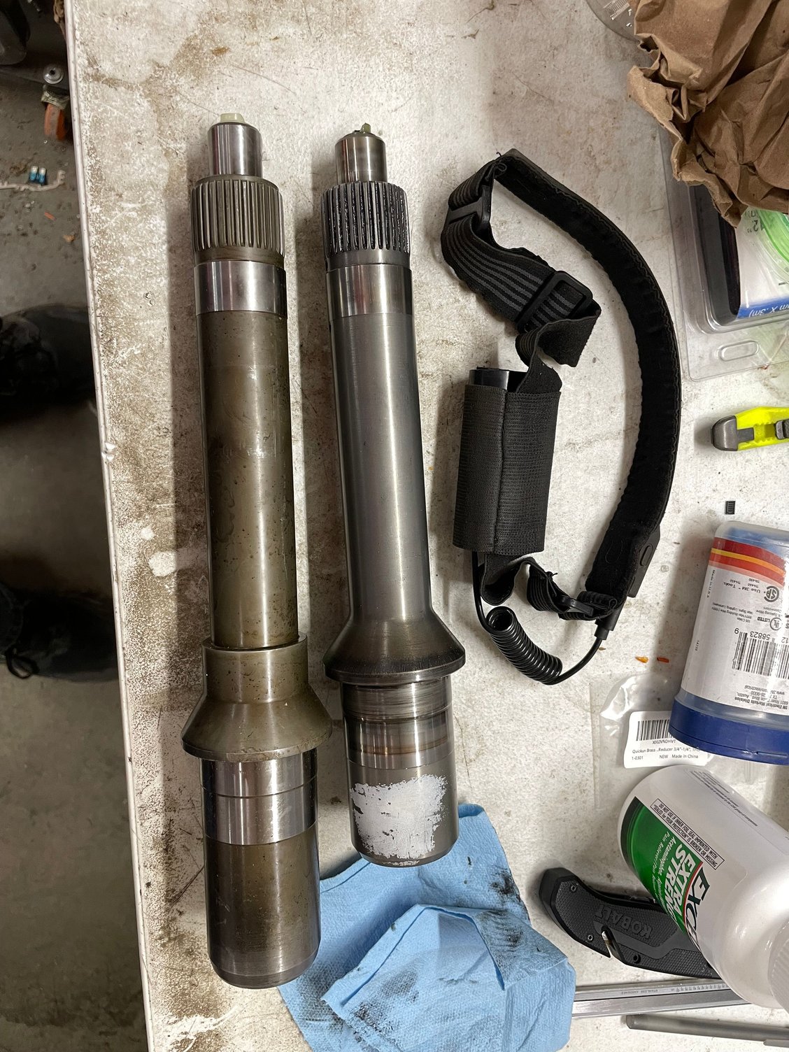

With that said, I ended up purchasing A LOT of t-cases trying to find a simple solution. The T56 magnum has a 31sp output shaft, so that’s the start
I purchased/rebuilt a tried and true NV149 from an 02 Escalade. Found a machine shop that recuts the input shaft to 32sp for 4L80E swaps and asked if they’d do a 31sp one for me. They accepted and after 4 months of no progress, they sent it back. Plan B, contact Mark Williams. They’d be happy to do it, had the machine data, BUT had a pretty large minimum order. While their PPU was VERY reasonable, the 12 unit minimum made this endeavor too costly, so that T-case was shelved. I got a second hand 32sp input for the T-case and saved it for a later 4L80E build
Next, I tried the NP242 route from a military H1. I then got a cheap Jeep 242 to steal the 2WD components as the H1/2 units were AWD or 4 Lock only. It was a shifter/gate change. These units are really cool, but the open differential AWD wasn’t what I was looking for. There’s a lot of conflicting information about these and most of the other Jeep AWD t-cases. Quite a few people swore these were coupler based. They are not. Had to buy one and crack it open to find that out for sure
The unit has a really cool center diff. It can fully unlock for 2WD, fully lock for hard 4x4, or become and open diff for overland AWD. It’s all one simple slider into the differential
I purchased a Ford 31sp NP271 input shaft hoping it would swap right in. It did not. The complicated gear meshes/critical dims all fit properly. The front bearing and rear pocket bearings were different. I found out later that Northwest Fab sells these pre-machined to do this exact swap. Hindsight
*Add pics when I find them*

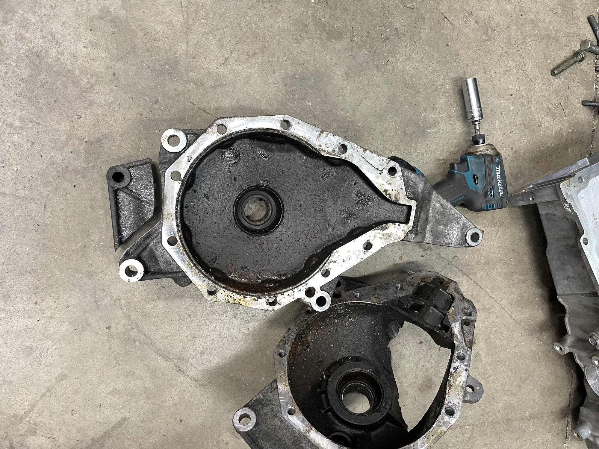

Then, I picked up an Escalade BW4481. I knew it wouldn’t work for this project, but it was $30. It was worth that to satisfy my curiosity of how it works
It's a huge empty case with a long input shaft feeding an open differential. This was done to keep the same external dimensions as the other SUV 4x4 units. GM could reuse the same frame, crossmember, driveshafts etc. It’s an active system based on the ABS. There’s a few classis truck builds using these with mixed results. None really push them for the AWD benefits, just say they have AWD and move on to the next project
Pics

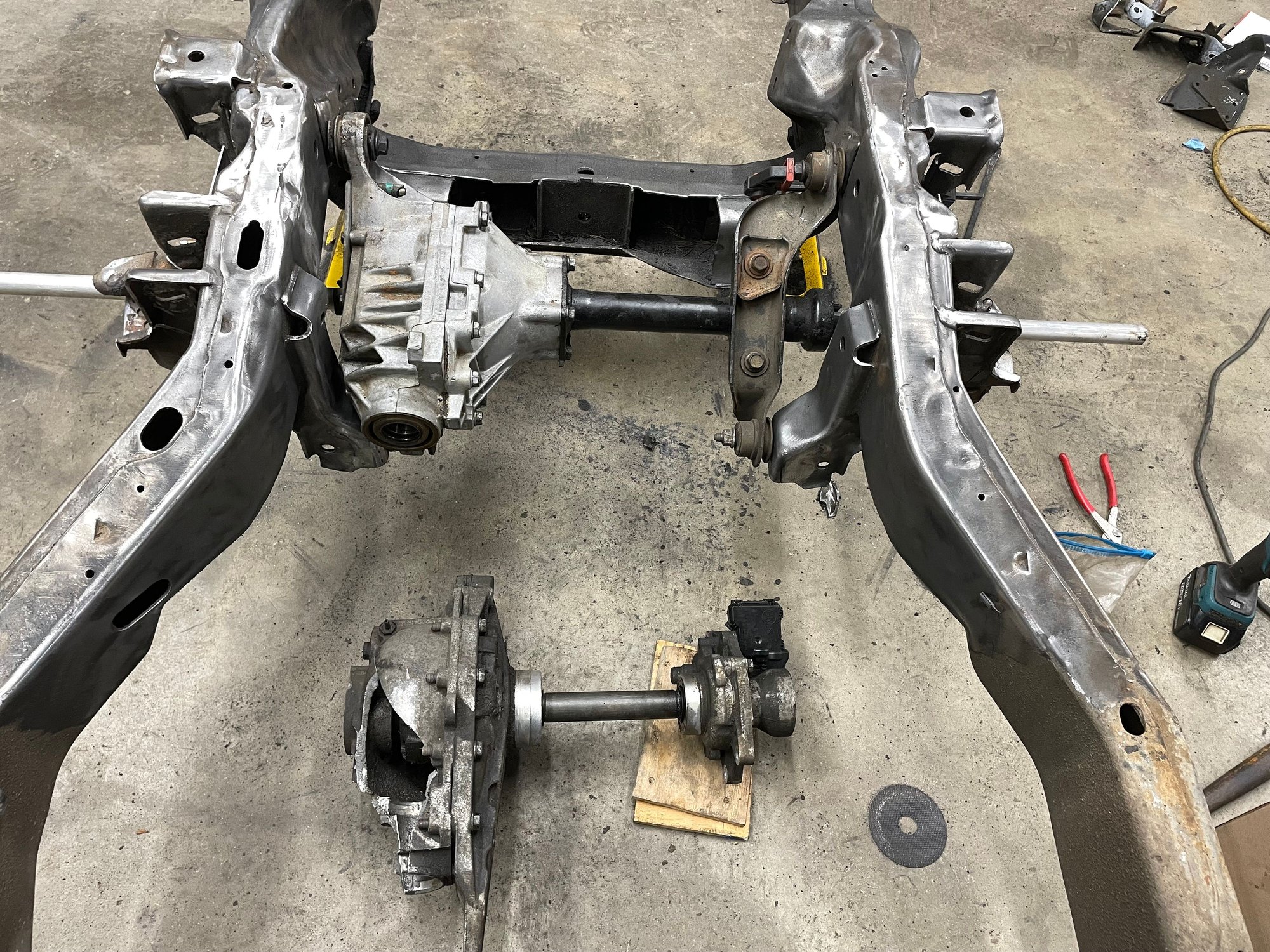

Finally, I found a guy parting a S10 Bravada and snagged the BW4472 and AWD front diff. The same trip, I got an Explorer BW4404. The V8 explorers were 31sp input and a viscous coupler based T-case. Just looking at pics, the two input shafts looked interchangeable. If that were true, then I couple pop a Ford BW4404 input into a Bravada BW4472 and have a 31sp in/32sp out T-case that could handle anything I could throw at it. There’s Typhoon guys pushing DOUBLE the power I’m planning through stock t-cases. This is where I spent the bulk of my time/effort
I opted to not use the vanilla Ford unit because of the tiny output shaft and fixed rear flange. 2010+ Camaro TR6060 guys know all about the weak flange snapping off when really power is ran through it. The ford T-case has an even smaller output. 21sp I think. It's tiny
The guts of both units were surprisingly similar with the rear planetary/ring being directly interchangeable. Unfortunately, the inputs do not interchange. To use the Ford input in the Bravada t-case, the front bearing pocket must be moved backwards. Lots of machining/welding
Instead I opted to use the Bravada output shaft in the Ford t-case. I purchased a NP241 tail section to be turned down, pressed in and welded to the Ford rear case. Another thing I found by having the actual part in my shop is that all the case info about the BW4404 is incorrect. It’s listed in about every source as having a magnesium case. It’s actually aluminum. A boon for me, as the tail is easily welded. My machine shop currently has this
As a final attempt, I tried a late model Express van AWD input. Those BW4473 cases are VERY hard to find and quite expensive. If the inputs swap, it may be worth the extra expense. So, I ordered a replacement input from Rock auto. If it fails, then I'm only out shipping both ways. Much less costly than cracking open an $1800 t-case
No dice
Keeping on with the modified BW4404/4472 hybrid

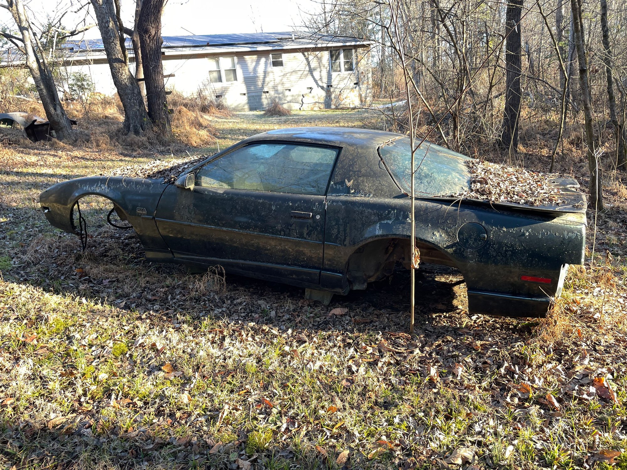

Mock-up

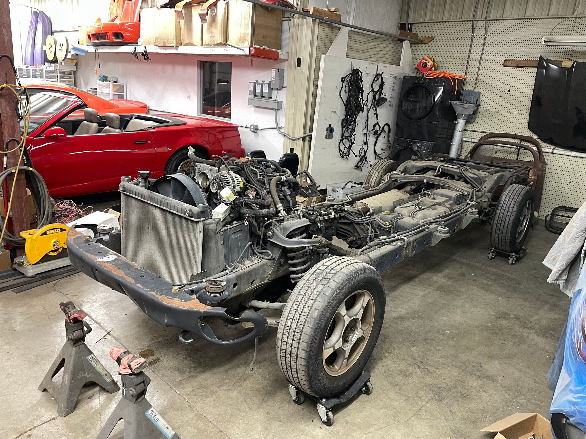

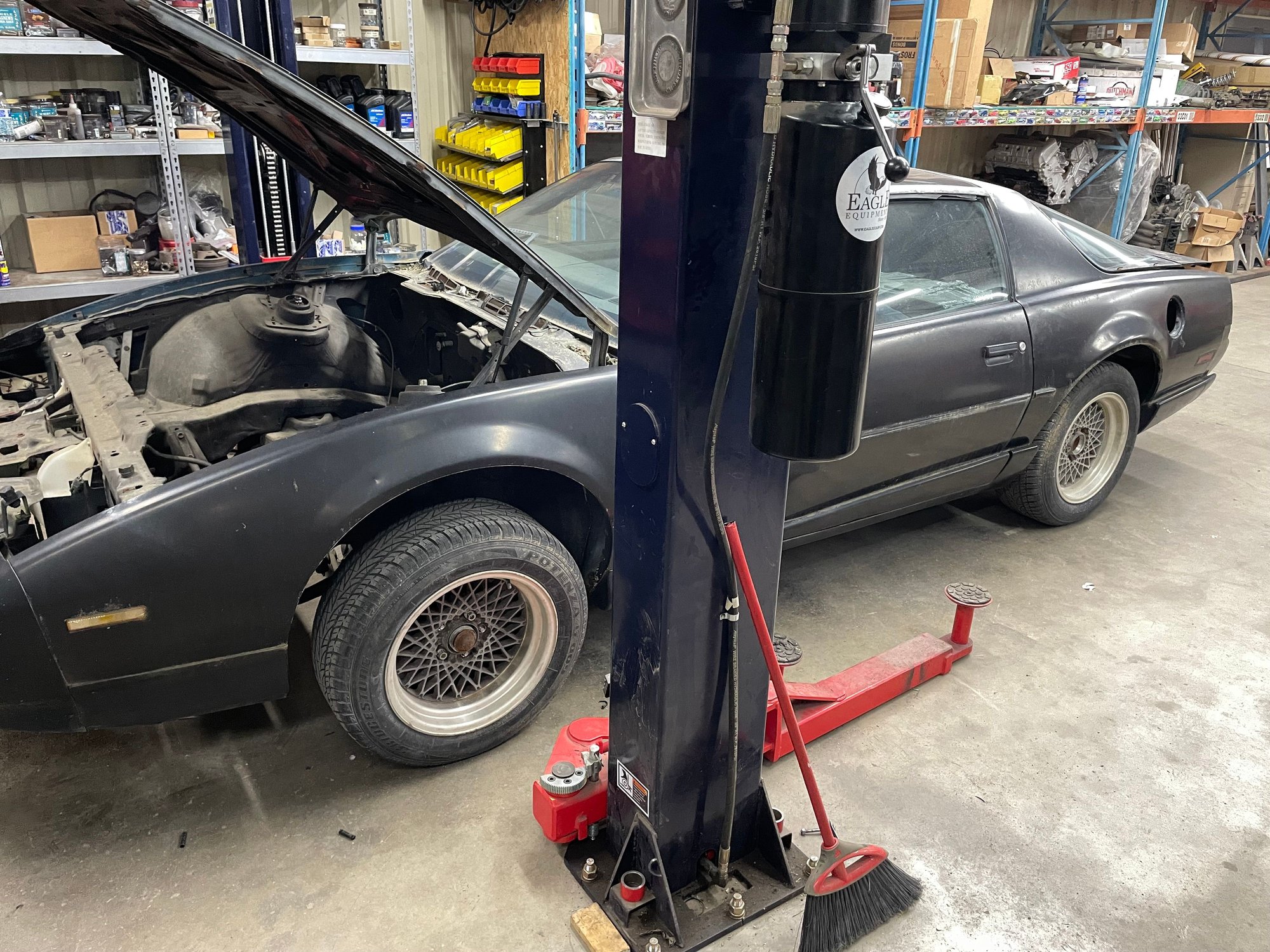

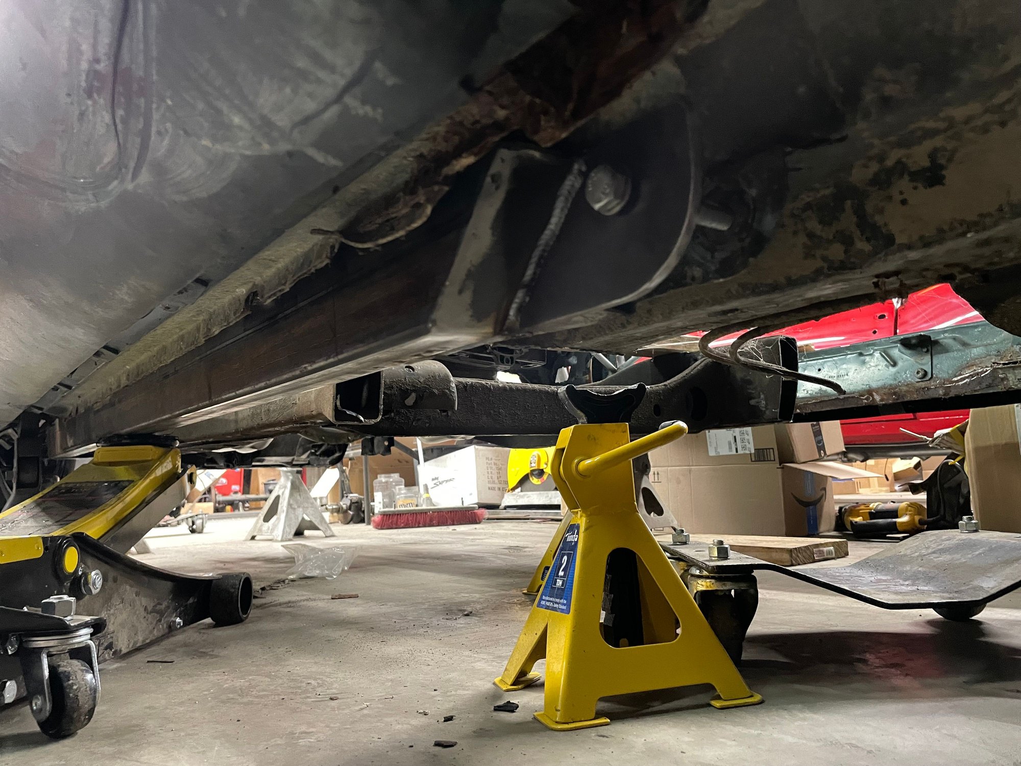

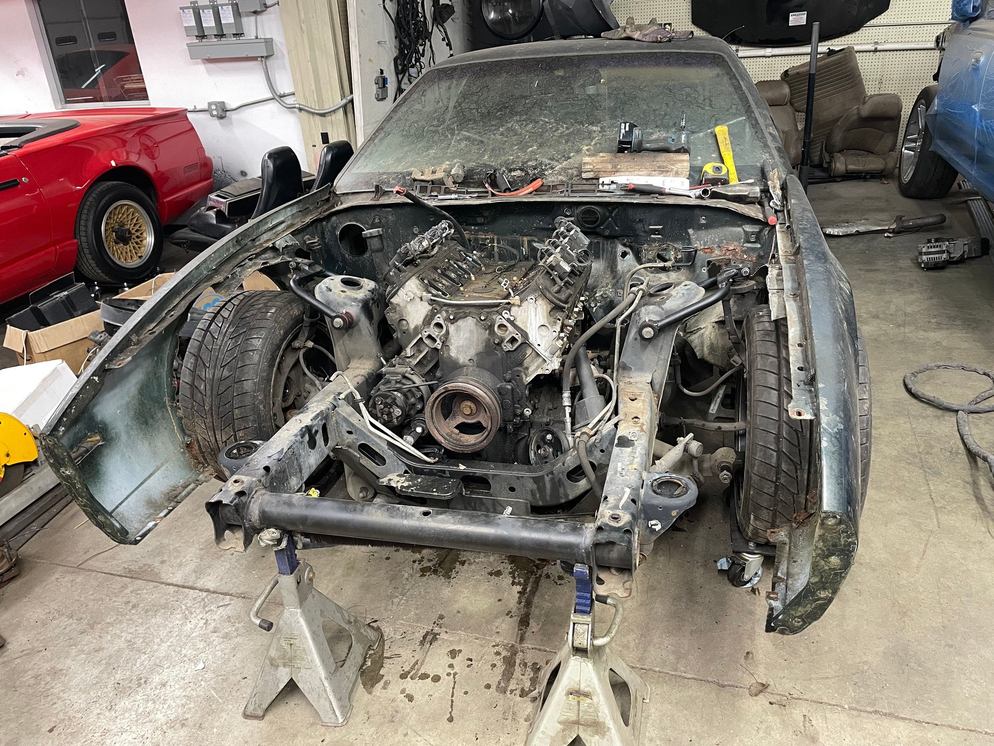

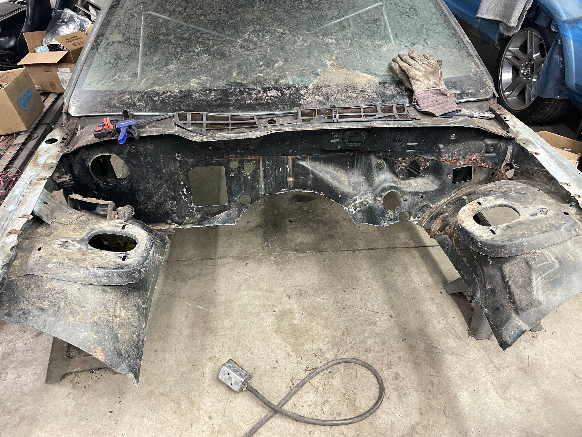

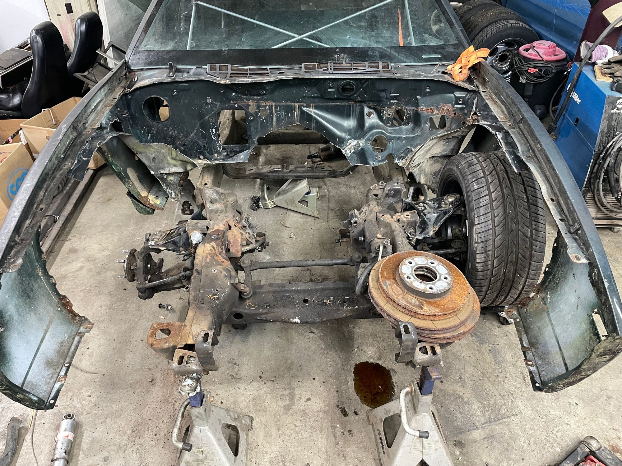

Since I’m not certain this will actually work, I decided to use a rusted out 3rd gen shell to mock up on. There’s nothing good left on this car, so why not
Stripped the last few bits, braced the chassis with conduit and cut the floor out

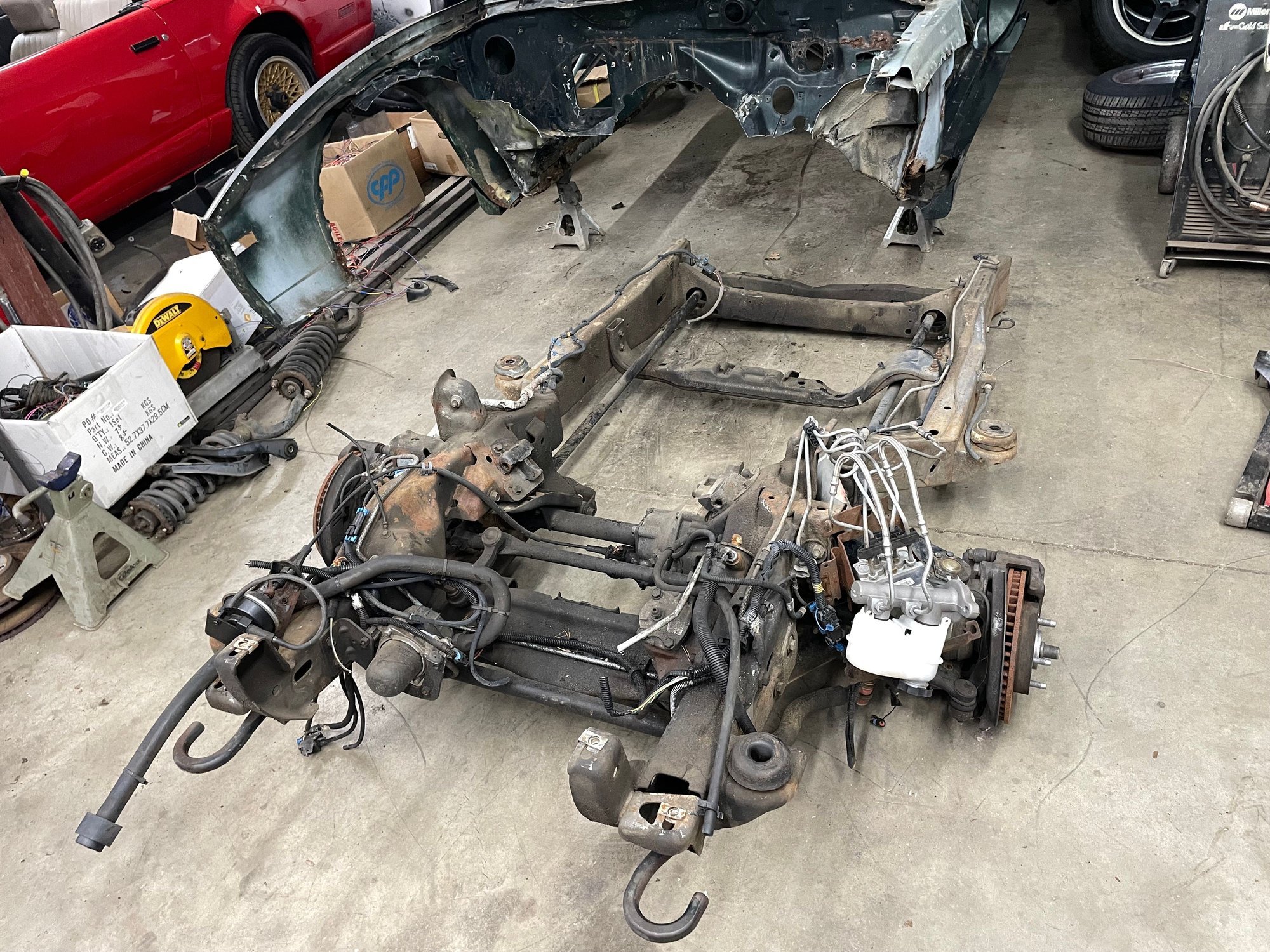

I used a trailblazer SS chassis under the 1953 build. They can be found stupid cheap, 2wd/4wd chassis are the same and this one came with a good aluminum 5.3 to recoup some funds. Body off, I only need the front half of the chassis
Test fitting. I did the 5 lug conversion and tested with C5 wheels due to the high positive offset. I also popped on a set of JDW control arms to get camber within reason
I nixed this chassis for two reasons:
The drivetrain sat too high in the car. The LSA lid would be above the hood. Trans/T-case severely limited interior/seat space
The upper control arms were dangerously close to the hood. It wouldn’t be ideal to dent the hood with a balljoint from a small bump

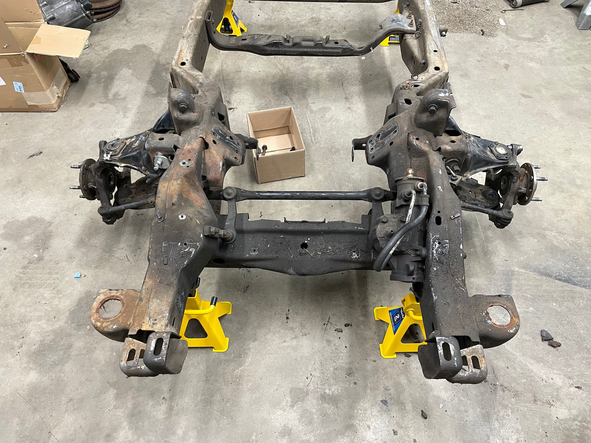

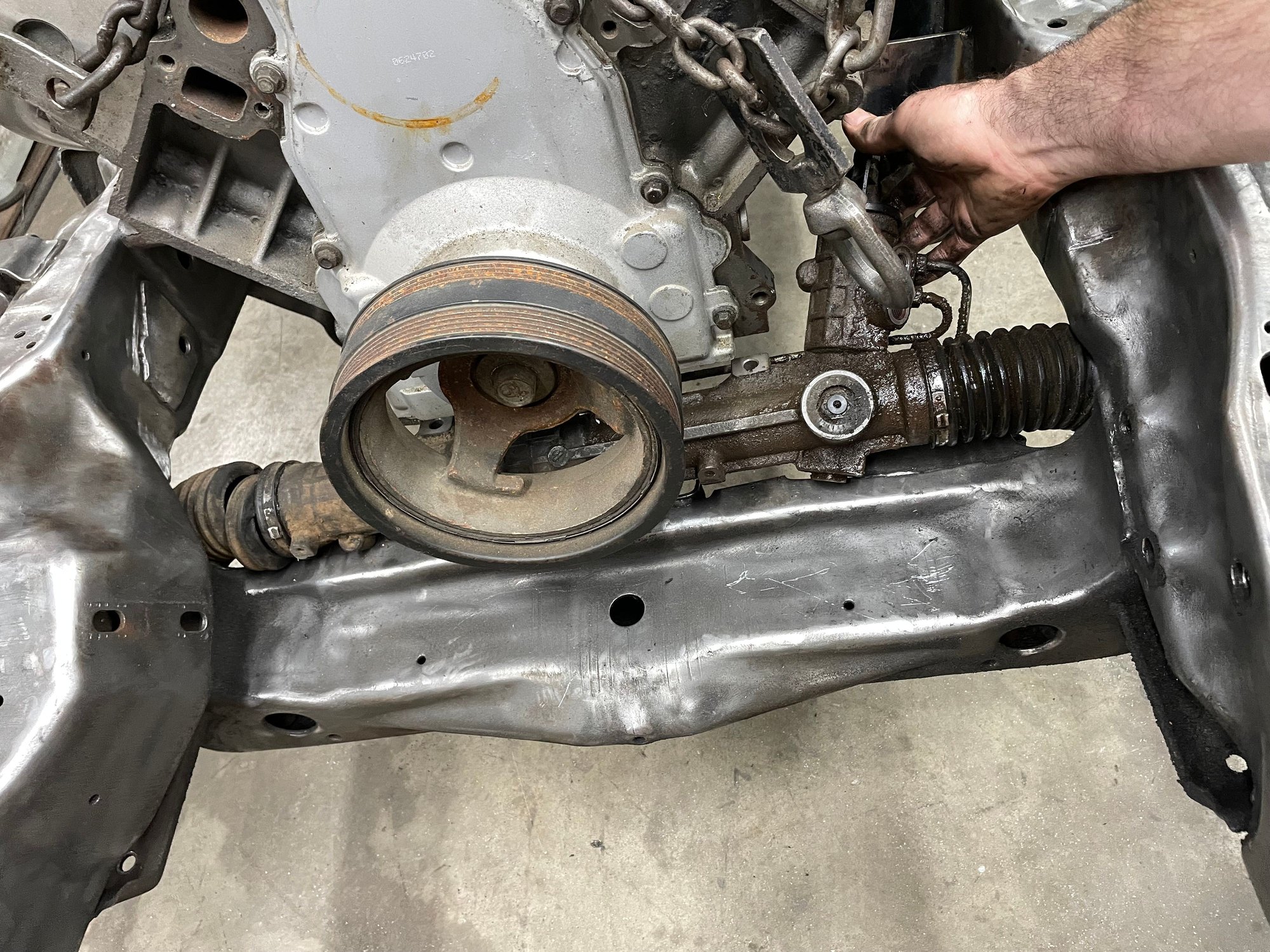

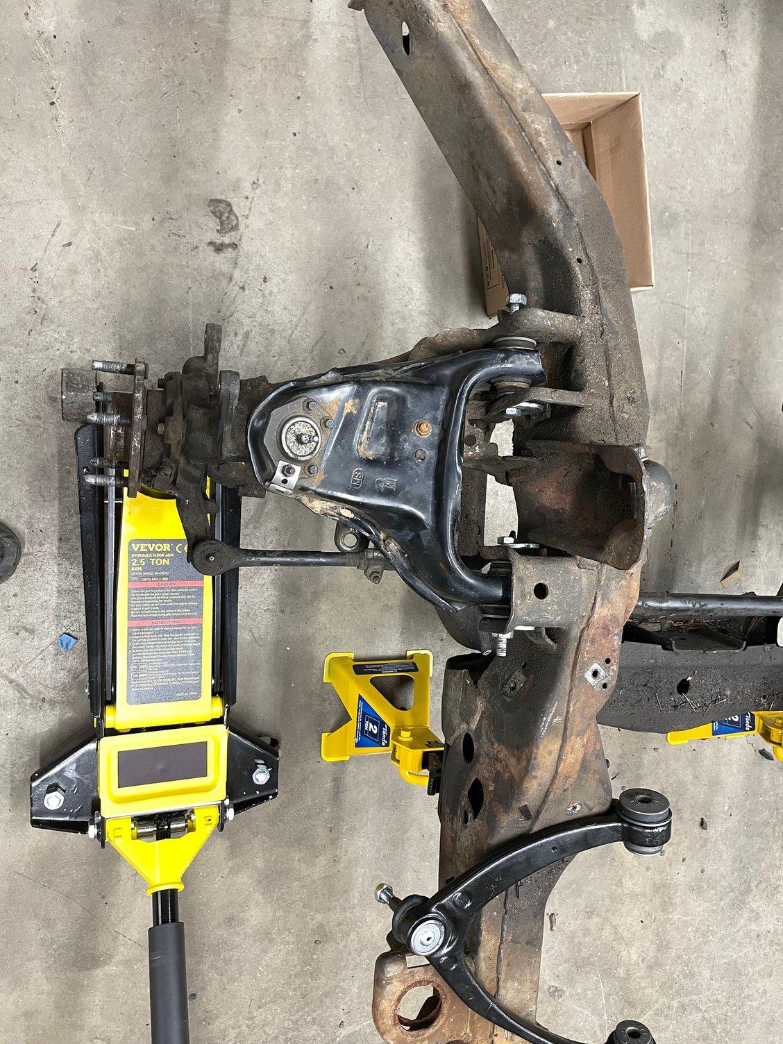

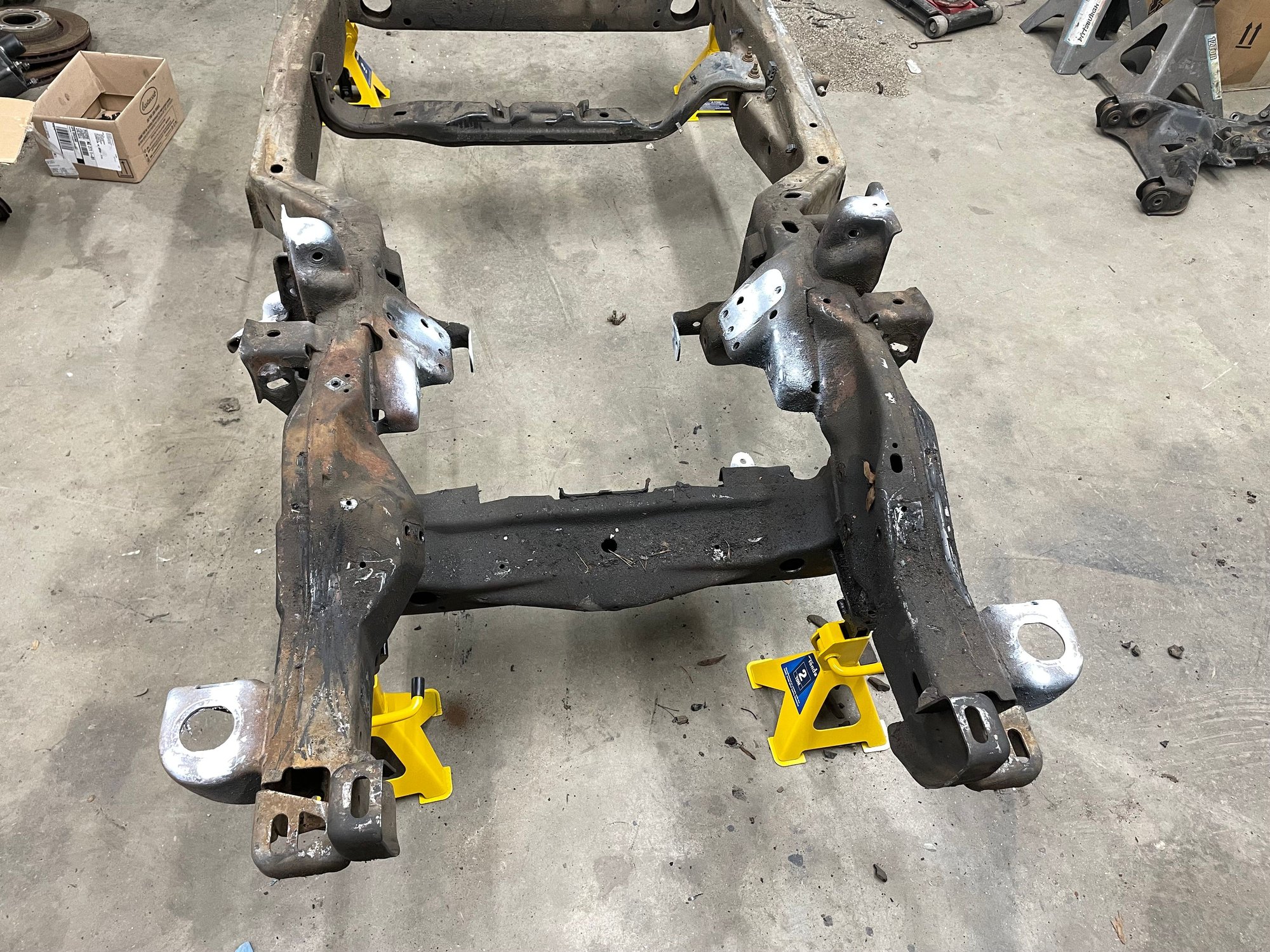

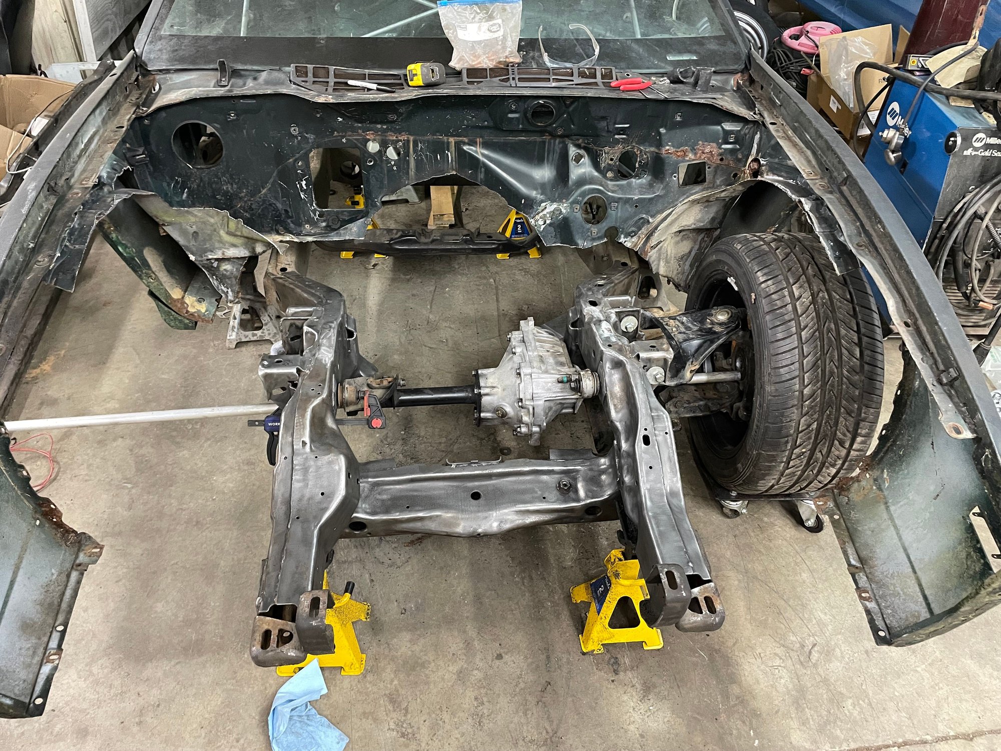

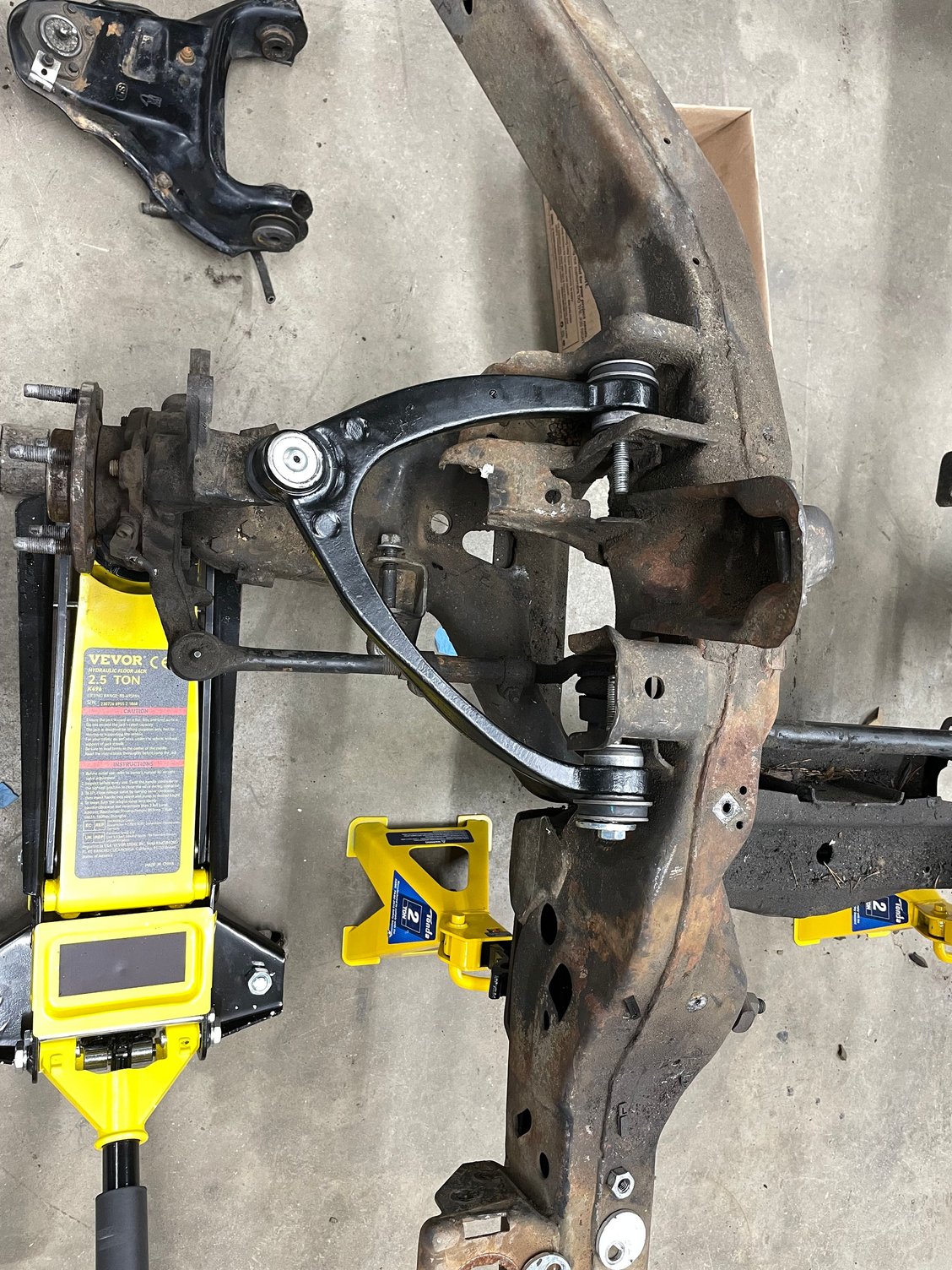

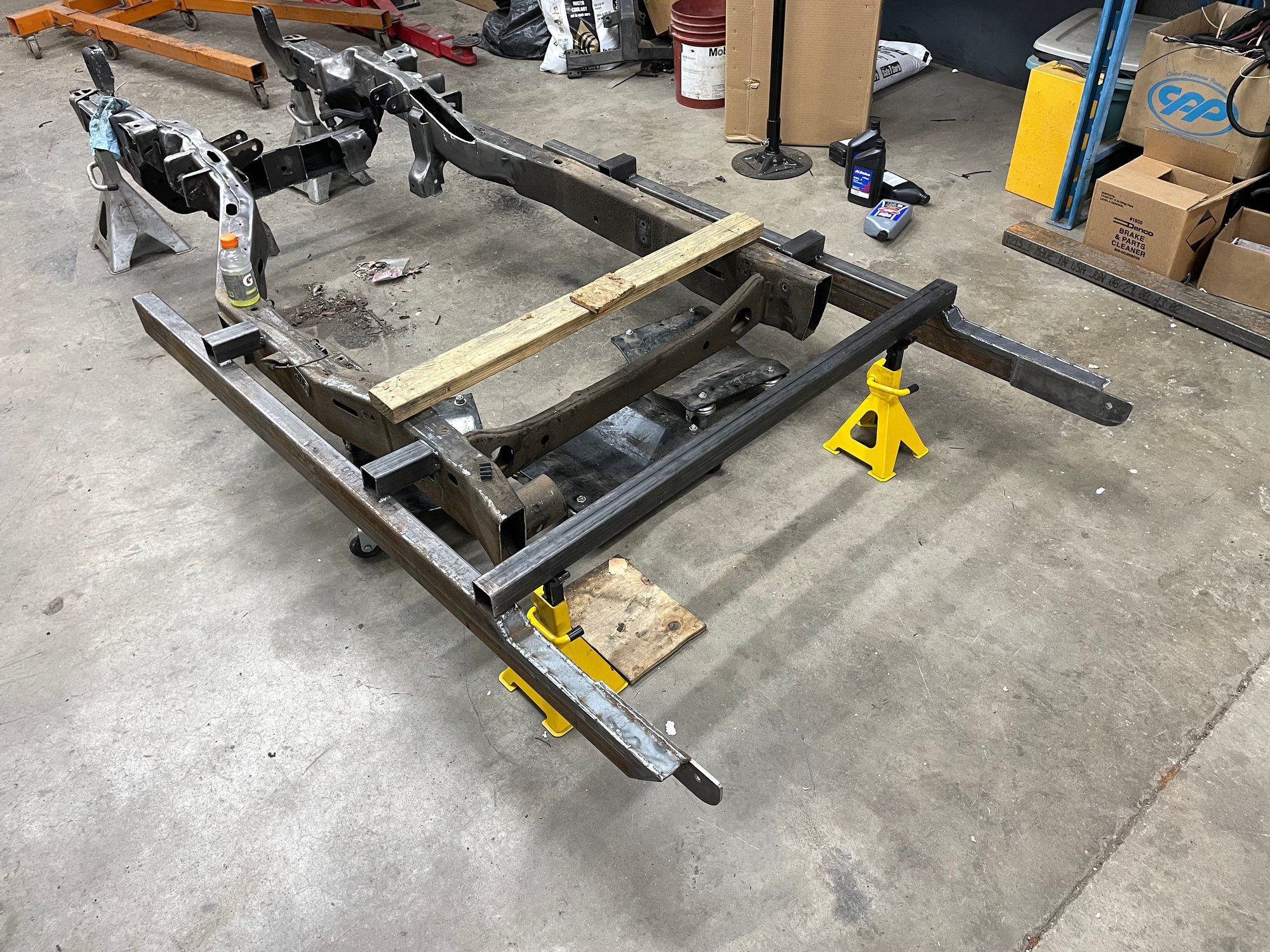

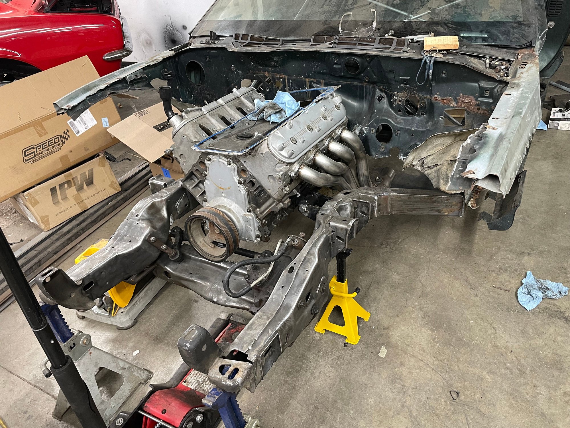

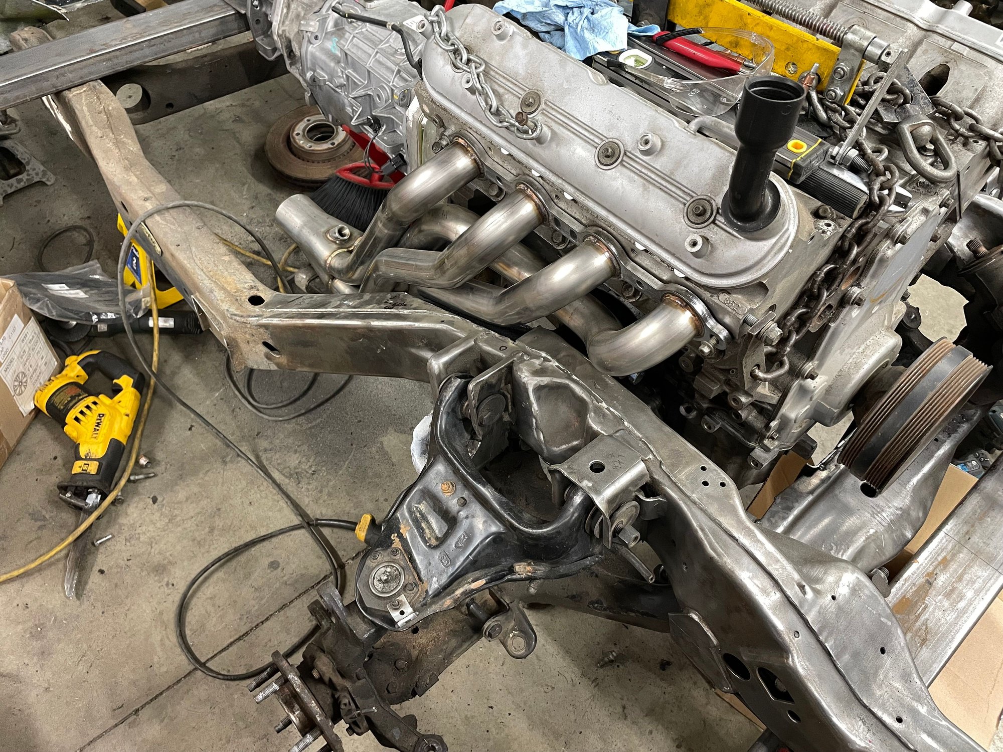

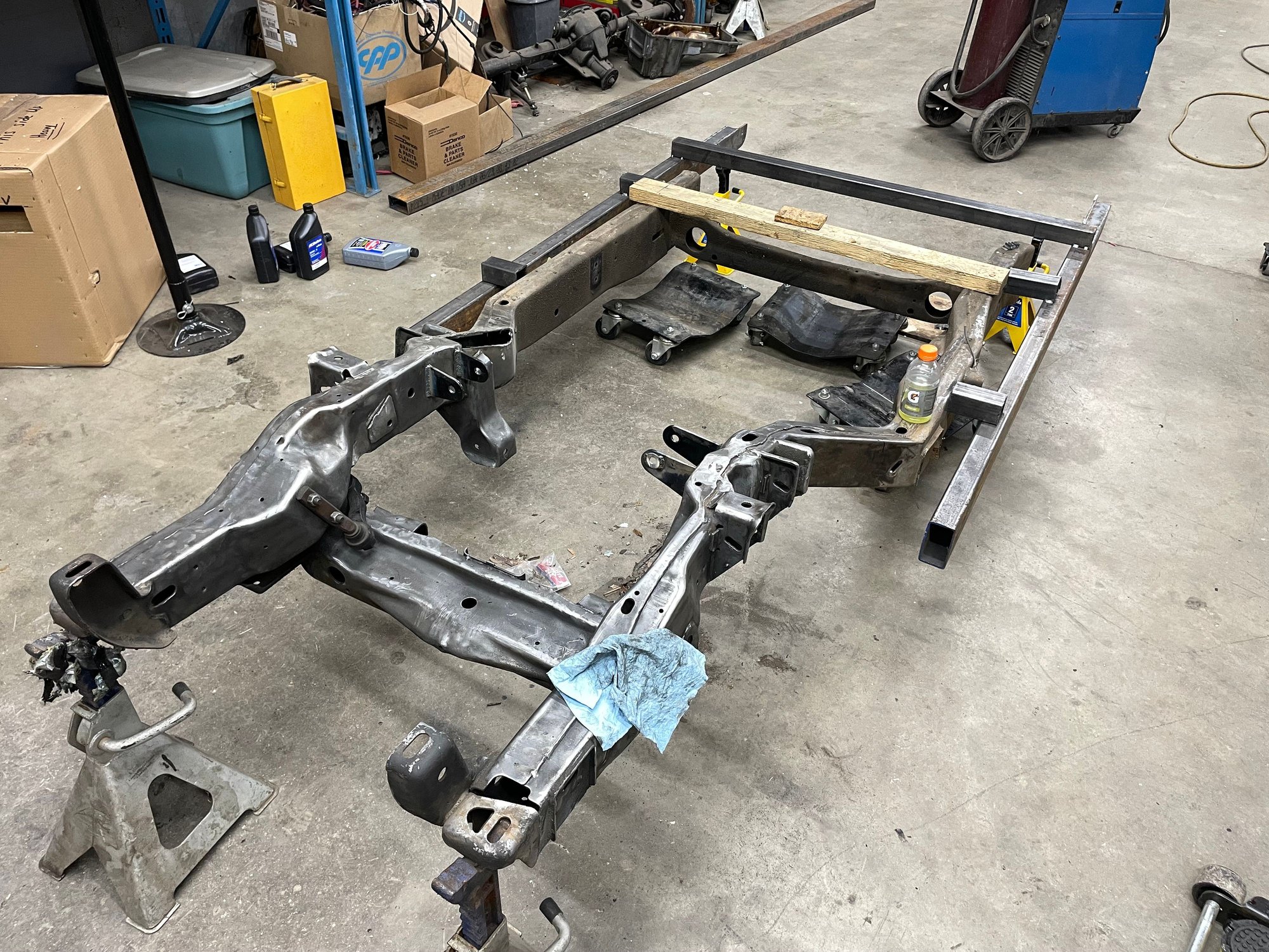

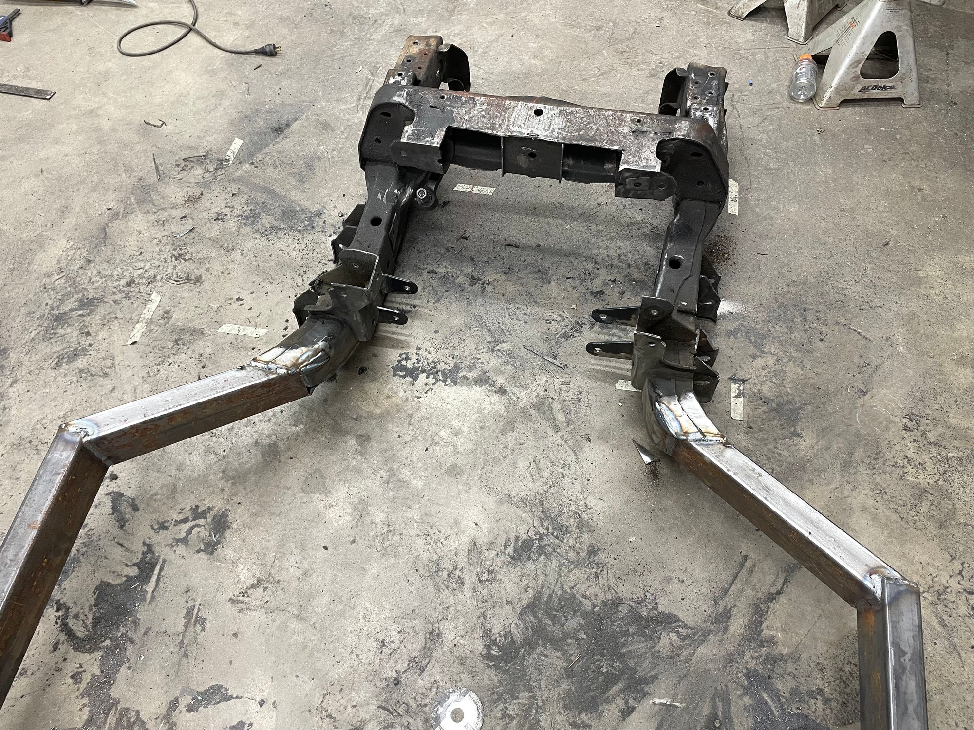

Next I picked up a S10 Blazer chassis. Originally, I didn’t want to use them because they were very narrow up front and the steering box geometry was less than ideal. Steering rack options were sketchy like 3rd gens and the few options were VERY expensive. With the steering obstacle in mind, I decided to try
This one ended up being a ZR2, high and wide chassis (edit:incorrect, it's a normal Blazer 4x4). ZR2's came from the factory with a small suspension lift and the front control arms mounted 2” farther out on both sides, for 4” wider total (more on that later). I mocked-up a 17” GTA wheel and it fit the wheel arch perfectly. The extra width positions them perfectly. Onto the interior, the trans mount is only 2” higher than factory 3rd gen. Definitely workable, since I planned to custom position the drivetrain anyways. I put the 3rd gen strut towers back on and they clear the wheels nicely
With that, I’m ready to begin the custom half-chassis. This will be an enormous undertaking, there is nothing simple about it. Plans:
2x4 tubing for the main frame sections tied all the way back to the 3rd gen LCA’s - Done

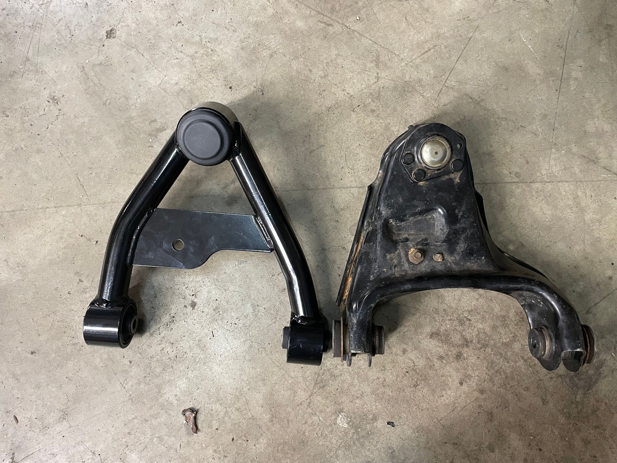

Stock s10 suspension/hubs/geometry. May change UCA for full size to clear coil overs - UCA required

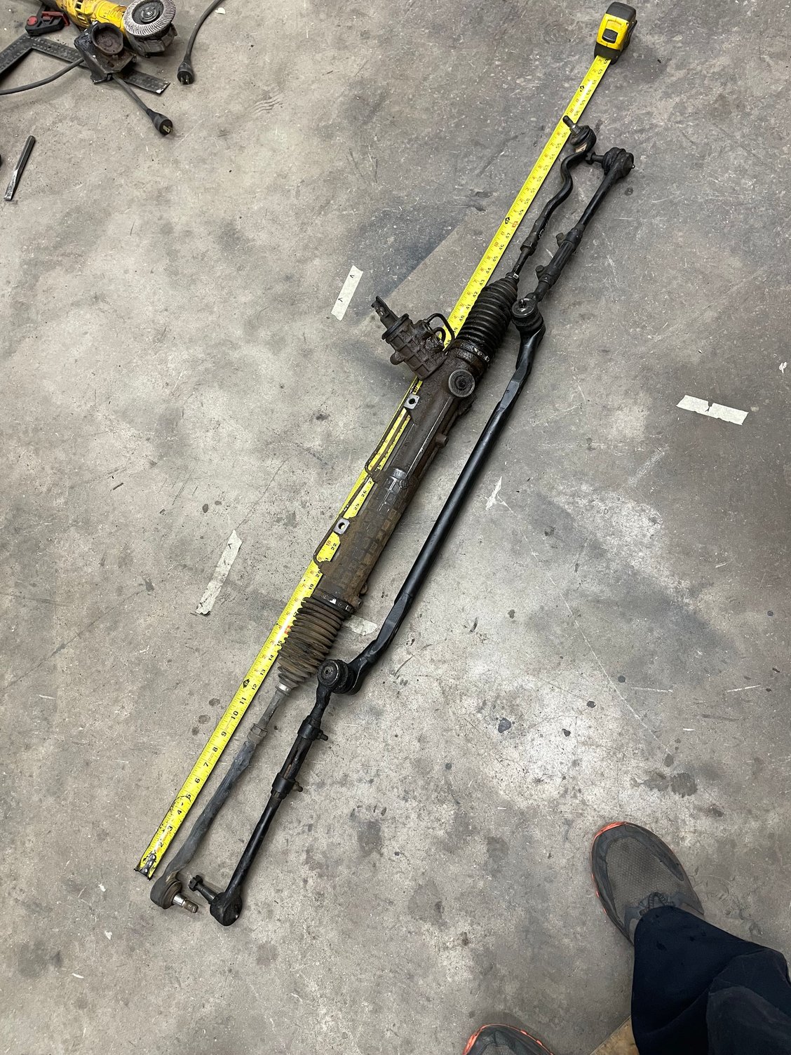

Figure out a coil over conversion to eliminate the S10 torsion bars - Torsion bars don't fit, coil overs required
Figure out if the steering box will work or if an intrepid CTO rack is required - 1997 Thunderbird rack used
Figure out if any of my headers will fit or if custom headers will be fabricated - Speed engineering TBSS headers fit with a frame notch - Done

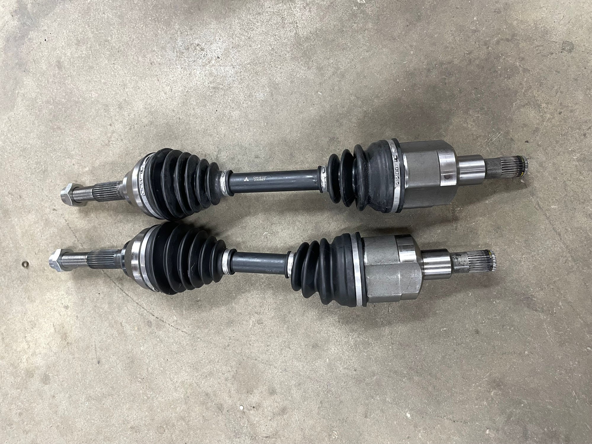

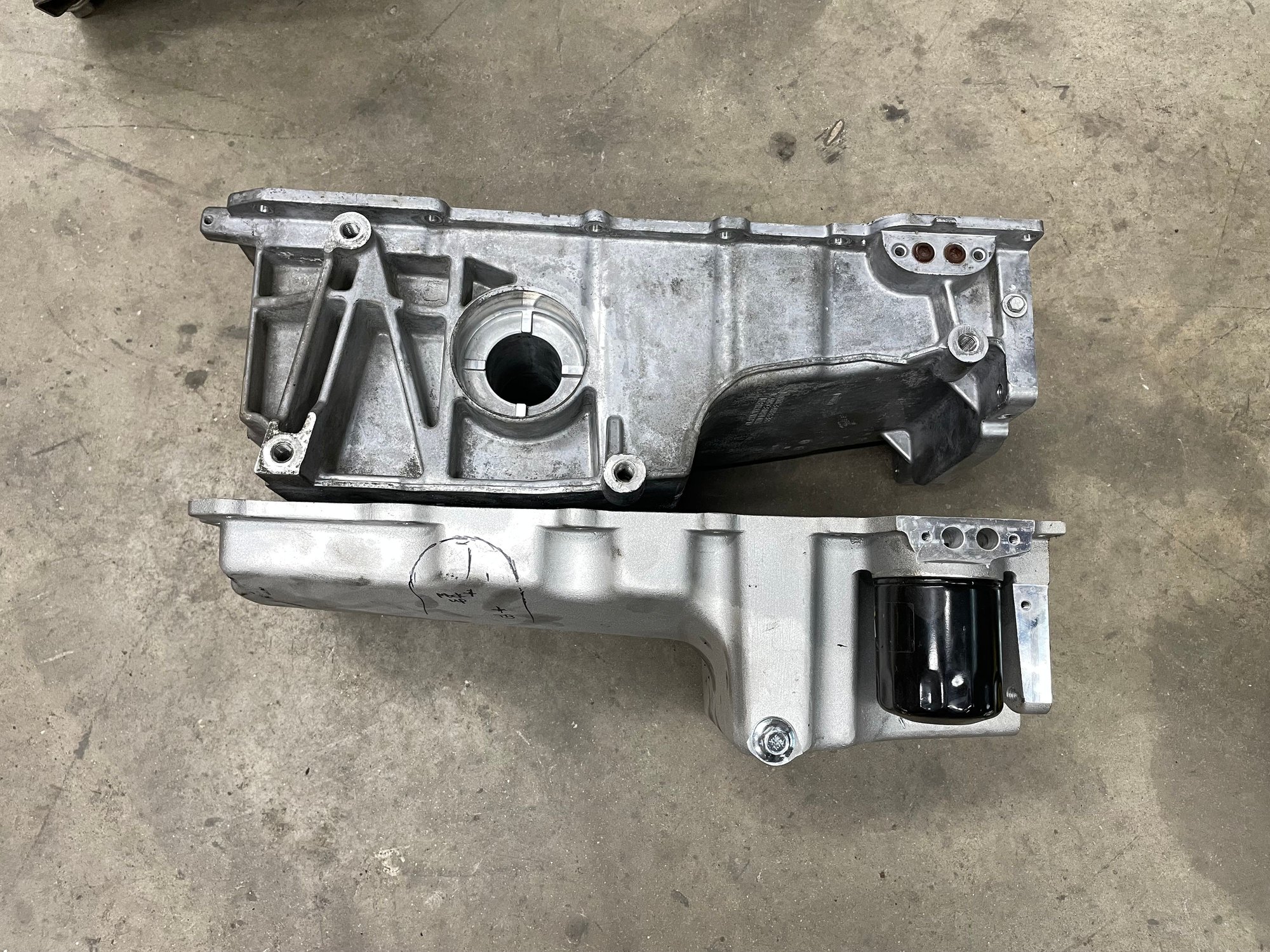

Figure out how to mount a trailblazer front diff to the engine. Either use ZR2 CV axles, or do something custom - One stock S10 axle, one ZR2 axle - Done

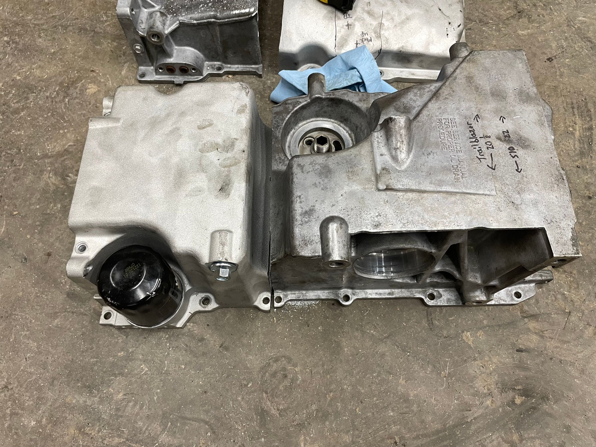

Modify the oil pan to clear the TB front diff. Possible oil filter relocate - Half TB, half holley pan, standard filter location
Figure out a way to connect the new chassis to the old in an easily transferable method. Alignment holes, common fitment etc - Wing it - Done
Fab new tunnel/tubing to provide support and be minimally invasive to the interior
Tie the new chassis to the 3rd gen without losing structural rigidity - Hope and prayers

I got a few hours to play with the project today. Decided to prep the S10 frame for fab
First up, possible A-arm option to allow a simple coil over. There's nothing wrong with the S10 A-arm, except the coilover physically cannot fit in the opening
I saw a S10 build that used 2007-13 full size truck A-arms by simply moving the front control arm pocket forward. New A-arms were $60 on amazon. I'm sure the BJ/bushings will be terrible but, I can press good stuff in at the end if they work
What do you know, they bolt on. So, I also got some 12mm SS round stock to keep stuff aligned when I modify the chassis. I decided to measure if they were within reason. They're not
CL of the pivot bushings to the BJ grease fitting on the S10 is 8" like all GM metric A-arms of the 70/80/90's. The full size is 9", so negative camber out of the box. To move the bushing boxes inboard 1", I'd have to pocket the frame and figure out how to get an adjustable bolt in there, UGH
The full size BJ is also 1/4" forward from the S10, so caster is also screwed
So, I get to build my own, nothing is easy it seems. Atleast I can return them
Next up, the chassis was stripped entirely. I shot the brackets to remove with white paint. This is going to take a while
I decided to buzz it with a wire wheel while I was down there. What a mess
Mocked up the empty S10 front diff. While, I won't be using it, I do need to accurately locate the axle shafts
A simple piece of scrap with a hole in it is perfect to align the axle CL
Hopefully this pic shows why I'd rather run a TB front diff than S10. The middle seam is approx the same for both units. The TB unit can fit much tighter to the engine/oil pan than S10, so the engine can possibly be mounted lower. The PS shaft/disconnect housing is a terrible design, so I'm considering a few options to fix/replace it
Ready to start mocking up the engine/trans

Hard to find time these days but I was able to sneak a few hours in to play with the project
The S10 diff was mounted to pull the axle CL. The end plates hold the tube in place with the diff removed
A junk engine was used to mock everything up. This one still had a crank and windage tray to establish max depth. I needed to identify F/R measurements to begin the oil pan modifications
Trans is pretty close to stock height
This is a holley 302-1 oil pan I had from a prev build. My intention was to cut a notch and weld a tube to go through the pan. I could weld diff mount stands to the pan after the CL was determined
The forward and up mark is what the mock-up identified. The bottom is a factory V8 trailblazer pass through CL. The difference is 3/4". I'm not reengineering an oil pan design for 3/4"
I ordered a V8 TB pan to try next. That should allow me to build the motor mounts

Lots of time spent on this only to change directions due to excess complexity and machining. Worth documenting the thought process, however flawed
This is a trailblazer V8 oil pan compared to a normal LS rear sump (302-1 in this case). TB pans are notorious for causing oil starvation issues due to the terrible pickup design. As such I've been keen to avoid them. My goal was to use a tried and true rear sump pan, fabricate a structure to hold the TB front diff on. The solution to the PS axle tube was TBD
A hole transfer plate was made to position the TB diff without the TB oil pan. The mount location was moved forward and up slightly to match the measured CL of the original S10 diff. The goal for keeping that measurement was to maintain S10 CV axle geometry. In hindsight, that location wasn't critical
I added a Fbody LS1 pan and attached simple brackets to emulate two diff mount holes
Trying to avoid some battles with a TBD steering rack, I notched a section of the front diff to clear the S10 drag link. This tab was for 6cyl TBs. All TB diffs have two bolt patterns
Hey it clears!
Tie rod contacts the diff well before full lock. Pretty sure converting to heims will give enough clearance, but detract from the junkyard special feel of this build. Oh well, pretty sure a bump steer kit would be a given on this regardless, so what's a little more on the inner ties

Suspension mock-up. CV doesn't bind
Decided to mock-up my C5 12.8" brake kit and see if it clears the 17" repop GTA wheels. 12mm spacer and they do. Caliper to spoke clearance is about 3/16"
Back to the pan. Transfer plate to position the PS housing on the diff
This was where the sheer amount of work and custom parts really hit me. The diff needs a complex structure to support it and the torsional load it'll exhibit. Using the S10 housing tube, a round plug needs to be turned, pressed into the diff and somehow bonded well enough to keep oil inside at two separate joints. That and it needs to be dead on accurate or the shaft seals will oval and leak. Pretty daunting
Or I could simply use the TB pan, with some mods
I'd cut it in half and the 302-1. Weld the two together and weld a new angled floor in the front so only the rear sump is used. No custom pickup tube, baffle kit or anything. Cutting and fitting can be done with a grinder. The only expected machining is to true up the top pan rail at the joints
The front will need need a notch to clear any kind of steering. It's dead space, so nothing critical

I bought 3 sets of speed engineering long tubes for this build for mix/match or worst case to be used as parts kits. C10, 3rd gen, trailblazer SS
Luckily the trailblazer set fit with small frame notch. That's a huge job checked off the list
The last thing I had time for was the front CV axles
DR side was easy. The TB diff flange was placed in the same location as S10, so the DR axle was stock
PS was more of a challenge as the entire TB diff/ext housing ended up 2" narrower than the S10. That meant custom stuff in the diff or find/make a CV 2" longer. That's where the ZR2 stuff kicked in. I was under the impression that I had a ZR2 frame based on the lower A-arms. After measuring the old CV axles, and comparing them to rockauto, I found they were the normal length. That made the route clear as it would be one LH S10 (regular) CV for the DR, one LH ZR2 for the PS. S10 diffs use a male socket for DR and female for PS where TB are male on both
With the drivetrain located, suspension, axles and exhaust figured out, it's time to mate the two chassis together

New CV axles came in. You can clearly see the difference from base S10 vs ZR2. Fits perfect and off the shelf, my kinda find

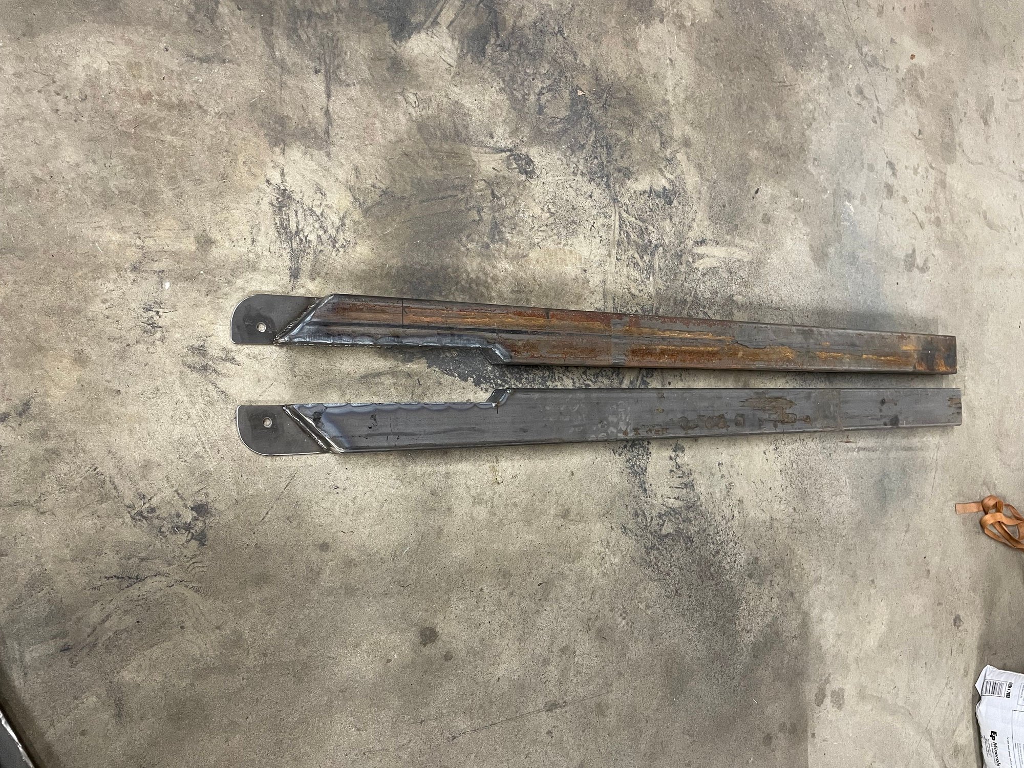

With that solved, I moved onto building the rocker SFC's that will join the front frame section to the rear of the car. Basic 2 x 4 x .125". I notched the rear section to clear a stiff piece of 16ga sheetmetal. It houses the LCA mount and joins it to the rest of the rear chassis. Seemed important, so I went around it
Basic 1/4" plate for one side of the SFC saddle. I can add the other side/bottom after the fact
Next came hours of leveling the body and frame sections. Once I was satisfied, I tack welded small stubs to join the two frames together and removed to finish join them
Notching out for the joining angled piece
I filled in the voids before flipping it over
Old May 1, 2024 | 04:44 PM
Pocket's Avatar
iTrader: (24)
Joined: Jun 2005
Posts: 8,117
Likes: 361
From: NC
Car: 91 Trans Am
Re: AWD 3rd gen build
Upside down, I was able to cut off the bump stop monster bracket. Then the S10 middle section could be removed entirely
I wish I had more time to buzz the bottom of the frame. I'll have to do it eventually, but today I'm rushing as-is
Flipped right side up and all the final void filled
There you go, most complicated set of SFCs ever

I started on the oil pan modification. Take two and make one. Initial rough in's
The BMW E46 rack showed up. I chose this primarily because of overall travel and ratios
3rd gens have around 6.75" of travel. S10 4x4 6.1", BMW 150mm or 5.91". Much closer than the 4th gen 4.5" of travel that people often use
"Good" BMW racks can have a 13:1 ratio, while most base racks like this greaseball get the more common 14.5:1
WS6/IROC boxes had a 12.7:1 vs the base model 14.1:1
Rough mock-up
I'm going to nix the BMW rack on this build for packaging purposes
To make it fit, I'd have to chop out the frame under it, then box it back in
Cut the center hardline port off and move it to the front of the rack
Notch a big C shape into the oil pan
Fab mounts to hang off the rear
Tie rod length and steering shaft orientation aren't major concerns though
What concerns me most is engine R&R. Due to the rear mount arrangement, the rack cannot be taken loose and slid forward to lift the engine strait up. Instead, the engine mounts must be removed. The engine lowered a couple inches rearward and slid forward after clearing the rack. Attach motor mounts last. My concern is firewall clearance in such a maneuver. I do not want to weld the structure together and find the engine no longer clears. Seems important
I may try a Dodge intrepid rack next. The have a 6.5-6.75" travel, but the ratios are 90's econo-car blah. Center take off tie rods may be a challenge to fit into this package too
I will hang onto the BMW rack. I have a feeling it would be a fine upgrade for a more traditional 3rd gen than this monstrosity I've created
Lastly, I bought some cheap amazon S10 lift A-arms. The biggest hurdle for front coilovers are clearing the tiny pocket on factory UCAs. Chop the center metal strip out and bingo
Lift arms also change the balljoint angle and overall length to attempt to correct some camber issues due to being lifted. These aspects may or may not be issues themselves. At $70 it was worth a try
I do need to press a balljoint out and determine a quality replacement. They're not the same as the original S10

With the oil pan in the works, the last major hurdle is steering. I ordered a 97 T-bird rack to mock-up. Hopefully it will fit a little better than the BMW rack
Anyways, one last mock-up in the rusty GTA. The new frame/SFCs fit perfectly
I decided on this 91 TA for the build. It's a shame to cut up a rust free car, but I haven't had any bites selling it
