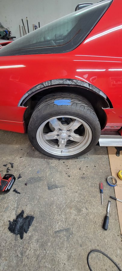

I mini tubbed the car years ago and was running a 12" wheel and 335's on the back and had fit 10.5's on the front.
Since then I've changed everything and my track width is looking to be about 5-6" wider than the factory sheetmetal, maybe more depending on some variables. So on the front at least I'm looking at a 2-3" flare past where the factory wheel lip is located depending on final wheel selection and suspension settings.

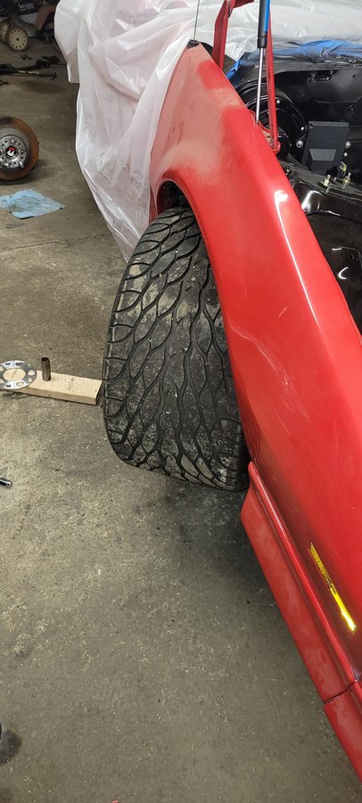

This was just goofing off and fitting the old 18x12 with a 335/30 on the front to see how it would clear. Surprisingly it fit and cleared everyting except the tie rods when turning but the steering arms need to be shortened anyway. I think this wheel and tire sits 3" past the fender lip but the wheel offset isn't right for the front suspension design

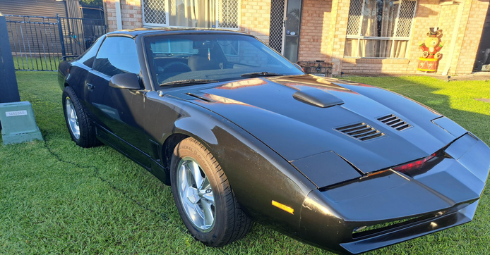

I was just about to start a new thread on this, but I'll piggyback on yours and maybe we can get the right info...
My mate sent me a video for flaring "any" guards from Eastwood that made it look super easy if you're willing to cut into the car, and this is what I'm looking at doing.
I have an 85 TransAM with a 4th gen rear in it which already sits a bit out of the guards.
I then have a set of 0 offset (4.5" backspacing) 18x8" rims with 245 55 18 tyres on them and I have the front tyres rubbing on the fender and the rear right fender cutting into the tyre.
I'm planning on doing the Eastwood cut, extend and shut to get the flares over the tyres, but I still need to check if the wheel will have sufficient spoace underneath to clear.
The other issue is, this is happening on the current springs, and I just bought a set of 1.5" lowering springs to bring the ride height down which is going to need even more clearance.

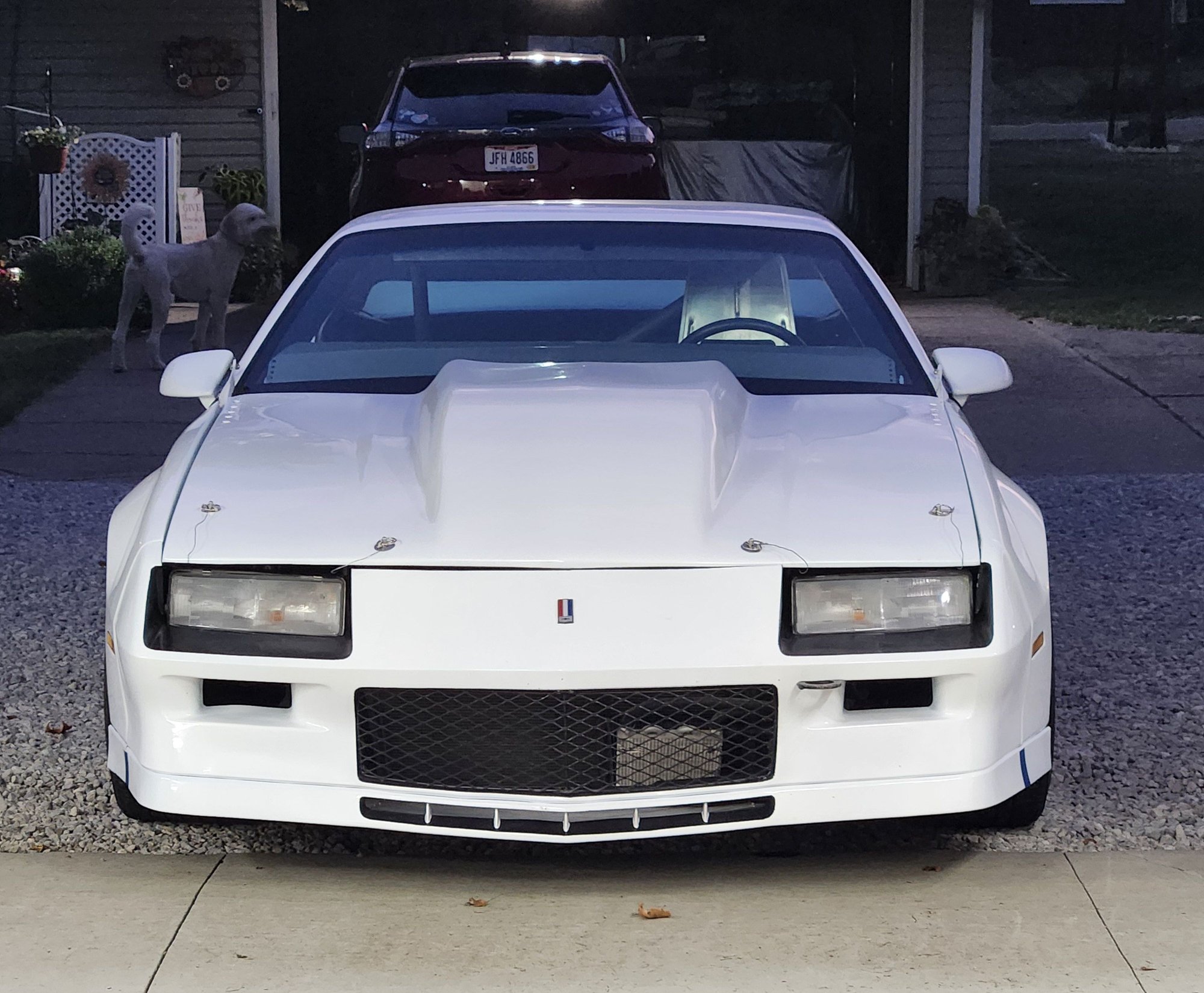

You can look at my thread "homebrew road racer" here in the fabrication forum. It shows in great detail how I cut and flared the front fenders about 2" per side, maintaining the stock shape of original wheel opening and wheel lip.
Old Dec 13, 2024 | 08:17 PM
83RDRACR's Avatar
Joined: Aug 2007
Posts: 682
Likes: 45
Re: Fender flares.
in finished form

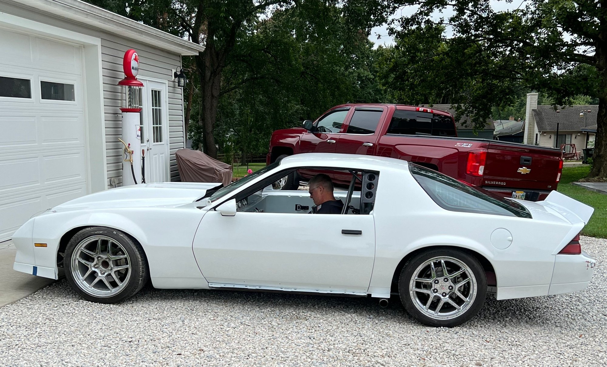

I just started doing rear flares because I added a C6 rear suspension/transaxle to my build. I have to use Corvette rear wheels and that requires changing the fender lip height and an extra 1" clearance needed.

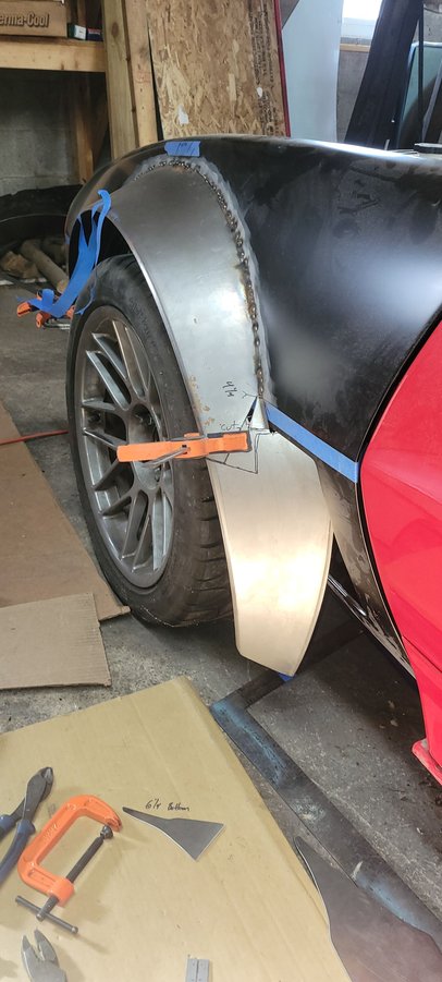

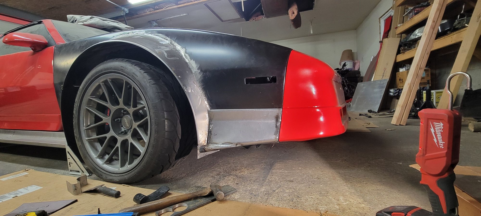

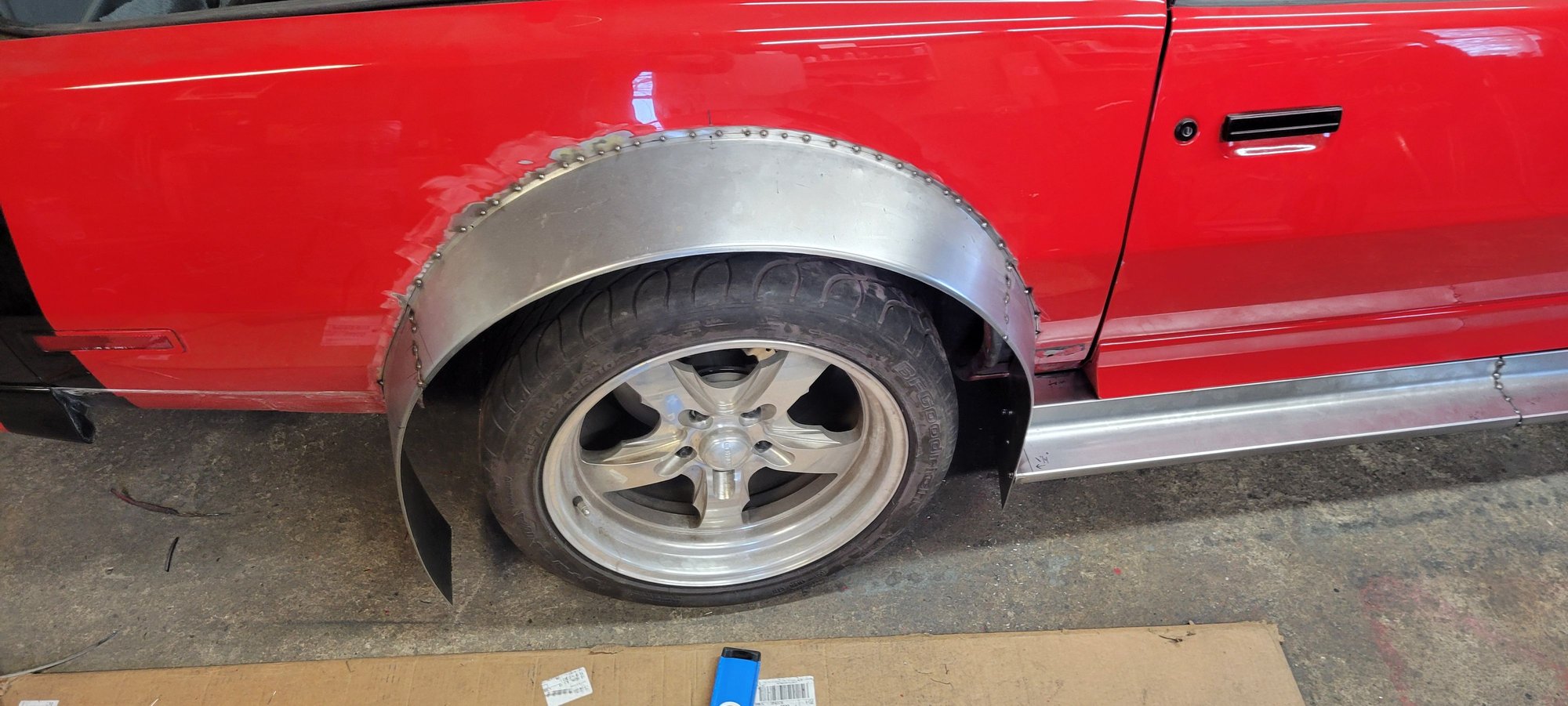

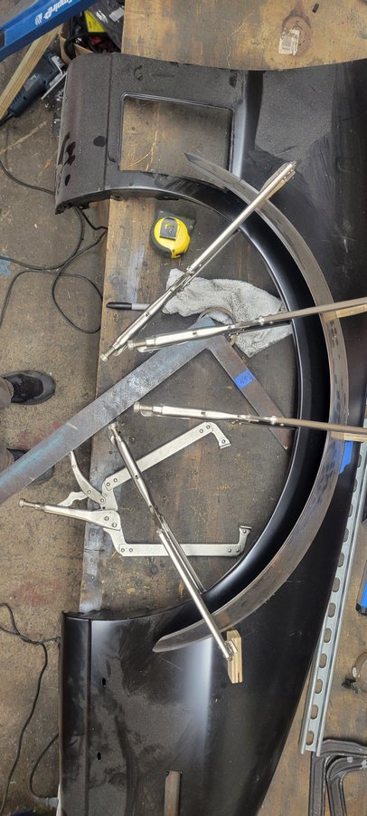

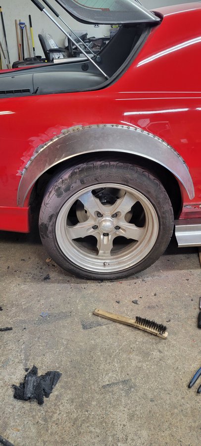

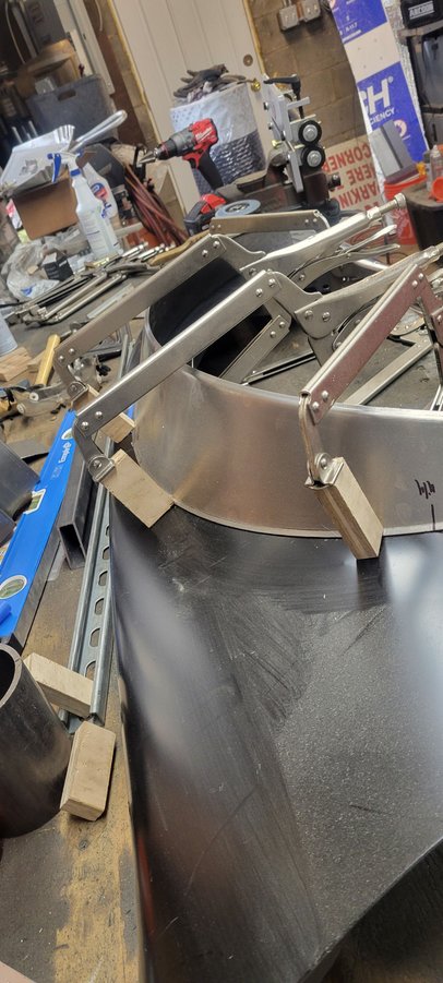

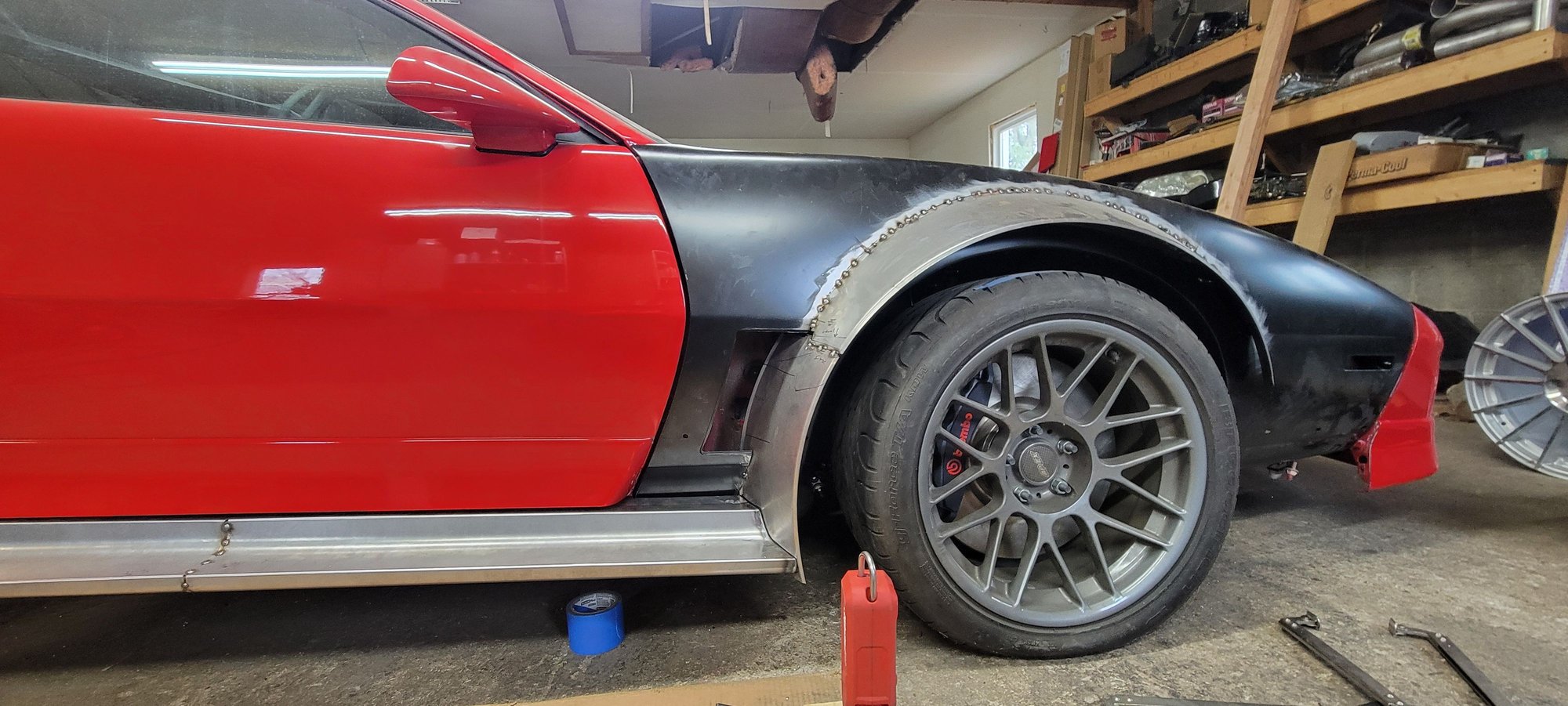

Going to bring this one back up. So I've had almost no time to work on this but did get a little experiment started. Started with a fender and have the main flare tacked in and will be tieing it back into the lower fender below the center body line of the fender
the hurdle right now is what to be with the ground effects. Im thinking about trying to make them out of metal as modifying the factory pieces isnt that easy.

Old Nov 27, 2025 | 09:08 AM
83RDRACR's Avatar
Joined: Aug 2007
Posts: 682
Likes: 45
Re: Fender flares.
Originally Posted by //<86TA>\\
what you've done so far looks great. I was going to suggest pulling the front of the fender out at the bottom to cover the tire, but you've already added the extension to the bottom of the flair. Still looks good though.

It's looking awesome. I haven't started on mine yet but will hopefully get to it after xmas. Mine's on an 85 Firebird so I'm doing the C5 brake upgrade, 18" wheel upgrade, and flares at the same time and just for fun doing a complete teardown to rewire the body harness and then after everything is done a respray, so it'll be a fun "little" project.
I'm thinking I might have to invest in an english wheel or whatever they're called to get the curves in the metal to match up to everything.

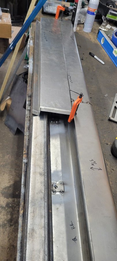

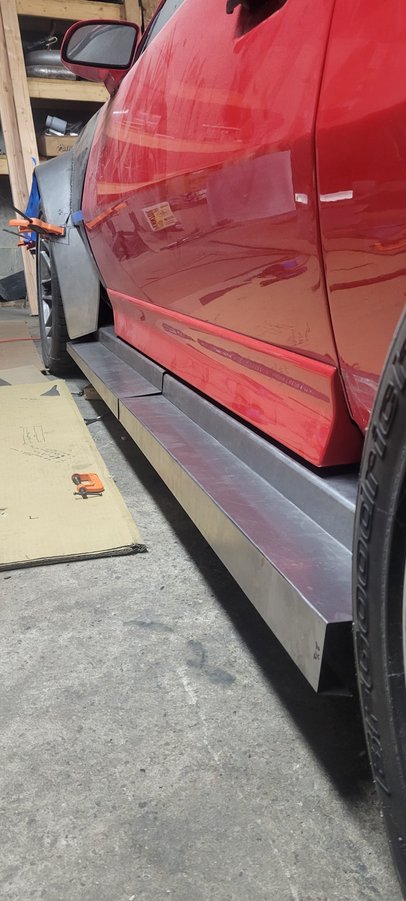

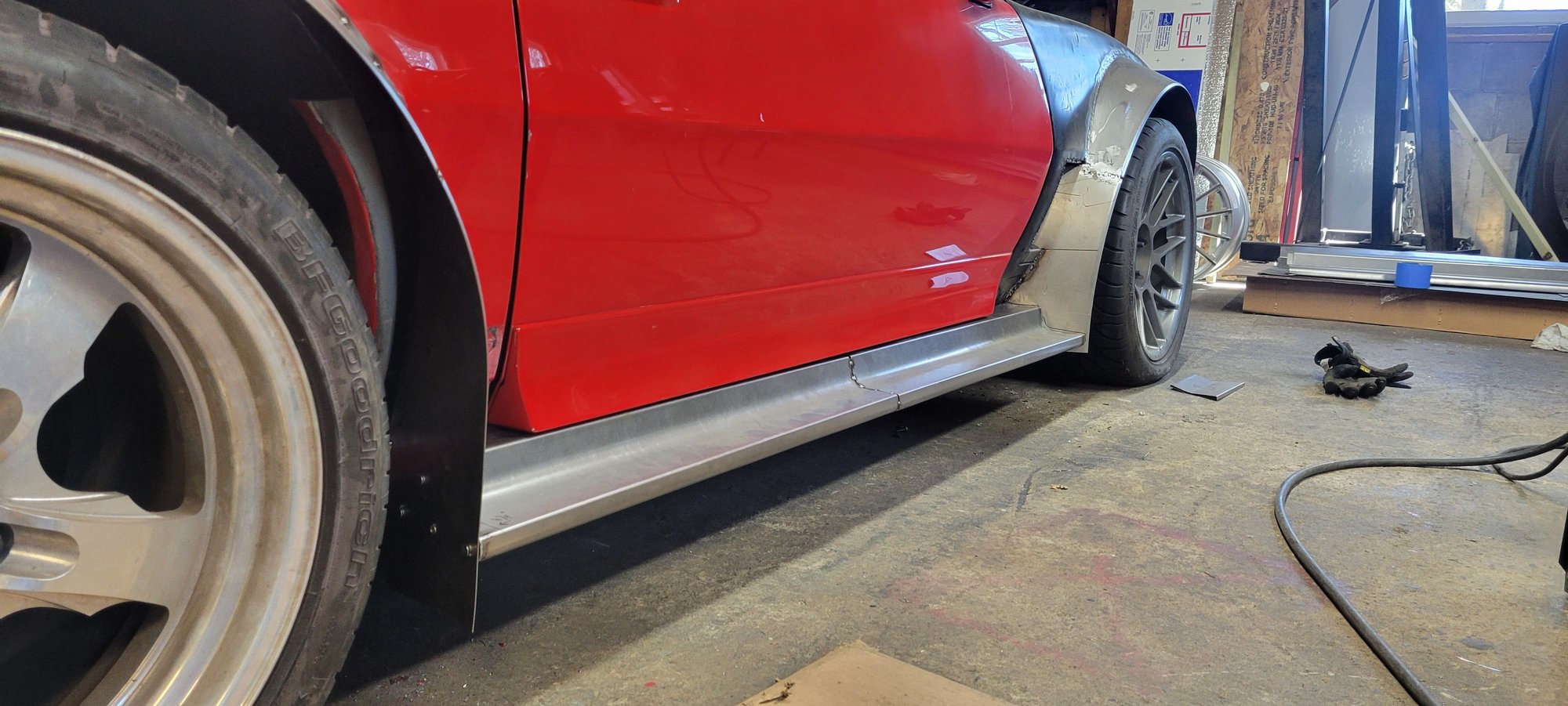

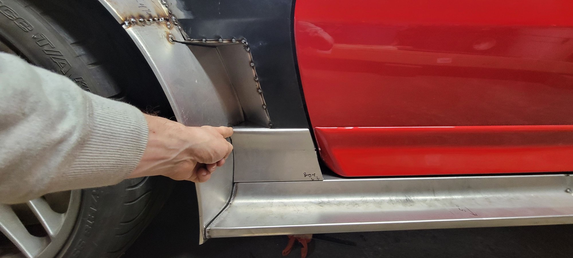

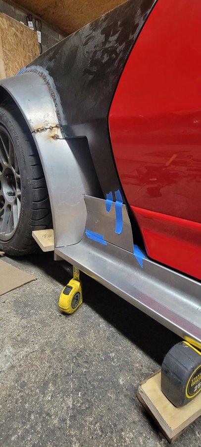

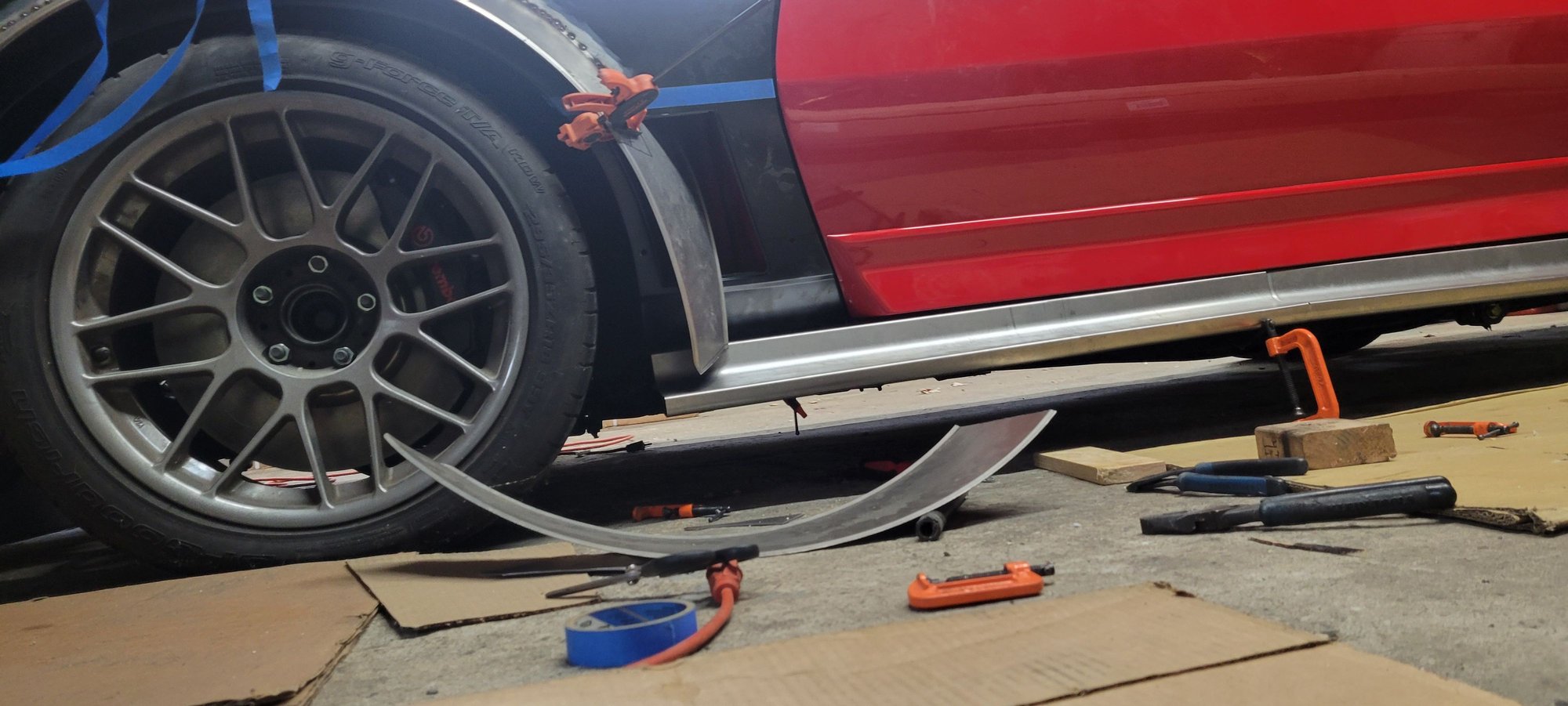

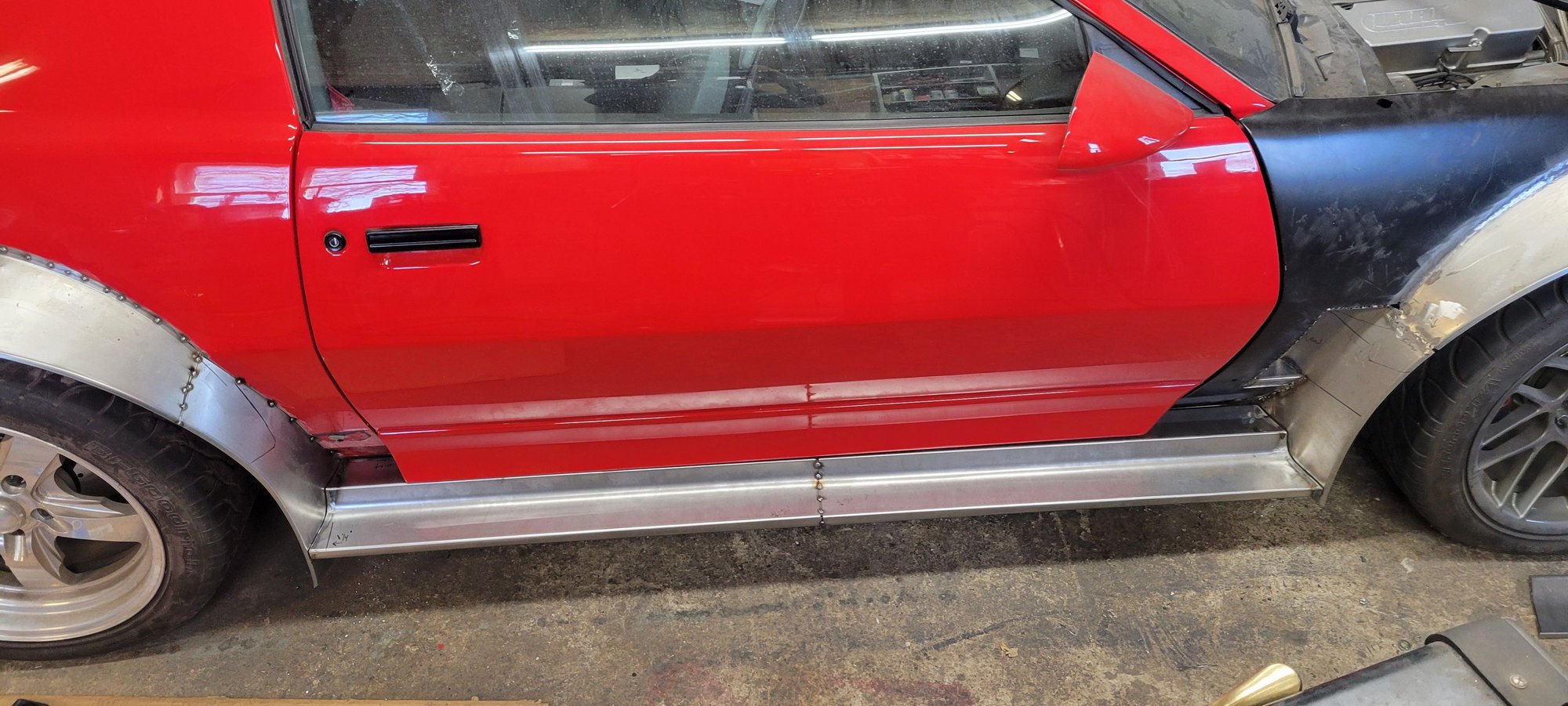

An update.
I couldn't figure out what I wanted for the side skirts so i took a break a couple months and spend some time brainstorming. I did some experimenting and made 2 versions.
This would get the job done, but it was too square and I didn't like how it clashed with the otherwise rounded styling.

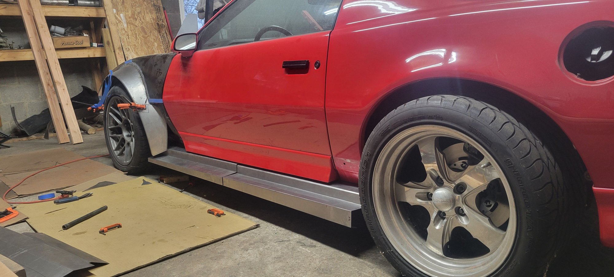

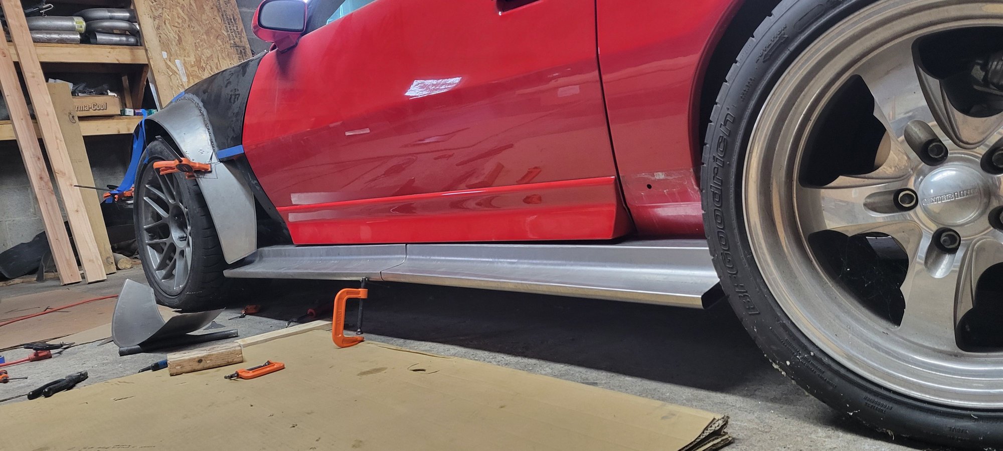

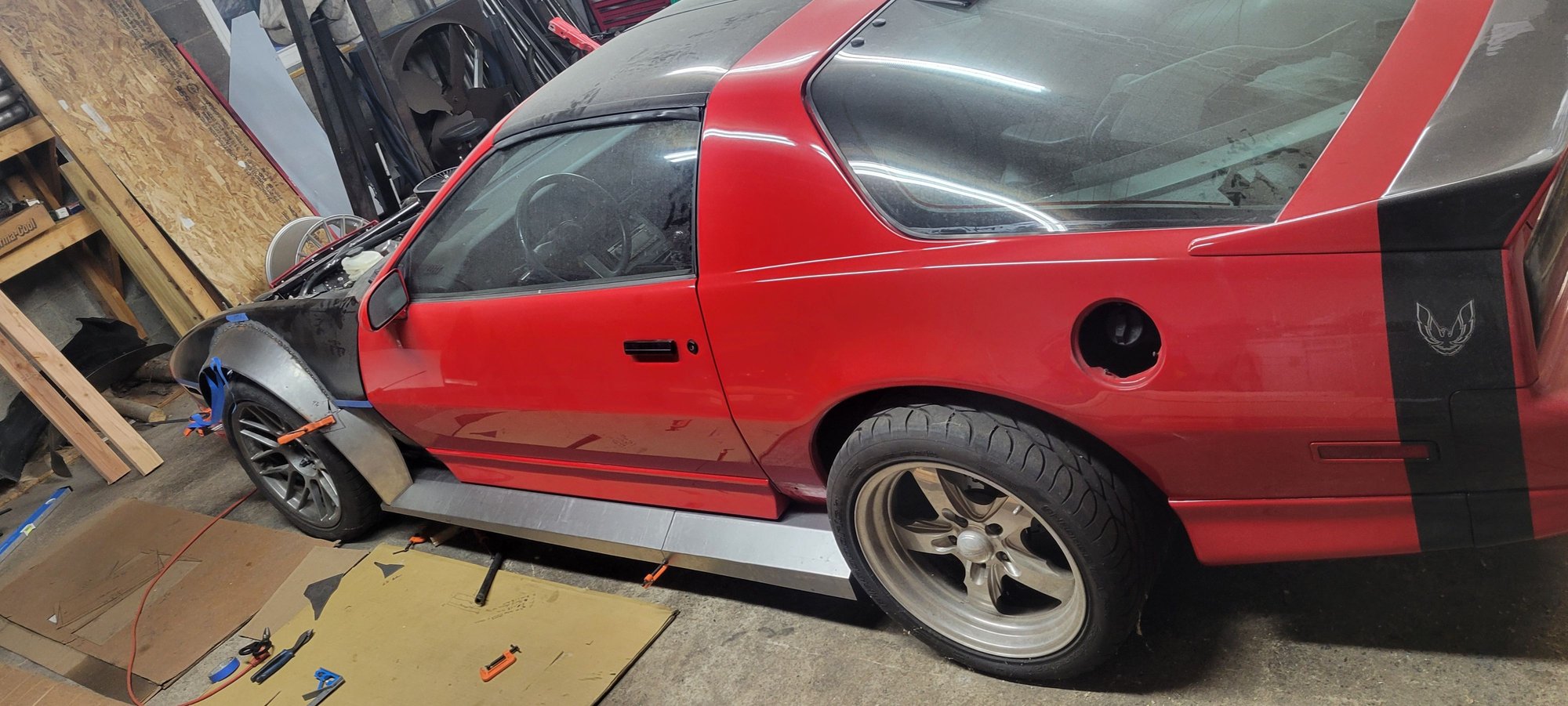

Re: Fender flares.

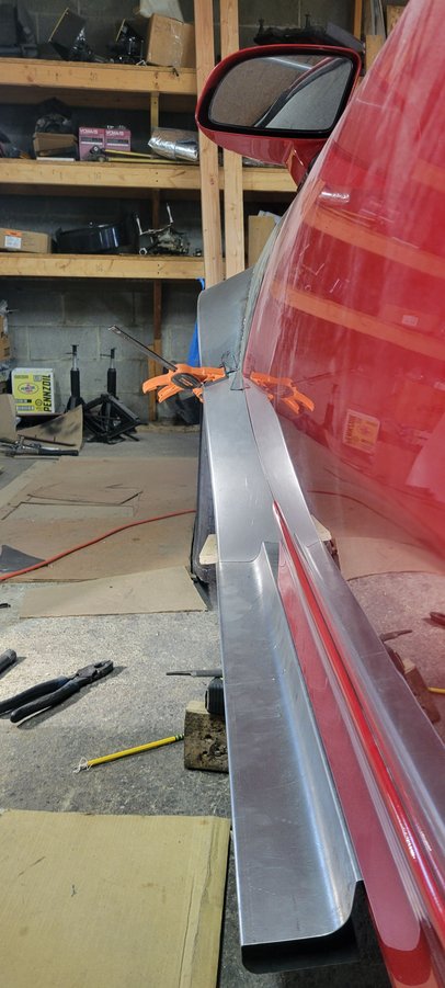

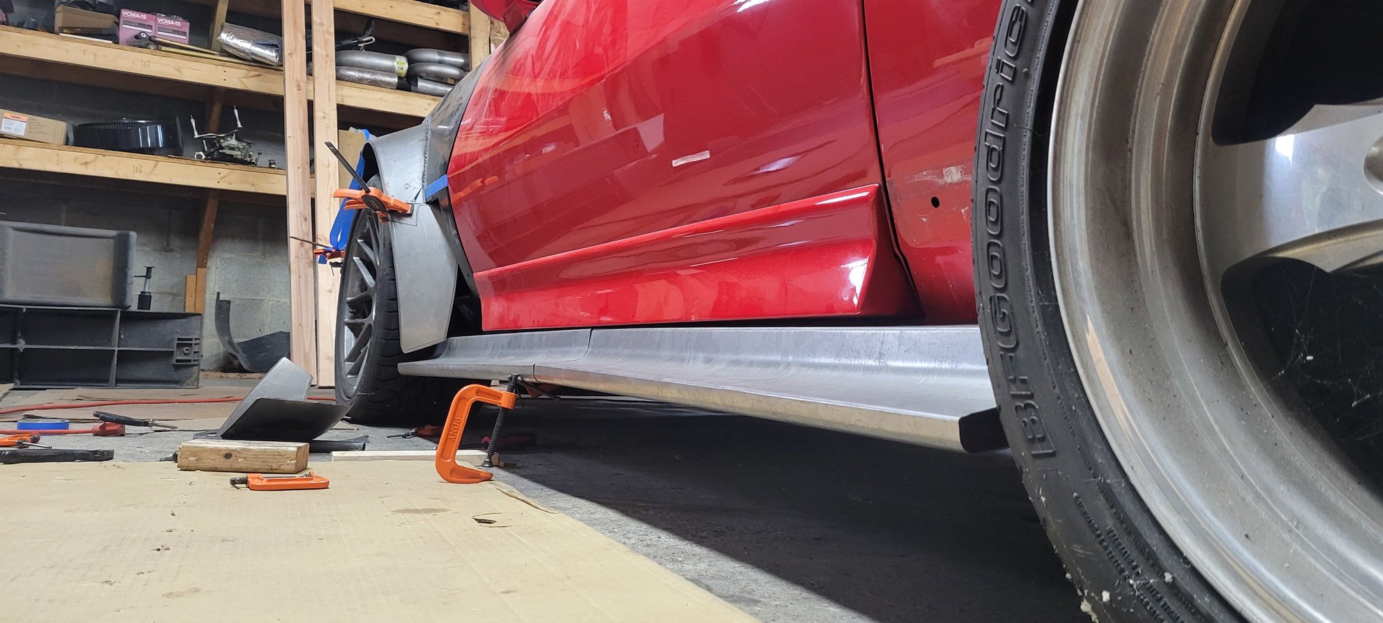

this was the 2nd version. I liked that it remained closer to the body and kept a body line just under the door GFX, but its still a bit square. I experimented with adding a raduis to the bends by making 2, 45degree bends 1/8" apart from each other and that really helped make the 90 bends (closer to 80 or 85) look better.
Still not happy with this one, but it was a step in the right direction.

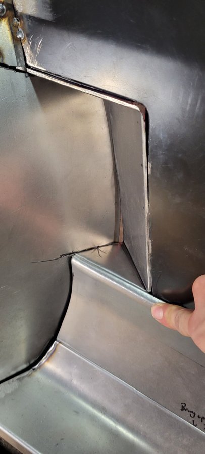

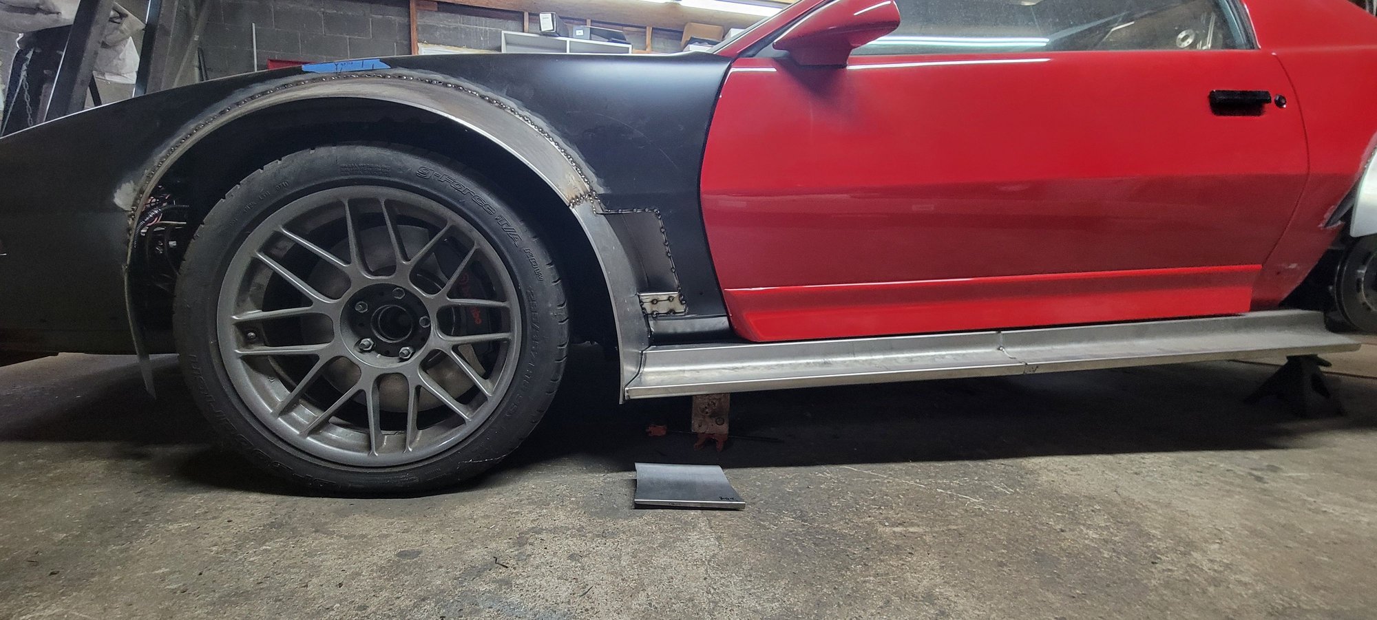

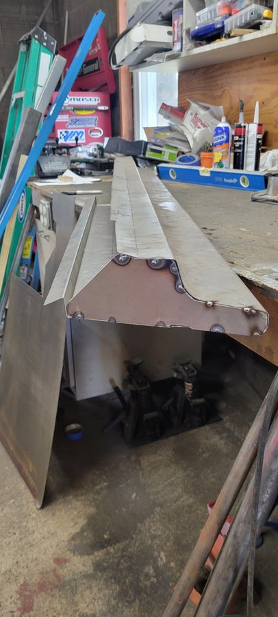

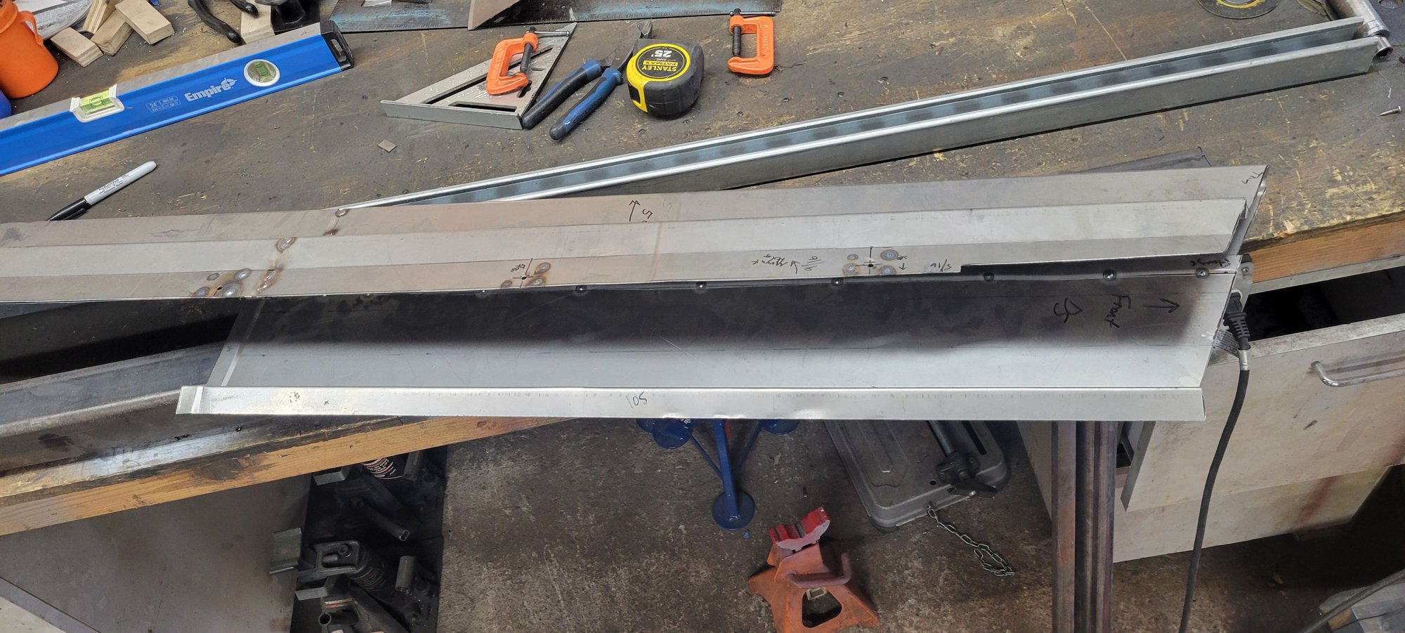

I made a 3rd version last night and added a large radius to the bend under the door. It completely changed the look and I loved it immediately.
I went outside this morning to clean and had an idea to add another rounded bend at the bottom to finish off the lip and it work and I think this one is going to be it!.

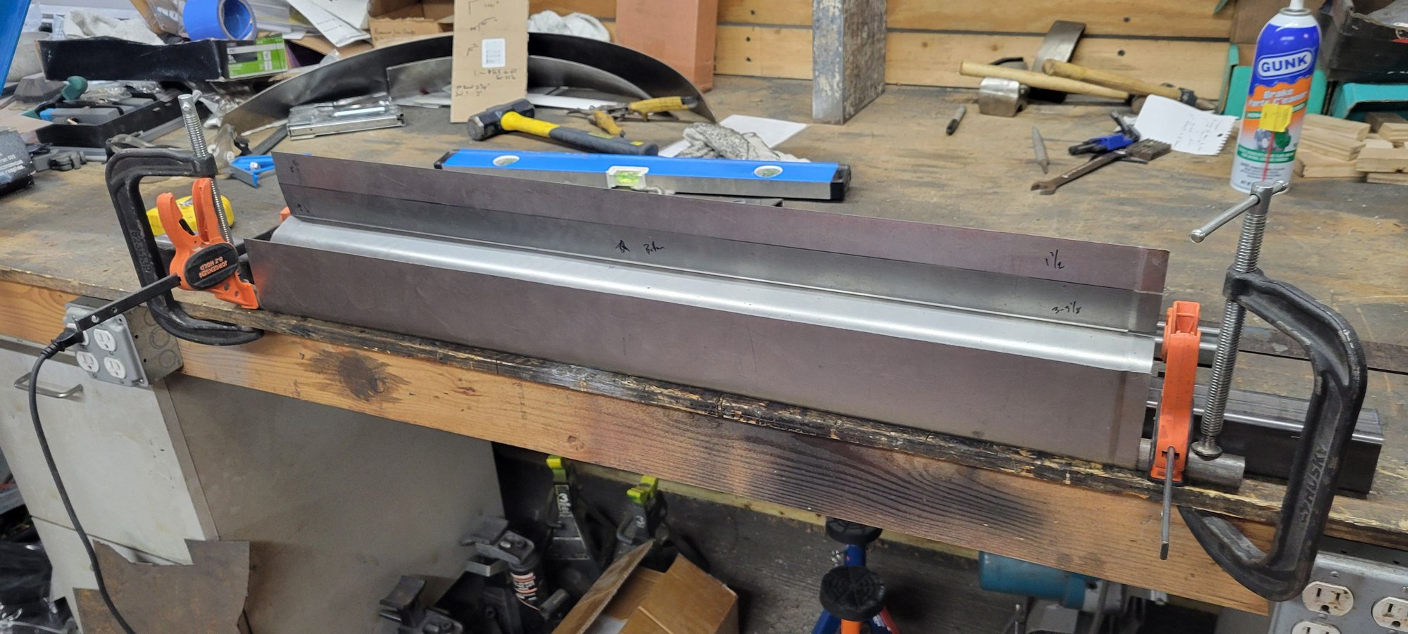

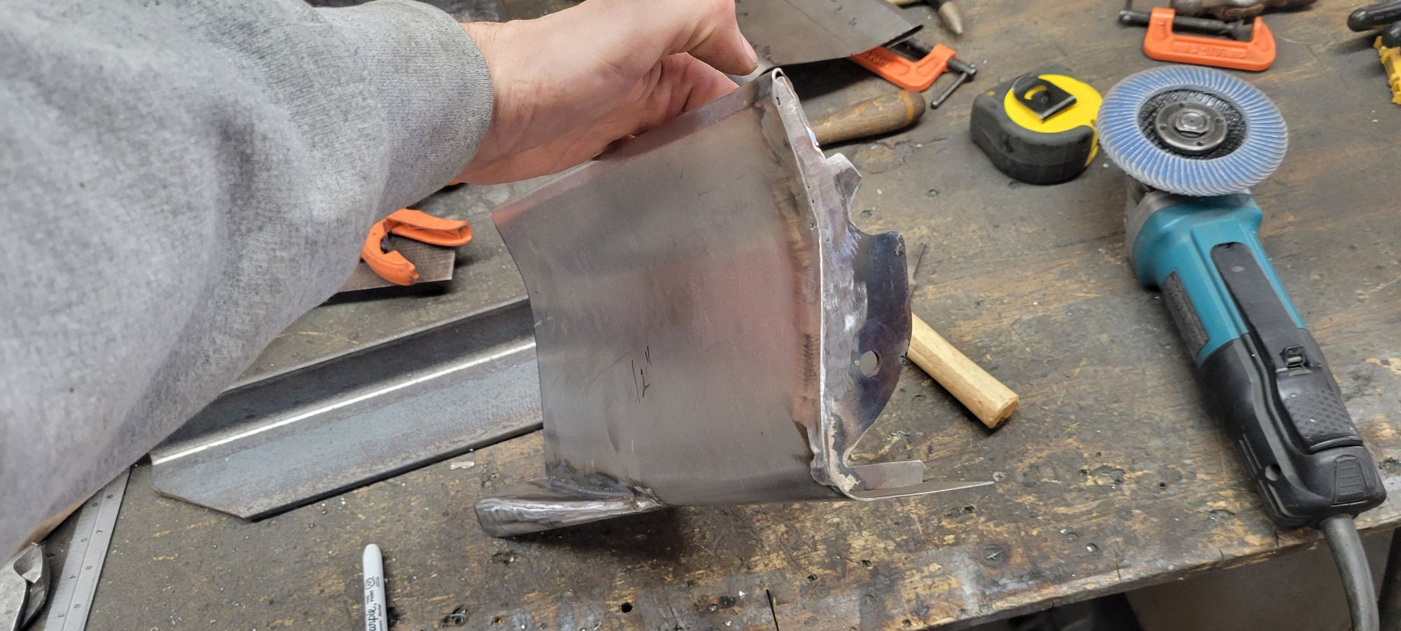

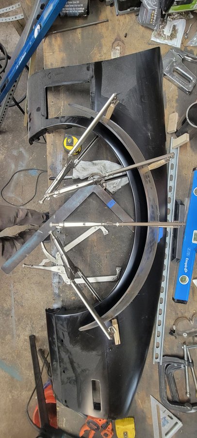

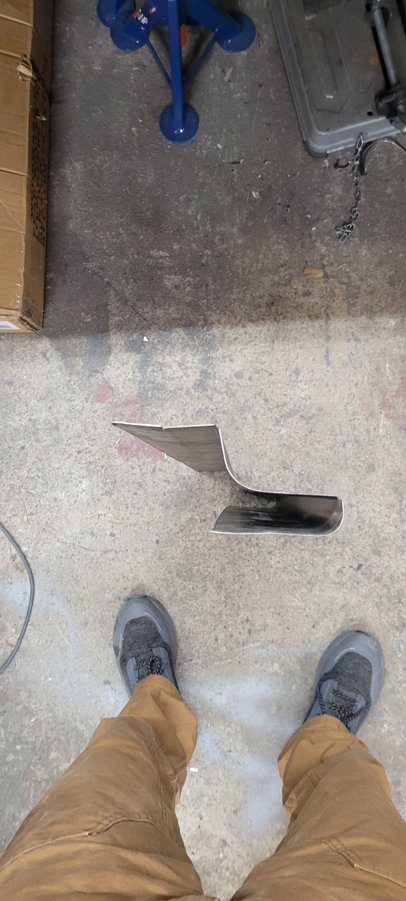

This is the end profile and my "jig" for the last bend.
Now I need to make the underside piece to reconnect back to the body on the bottom of the car. Ill likely add ribs inside to add some stiffness and need to add material in tye doorjam to match the thickness of the original pieces where they attach to the sill.
Next i need to redo the rear of the front flare extension to meet this piece and exten inward to the fender more.
Any progress is good progress!

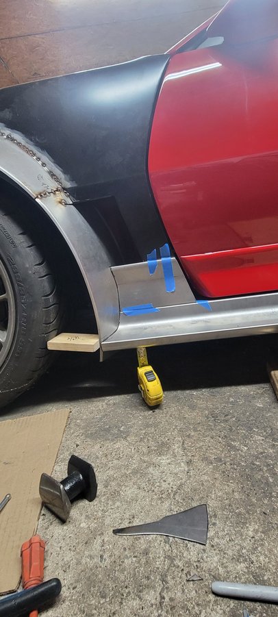

I totally agree on the third design. The rounded edges give it a more finished look. Have you left yourself room to get a floor jack under the side of the car? Anyway the flares and gfx look great. Very good craftsmanship.
Oh I didn't forget the floor jack! These rockers are about the same height as the rear most part of the factory piece at the rear wheel well, so they do sit lower in the front but are just about the same height as the fender tab, so the floor jack will still fit and reach to the front subframe under the firewall.
You can kinda see the little C-clamp im using to hold the fender tab to the body in the last picture.

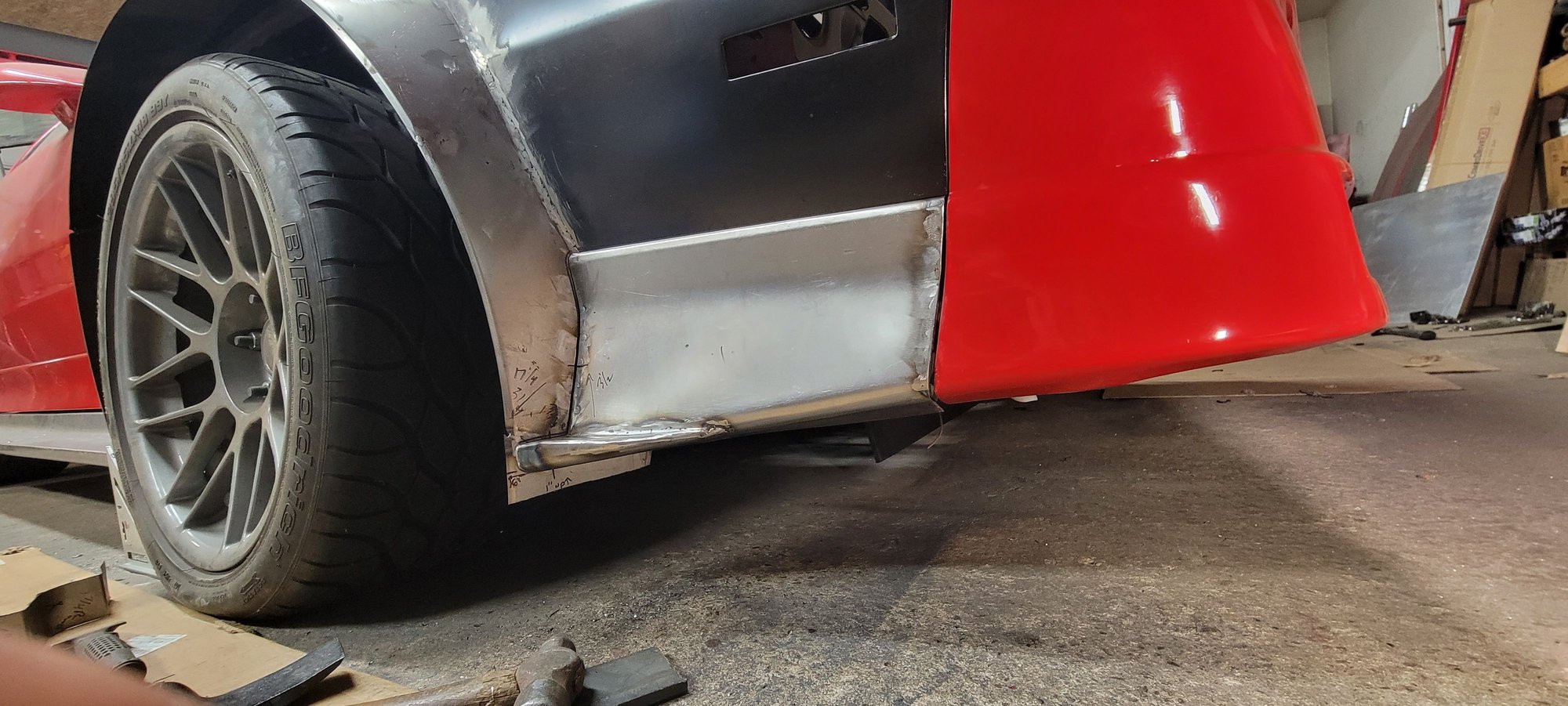

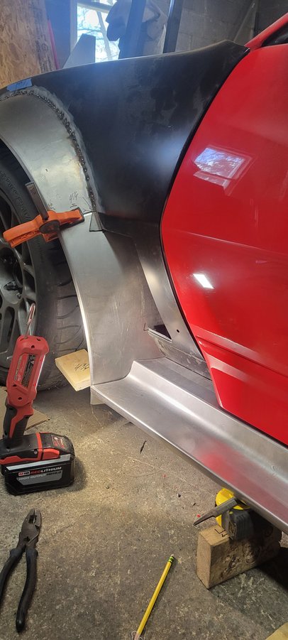

Today's progress.
I made a new lower extension for the wheel well and fitted it with the new rocker GFX section. The plan is to cap the end of the gfx once the lower portion is made and have 2 screws/bolts through the lower wheel well flare into the gfx for support.

Old Mar 21, 2026 | 06:09 PM
//<86TA>\\'s Avatar
iTrader: (15)
Joined: Aug 2006
Posts: 12,812
Likes: 110
From: Central NJ
Car: 86 Trans Am
Engine: 408 stroker sbc
Transmission: TKO600
Re: Fender flares.
I started making the fender piece, need to make the filler for the door jamb side but it came out better than I had imagined for the first shot
I think im going to weld it to the rocker section, so I also need to add a couple mounting studs to the backside.
Old Mar 25, 2026 | 12:48 PM
AlkyIROC's Avatar
Posts: 17,271
Likes: 171
From: 51°N 114°W, 3500'
Car: 87 IROC L98
Engine: 588 Alcohol BBC
Transmission: Powerglide
Re: Fender flares.
Not sure if I like the "floorboard" look but the fab work is amazing. Can't wait to see the finished result.
I'm excited to see how it turns out! Looks like you're making good progress.
And my god that looks like a ton of tire for one of these cars. I approve

Re: Fender flares.
I started the passengerside fender today, excuse the mess, there is an order to this chaos.
This is how I layout the flare on the fender before cutting. I have a nibbler for a drill that I use to make the cut after tracing around the lip. Then just repeat the same clamp process and tack in place.

Re: Fender flares.
I was able to fit together quite a lot today, this same work took months to figure out on the other side, lol. Glad to see progress.
I need to verify some measurements from the other side and make sure things are an symmetrical as possible.

Re: Fender flares.
dude! you are making great progress. Metal working to that level is damn difficult, well done

Re: Fender flares.
Started the rear flares today and I nearly cried when the cutting started but what can I do.
I was suprised the flare sat perfectly on the quarter, above the body line at least. I need to work up the extensions and cut a bit more but things are moving along still.

Can't wait to see the final product. Fab work is very clean. Its an interested approach to solve the problem with the wide sills sticking out... Are you (or passenger) going to have to worry about hitting/stepping on them while getting in/out? Doesn't look like the would be able to support much weight. The front shot on the pass side makes me think you need a much bigger wheel/tire combo... lots of room!

I dont have an issue getting in and out but yeah, you need to be careful. The rocker section will have an underside as well that wraps back to where the factory pieces attach amd I plan to add a couple ribs inside it and will also bolt to the flares through the wheel openings. it will be quite sturdy.
The wheels will be 19x12.5 on the back and 19x11 or 19x12.5 on the front (they will fit so why not, right?). Tire height will be close to 28" so they should fill out the wheel wells nicely. Only thing I will need to check is whether the taller front will clear my powersteering coolers that are tucked under the driverside battery tray.

Re: Fender flares.
This is what the underside is going to be.
The ends will be capped and bolted to the flares from inside the wheel wells for support.

Re: Fender flares.
Did a little work on the driverside, got the rocker section capped and bolted to the wheel well. Did the same for the passengerside.
Also made the fender vent. The plan is to open the wheel well in tye vent and add a screen like factory.

Re: Fender flares.
Working on figuring out the front fender gfx section. I felt i needed something to tie it in with the styling of the rocker section. Ended up with just a little wedge piece where it transitions to the flare. Made the rest bolt in like factory. I will need to make a piece for the underside.

Re: Fender flares.
Roughed in the rear passengerside quarter flare and rocker section.
Needs a few tweeks but its getting there

Here's what I see...
A better choice might have been to use convex as opposed to concave, to continue the flare shape.

Re: Fender flares.
Just saw this on FB 3rd gen group.
yea eBay flares not metal
