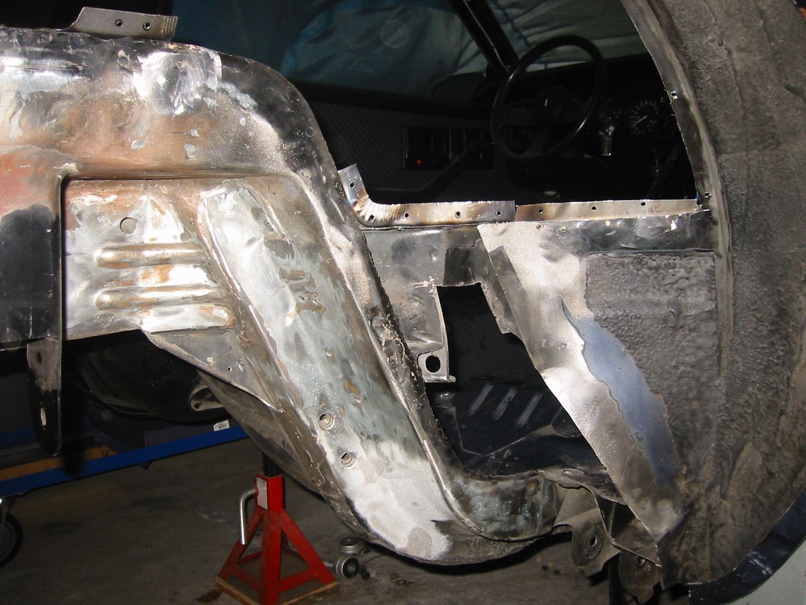

Yes, I am running a 315/30-18 on the rear

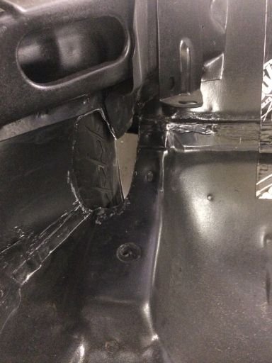

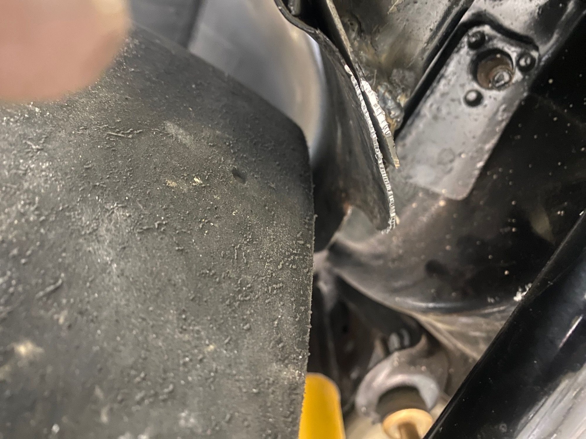

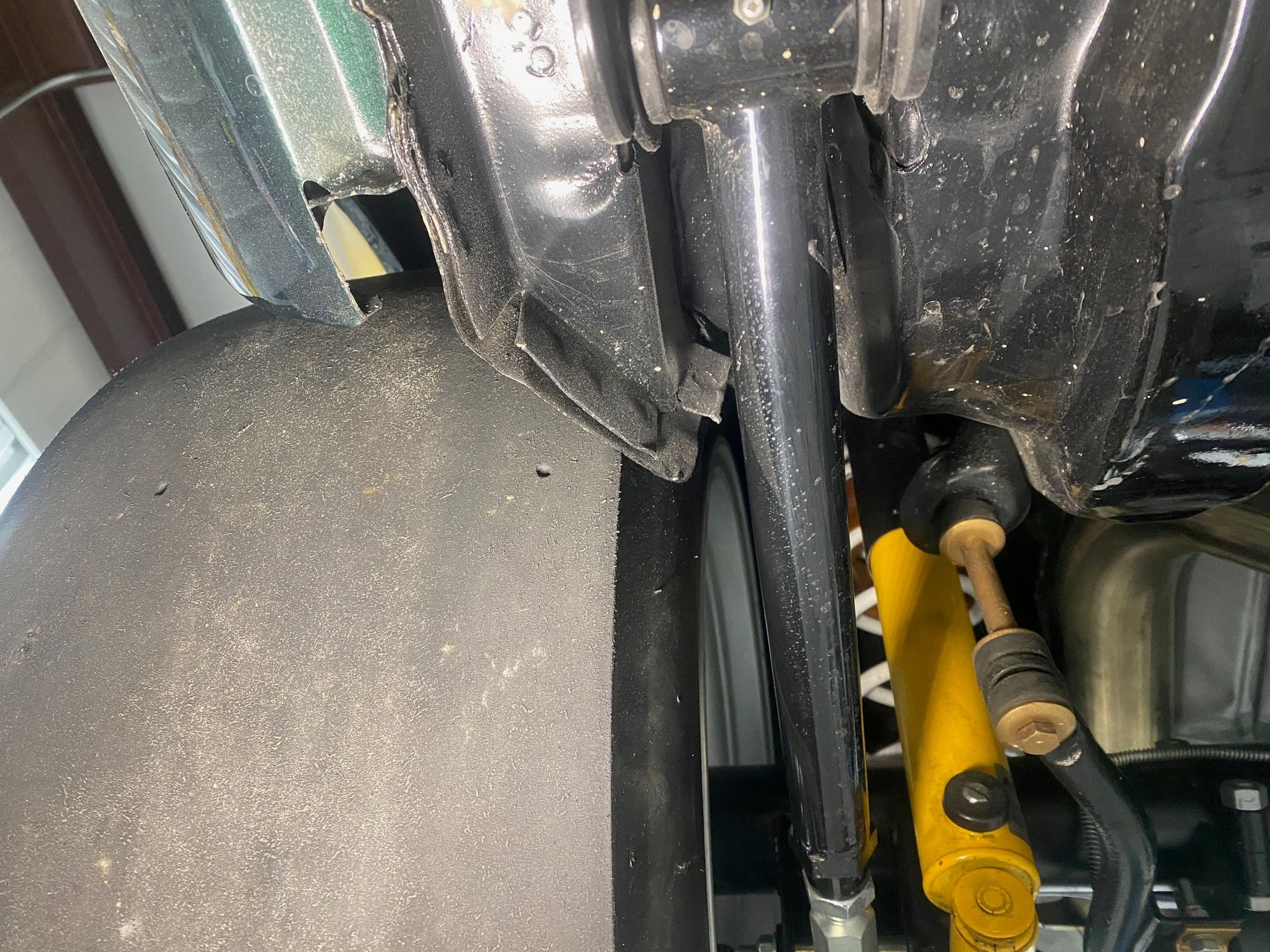

I know this post is a few months old, but I recently ran into a similar issue with my car trying to fit 28x12.50 ET Streets.
I did the following:
Contact with the front edge.
I took a small pie cut out of the inner structure then rolled the fender well in & rewelded it.
This gave a lot more clearance.
From the fender well you cannot tell it was modified unless you know what to look for.

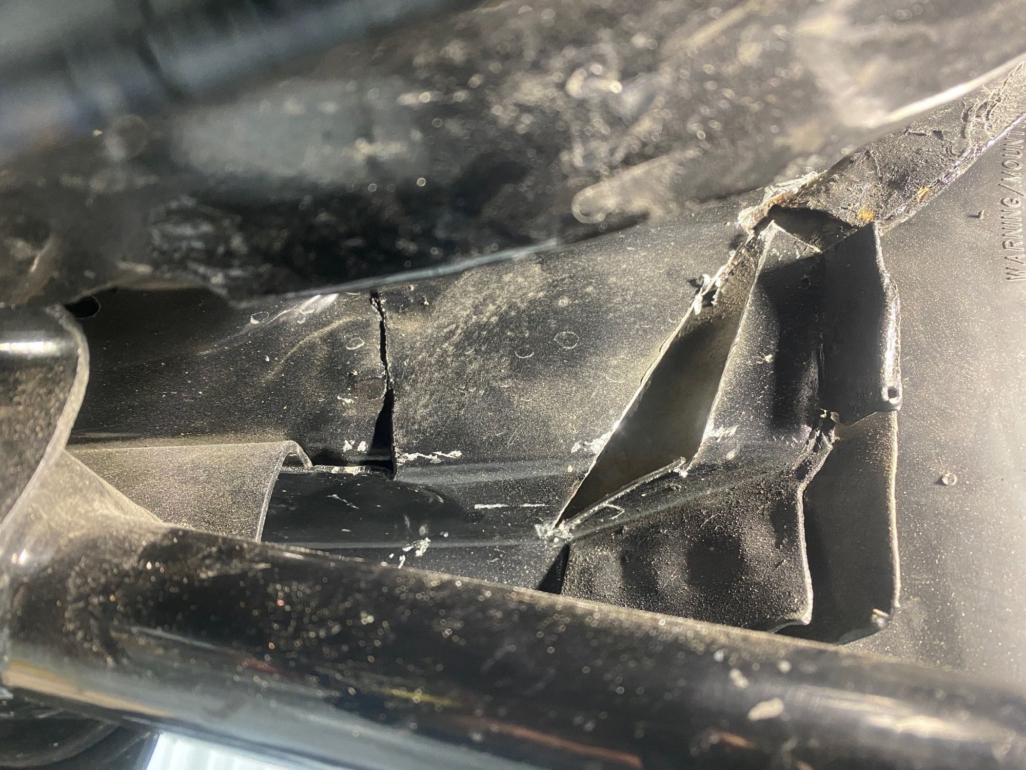

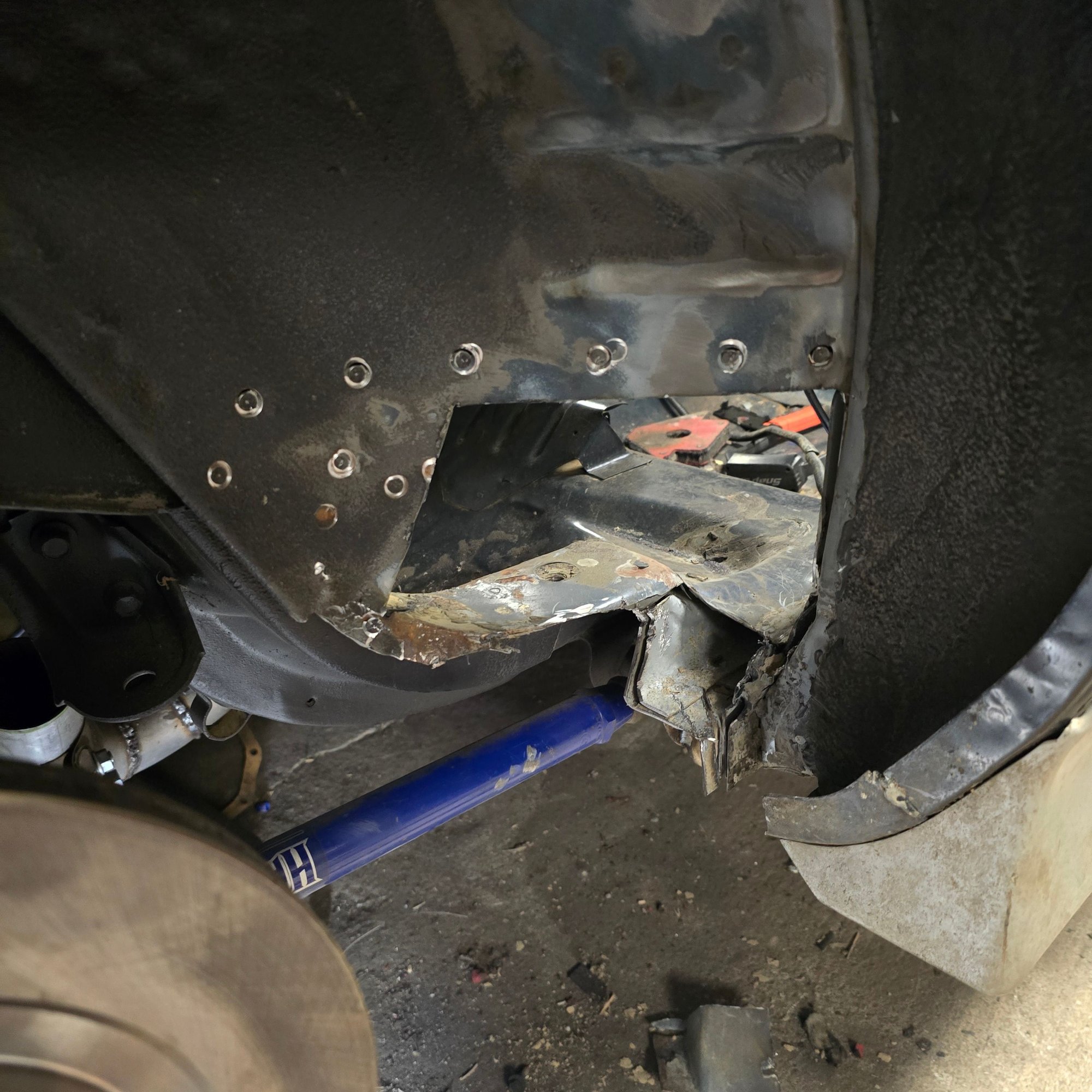

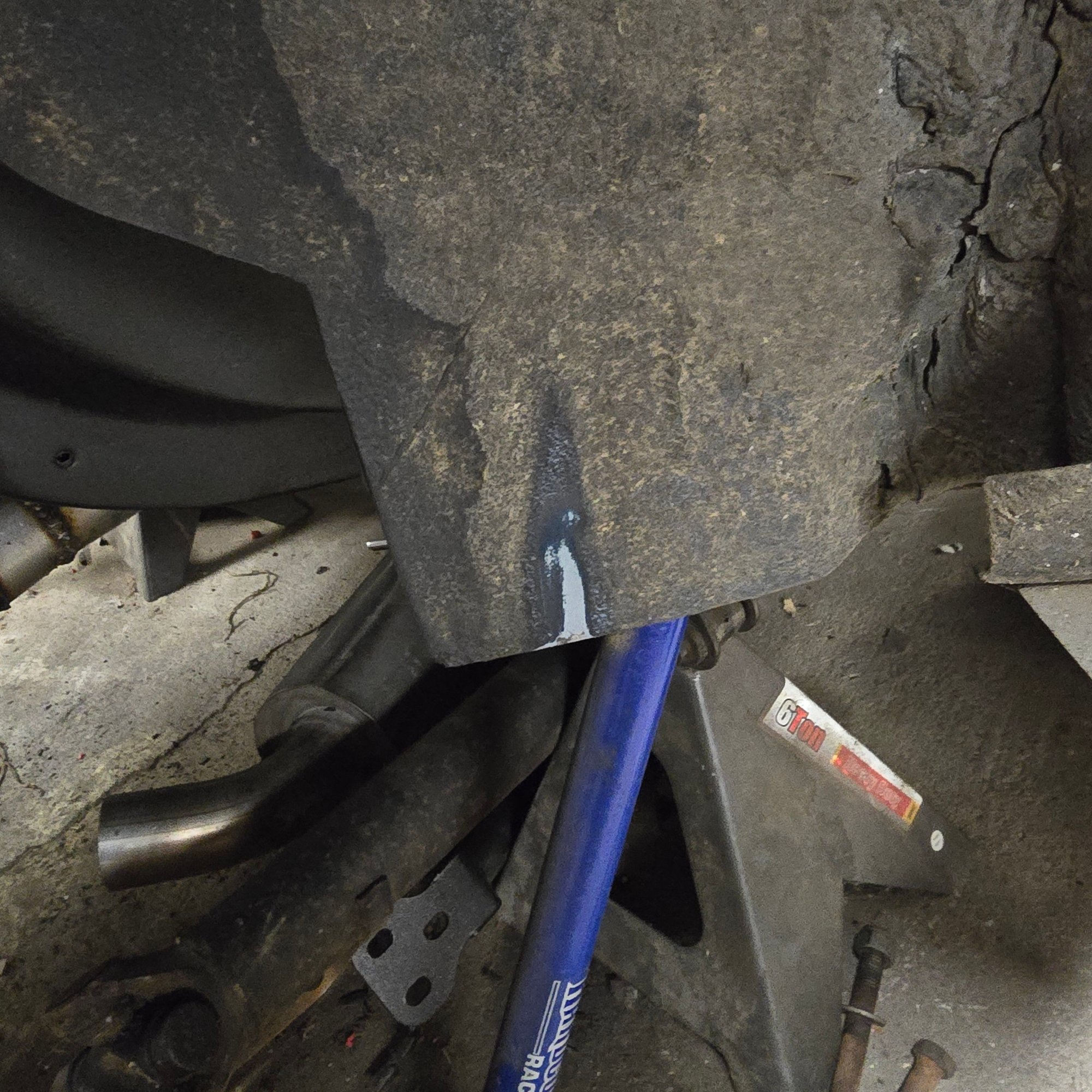

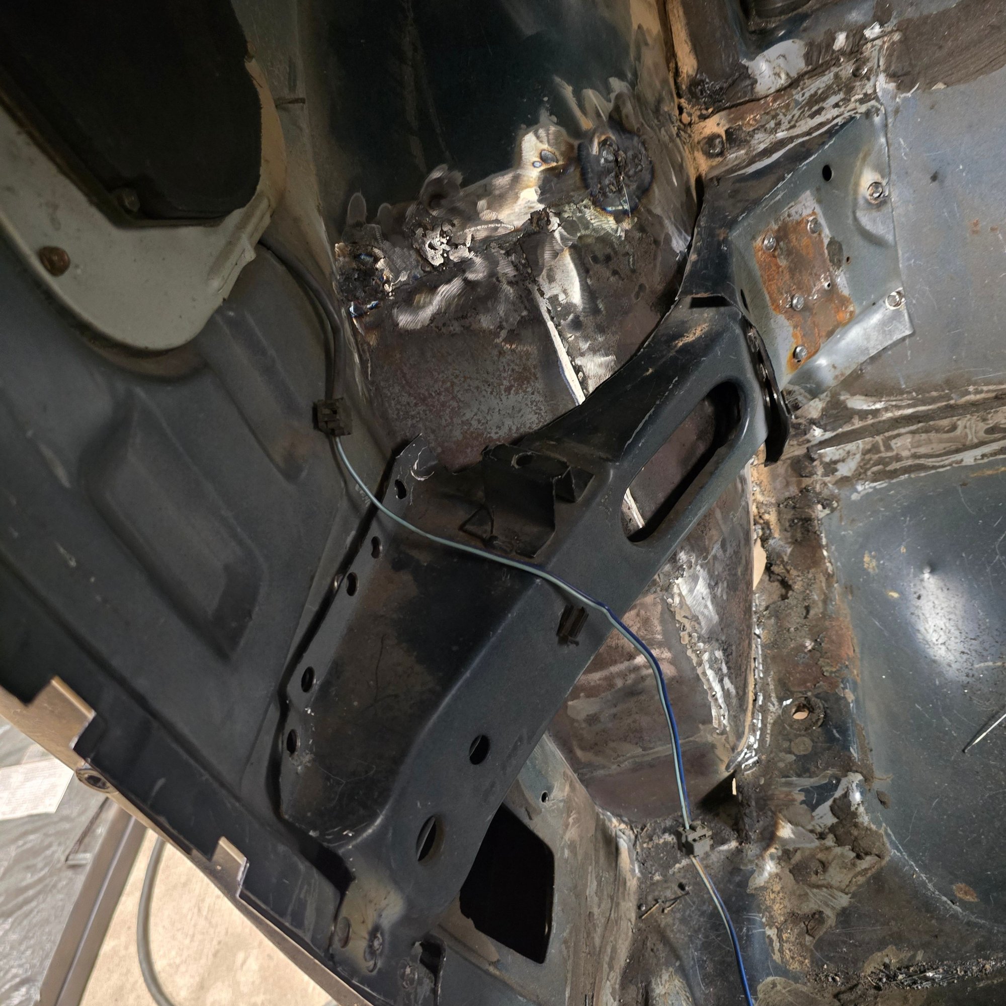

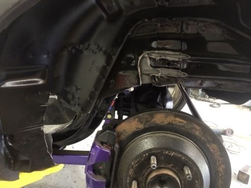

I run a 325. I had to do a couple small cutouts and shave off the raised stiffeners on the subframes. The first picture is the inside of the car, on the passenger side. The second is driver side. I have almost 1/2 inch static clearance and it will still rub in a 1g turn. I need to sit a slightly deeper opening before our next trip to Tail of the Dragon

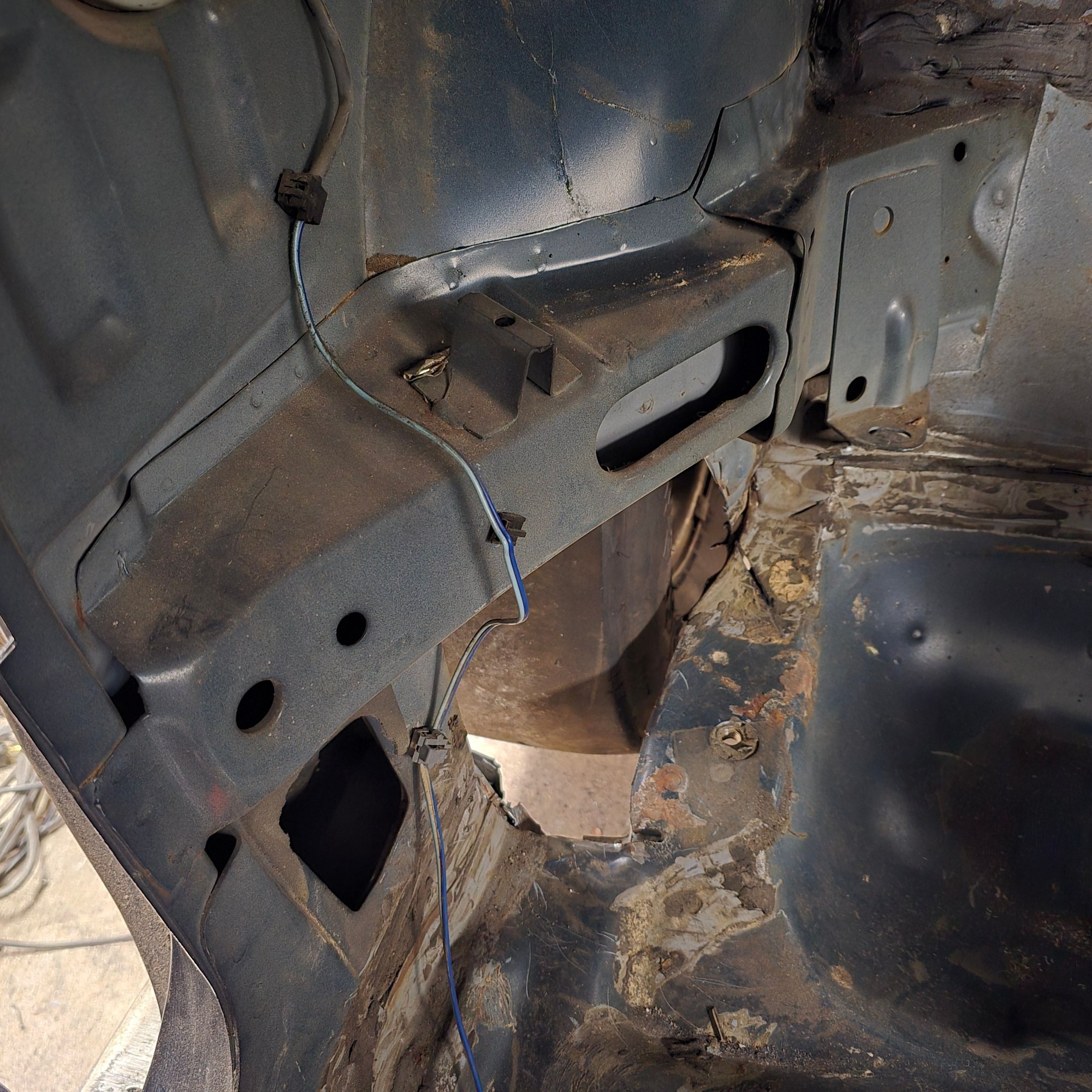

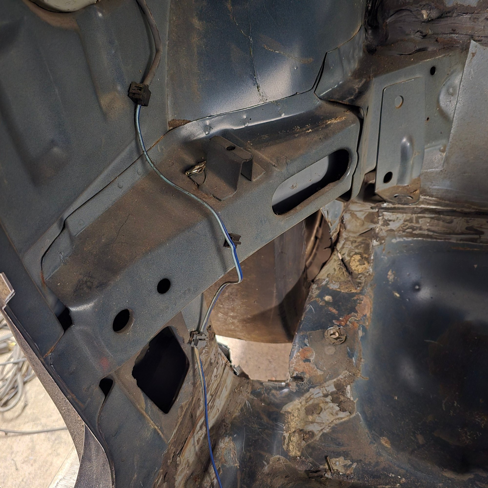

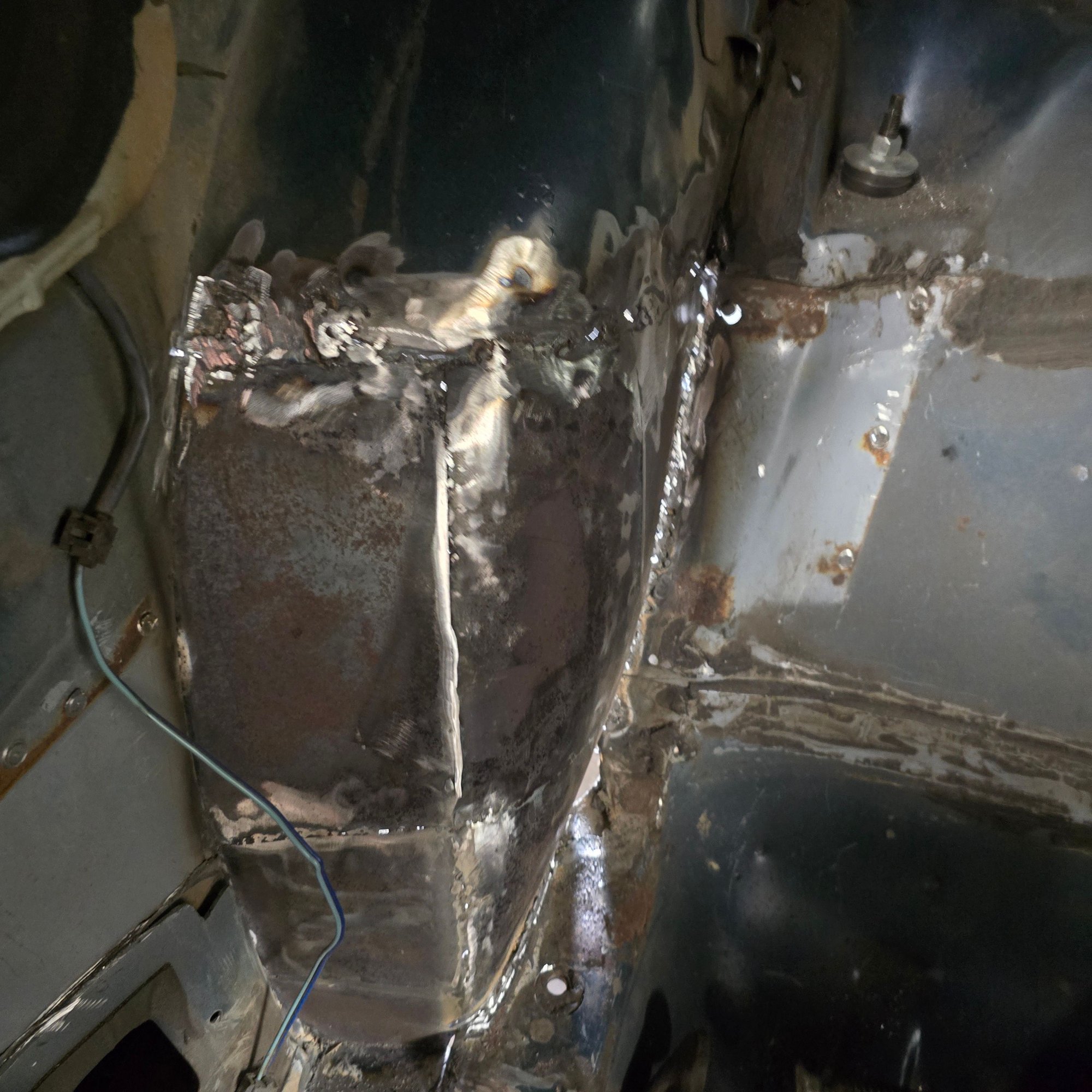

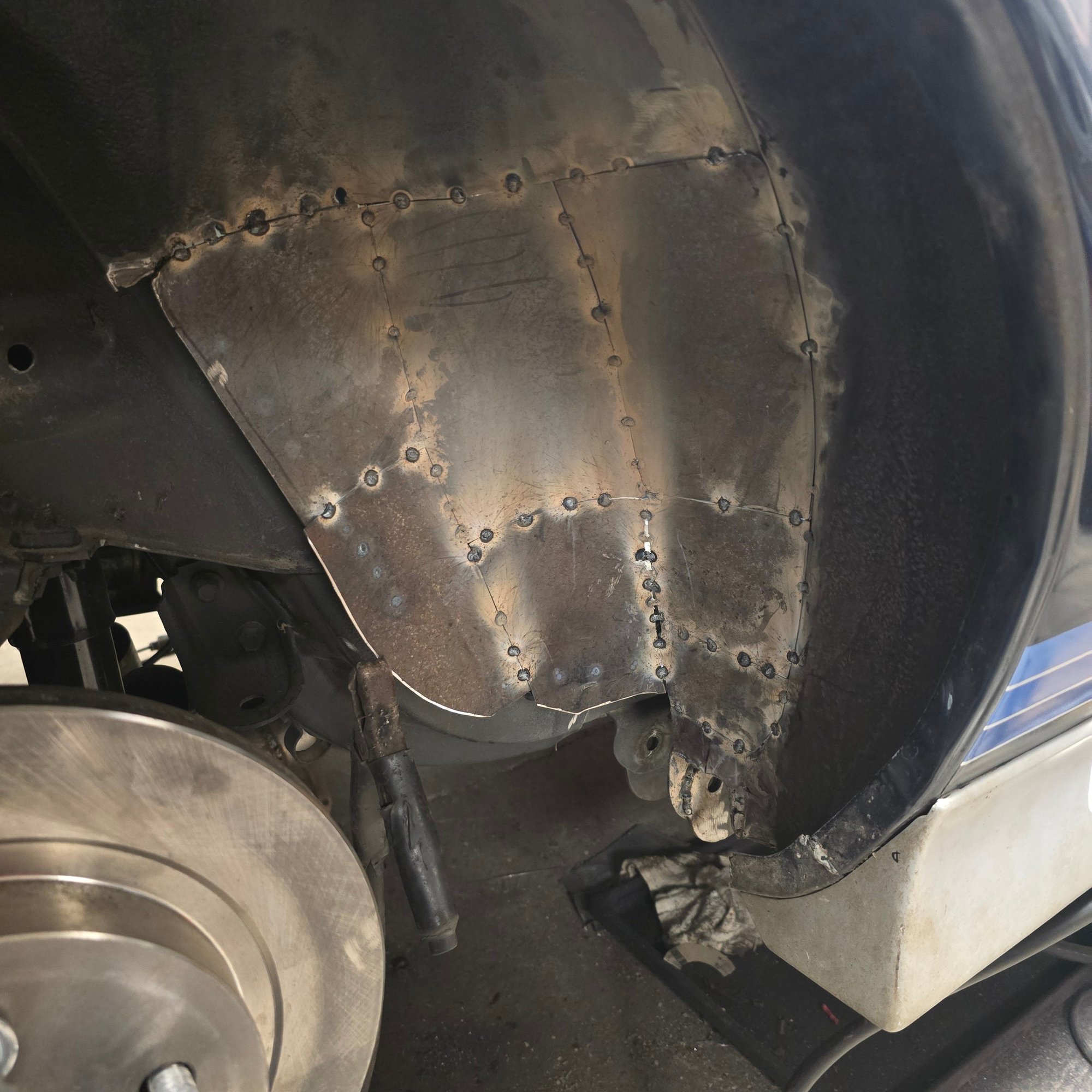

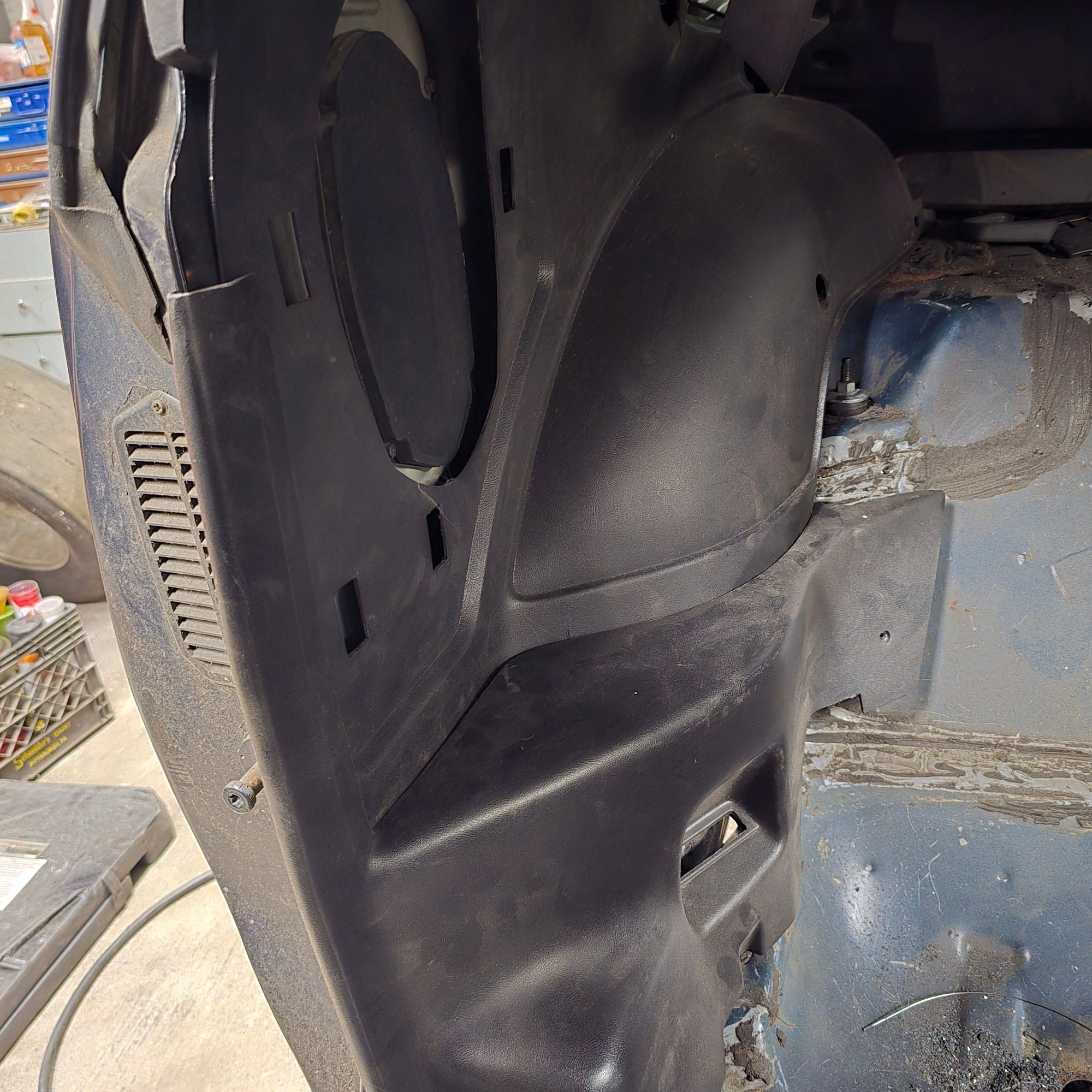

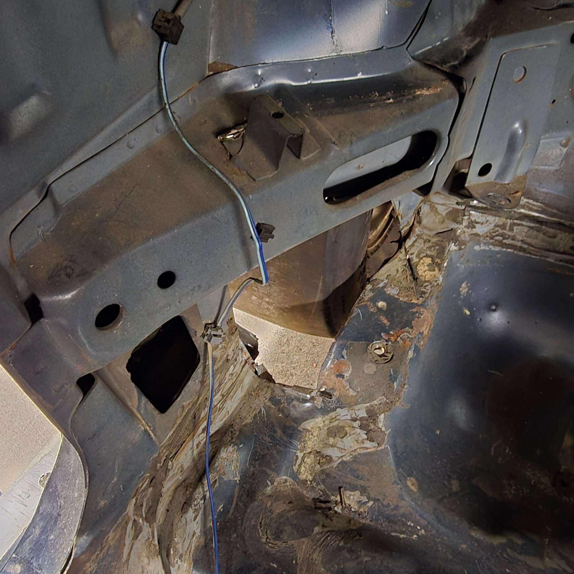

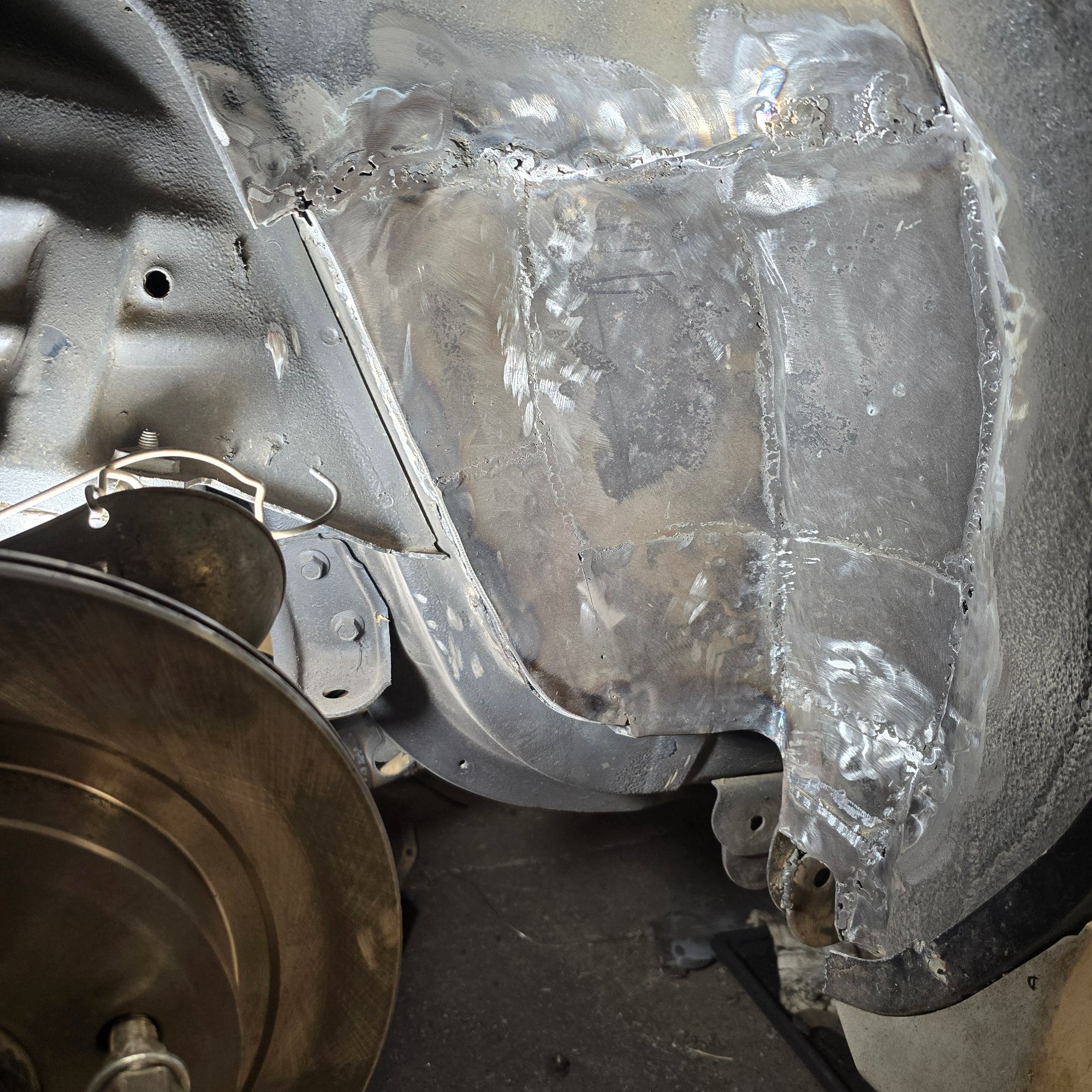

A little update. I tried hitting it with my purse with no success. So out came the old grinder with cut off wheel. passanger side is pretty much done other than some rust in the spare tire area. Next is driver side.
All of the factory bracing for the arm rest has been modified and fits along with the seat bracket.
