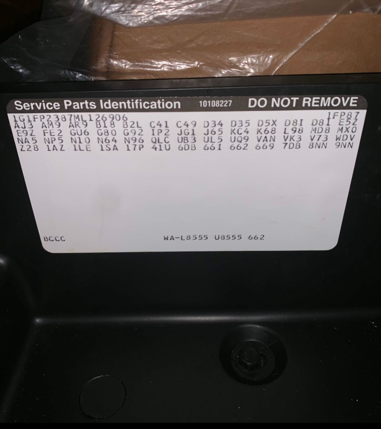

i thought it was a L98 car...

Re: B2L rpo ??
i know that L98 means you have a 350 motor, i even checked in my gm shop manual, but this page shows differently.
http://www.chevy-camaro.com/chevy-ca...-third-gen.asp
Re: B2L rpo ??
The B2L RPO was a group RPO for all options required when ordering the L98. In the case of 1987, ordering the L98 required you to get J65, K34 and a few others. L98 was the engine option. Most books, even the white book refer to the 350 incorrectly as B2L. GM uses L codes for their engines.
Posts: 10,950
Likes: 26
From: Orange, SoCal
Car: 1990 Pontiac Trans Am
Engine: 355 TPI siamesed runners
Transmission: Tremec T56
Axle/Gears: 12-Bolt 3.73
Re: B2L rpo ??
My gosh, doesnt anyone search anymore? This question gets asked at least once a week.
L98 means 350 TPI engine with aluminum heads in a Corvette. B2L means delete the aluminum heads and put in iron heads for an F-body.
Re: B2L rpo ??
Re: B2L rpo ??
I agree. L98 on an Fbody means 1987-1992 350-TPI. On a Corvette, they did use aluminum heads versus the steel that the fbody received, but B2L has nothing to do with the heads. Please be sure you have facts correct before posting info to new users.

Re: B2L rpo ??
You guys need to look again. While I didnt give all the options B2L made up, I got at least one of them.
https://www.thirdgen.org/forums/hist...ifference.html
To further prove my point, the G92 package is the one that triggers the 4-wheels disc brakes (J65) and the engine oil cooler (K34). These things can also be on a 305 5-speed TPI but those dont have the B2L rpo.

So don't state G92 consists of this option and that option. It did not.

Re: B2L rpo ??
Kevin, what website is giving you this much misinformation? I know it's not coming from TGO. As was stated, G92 is a performance axle and in some years had different requirements. In 1987, the 350 cars came standard with G92, but in 1988, G92 was an option on the 350 cars. B2L is a code for mandatory options required for the 350, including oil cooler and 4 wheel disc. I do see that I made a mistake above. RPO K34 is cruise control. RPO KC4 is oil cooler.

Re: B2L rpo ??
Yes, its coming from here. I've been here since the end of 1998, and what I've posted is what's always been posted when someone asks. Where are you getting your info?
Both of you guys say that B2L means "additional options for the L98 engine." Well, you think maybe one of those required options is the iron heads instead of the aluminum heads? I mean, something had to trigger the change in heads, and it could be that code or any other RPO code on the car, right?
The L98 in the Corvette and the L98 in the Camaro were different engines because of the heads and the way the EGR passage was routed. However, the LT1 and LS1 in the 4th gen F-body and the C4 and C5 Corvette were the same engine, hence no different code in the 4th gen f-body to distinguish the two.
The L98 in the Corvette and the L98 in the Camaro were different engines because of the heads and the way the EGR passage was routed. However, the LT1 and LS1 in the 4th gen F-body and the C4 and C5 Corvette were the same engine, hence no different code in the 4th gen f-body to distinguish the two. Supreme Member

Re: B2L rpo ??
Wouldn't it make more sense for the corvette to have a RPO code that added the aluminum heads rather then having it deleted with B2L? I would have assumed that the "standard" L98 would be the iron head version and that the corvette would have had an additional code to upgrade it to vette specs. I still think that B2L was as Scott describes it, the manditory upgrades that come along with the L98 instead of the iron head L98 being manditory for B2L.

Re: B2L rpo ??
Look at it from GM's point of view. The Corvette and its engine are the flagship, so the Corvette L98 is the standard, not the f-body L98.

Re: B2L rpo ??
yeah i think i would have to agree there since the vette got the L98's first i doubt they would make an extra code to identify it from the camaro engines
Re: B2L rpo ??
If the logic behind B2L means pulling aluminum heads and substituting cast iron, then where's the code indicating the same on 94-96 B-body LT1's?
It's something of a retarded argument anyway, since the Corvette L98 was originally an iron head motor. If they had to change the RPO to change the equipment, then wouldn't the 85-86 L98's have a different RPO then the 87-up?
Whether B2L was to signify changes in the engine itself, or the standard equipment attached to it, is really a moot point. There are plenty of RPO codes that could be debated. GM defines L98 as Engine 5.7L V8, and B2L as Engine Package, 5.7L V8. Sure seems like L98 is the engine code, and B2L has to do with the subsequent components.
Re: B2L rpo ??
Previous Posts are just a CYA type about the different heads on the L98.

NOw that we have gotten WAY off topic arguing about crap that has nothing to do with 3rd gens...
To answer the question:
B2L - PERFORMANCE PACKAGE & ENGINE PACKAGE V8 5.7L TPI
L98 - 5.7L TPI engine
The fact that both the Corvette & the F-body both used the L98 is moot, they are similar but as discussed the vette used the aluminum heads. Same thing as mentioned before for the LT1 and the Large cars vs the Vette/F-body from 94-96. But those cars are not third gen. THe point is that they used the same engine designation, but slightly different varients of the engine.
The question I assume by the TITLE OF THE THREAD was B2L RPO?
THIS IS A PACKAGE RPO, it has nothing to do with the engine other than the engine was included IN the package. Much like the 1LE (88+), WS6 (86+), W66, W61, W6, Y84 were ALL packages, Although they determine either a trim option or a performance option, they do not distinguish ONE single item but many items.

the L98 is the ENGINE, B2L is the PACKAGE as listed above. Heck some of you should really do your reasearch... The B2L does not directly designate the IRON heads anywhere in official literature, however this is how they all came in the F-body, SO it would be easy to ***-U-ME that it was part of the package, but it is probably not the case.
with that said I will leave you to your pointless argument...
Scott got it right in post 4, it should have ended there...

I know this is an old post but for people looking these things up today, L98 means 350 motor regardless of what car (corvette, trans am or camaro). I have a 91 Z28 and my RPO clearly stats “L98”

And you have B2L... B2L was the package, L98 was the engine, in that package. Read post 28

You have an L98 RPO Engine, with the B2L RPO for Cast-Iron Cylinder-Heads, instead of Cast-Aluminum Cylinder-Heads.
At that time; the Corvette Sub-Division of the Chevrolet Division...
Did not want any other Vehicle to have the L98 Engine with Cast-Aluminum Cylinder-Heads.
The Corvette Sub-Division had a massive say in how decisions were made at GM.
