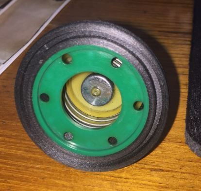

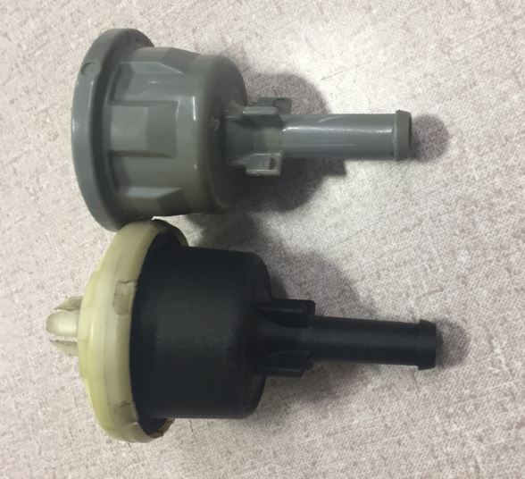

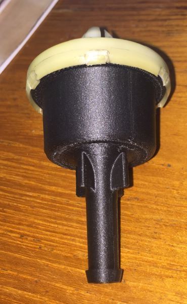

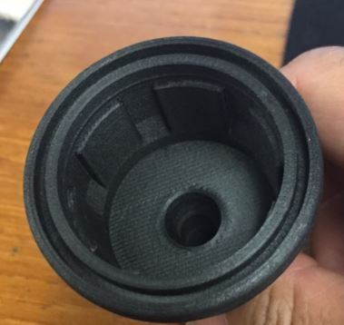

I 3d scanned my broken housing and created design with strengthening improvements. I then had the design 3d printed with a Markforged Mark Two printer using Onyx material which has chopped carbon fiber along with continuous strands of carbon fiber in select areas. Everything snapped together. If you are interested for the STL file to print your own housing, it is at following link.
https://www.thingiverse.com/thing:2457282

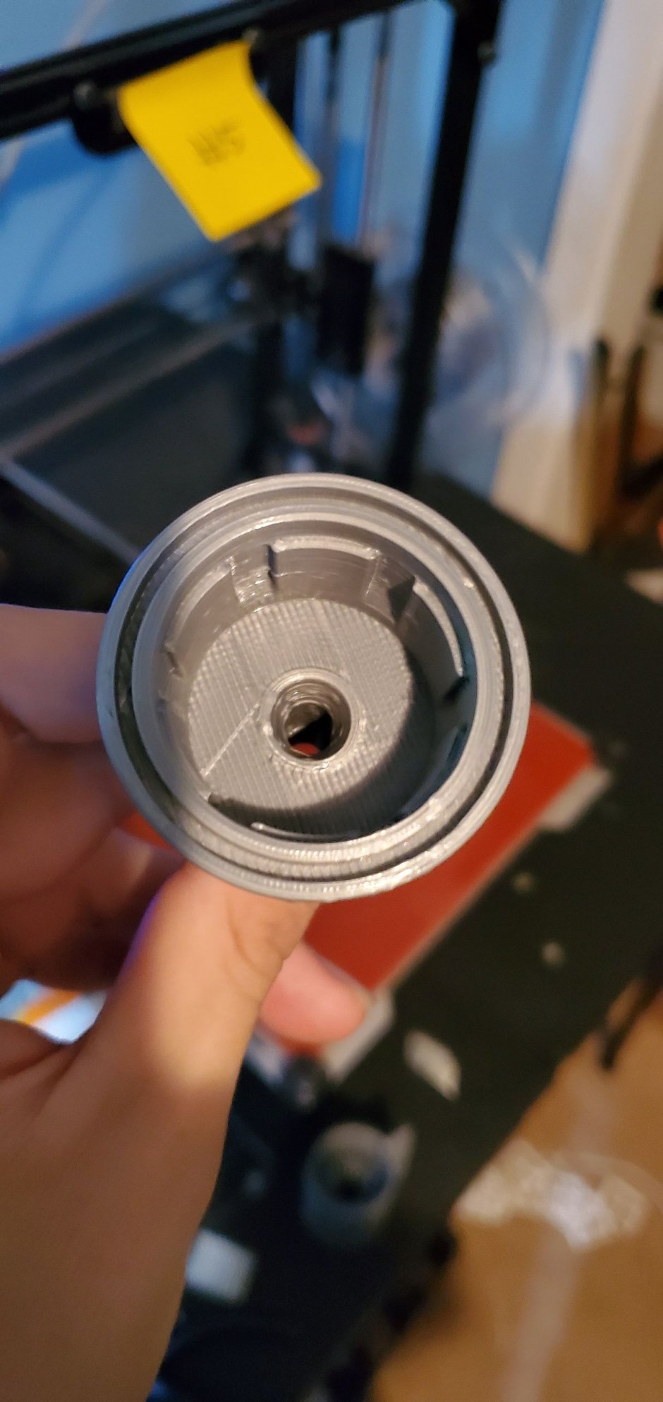

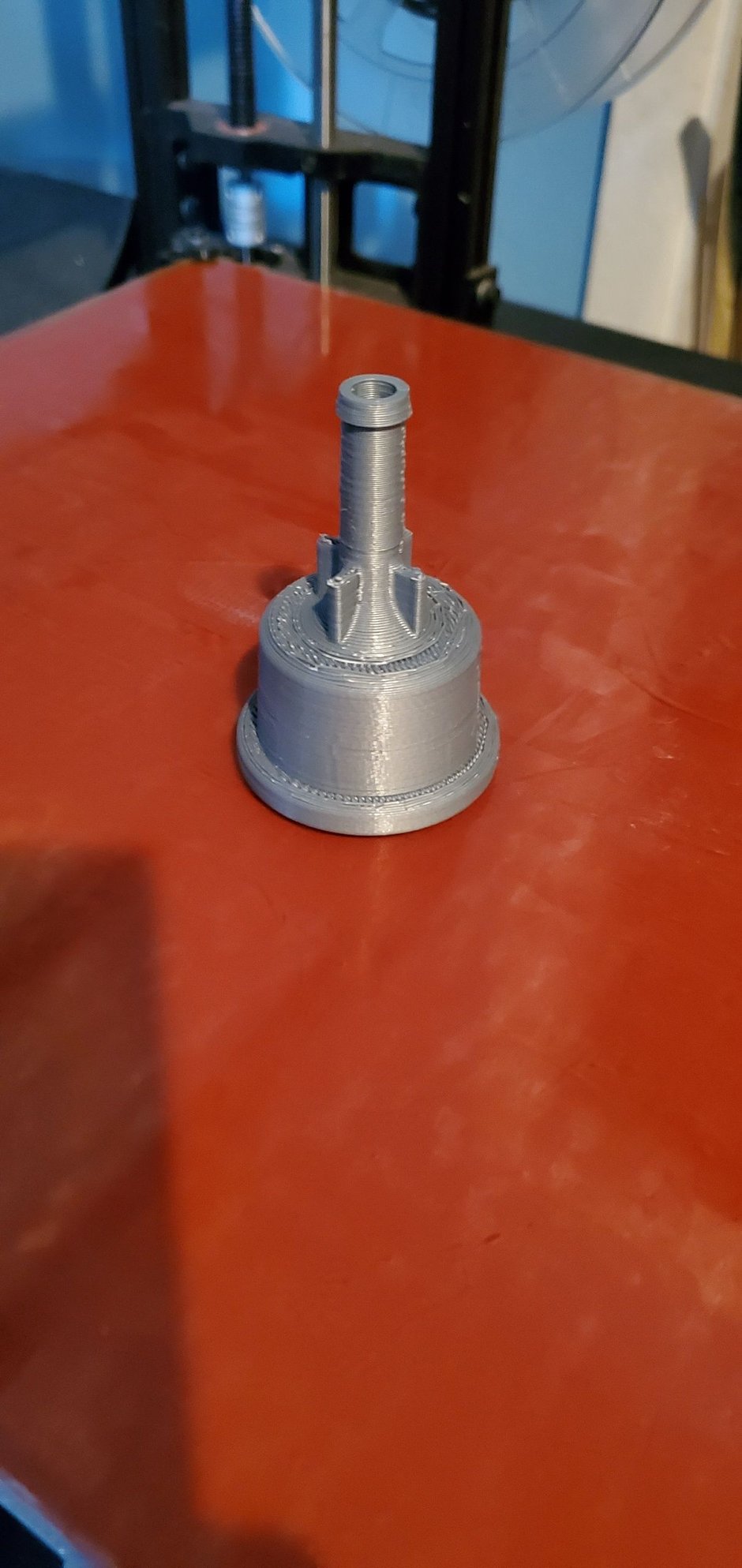

We are printing these for sale if anyone is interested
