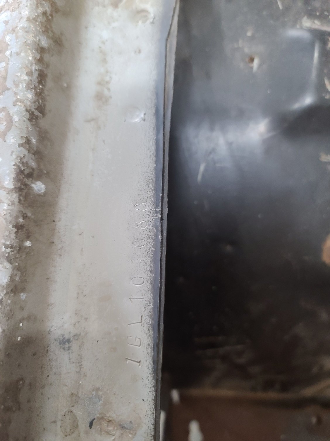

As others have said, and on my 86 it is stamped on top of the passenger side frame rail. It is pretty faint and if someone before you sprayed paint or something it could be very easy to miss. Heck I've had my car in pieces for a year and I've sat 2 feet away from its stamped location drinking beer and admiring the mess I've created. Having spent some time looking for it myself, I only just noticed it... the light hit it just perfect, it lit up like the holy grail. I'm not even sure why I even cared so much now...

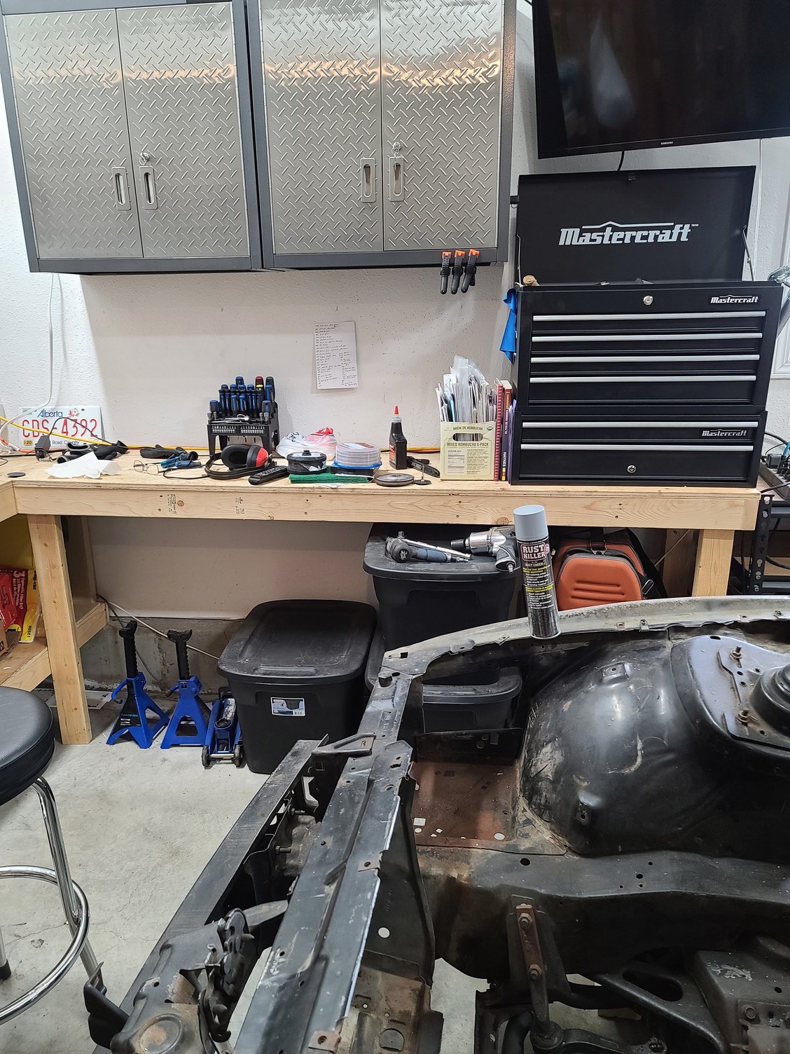

ya that would be frustrating. Not sure why they want that unless it came up as stolen in its history. Here is a pick of what your looking for. It seems obvious now, im not sure how I missed it. That can of rust filler is where its stamped on the fram rail. I imagine the location sould be similar but who knows.
