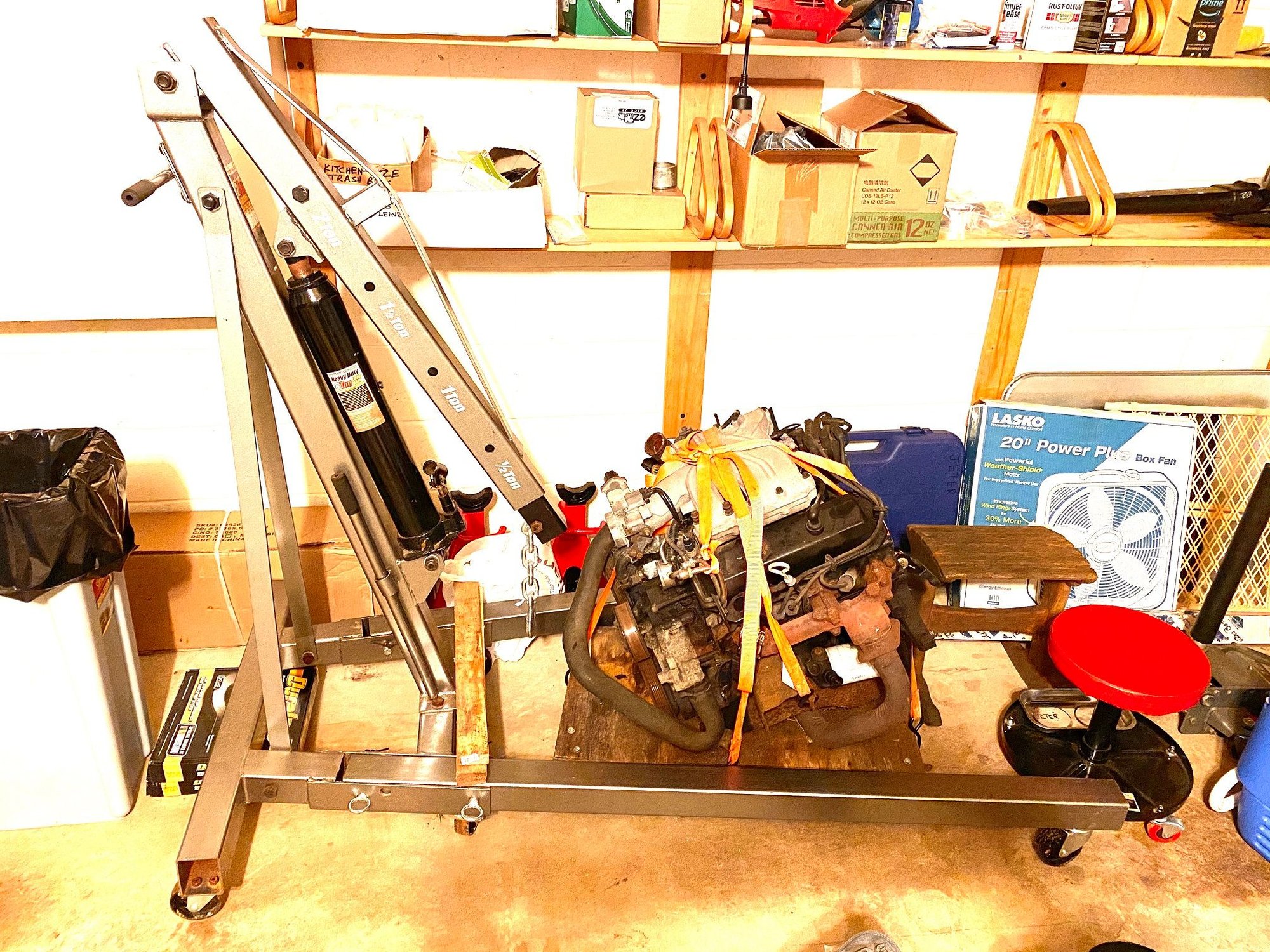

#343
Re: about to be a "new" owner of an '88 V6 Camaro
Need to get serious about installing that Pontiac motor.
The old 2.8 is getting TIRED.
