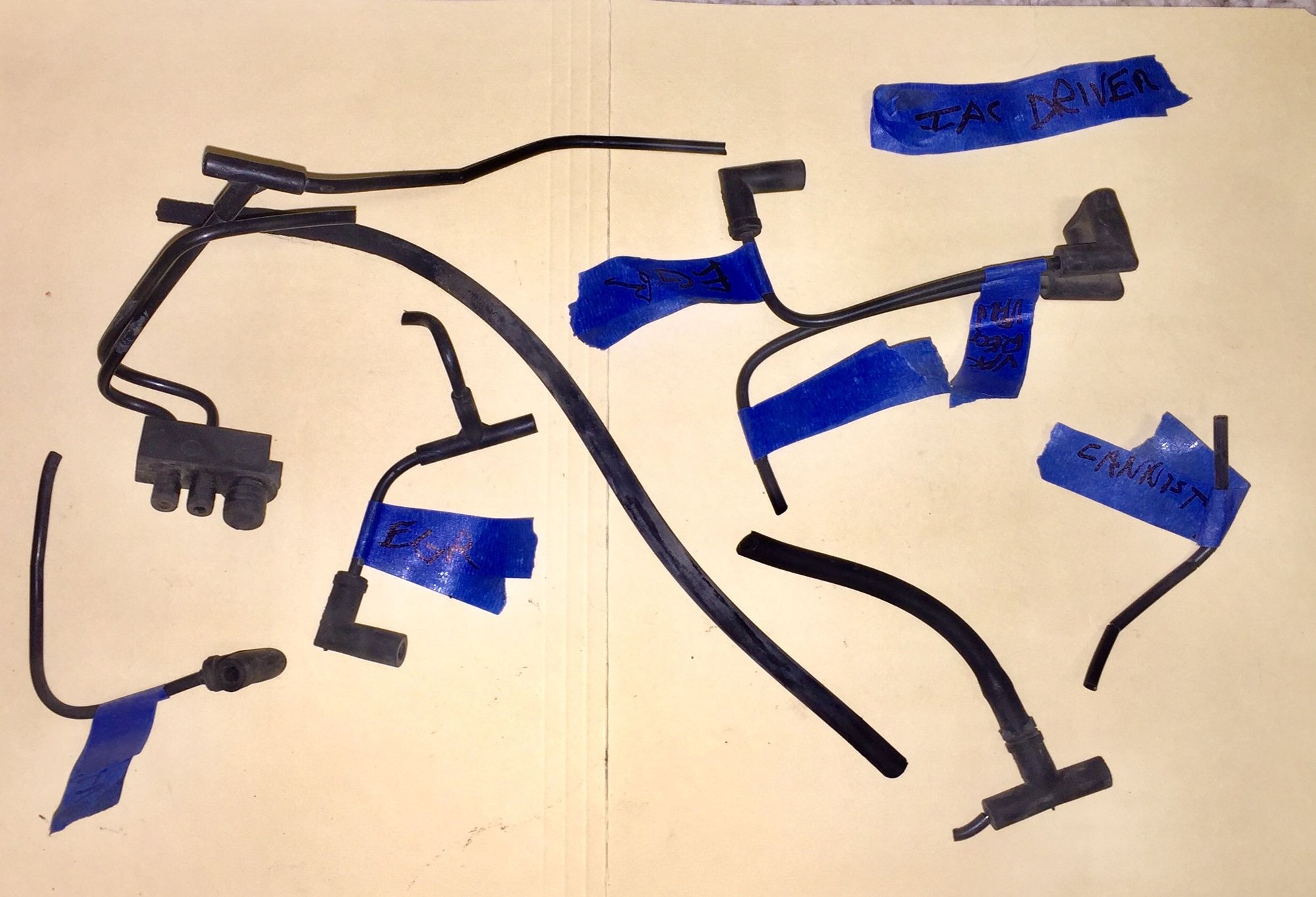

I got the notion I would do a "visual inspection" of the various small vacuum lines before "smoking" the intake system to discover further vacuum-system failures I might have overlooked.

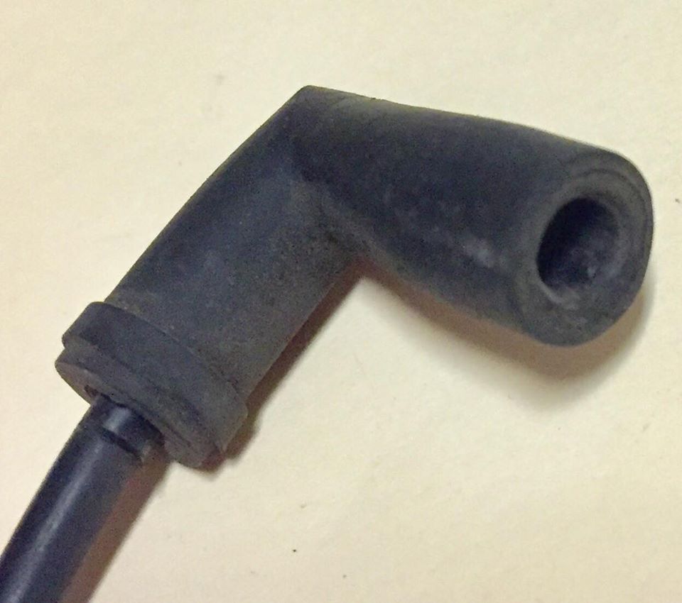

First, I find a perished cap-connector on the line to the vacuum reservoir (known to some of us as "the cannonball"). Easy fix.

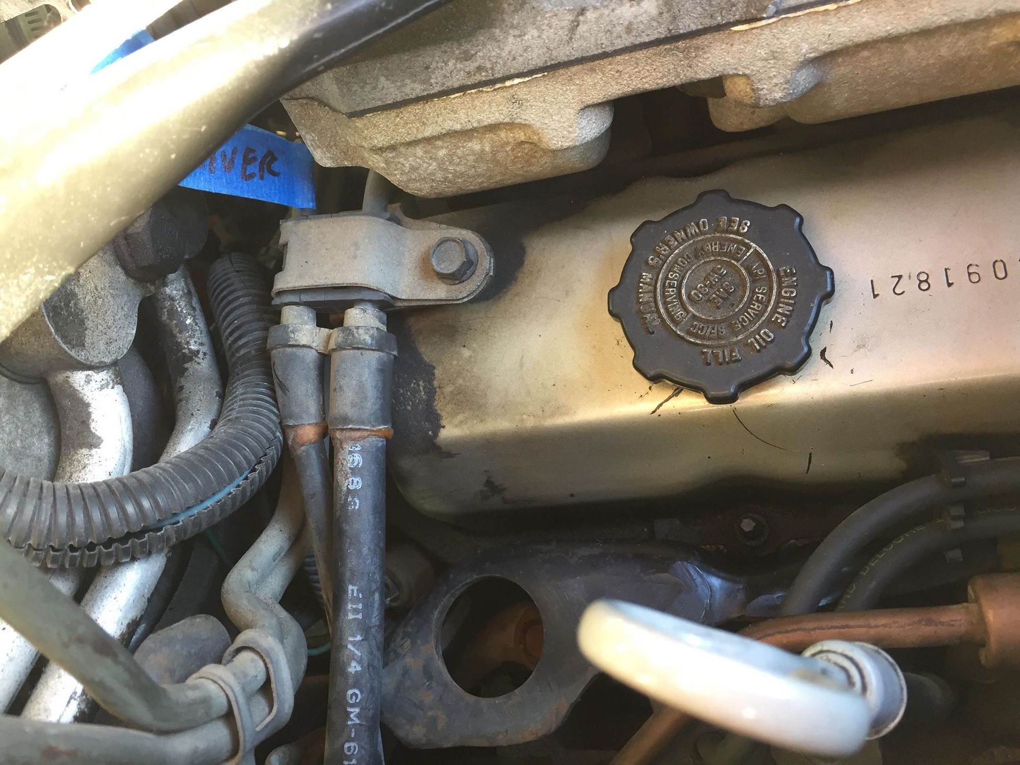

Then I observe the soft line running from the AIR pump to another unique "smog" device known as the "DECEL VALVE." This is where the trouble began.

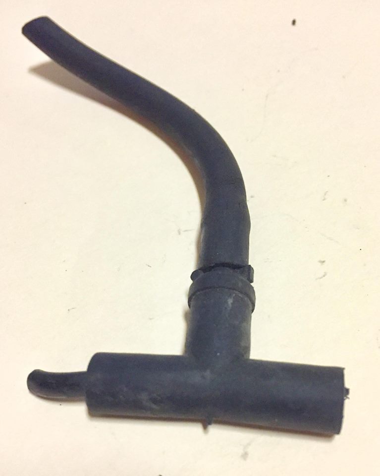

The soft line at the AIR pump connector was pretty rotten. The end of the soft hose pretty much crumbled when I attempted to disconnect it from the AIR pump. I figured the other end of the soft hose would be pretty similar. Of course, it connected to the vacuum system via a T-connector buried under the labyrinth of the intake plenum and all the other vacuum lines and system lines that are found in that tight space.
When I tried to disconnect the soft line from the tee, it didn't want to give. I tried various methods. Just as I thought I had the tee braced sufficiently for me to free the soft line, I heard that sound...
SNAP!!!
oh no...
Yes.
I did it.

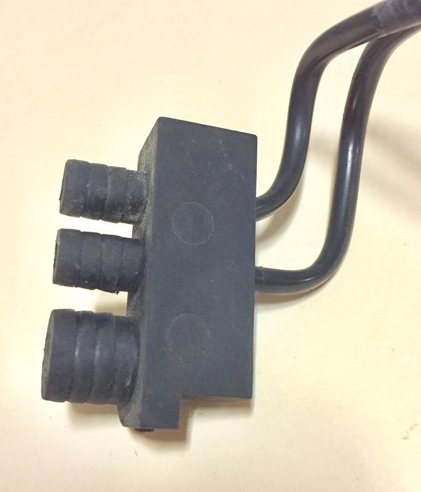

I snapped a hard vacuum up under the intake plenum.
I tried to free the hard line I had snapped. It was then that the other hard lines started snapping like an angry child playing with a box of uncooked spaghetti.
What have I done?
I managed to fish-out all the hard lines I destroyed. I gotta say, I'm feeling pretty down about right now. I pondered whether I should post this, because I know these sorts of things often elicit only derision on the internet. I've seen the remarks to the effect, "you're an idiot," "you should never be allowed to work on cars," "hit it with your purse," and on-and-on.
This sort of thing does make one question one's competence to attempt these sorts of jobs. I think I can fix it. But, I'm upset and perplexed, and not seeing a clear path to the solution at the moment.
Friendly advice would be welcome about now.
I've always looked at that "emissions hose routing" sticker on the underside of the hood with some trepidation. It really came home to roost in spades today.
I tried to label the broken bits as best I could as I was pulling the broken pieces out of the engine compartment. The experience was worse than this pic really shows, because some of those lines snapped (incomplete breaks) many times as I tried to free them. The sound of the relentless breaking was truly disturbing. Here is the carnage:

Thanks for all the support!
The anxiety of just completely breaking everything I touched was a tough pill to swallow yesterday.
That suggestion to run some wire or weed-eater line in the hard-line stuff sounds like a top tip. I am pondering forming some coathanger to model the routing for hard-lines, then trying to mimic the coathanger model with the hard-line stuff.
My kid bottomed-out his girlfriend's Corolla in some parking lot stunt at the beach two states away this week. Sent me a blurry picture of dirt and/or pavement embedded in the undercarriage and some broke body fasteners. Somehow managed to not breach the cooling or hydraulics. So, I'm motivated to cobble-together something in a hurry so I can at least pull the Camaro out of the driveway so we can pull the Corolla in and get it on jack stands for inspection if they can just make it home via other than a flat-bed.
I think I'm diagramattically dyslexic when I look at routing-diagrams.

Now I just gotta finess some new lines into the old connectors. Some of those connectors pretty ordinary 90-degree, or Tee. Others not so much run-of-the mill. Might try to get a few spares before I ruin the only ones I have.
