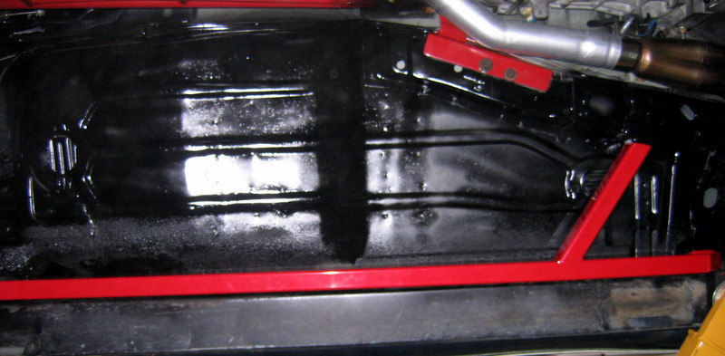

You can see the "factory" SFC's on my car here...

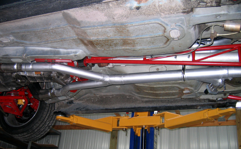

well i was searching and searching for a pic of the undercarrage of convertible 3rd gen and finally found a good one, off a ebay pic....so i thought i post it here to show what it looks like for the undercarrage support of a 3rdgen convertible. Also Ofkoz, i haven't ignore you about the information for my uncle's gta convertible. He just hasn't had any time for the past few weeks for me to go down and see it....but i'll keep you inform as soon as i can...

Looks fairly beefy. But I wonder if it is solid or a U shaped hollow piece of metal.
Twin_Turbo
close
It's thin sheet metal and it's pop rivited on. Frt quarters are cut to make room.

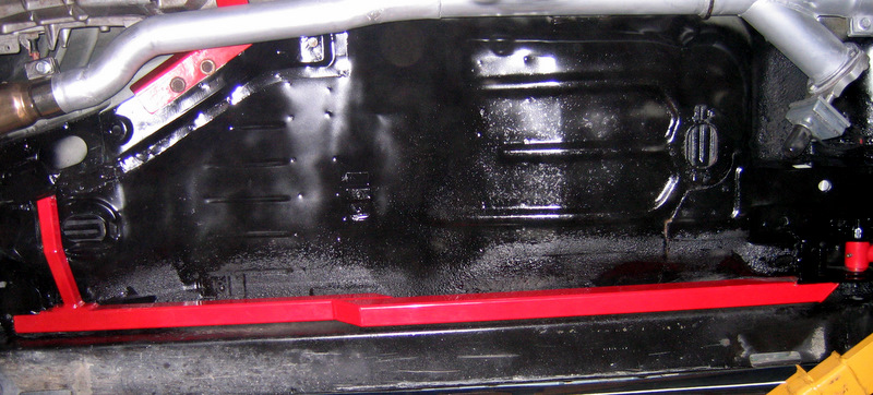

Here's a good shot of the passenger side:
You can see it's a u-shape, but is formed to follow the floor pan curves. It pretty much covers just the pinch weld and does not tie the sub-frames together.
The UMI pieces make great additions and improvement:
Kevin D.
