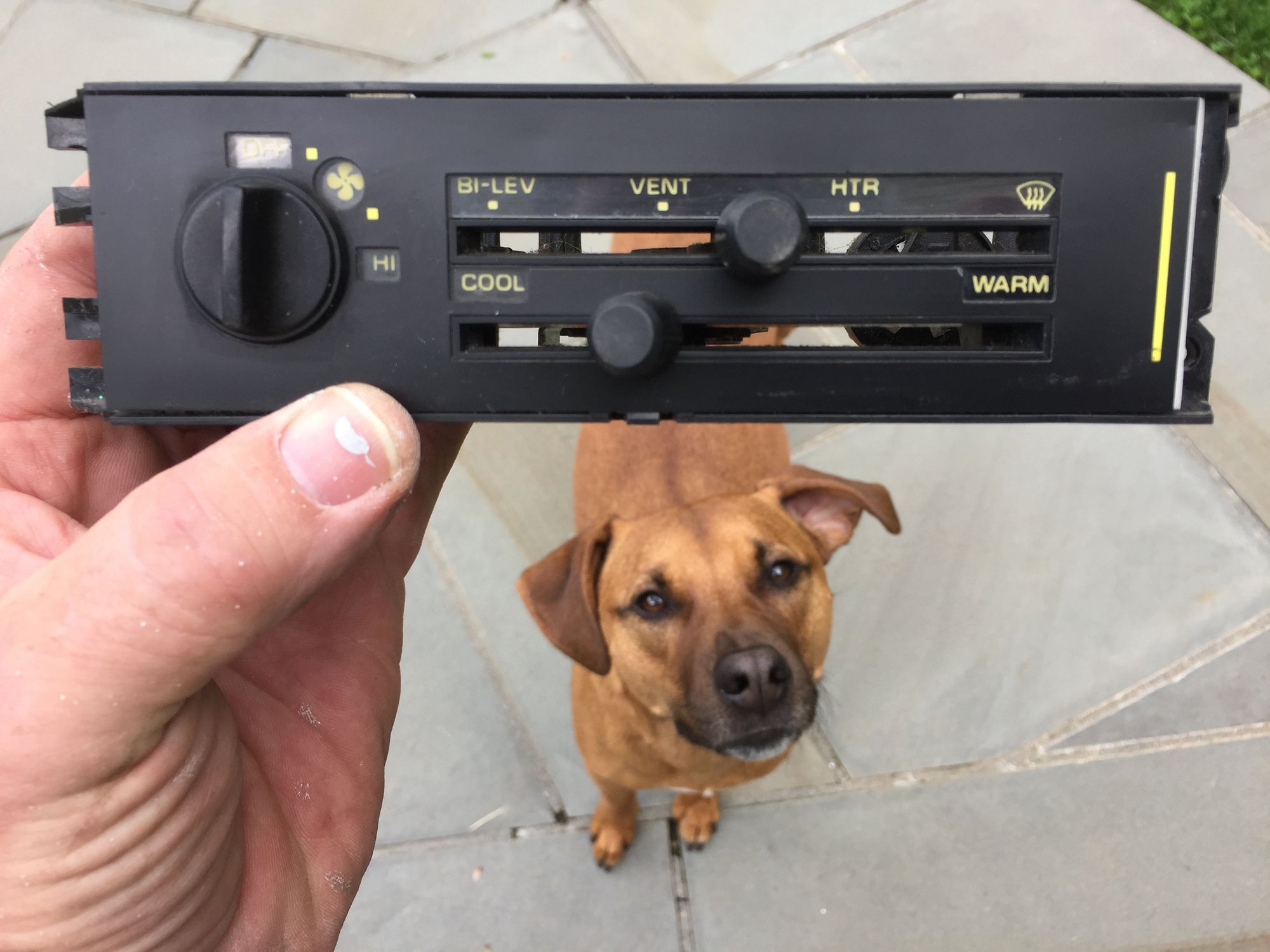

Re: Questions about differences betwee B4C,1LE and Z28/IROC
Originally Posted by Time2Fly
I think these cars are each unique in their own way. For instance, my 1991 non-B4C 1LE was delivered without a wonder bar - something I think most Z/28s and IROCs have. Oddly, it is an A/C delete car and was delivered with the standard A/C dash control unit. My car does not have a tank baffle, swinging pick up, or anything else out of the ordinary in the fuel tank. It also has the RPO DE1 which (in my opinion) is an odd option for a 1LE car.
I have a correct heater control if you need it, but it won't be cheap, the photo bombing dog is not for sale.
