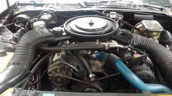

Air cleaner, coolant hoses, worm-gear AC repair, wrung leather on the steering wheel, electric fan swap, CS130 alternator swap, new tires. There is enough going on there that the mileage may be in question. And who puts a 10-disc CD changer in a car that's hardly driven?

Eng.

That's why I share these when I find them. When I see some of the little things you guys notice I question how much i really know, lol! Biggest thing I caught was the dual snorkel air cleaner. Could it be an 83 l69?

This car has a ULTRA RARE 1 of 1 dual snorkel LT1 350 in it !!!!!!!!
Guy who's selling it has NO clue what he has and just trying to flip for $$$$

Did anyone notice the valve covers? Look to be Corvette pieces, but maybe just centerbolt valve covers. "LT1" could be code for an L98 long block, or ZZ4 swap, or who knows... But I'd suspect the 305 is long gone. Not a low mileage original car by any means, and not a $20k car. It's probably more like a $6000 car.

There's no baro sensor, so its probably not an HO, even if its an 83.
The pointer/s on the gauge/s are not the early tapered style, but the later cut down tip/s style.You can just see it on the tach too in the other pic.
Wont those AC hoses leak when pressurized?
You can get by with it sometimes. Obviously a whole lot less reliably than properly repaired crimps. And especially if the higher pressures of R134A are used.

The least he could do is use high pressure EFI hose clamps
