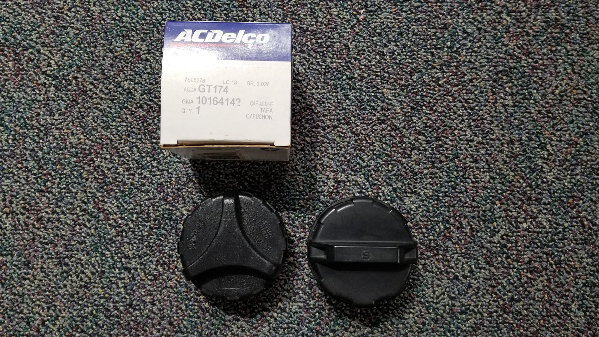

Gas Cap Woes
Over the past few years I have noticed something, it appears that gas caps are becoming difficult to find one that fits. Both my 87s, and my 89 have the original gas tank. A few years back I bought 3 GM gas caps, BUT every replacement cap I have (even the GM ones) do not have the correct thread. It is like they are too large, and the thread is wrong.., they kind of fit if you fiddle and monkey with it, They do not screw all the way down either, so they do not seal correctly, and in some cases leak if you just filled up!!!
The ONLY car that I have a gas cap on right now that fits correctly is my 87 Formula, I can easily spin it on, and then it clicks.
Anyone have any luck with any gas caps? I should take some pictures this evening to show what works and does not work.

Most of the "GM" caps have the Stant S logo molded right in on the cap.
Looking on Ebay at NOS caps, plastic caps in the blue/white GM boxes have the Stant S mark too. Getting really whacky, some of the old metal gas caps have the S stamped in them.
Stop at your friendly corner gas station and ask the clerk if they have a gas cap lost and found. I'm just going to spitball here, and say that if you ask 2 or 3 different stores, one or another will probably send you home with as many as you could ever want.
Old Jul 18, 2018 | 03:14 PM
okfoz's Avatar
Posts: 14,298
Likes: 197
Engine: 5.1L TPI, 5.0L TPI
Transmission: 700R4, M5
Re: Gas Cap Woes
Yep, that is the POS I have... Tried to keep my car GM as much as possible, and ended up being crap.

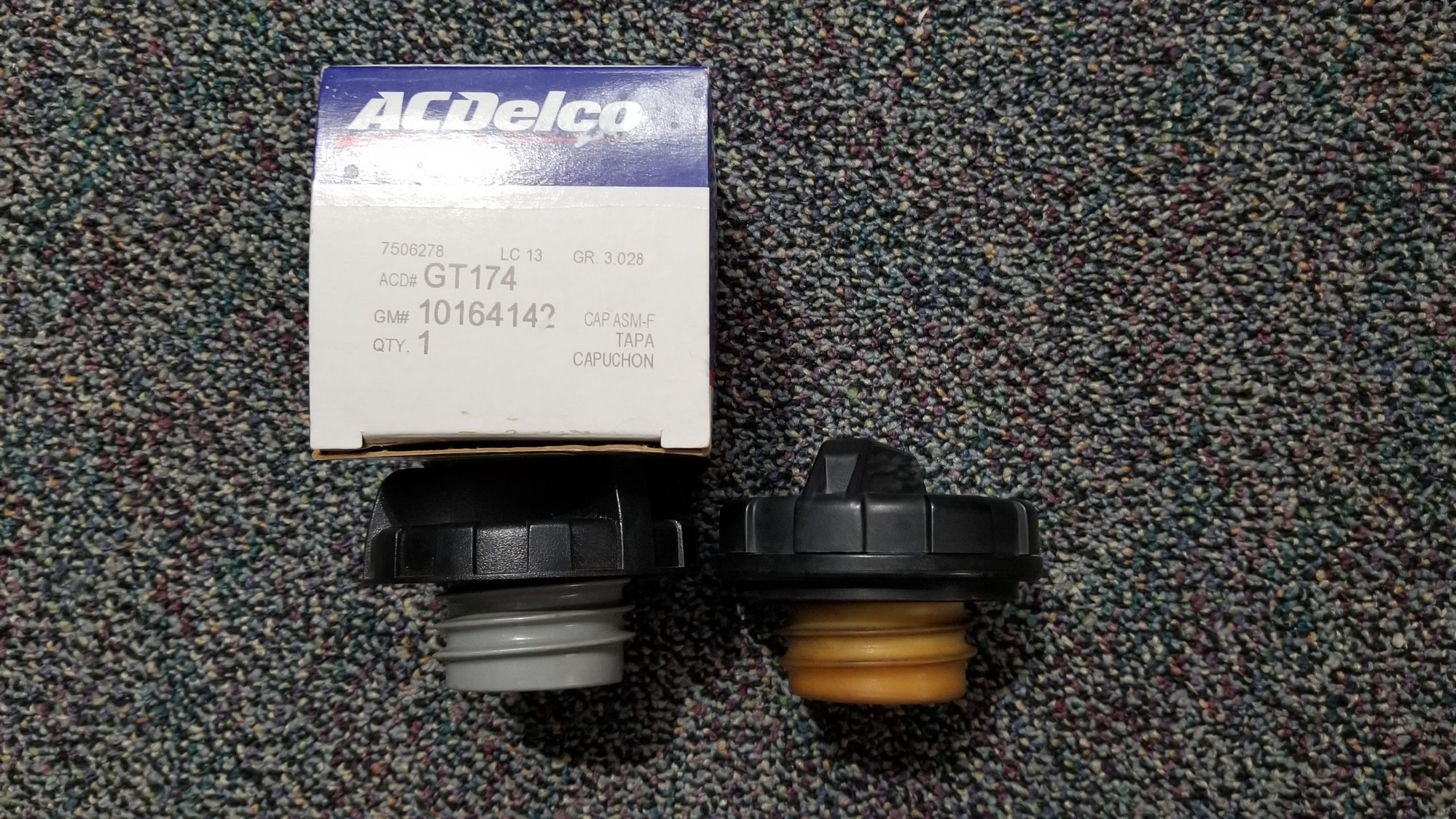

Old Jul 18, 2018 | 03:27 PM
okfoz's Avatar
Posts: 14,298
Likes: 197
Re: Gas Cap Woes
I have the top one of the 2 pics. 3 of them.

Old Jul 19, 2018 | 01:16 PM
okfoz's Avatar
Posts: 14,298
Likes: 197
Re: Gas Cap Woes
Notice the thread on that metal cap, it is finer than the replacement caps.

Here's one I bought maybe 20 years ago that's still in the box. I dug it out when I saw this thread to compare it to my factory cap. Same box as shown above in this thread. Same part number. But completely different cap, nothing at all like my factory cap. But the threads match, and it fits perfectly, although the triangular handle is awkward to turn. It says Motorad on the cap. Here it is compared to my factory cap, which doesn't leak and is still on the car.
Originally Posted by 84 1LE
I used to just swap the big o-ring when i ran into this issue. Which was usually when the smog guy would tell me my cap was leaking.
The smog techs in CA love to pull that scam. They never replaced mine when I lived there, but they always fiddled around with it. Twist it, turn it, take it off and examine it. Look at me but never say anything. Fiddle with it some more. Look over at me again. They'd eventually put it back on and pass it, but it always seemed like he was thinking about saying something to me, and if I hadn't been watching his every move, he might've tried. But that's a good idea. The O-ring on my factory cap is cracking, but it's still solid and holds pressure.
If you look close the Cap on the right the thread is flatter, the threads on the right are more aggressive.
