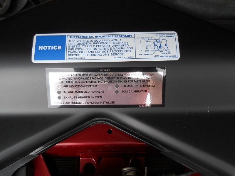

Stolen info on the SLP package from this site:
http://www.gtasourcepage.com/techspecs.html
For 1991 and 1992, GM offered the SLP Engineering "Street Legal Performance" performance kits through GM dealers. These kits were offered either as a dealer-installed option or could be installed by the customer. Each kit consisted of the following: 1) SLP Hi-Flow Aluminum Siamesed Intake Runners, 2) SLP Tri-Y Stainless Tuned Exhaust Headers, 3) SLP Low-Restriction Stainless Exhaust System, and 4) Revised Engine Cal-Pac PROM (specific to application). These kits were the first GM-authorized totally integrated performance upgrade packages for TPI-equipped cars which substantially improved performance without sacrificing fuel economy, drivability, and emissions legality. These kits were warranteed through GM by SLP Engineering. Engine power increased by 50 HP at 5500 RPM, long above the point where the stock LB9 and B2L stopped performing, and there were corresponding torque increase from 2800 up through 5500 RPM. Each part was also available seperately thorugh GM dealers. There was also an available SLP Cold Air Induction Package that was not part of the complete kit, but sold seperately.
The kits were offered specifically tailored to the engine the car was equipped with and other variables. The part numbers were as follows (these numbers are the ones relating to GTA models; kits were also available for other Firebird models as well):
1987-1988:
GM # 12341390 -- 305 TPI with 3.08 ratio - Single Exhaust (S.E.) -- $1,930
GM # 12340391 -- 305 TPI with 3.23 ratio - S.E. -- $1,930
GM # 12341392 -- 350 TPI with 3.27 ratio - S.E. -- $1,930
1989:
GM# 12341393 -- 305 TPI with RPO N10 -- $2,085
GM# 12341394 -- 350 TPI with RPO N10 -- $2,085
1990-1992:
GM# 12341398 -- 305 TPI with RPO N10 (91-92 RPO R6P) -- $2,085
GM# 12341399 -- 350 TPI with RPO N10 (91-92 RPO R6P) -- $2,085
All of the package components were also available seperately through GM dealers. The cost of the components were as follows:
Tri-Y Stainless Exhaust Headers: (1987-88) $1,050, (1989-92) $1,100
Stainless Free-Flow Exhaust System: (1987-88) $390, (1989-92) $415
Hi-Flow Siamesed Intake Runners (specific to model year application): (1987-92) $450
Cold Air Induction Package: (1987) $295, (1988-92) $270
1987-1988:
1989:
1990-1992:
1987-1988:
1989:
1990-1992:

Thanks for the photos Drew. I have saved copies for my future reference.
So some years, OTC parts only. Other years packages and OTC parts. Interesting.
And no cold air intake in the package...add a better manifold (or runners anyway), exhaust, and timing/fuel via chip, but keep the factory air cleaner assembly. Interesting.
So is the .75 or so second 1/4 mile difference between the two LB9/5-speed cars just a weight difference between GTA convert. and Formula? Or was there a gear ratio difference for the vert?
