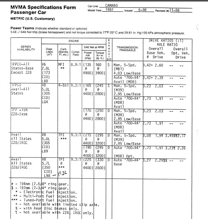

I forgot I've got the order guide for 1987 Camaro and it does also agree with the tech data that I quoted where 3.45 is optional while 3.08 was standard. This is the chart for the B4Z-Z28:
Note this was an early print as there is no L98 referenced.

And don't forget this from the order forms. Notice the 3 asterisk on the 3.08 for the 5.0 liter TPI V8. Under the box, it states that the 3.45 was standard on the IROC-Z, which means the 3.08 was standard on the Z28.

Yours shows the 5.7L where mine doesn't due to an apparent earlier print.
So in that regard, was this a change shortly after 1987 MY? Charlie states seeing a few non 3.45 gears and my early sheet supports that. Since your sheet shows the 5.7L, it was a revision at some point.
Here was the full sheet. So it's the correct application:

I looked at the PDF that you can download from GM's Heritage site, which I believe is where you got the power team sheet (mine came from a dealer manual I have), and I noticed this sheet:
Notice this also states the 3.08 was standard on the 5-speed 305 for the Z28/IROC with 3.45 under the optional.
Still looks to me this was some sort of change in the 1987 MY based on different GM documentation. Or an error that populated through the documentation and passed different revisions.
