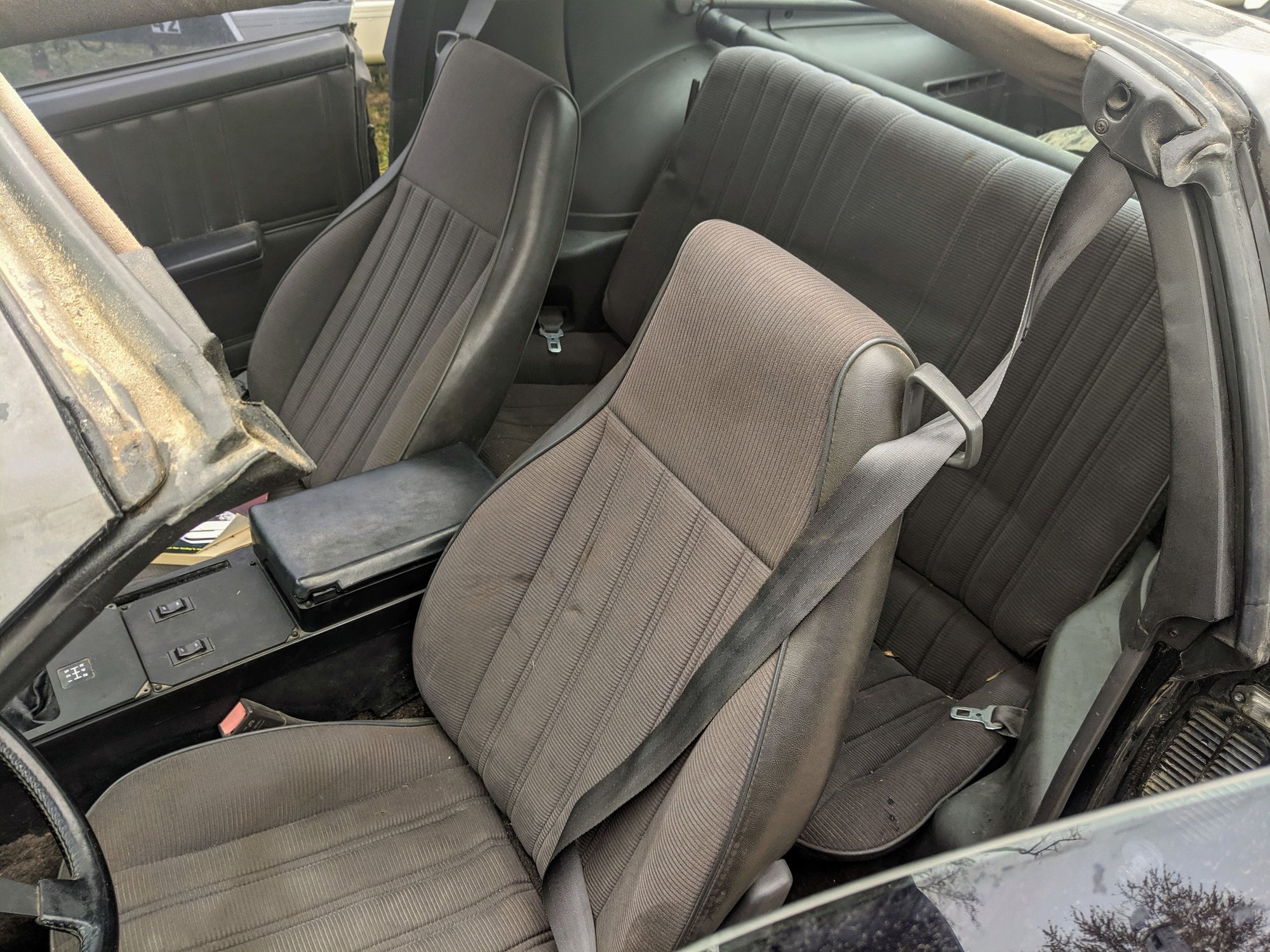

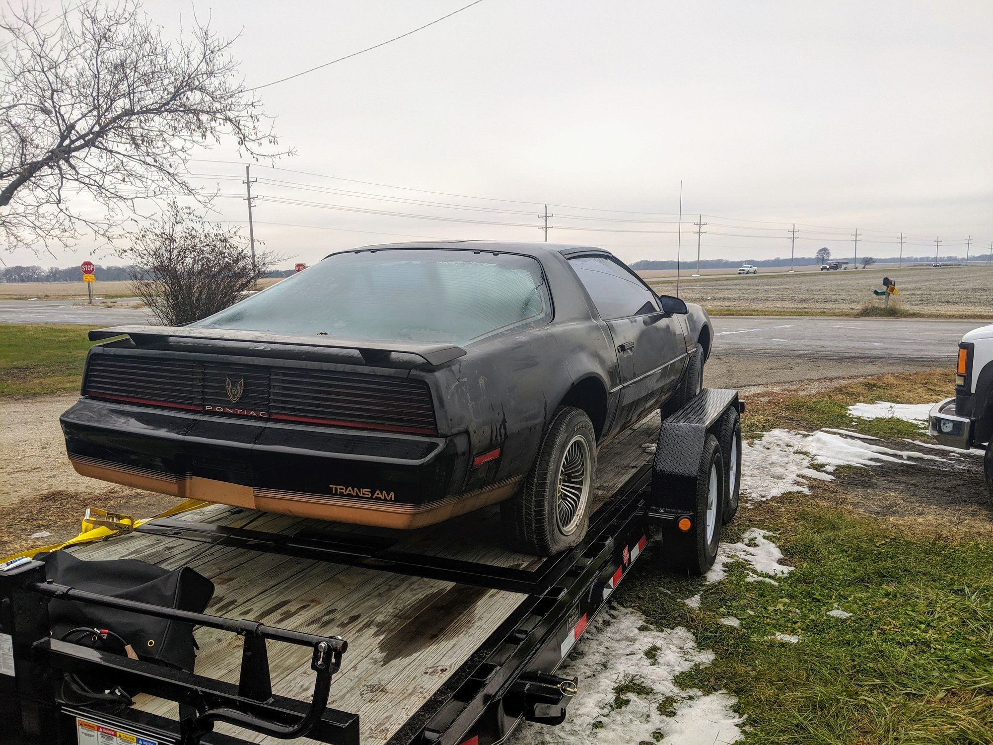

As the title states, I picked up a super cheap roller last week. It came up on Marketplace for $300 and I saw an uncracked dash and good tail lights, figured it'd be well worth picking up as a part out car. Fast forward an hour, I get it home and start to dig... There's zero rust anywhere, it's a T top car (genuinely didn't notice when winching it onto the trailer), 3.73 posi disc rear, brand new OEM gas tank in the back seat, interior is in pristine condition and I hooked up a battery, all the lights work. Was originally an L69 5 speed car, drivetrain is gone but the car is complete otherwise. Paint is rough, but it's all black and gold. Clear Illinois title.
My question is, where would you guys go from here? My current plan is a mild 350/T56, buffing the original paint and driving the car. To do this, I'll have to sell my fairly rusty/rough '91 Trans Am convertible with an immaculate interior and digital dash swap.

nice score! besides the obvious, it looks like it's only missing a few things - radiator, shroud & fan, and the front air deflectors.
deep clean the interior, install a tranny & crate motor and start driving that sucker.

Do thirdgens ever buff out? Pretty sure if the paint looks bad now, there's not much cleaning it up. If it's base coat/clear coat, it'll probably shed the clear before it cleans up. Point being, plan on needing paint.
Aside from the pain of labor to install a drivetrain that is less than ideal, you could look around for a junkyard V8 with a roller cam and a used T5. Do it cheap and end up with an enjoyable car. Then you could stack em up like the rest of us, because be honest, no one stops at just one.

Wouldn't an 84 HO have a single electric fan? Shouldn't be hard to come up with, it's the same setup they used up through 92 on the 6cyl.
I wouldn't bother trying to make it original. It's arguable if an 84 305 anything will ever be worth more as a stock HO vs a mild 350 with a 4bbl and headers that fits under the hood. Potentially I could see the car being worth more with a more realistic drivetrain. There's a lot to be gained by simply going to a 87-up 305 to get the roller cam and 1pc seals. A TBI or Vortec 350 truck engine with a cam swap would be a nice upgrade, as would a World Class T5. I'm not suggesting to just throw together some junk, but there's a huge margin between picking up the latest wonder LS(?) crate engine, and a 10-speed manual trans, with Death Stars and "My 900hp...", etc and having a roller rotting out back.
I wouldn't 'rebuild' or 'freshen up' or whatever euphemism, a 305, or even an older 350, but I could see dropping a healthy used engine in a roller to make it a complete car. But maybe that's just because I have a... uh... Well, it'd be a roller if I put the suspension back under it... Sitting in the garage going on 4 years now... I don't think I'd want to recommend someone sell a car they enjoy, that drives, to fund rebuilding a car that doesn't drive and won't drive any time soon, without a good reason. IF that makes sense.

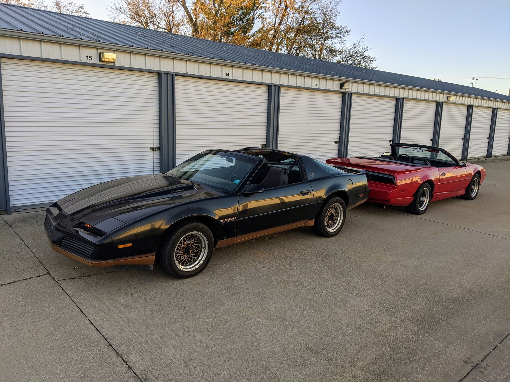

It's been a learning experience, but the car has cleaned up extremely well so far.

Are you sure that's an 84'? It has the 82'-83' lower body spoilers in front of each wheel and the open grilles in the front bumper. The 84' Trans ams had ground effects and closed panels for the front bumper grilles.
If it is an 83' that had an L69, that would be somewhat rare since they didn't make very many. Still, it wouldn't be worth trying to put it all back to stock. Build it the way you want it. Seems like a solid starting point.

I was actually somewhat excited that my car doesn't have the ground effects, as most '84s do. It's definitely an '84, only W62 RPO cars got the ground effects. I do plan to swap to the closed front grilles though. Thank you, though! I'm sure it'll be a fun car finished.

Wound up getting it running, the '91 is still up for sale. Went with a 406 and a V6 T5 in the black car to get it running, still hunting a T56.

looks great in the picture! congrats.
