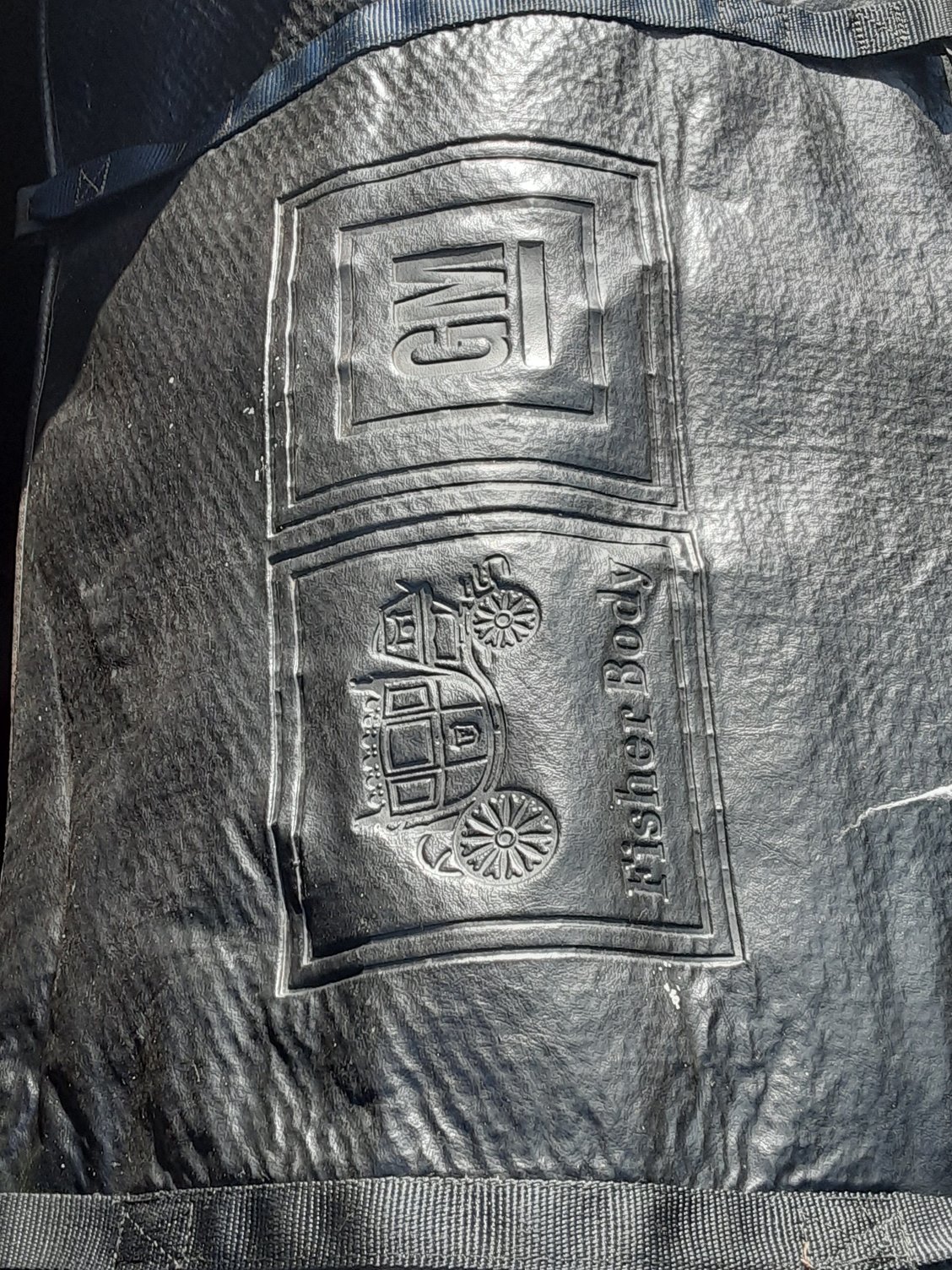

Just a few photos and gauges are standard not metric thanks again for the help i love the car either wayand i dont see any around where i libe

Looks like a 3rd party dealer-installed plaque to me. I don't believe anything like that would have come from the factory. There's a member on here who had the last Third Gen built and physically stood with the car as it was being built. He also had it signed by all kinds of the plant workers, and even he didn't get a plaque

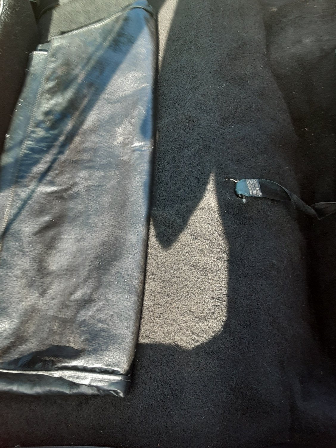

I am not sure what type of T-top that is, it doesn't appear to be a factory style. Also no hooks for the bag in the rear.
Most likely somebody that wanted a 5.7 GTA & had the tops added to get both options.
The dealer could have sent the car out for them as well. I wonder if the cost of those were more than the CC1 option?

Those are definitely Cars & Concepts aftermarket T-Tops. The T-Top conversion was probably done or sent out to be done by the original selling dealer. Pretty common for particular combinations (like this one) that we’re not available with T-Tops from the factory.

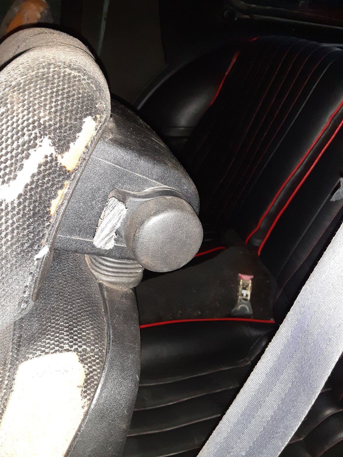

Had my back seat reupholstered in leather ready for the front now stupid question how do i take the adjuster **** off my head rest i dont want to break it parts are hard to find and yes some one cut the seatbelt guide off im looking to replace those as well if you have any info on where i could get them thanks for all your help car is finally coming together
That black plastic **** is a cover for the **** assembly. It simply peels off of the **** assembly. Remove the black **** cover and you will see there's a screw in the center holding the **** assembly to the headrest.
