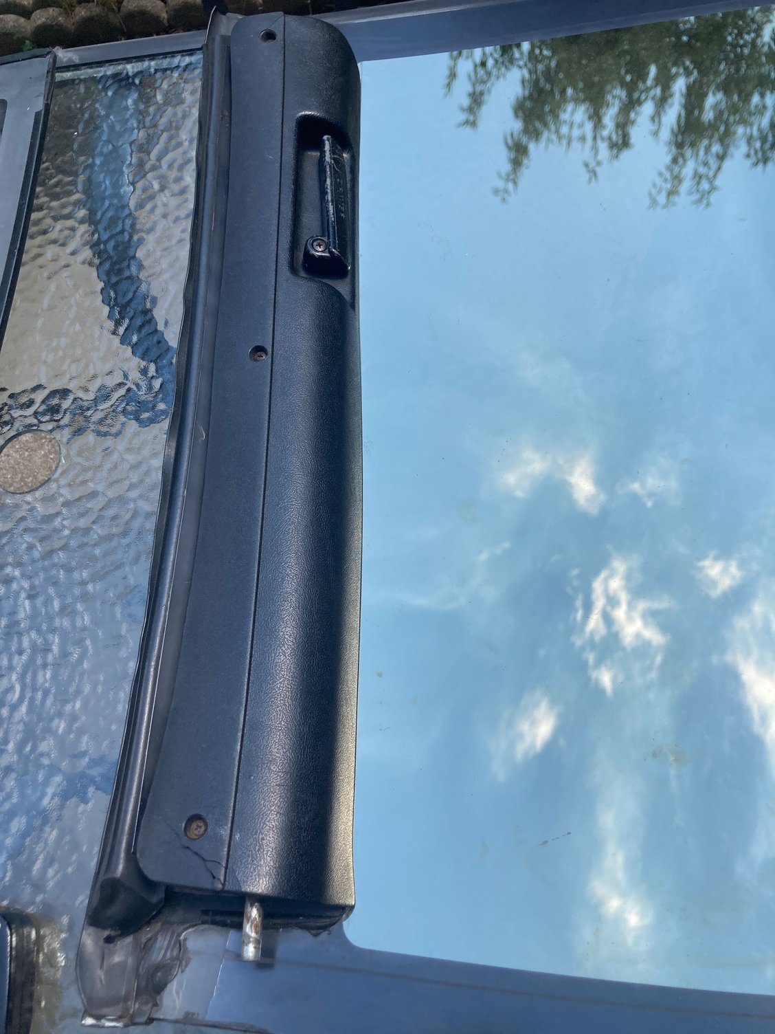

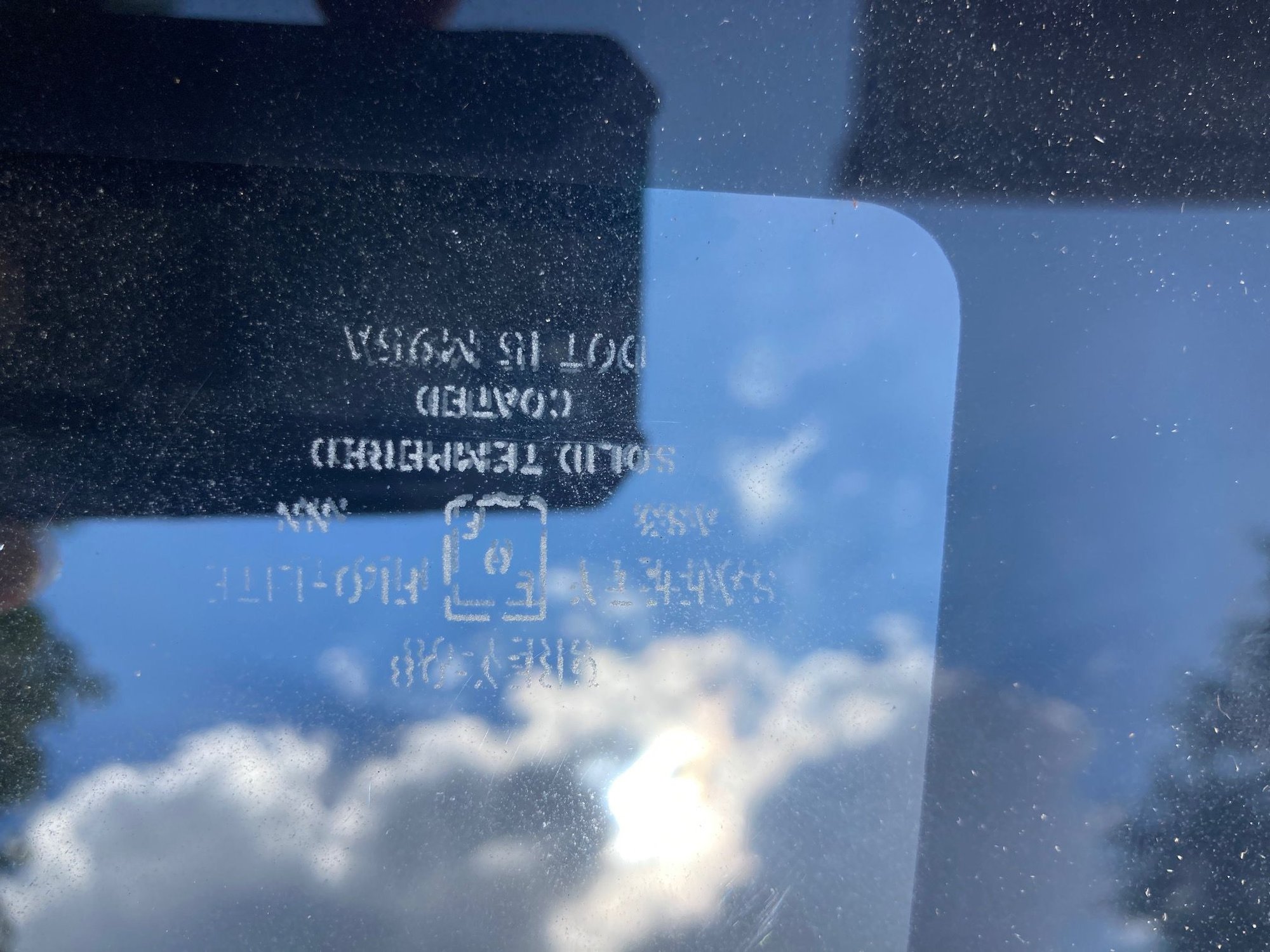

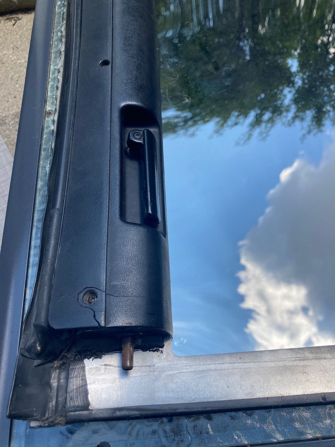

Hey, I have this pair of t-tops I got when I obtained a batch of parts. The guy I got them from didn't know much about them so I am hoping you experts can help ID them. They are not in great shape but could be savable. What I can tell you beyond the pics is that they do NOT fit my '87 with CC1 tops as they are just a bit too large. I am guessing they are an early 3rd gen set but not sure. Any help appreciated.

Based on an 84 I am working on these are 84 and up. They have the pin latching mechanism whereas my 83 has the pivoting, for lack of a better term, latch type. Not sure if they changed again in later years.

I said these tops did not fit my '87. That is sort of true. I have learned that there are different latching mechanisms (hook, and two sizes of pin) as well as different weather stripping fitments. I believe these tops are the same molding width and glass shape after all but the weather strip is different. I also learned that the pin latching has adjustment to it which may be all these need to fit.
I found that Cars & Concepts versions are aftermarket whereas RPO CC1 on the SPID should indicate factory Ttops by Fisher. I also found that some Fisher Ttops had an edging around the front/rear/inside glass edges like the one pictured in my first post.

Other threads tell me the "Lexan" tops are actually acryllic (Lexan is a trade name of similar material specific to the company holding the trademark) and were made by a company called Lexamar which is the likely source of confusion on that.
In conclusion, I believe the answer to my original question is that I have 1984-85 factory Ttops.
Both these and the tops from my '87 seem to have pins that measure about 0.38" in diameter. What remains unknown to me is: what is the diameter of the other size pins and what years were they available?

Those t-tops in the first post looks like G-body t-tops.

Dont quote this... but I was reading something that the pins on some are as stated larger than others, Some have a plastic sheathing on the pin or something to help guide the pin into the lock.... but any PIN GM t top is interchangeable.... but any of the 82-83 latch / hook style is not, and of course the aftermarket C and C t tops are not interchangeable as they are specific designs. . The trim around the glass varied from year to year and was cosmetic . and not important. C and C cars had a black trim piece on the back of the tops on the roof / body of the car right above where the door windows roll up to.
So supposedly, GM pin type t tops including Lexan tops would all be interchangeable regardless of pin size...... its just might be harder to close and lock the pins depending on what the car came with... ........supposedly. the pins / locks appear to be able to be removed and transferred over to other t tops as well to keep the cars original keys.

The ones I posted which I believe are 84/85 fit in my 87 but the weather stripping does not line properly. Maybe could be made to fit? Not sure.
