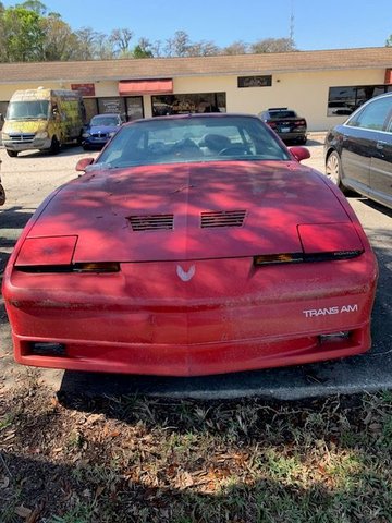

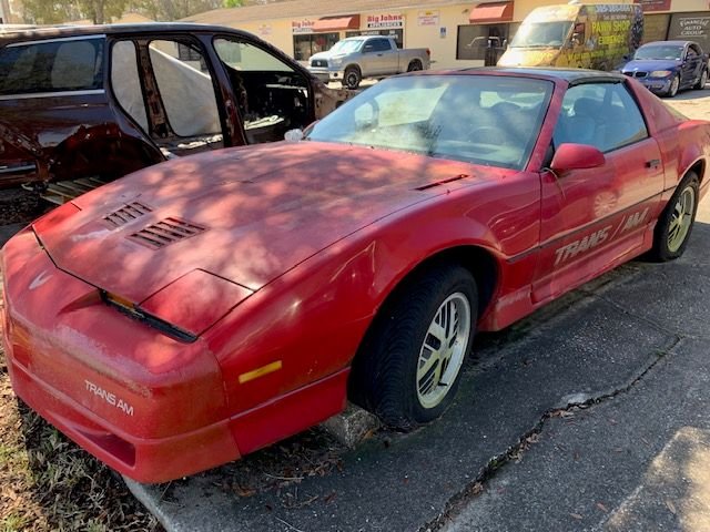

I've seen this Trans Am sitting for over a year or so here locally and and not sure what year it is to be exact but looks to need lots of TLC. I contacted the business this was sitting in front of and got some info to contact who was responsible for it. Not sure how this works in the State of Florida... however there is no title or paperwork on it. They want $1k for it as it sits. I may talk them down some but curious what you all think here. Is it worth the hassle or not? Vin is in the pics and other pics below... Want to get back into another third gen and wondering if this i worth restoring? Currently it doesn't run and I'm sure there are a myriad of other issues as well... Thanks in advance!

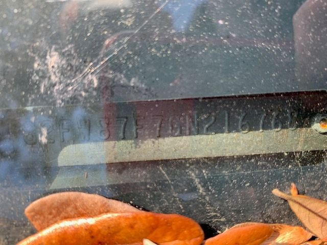

The hatch mounted 3rd brake light indicates 1986, and the VIN decoder here on TGO (in the "Tools" dropdown menu in the top margin) confirms it's a 1986 Trans Am. The 8th digit of the VIN (F) indicates the LB9 5.0 TPI engine.

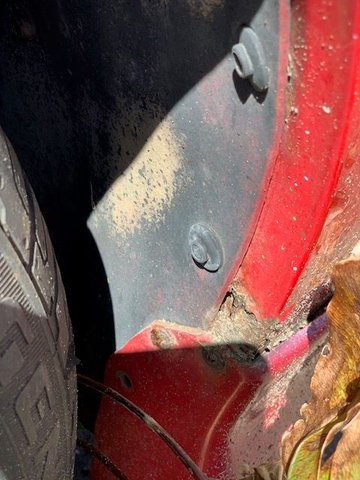

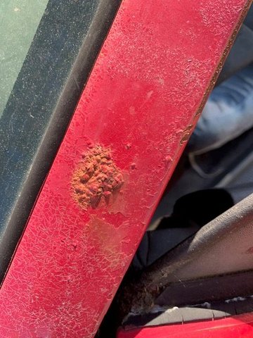

Thanks for all the replies. I took more pics but will post them later. Found more rust problem areas and think i would be in over my head trying to restore this car. I'm better off finding one with a title and no rust plus less problems. The under carriage looked pretty clean and no rust, just the outside panels and the drivers side inner
t top rim/lip.

That's not its original engine. 86 had neither centerbolt heads nor a serpentine drive. But that's a good thing, as the 86 LB9 had the peanut cam. That's either a newer LB9 or, for someone to have gone to the trouble of swapping the engine, that might be an L98.

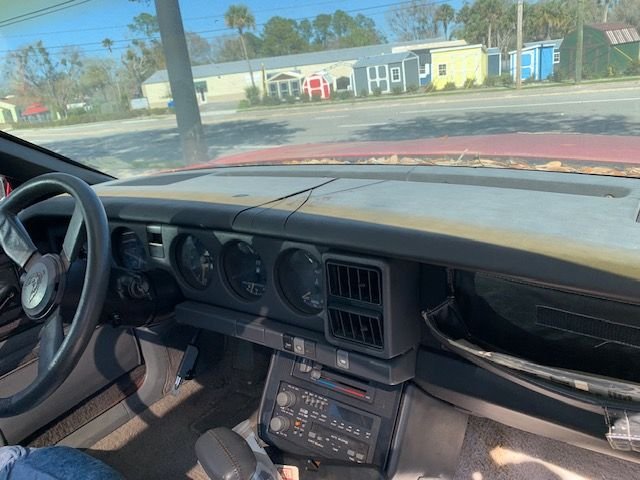

As for the interior, if even just one rodent lives in there (and they are not noted for being 'solitary,' IYKWIM), the car may need an entire new interior. What about the power train? Is the engine seized? How about the transmission, brakes, fuel tank and lines, suspension, wheels/tires, and on and on; what is their condition?

I do agree with others that the rust on this car precludes it from being a reasonable candidate for a restoration. The thing with these cars is with all of the plastic body cladding, a lot of the rust is very well hidden. Once you start to see the rust on the outside, like with this car, the underlying rust that you don't yet see is really bad. If one were to take this car apart, I would expect it will need T-Top channels, partial or full floorpans, front inner/outer rockers, cowl/firewall repair, strut tower patches, rear inner wheelhouses, partial quarters, maybe doors, maybe fenders and probably a bunch of smaller patches.
My car had no visible rust on the exterior and when I tore it down to a shell, I had to address most of what I listed. It was surprising how much rust there was on a car that appeared to be very clean. This one will have significantly more.
If you want to do a restoration, finding a rust free starting point, even for more money is going to be better and less expensive overall.

my car had similar levels of rot when I bought it and I would not be eager to do another restore like it. It could definitely be saved if you have the time and enjoy rot repair projects, these cars aren't exactly fun to patch up though.
As TransamamGTA350 said, the rot you can visually see is usually only 40% of it. Once you pull up the carpet, take off the ground effects, etc; you will see how deep into the cracks and crevices the rot goes. you will have to cut out, make patch panels, and replace so many annoying and intricate sections.
The T top channel rust repair isn't fun at all either. I have a thread on how I repaired the t top channels on my car with new metal and it was an annoying process. If I'm ever in the market for another one of these cars, it will be a hardtop lol.
