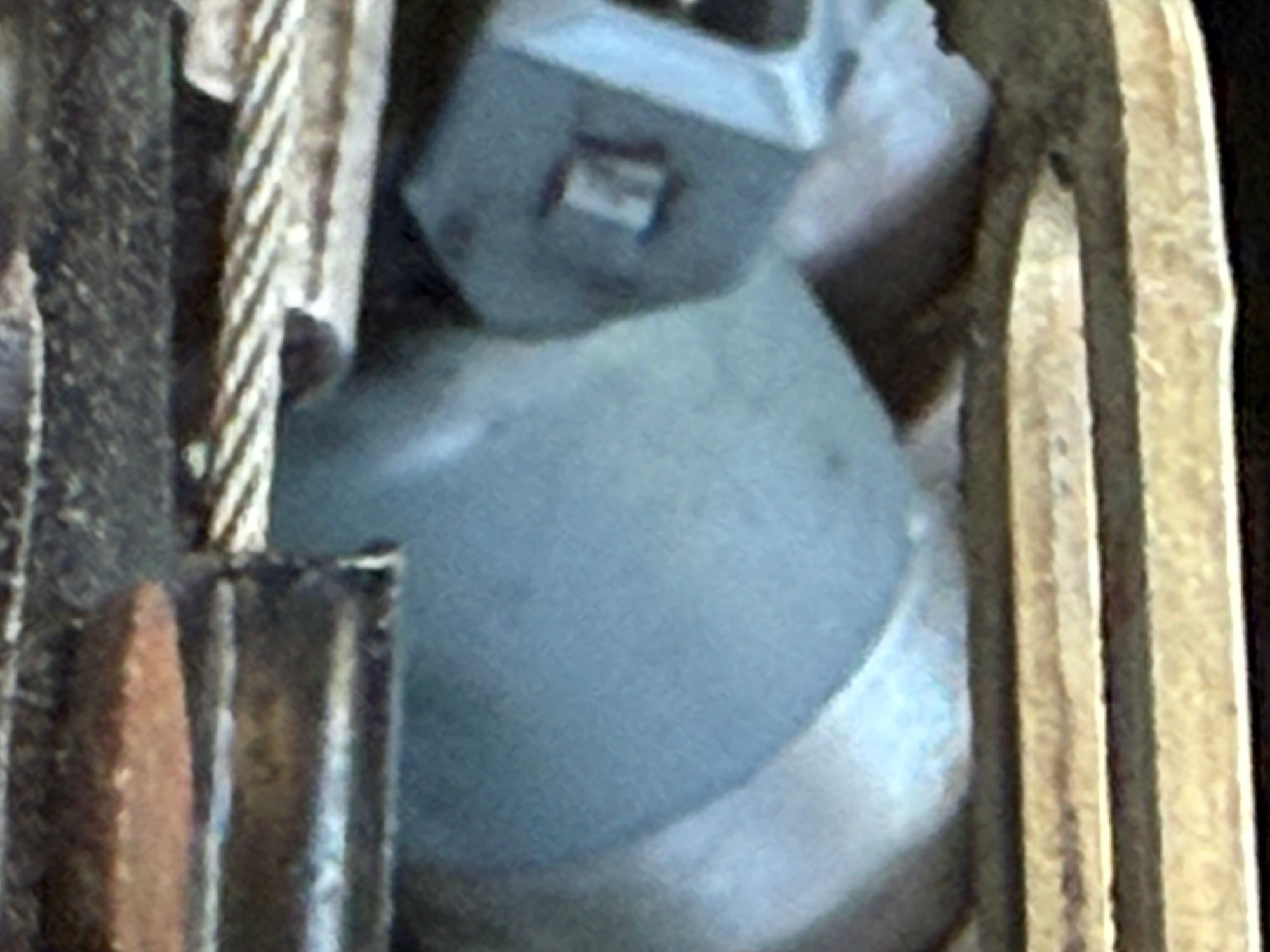

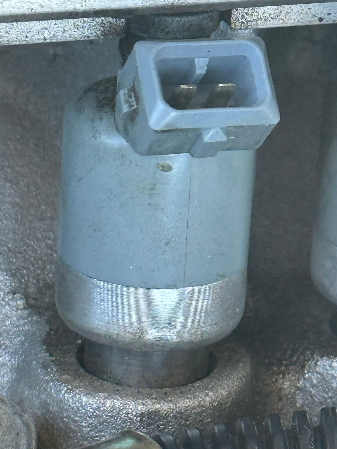

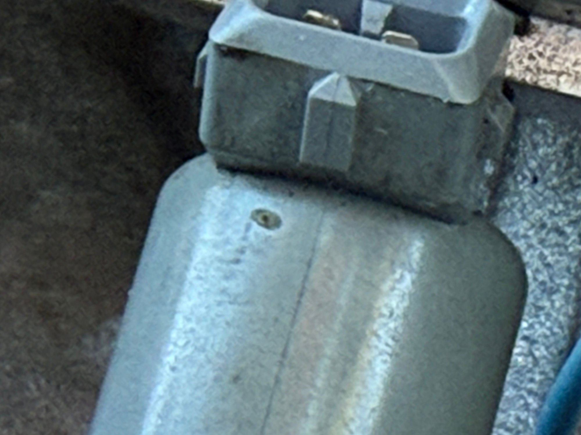

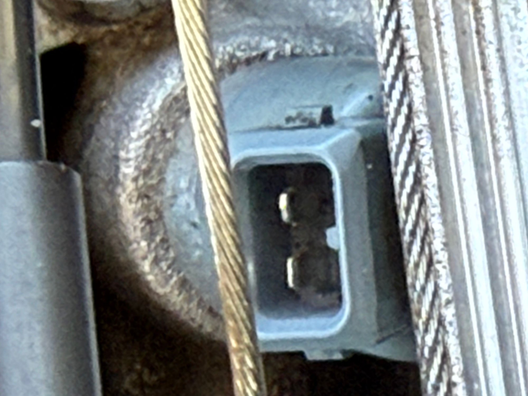

When you get a chance post a nice clear in focus picture of the fuel injectors. Take a picture of the ones next to the throttle body in front of the runners on the driver's side. If you remove the fuel injector wiring harness clip from an injector look for a stylized RP logo on the connector body of the fuel injector.

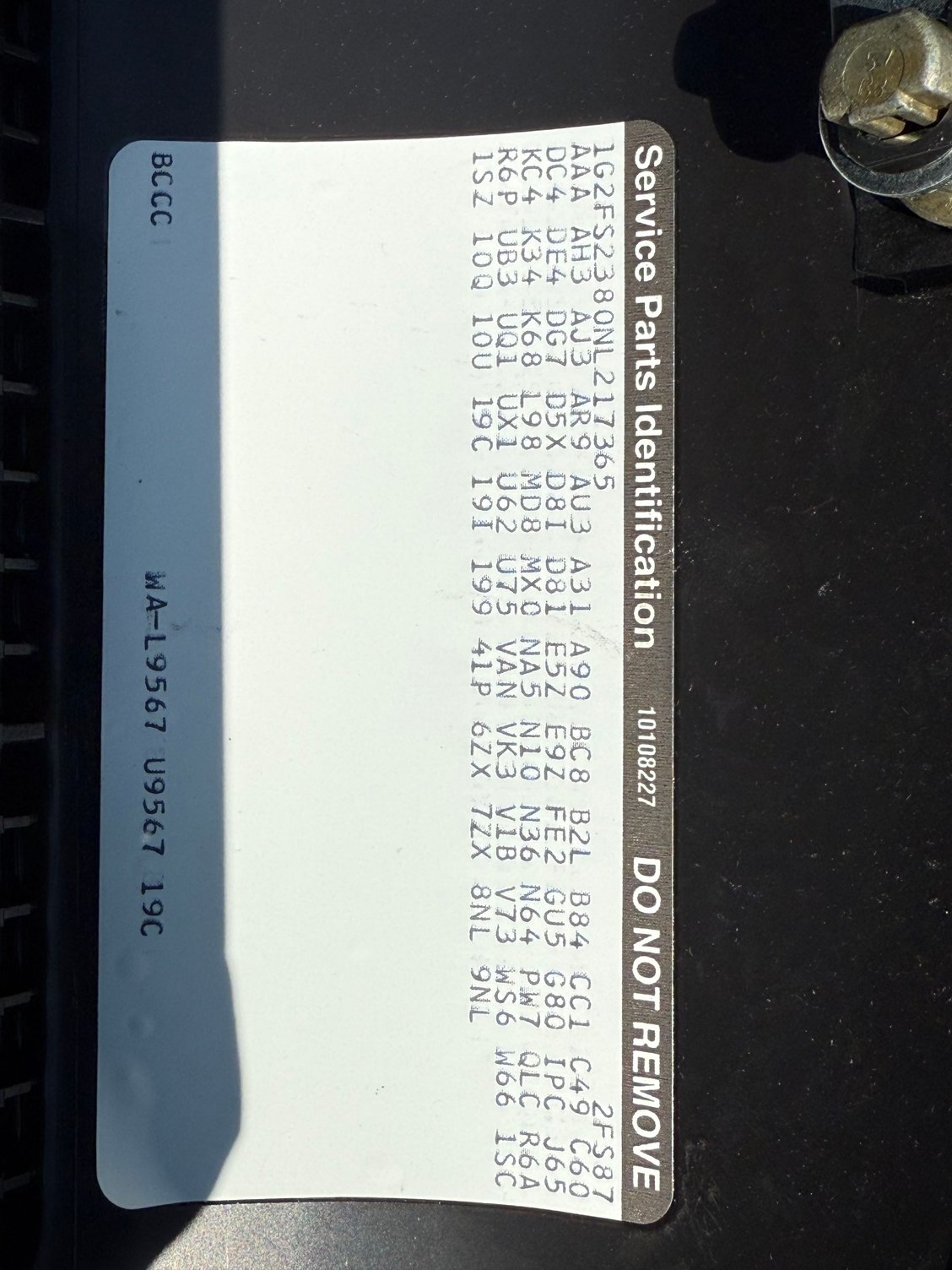

Here is my SPID label.

I rotated it be easier to read.

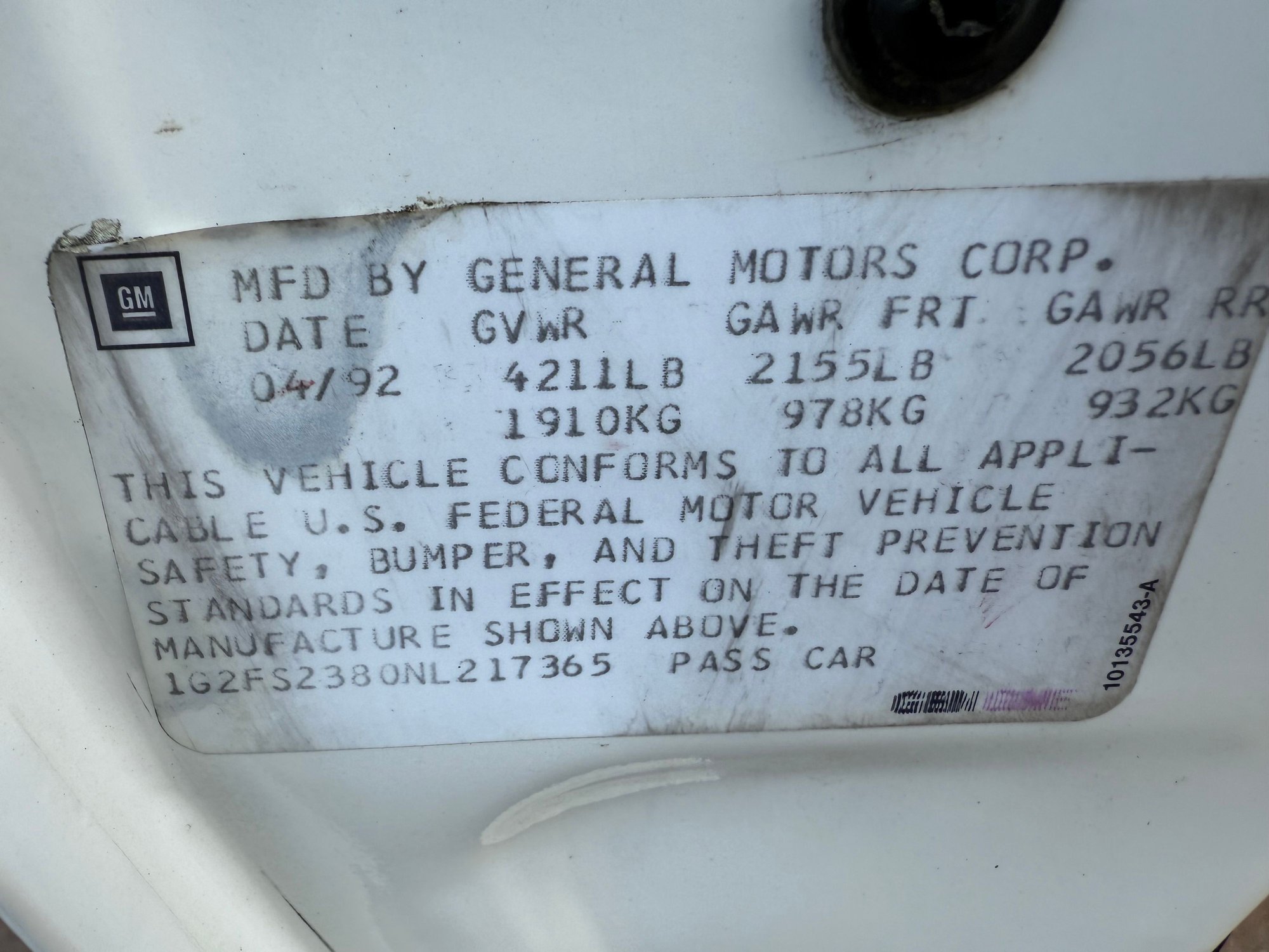

I was actually going to ask to see it and the labels on the driver side door. I was interested in the production date. The SPID label is exactly as I expected it would be.

Here is a link to the Compnine Build Sheet for your car.
Your car was built April 15th 1992. Tax Day!!! LoL
Not as late as I thought it would be. They must have run out of parts earlier that I thought.
Compnine Build Sheet for your 1992 Formula 350
I saved the Compnine Build Sheet as a PDF file for you too. It's attached below.
I have no idea why it didn't put the RPO codes in alphabetical and numerical order. I swear it did in the past.
Some of the descriptions are a little off too. Later on, I will translate them into 1992 Firebird Formula.
AAA = Standard Equipment
CC1 = T-tops (Your car has the redesigned 1991/1992 low dome height lightweight Lexmar acrylic plastic T-tops with LexAR 100 Coat for scratch resistance. They scratch really easy too.) The glass T-tops are heavy AF.
1SZ = Formula Option Group Package Discount
R6A = Formula Value Package (Includes CC1 & UX1)
R6P = Performance Enhancement Group (Includes G92, N10, J65, and KC4) G92 Performance Axle Ratio will not be on the SPID Label unless the car is also 1LE.

Here are the door stickers

Did you by chance get a picture of the fuel injectors as described in post #17?
I didn’t see RP anywhere. Is that good or bad?
Old Sep 18, 2025 | 05:44 PM
Airwolfe's Avatar
Joined: Oct 2020
Posts: 1,460
Likes: 712
Car: 1992 Pontiac Firebird
Engine: 5.0L L03 TBI
Re: 1992 Formula 350
Maybe I have misremembered the little stylized RP logo being on them on the top between the connector and the fuel inlet of the injector. Or maybe it's just hard to see it the way you are looking at it.
I'm 99.999% sure though that those are the factory original RP Multec fuel injectors.
The 1989 to 1992 ones are defective. They fixed the problems with the insulation used on the wire for the coil winding for 1993.
With a next oil change sticker of February 2001, I am assuming this car hasn't been on the road since then. Sitting for 24 years I would at least want to have them cleaned. No reputable business that services fuel injectors are going to touch these RP Multec fuel injectors.
They might still be good as far as the insulation on the coil windings go if the car has been off the road for so long. I don't remember when gasoline started having the 10% ethanol in it. Maybe the car has never had HEET or the like or fuel injector cleaner ran through it that contains harsh solvents. GM had a special fuel injector cleaner for these RP Multec fuel injectors that didn't have harsh solvents in it.
Thing is these days you will be hard pressed to find high octane Premium Fuel at a normal gas station that doesn't have at least 10% ethanol in it. I don't know which fuel injector cleaners you can pour into the gas tank these days that won't harm the RP Multec fuel injectors.
​​​​​​Maybe @southbay08 can tell us if those are the original RP Multec fuel injectors and if there is a fuel injector cleaner you can pour in the gas tank that would be safe for them.
Yes they are definitely multecs!
Old Sep 18, 2025 | 08:02 PM
southbay's Avatar
Joined: Oct 2008
Posts: 41
Likes: 9
In all honesty if you didn't check the resistance yet when they are hot and cold I would do so.
even if the coils are good I would not keep them as they are so problematic. We do not clean our injectors by putting a cleaner in the fuel. They go onto a bench where we can flow them at various pressures.....sometimes the injectors will flow fine and then shut down at certain pressures due to failing coils , we check the spray pattern, we see if the flow within speck, check the resistance and so on

Eject the multecs with extreme prejudice and install some nice new Delphis from Southbay.

Yup, RP multec injs. Ditch them (but keep with removed parts, I'm weird)

The car currently runs good. I am not against replacing injectors now. Should I wait since they are working well or just replace them?
Old Sep 20, 2025 | 03:21 PM
Airwolfe's Avatar
Joined: Oct 2020
Posts: 1,460
Likes: 712
If the car is running just fine and has no misfires with a butter smooth idle and there aren't any hesitations when rolling into the throttle, then don't worry about them for now.
Try to run 91 octane E00 pure gasoline if you can find it. Where I am I'm super lucky and can get 87, 91, and 93 in E00 pure gasoline
