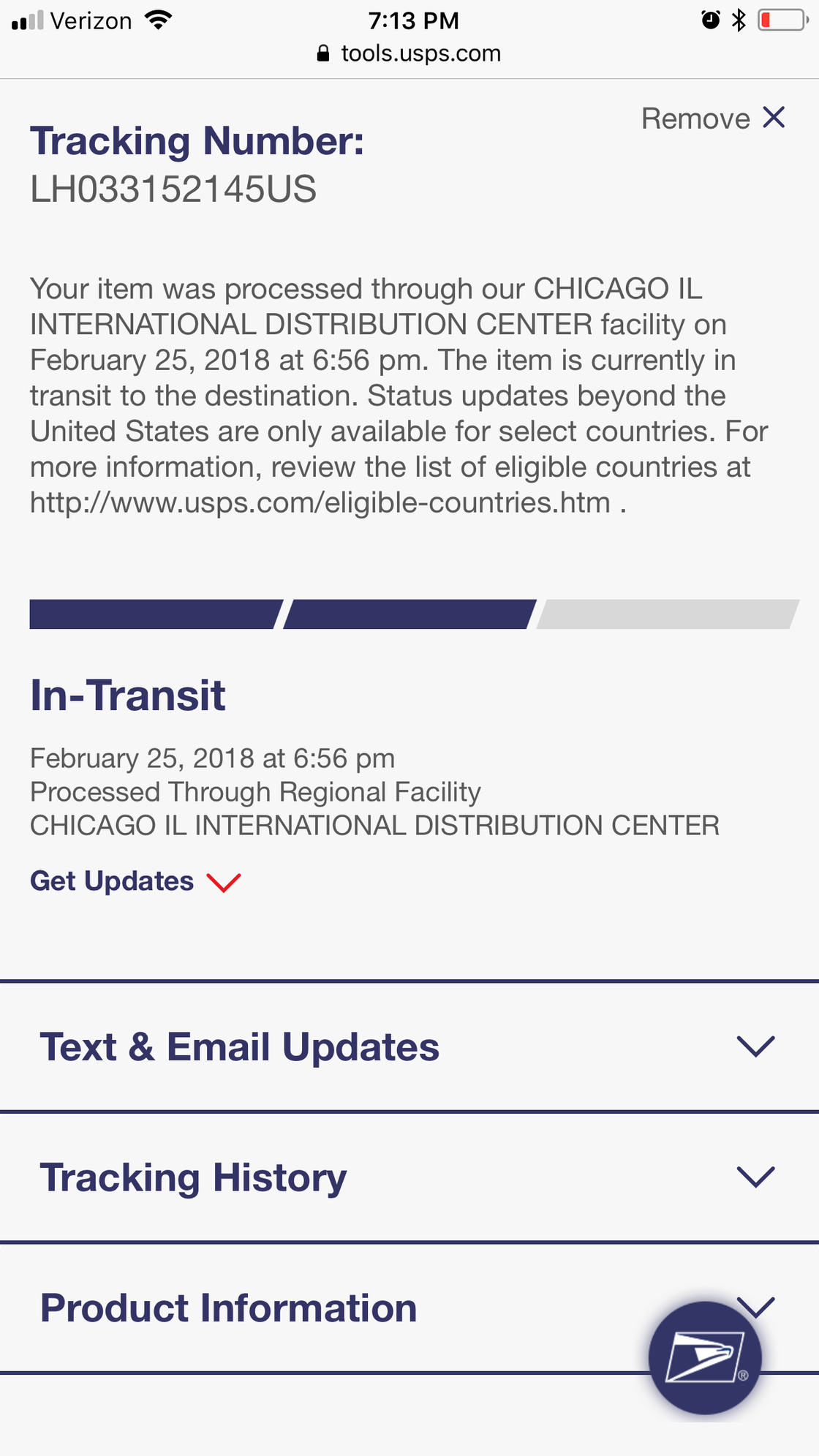

Hey Alex-here is a screenshot of what shows up on the usps site as far as tracking info. Once it leaves the US and is abroad there is not usually any control over customs for example or sometimesitems can be held, checked/searched etc for whatever reason and at any time.

Hi Formula
yes I am getting the same information from the tracking. It seems odd that after all this time it is still not here so I thought maybe you can contact them from your side to try and get some more meaningful information from them

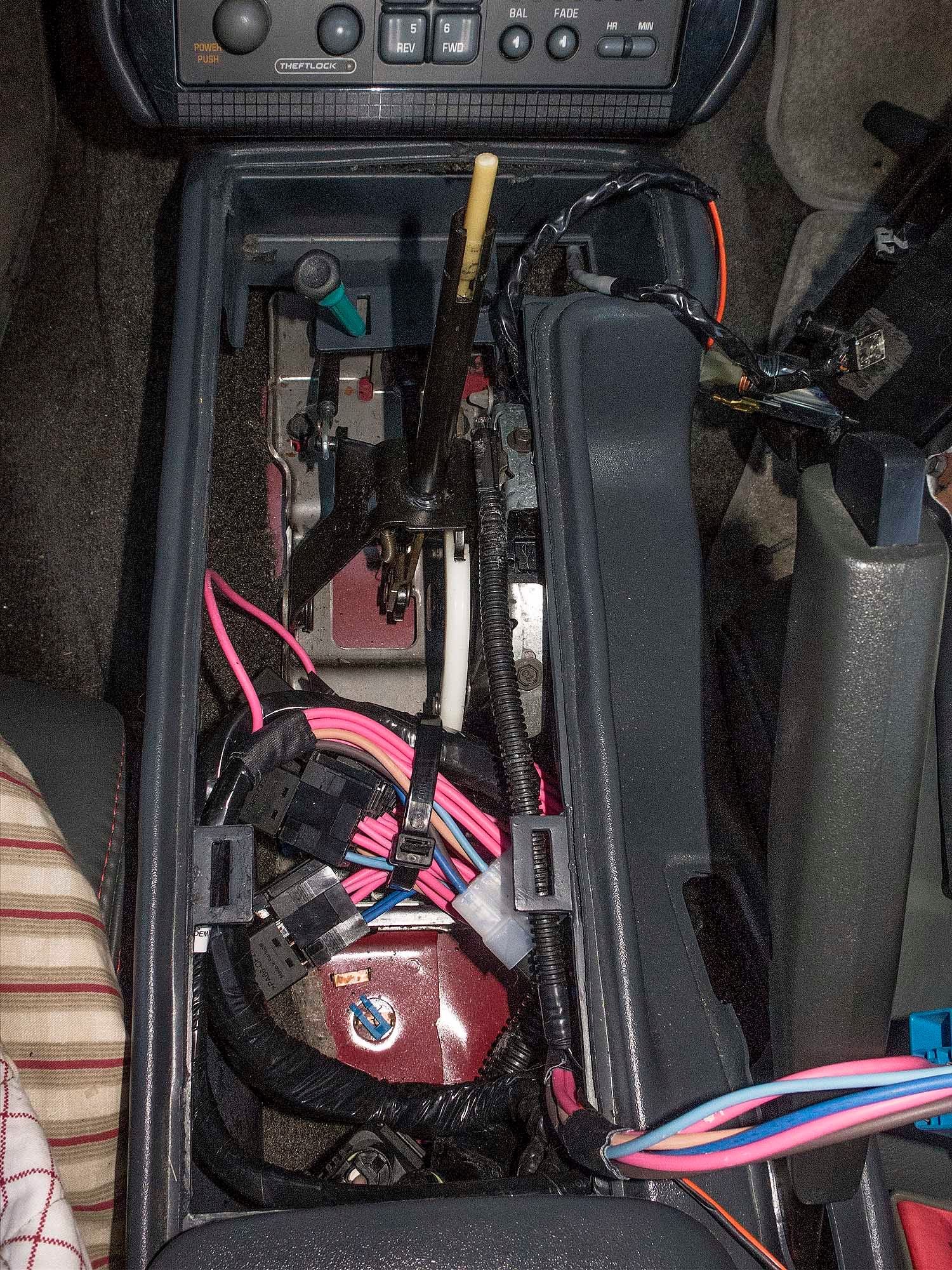

Hi, Received my kit 4 months ago and just got time to install it. The cable was much too long to fit under the consul, so I had to cut 2 feet of of it. Since I installed a new radio, there was no room for wire and modules in the radio console. Soldered and heat shrunk the connections.
Taking apart the cable its obvious Formula is a talented constructor, the cable and modules are top notch. I had no problem placing all the wiring and modules to the back of the console area. This works so good, I now regret I did not get the down and up system, I just have auto down, both sides.

I have finally installed the kit yesterday according to the logic. Removed spade connectors from factory block and placed the kit wires (same color position) instead of them. I then matched the colors of the wires removed from the stock blocks into the supplied black connector block to the harness white connector and connected the earth lugs to a bolt.
Problem is that I can hear the relays but the motor works intermittently. If I fiddle around with pressing switches it works intermittently. And it is doing this on both doors so I doubt it is a motor problem. I even swapped the switches across doors but still the same. I will tonight try to short the switch connector wires to completely eliminate the switches (still have to see which wires to short). Could it be I had failing switches and now due to less load , they are not making proper contact?
Also, when you say 'omit oem black wires' do I have to remove them or keep them there? I kept them in the switch plug.

You will not need the 2 black ground wires that were on the switches. put a little tie wrap and tuck them aside. They do not have voltage in them.

Thanks Louis. Will remove the black cables from the switch connectors. I doubt it is the reason why this is happening but will anyway remove them.

Originally Posted by aseychell
Hi there
the OEM black wires to the switch connectors arent needed but-you need to retain your floor/console ground wires since that is also a shared ground for power mirrors if equipped as well. The ground terminal from my harness goes to that common ground as well.
with my setup, the switches are now only ground triggers-if the windows work when fiddling around with the switches then my guess is the racheting action of the switches are pretty worn-a simply jumper wire from pink to brown should trigger down and pink to blue up on the drivers door for example.

And yes-remove the black wires from the switch connectors-I bet your problem will go away.

I jumpered the cables and windows worked fine. I removed the black wires and windows worked fine also. So the black wires were the culprit.

Re: power window relay kit EASY to install!
Sorry mate but I couldnt take a photo of the whole thing installed and there is a very valid reason for it. Be ready to swear bigtime to install this kit in a firebird. The relay modules and the wires in this kit are very big / thick compared to the availability of space in the console. The top cover of the console is quite thin and you cannot afford to have the wires pushing against it as it will bulge it up.
You also have to leave enough space for the shifter to work. I had to remove the whole console again to wrap the kit wires around the base of the shifter. I also had to separate the 4x relay block in 2x 2 relay block to distribute them on each side of the console. And mine does not have any auto up/down. That would mean another 4x modules if I am not mistaken. (for both windows).
Once I got all miraculously in place I couldnt afford to remove them again to take pictures however I am attaching the stock connectors before i removed them from their blocks. Its very easy. You only have to remove the wires from the white and blue connectors (pinch the small tab on each slider) and put in the kit's wires which are colored the same in the white and blue connectors. Make sure you remove the stock black connector and tape it aside as this will not be used.
You then take the removed wires from the stock loom and clip them in the supplied black connector lining them up with the supplied white connector.
Attached Thumbnails power window relay kit EASY to install!-photo-16-07-2018
