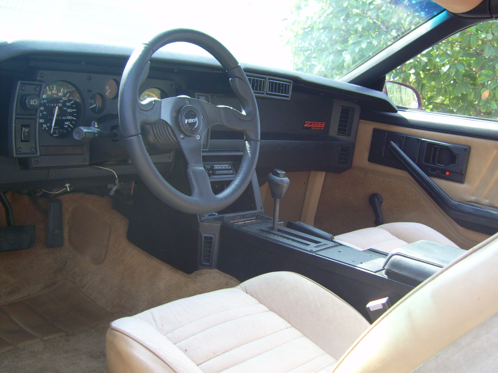

This is what worked - at least for me
1. Lightly rub all the pieces with steel wool. (I guess you could use sandpaper if you have really bad sun spotted areas- just make sure to do it evenly to not ruin teh texture on teh plastic)
2. Wash all the parts with water and standard liquid soap
2. Spray the panels with SEM plastic/vinyl cleaner. Spray per directions. Some people skip this step, but yes it does make a difference.
3. Spray with SEM choice of color. Use per directions. Youd be surprised at the color selection- they are right on with GM colors.
Just be sure to constantly clean the nozzle while spraying, because the buildup makes it spit. The cool thing about sem is that its really hard to make the paint run even if you are a terrible painter. Its almost like a powder that you brush evenly before it settles and dries.
I panted mine last summer. I live in Fresno california- it gets like 100 degress here easy. Check it out. . The center console, gauge bezel, door plastics, and the kick panel are whats painted with SEM in this pick. Really good finish, and has lasted thus far.
