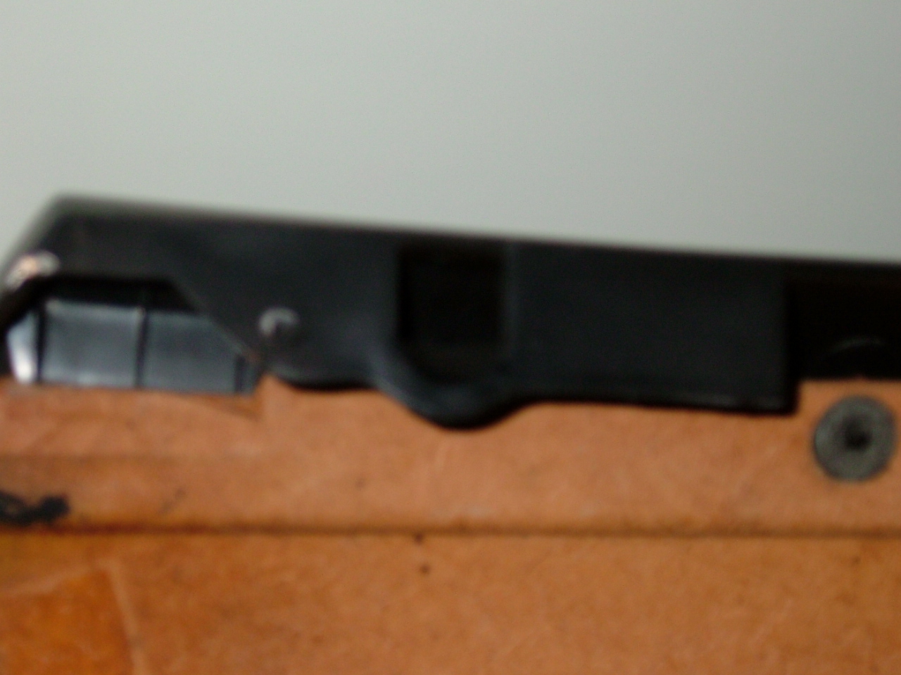

ok here are a few pics as to why you have to squeeze the plastic starting from one end and working your way down. there are just premolded clips four actually holding them on and they look like this
Attached Thumbnails How to Remove upper door plastics-dscf1436.jpg   How to Remove upper door plastics-dscf1437.jpg   How to Remove upper door plastics-dscf1434.jpg
that plus they dont always come off easy. So sometimes you gotta use the palm of your hand and give it a firm hit.

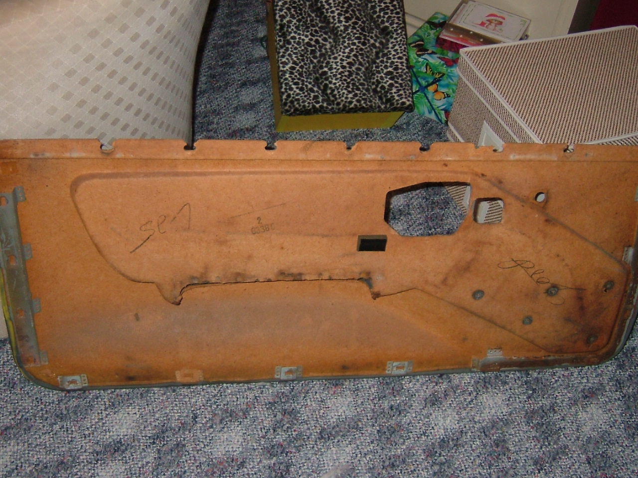

here is the other door panel not being careful cardboard off door plastic on
Yeah, I see that a lot. I sometimes go to junkyards and try to save the good plastic pieces from junked 3rd gens. The panels are usually trashed, so I just tear them off the flimsy cardboard. I was actually thinking of just cutting off the tabs so that they can just lift up easily, but I'm not sure if that'll have any effect on it especially when the windows go up and down. If it breaks off the panel though, I imagine you could just put the panel on and then put the plastic piece on.
hmmm just came to thought, but has anybody made custom panels out of thin but stronger plywood to look like a thirdgen panel?

I was just about to post pics of the molded clips but I see Imapaler68 beat me to it. Those pics pretty much answer the problem most people have taking off the panels.
Thanks to everyone who responded.
