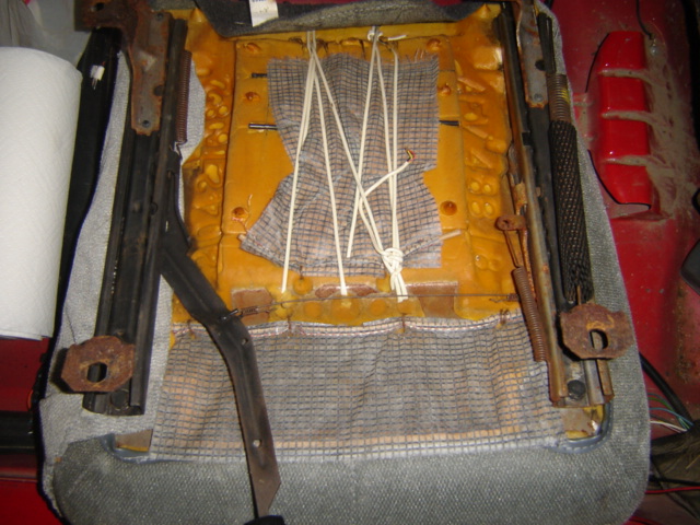

Re: Seat Cushons
first you need to remove the upper half of the seat from the bottom cusion, then start removing the special circle staples that hold the cover to the frame, then carefully remove the cover...alot of that cover is stitched to the padding if i remember correctly, but after that it should come apart with a little coercion.

Re: Seat Cushons
yea the bottom is one piece sewn together, and the top half of the seat is another piece, and then if you have headrests thats an entirely new piece. Think of it like putting on a t-shirt that is 2 sizes too small, thats how seats are upholstered, the fabric is one very tight piece and is held down with staples that are round and go into the bottom frame of the seat. You just need to seperate the staples and take the seat tracks off, if there are more staples under there then get them, but then you need to carefully (cause these cusions are most likely around 20 years old) and it looks like the easiest would be take it off from the back towards the front. attatched is a picture of the bottom of my driver seat (don't mind the telephone wire) but at the bottom of the picture if you can zoom in you will see the staples, that is the front of the seat at the bottom. Hope this helps.
