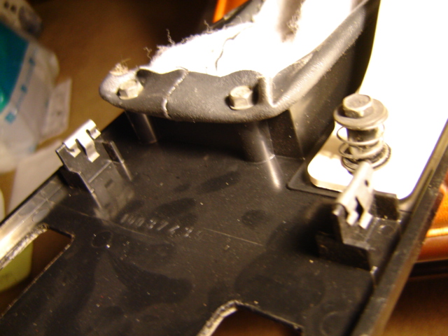

my shifter plate has a crack in it i can only see 3 , 7 mm bolts holding it on , do i need to remove the radio and pod ? it wont budge by the front area the back will come out freely

There should be 1 or 2 bolts in the ashtray holding the front in.

took it out theres only 1 , its still fighting , what about the cig lighter?

Wiring might hinder it from coming out as well. I know on my old GTA that was the problem and had to remove the brace on one side to get it out. Not the biggest problem but a problem none the less. If all the screws are removed then look for wiring, the radio trim or pod for that matter, handbrake handle etc.

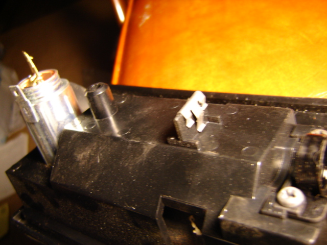

Shot of underneath of an automatic shifter plate (85-92 i believe), there are only 3 pressure clips, 2 right behind the shifter, and 1 underneath the ashtray, and only 3 screws, 2 underneath center console lid and again 1 underneath the ashtray. After that it's just convincing the part that it wants to come out, only real wires that would prob give you a slightly hard time are the cig lighter ones, i don't think there is much for the shift indicator light to get caught on. Good luck!

so im guessing i dont have to remove the radio pod? just have to use a lil effort to get it to pop?

You have to remove three (maybe two) bolts from the console, remove the staple from the back side of the shifter ****; remove the three bolts holding the trim on around the AC/Radio, and the three or four bolts around the ashtray/shifter. The trim around the AC/Radio and be tricky. Tilt is up at a 33 degree angle and pull towards the passenger side.

Man, if this isn't in a sticky somewhere, it SURE AS HELL oughta be! Geez, I've gotten the shifter handle & the two bolts off, I've been gently twisting, tweaking, pulling, looking, & I still couldn't figure out how to get that sucker off...

there's 3 bolts holding it in 2 by the armrest 1 under the ashtray take the radio trim off and you should be able to wiggle it loose, there's wires connecting hooked up to the lighter and the switches but you should have enough slack to get it up and disconnect them

Yeah, the problem that I'd been having was that it didn't want to wiggle at all, it seemed as though it was bolted in, & I couldn't FOR THE LIFE OF ME see where it could be bolted...
Thanks for the info though, it's dead-on accurate.
