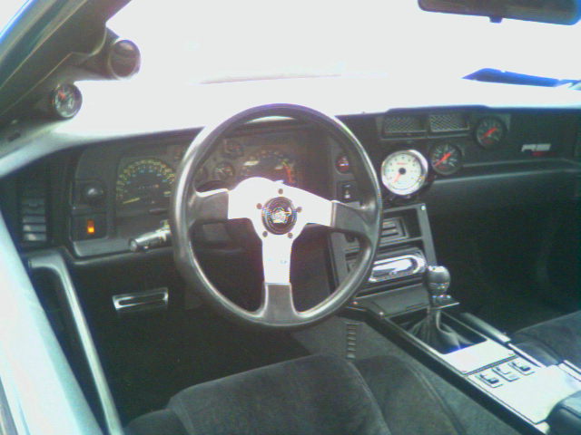

Here you go.The boot is hand made/stitched leather.I did this some 6 or 7 years ago.I cut the stock shifter plate to fit the boot.The boot is held in place by the shift indicator housing.I had to remove material from the housing to accept the boot on that side.The outer side of the boot is sandwiched between the shifter plate & console body.I made two wire frames from a hanger to hold the boot to the shape of the cut-out on the shifter plate.One wire frame is just under the shifter plate & the boot is stitched onto this frame.The other is about 1.5 inches lower.Which is there to keep the boot from catching on the shifter mechanism when going form park to dr & back.

Why not just run a manual plate instead of the auto plate? Sorry didnt read all of what you wrote apparently...

I think he said he wanted to keep the gear indicator with the boot.

Yes i made the boot i cut the pattern & stitched it by hand(very tedious).I believe the slider & the indicator on your console are linked together, but there should be a way to keep the indicator & remove the slider.As for having enough room.The opening where the slider goes is narrow & a boot would be pretty tight there without widening the open section.I tried putting the boot in this way, but was having problems with the boot bunching up when i shifted into park or pulling out when into 1st or 2nd gear & almost at times when in drive too.The boot needs to be long enough for the shifter to go from P to 1.Without the boot pulling out from the other end.This means the boot needs enough material to stay in place, but this also caused it to bunch up.Widening the opening allowed the boot to spread outward...I looked at vette shifter plates(mid 80s-early 90s) & non of them are what i would call a direct fit.Not even close.As for earlier vettes who knows, but i doubt they would fit!
