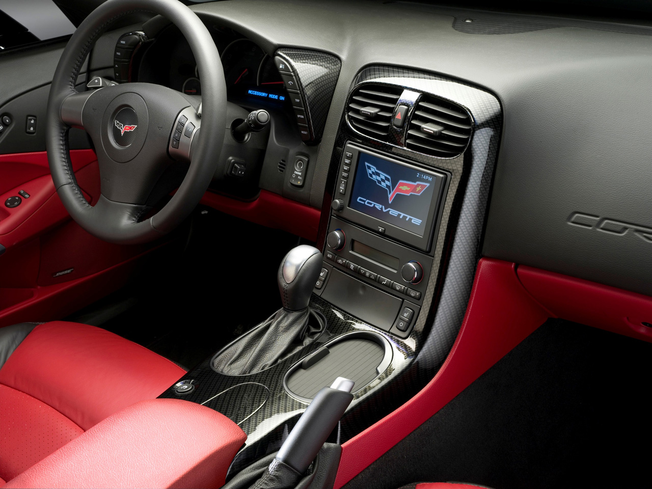

Ok so i know that you can swap a 4th gen dash with a 3rd gen, but about a week ago a new well was new 07 corvette got totalled(front end basicly gone from a semi)
Basically do you think it is in anyway possible to do a swap? The interior of the car is perfect

I'm pretty sure if the corvette was hit in the front that sucker would be torn up, my bet is the dash would have already been cracked after that. Also for how many corvette crash I've seen those things just shatter or the semi would just steam roll it. lol
-edit-
The att is a pic of a 2007 corvette dash, I have a hard time in seeing this thing in a junk yard
