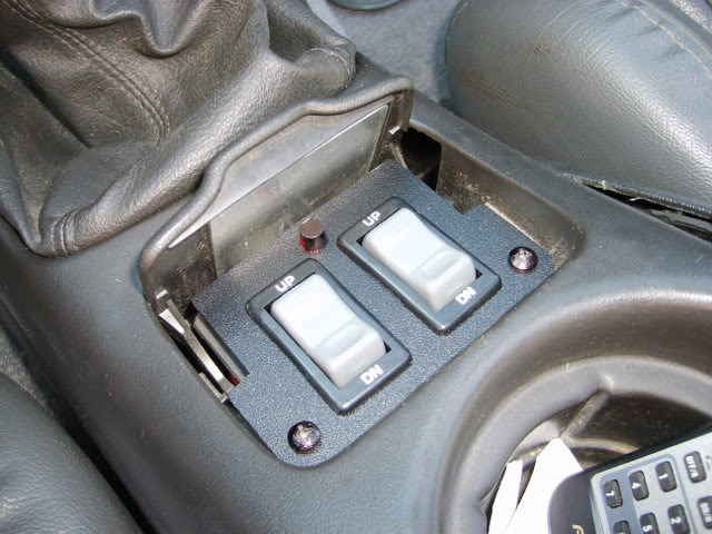

True...however plastic is also not as strong. I made my first one out of ABS and it worked well for awhile. But it started to flex, and eventually cracked on me.
A nice comprimise between strength and ease of "work-ability" is alum. Thats what I made my current one out of.

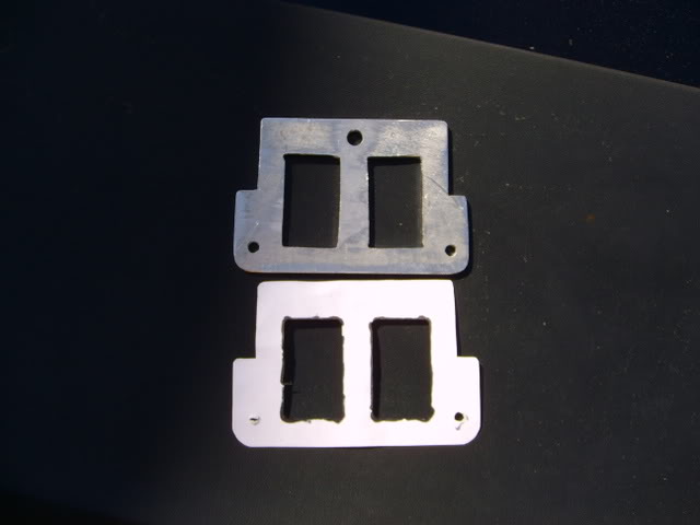

Old plate vs. drawing.
Layout after the rough cut.
Plate vs. drawing.

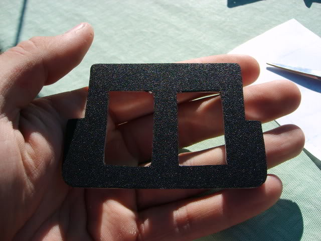

Textured overlay. MUCH nicer than paint for a piece like this in my opinion.

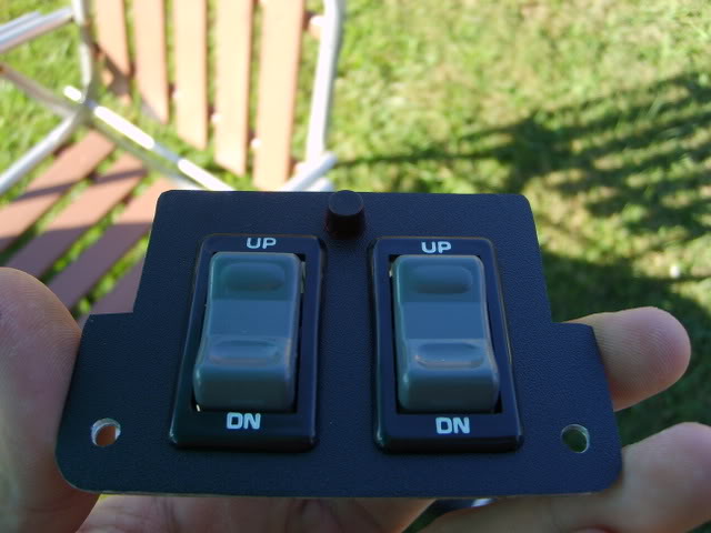

Switches and light mounted.

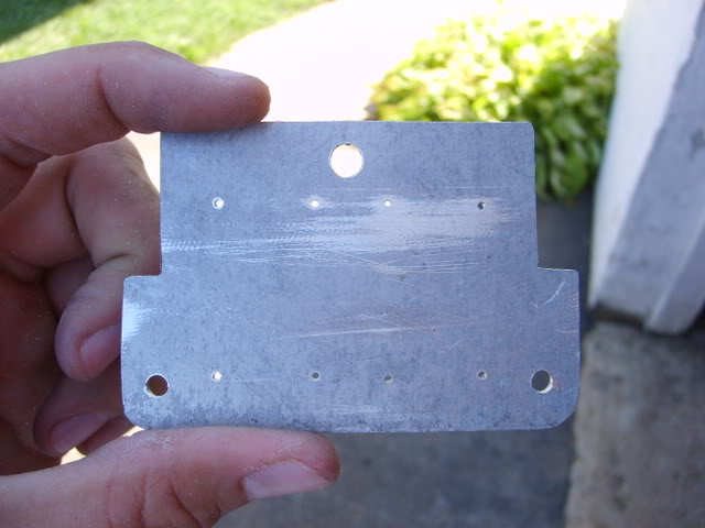

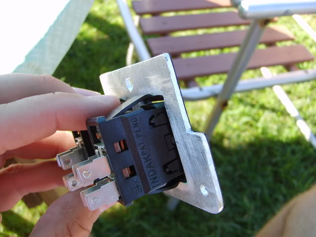

Backside.
Installed.
The aluminum mounts via two long self drilling phillips head screws right down into the console plastic, and I painted them black for looks. It feels much more solid than the last one.
