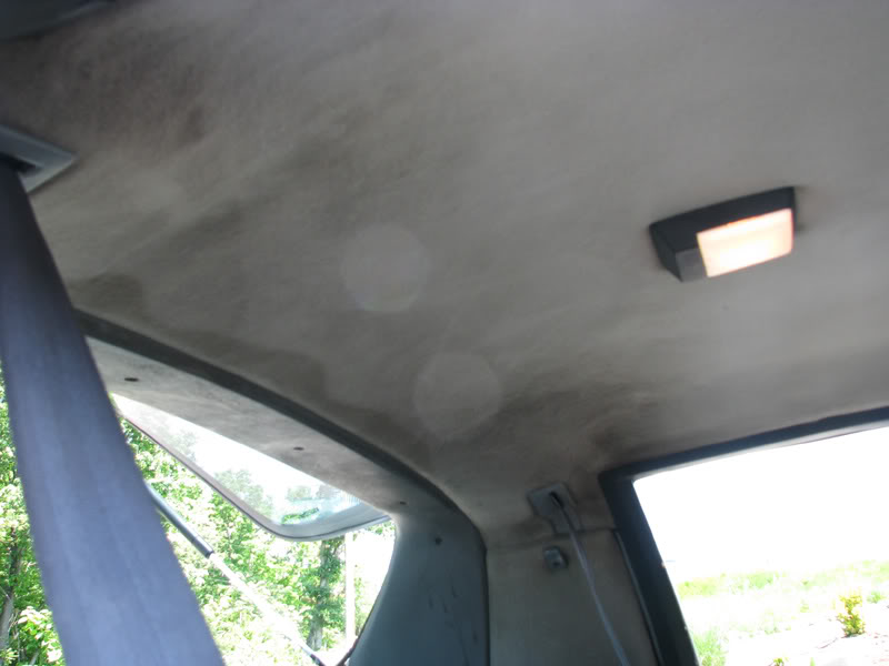

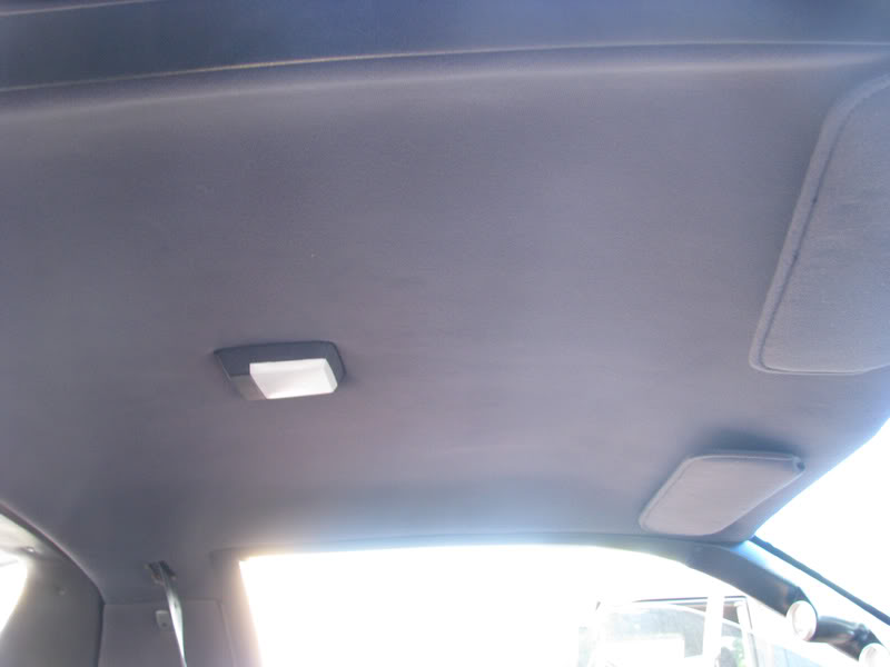

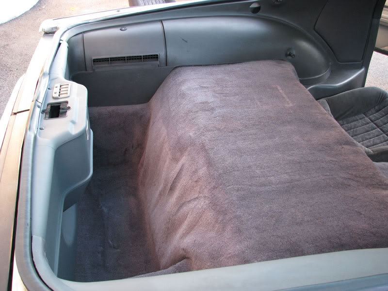

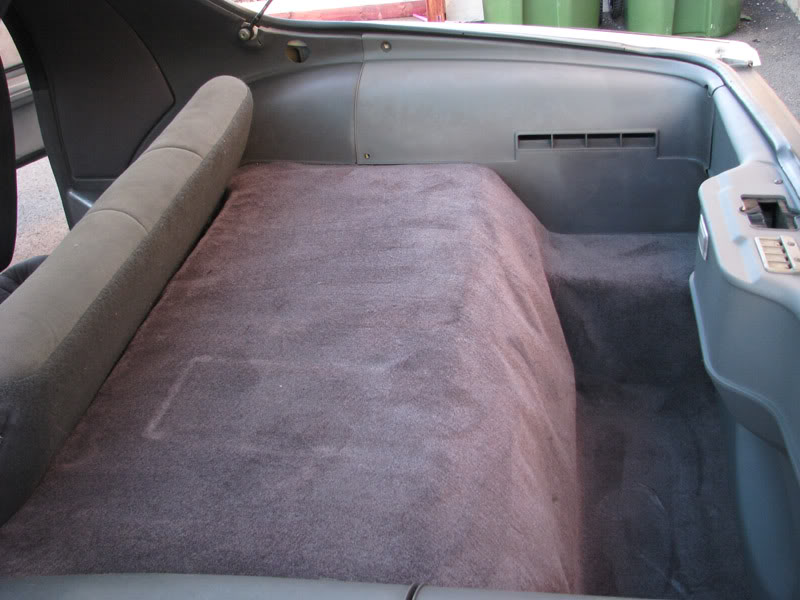

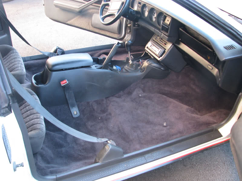

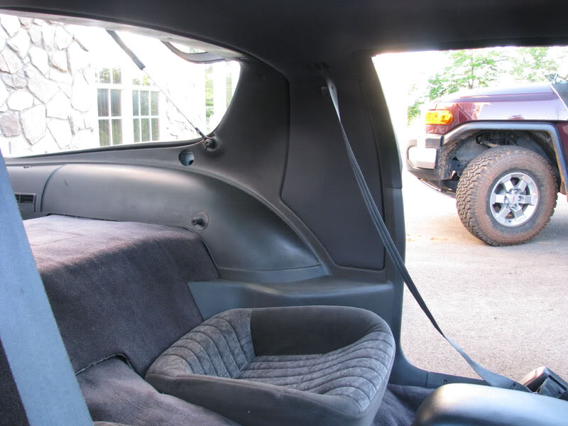

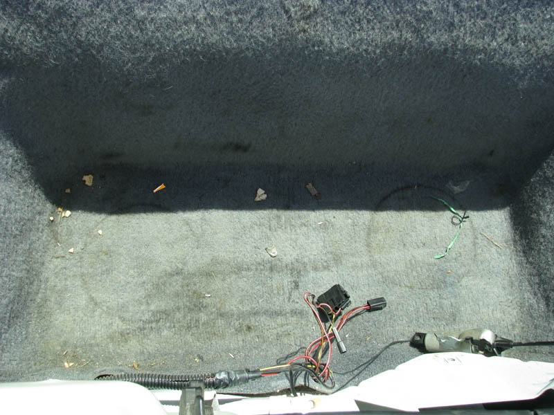

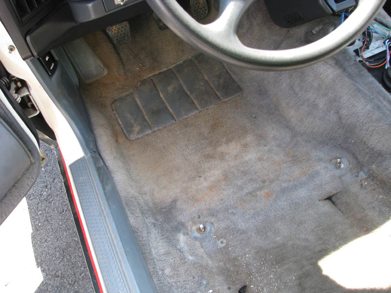

here we go! Started with light grey interior...stock for an 89 formula. Switching to dark grey, featuring new carpet and door panels from Jims85iroc, and a locally recovered headliner and sunvisors.
BEFORE

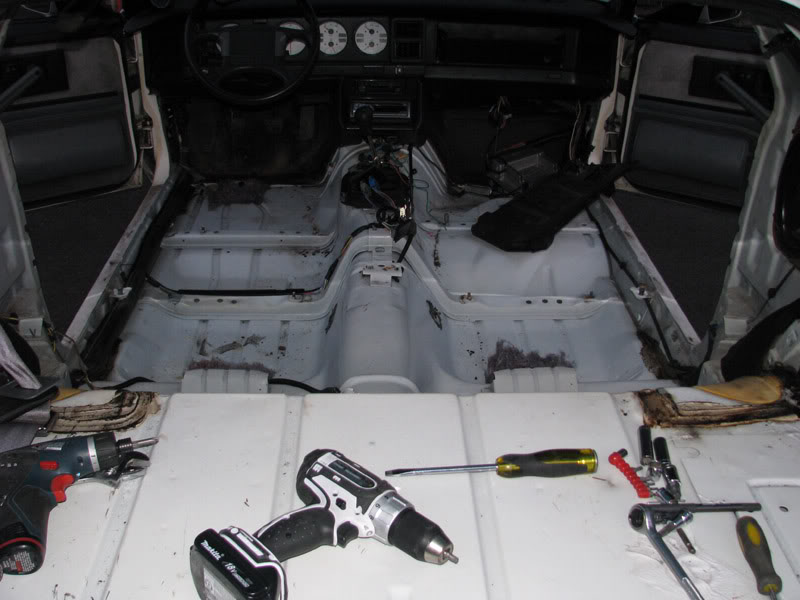

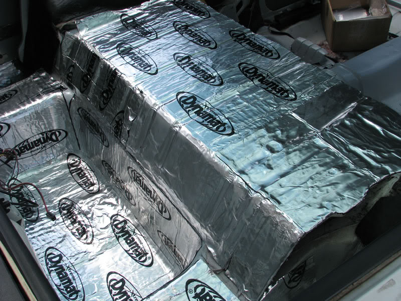

DURING

Hey was wondering what was the price of the Dynomat

$95 for a "trunk kit"

Looking good. Did you find your build sheet under the carpet?
I used peal-n-seal on mine insted of dynomat. Its a roofing material for trailers you can get at most box stores. Its pretty much the same stuff, just a whole lot cheaper.
I also used a milar insulation that looks like buble wrap except its made out of milar, its what you see in the fenderwells if you look at the cardomain link in the sig. I didn't but it under the carpet because I didn't want to pop it everytime I stood on it.

The extra thickness of the dynomat will propably make the fitted carpet buldge in a few spots use a heat gun to fix those spots, just don't melt the carpet.

Are you doing your headliner while you have the plastics out?

yup I dropped the headliner, sunvisors, and speaker covers off at the upholstery shop on Tuesday and got them back yesterday. They were done in a matching Charcoal Grey and look awesome
