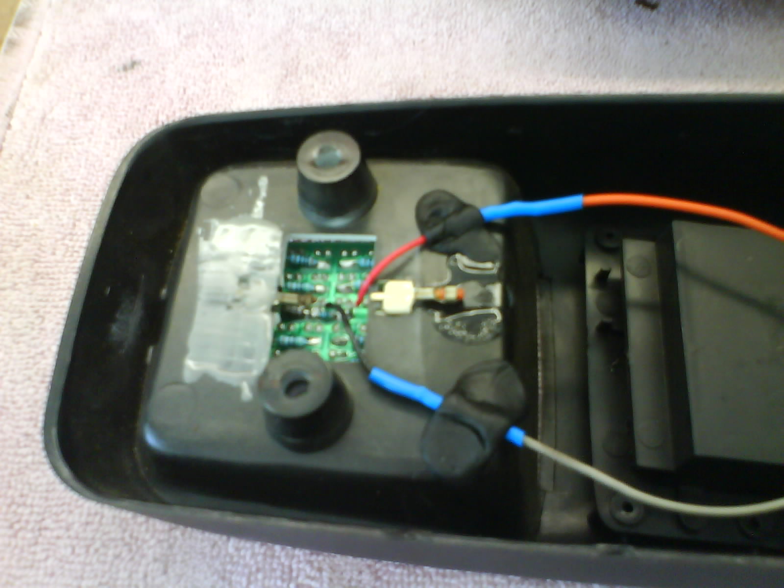

1) With the overhead console dropped, I removed the prong, which has tiny clips that can be depressed with a small needle nose pliers.
2) I used a Dremel to remove a badly melted section.
3) I cleaned the area and reinstalled the prong.
4) With the prong in place, I coated the backside with JB Weld to reinforce the area and allowed it to dry. Pic 1.
5) I installed the LED’s, which wedged firmly between the original prongs. Pic 2.
6) I soldered (black to black, red to orange--the LED leads are shortish, so cut them as long as possible), then used shrink wrap and a dab of automotive caulk to hold the wiring in place. Pic 3.
A faster and less permanent install would be, as 84 1LE points out elsewhere, to simply wrap the LED leads around or through the prongs to make contact and then push the LED’s into place.

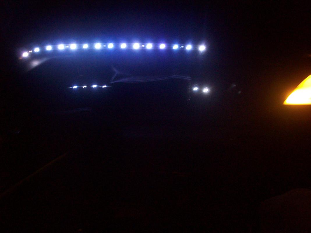

Installation with and without dome light cover. BTW, opening the door in the garage at night is a revelation.

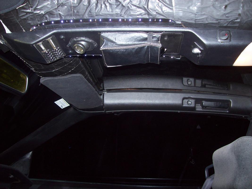

I also ordered an LED replacement for the map light (T13x6 Wedge Base LED Bulb – White T13-W6, which is an 906 replacement).
http://www.superbrightleds.com/cgi-b...=2095971.28409
The install of the above is a simple pull-out, push-in affair.

I thought I'd throw in my ,
I actually bought some LED strips and installed them parallel to the center console. My headliner is made of out black ducktape for now (haha, great against leaks) so they stick on easily. Although I think the stock overhead light is in a good spot, the strips work MUCH better. I plan to put a longer LED strip parallel to the back seat to illuminate back there...
Attached Thumbnails Install of LED’s in an Overhead Console-interiorled1.jpg   Install of LED’s in an Overhead Console-interiorled2.jpg

Re: Install of LED’s in an Overhead Console
Is that switch in the overhead console by the dome light the l.e.d. switch?
no, actually I forgot what that does I think I had some red LEDs once in the overhead console and that was the switch, but I took those out. The LEDs come on and off with the regular door switches...
