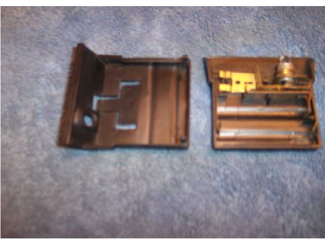

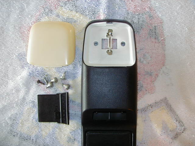

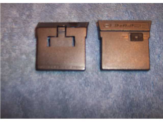

Mounting hardware (the wiring can be seen above) and flash light. The bulb for the flash light can be purchased at Radio Shack: part # 272-1124, packaged as # 243 (222) Flashlight Lamp.

Any way to replace that dome light cover? It looks... yellowish.

If age has caused the yellowing, there's not much to be done. If caused by smoking, the plastic can be freshened up with soap and water or a product called Soft Scrub (used on Convert rear windows).
