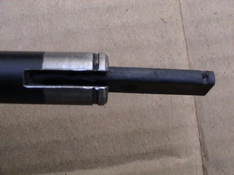

Ok, I dug around a little. They made the ball with leather and without for the automatics. They also differ in shape as well as the distance top and bottom from where the C-clip attaches. In other words the recess for the button differs in depth as do the length of the buttons. Some have metal tabs on the inside and other don't. I've been grabbing stuff over many years and I never kept track of what came from what years. I have a couple of shifters and I'm not even sure if they're from Firebirds or Camaro's but the slot for the C-clip is about 1/8" from the top of the shaft on both. (Firebirds use the U shaped clip BTW.)
My camaro has the U clip too. Umm not sure which one will fit though, cause I dont really want to go through the trouble on swaping out the hole shifter assymbley.

IIRC, it's not all that difficult to remove the assembly. But if you pull the handle off of yours, you should be able to compare it to what I posted. If it's similar, then there's a good chance it will fit. Just make sure you include the cut out as well. Pull the U clip out and the handle off and that's it. My '86 that I swapped around had the U clip and the square handled shifter ****.
