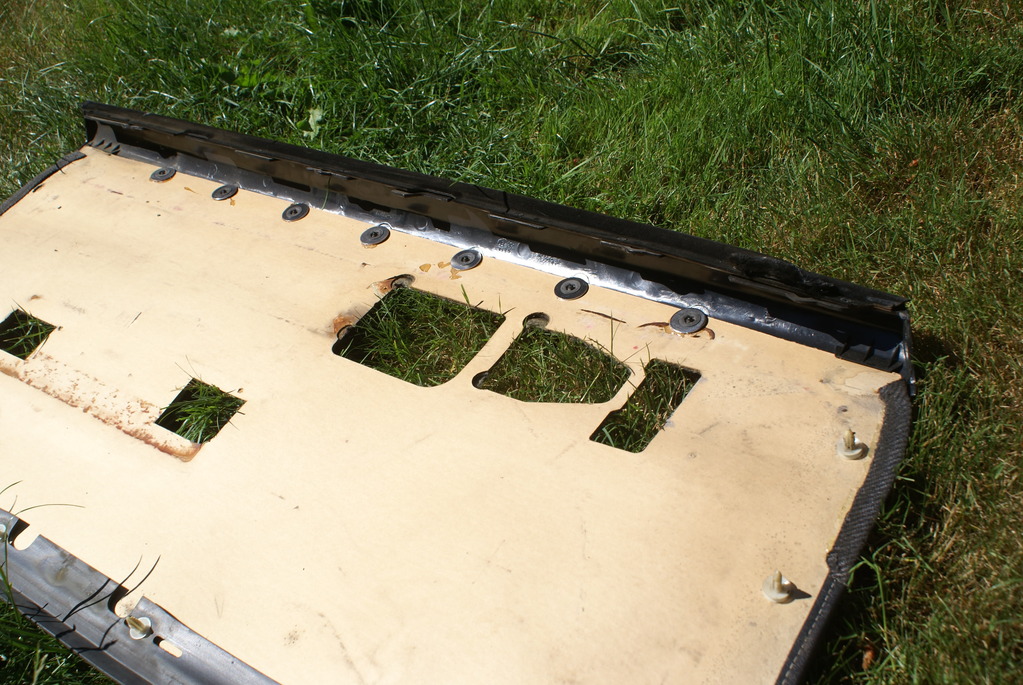

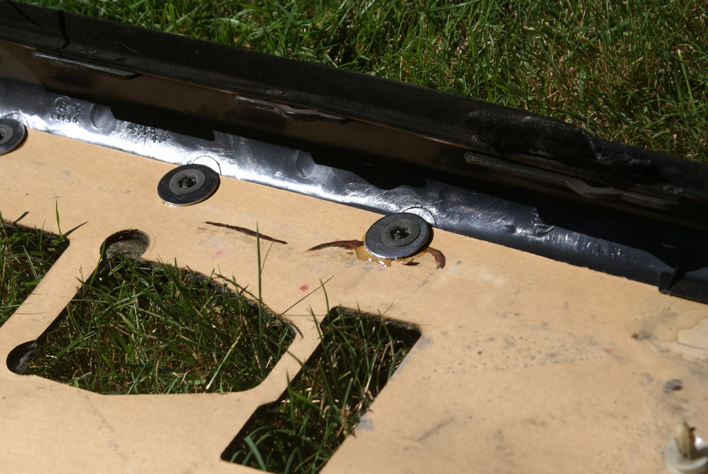

You need to remove the sheet nuts from the plastic studs on the back side (they're installed upside down and a PITA to remove), then the top cap separates easily from the door panel. Some have had luck using a pair of pliers to remove the nuts, it took me about an hour for one door. For replacing them, they'll just push onto the studs. And be very careful when removing the sheet nuts so as not to break the plastic studs they're secured to.
The best pictures I have are of the repair I did to mine prior to replacing the panels. Here you see the sheet nuts on top of some washers I epoxied to the door panels to reinforce the holes in the cardboard.

alright sound good and thank for the pics also very informative
