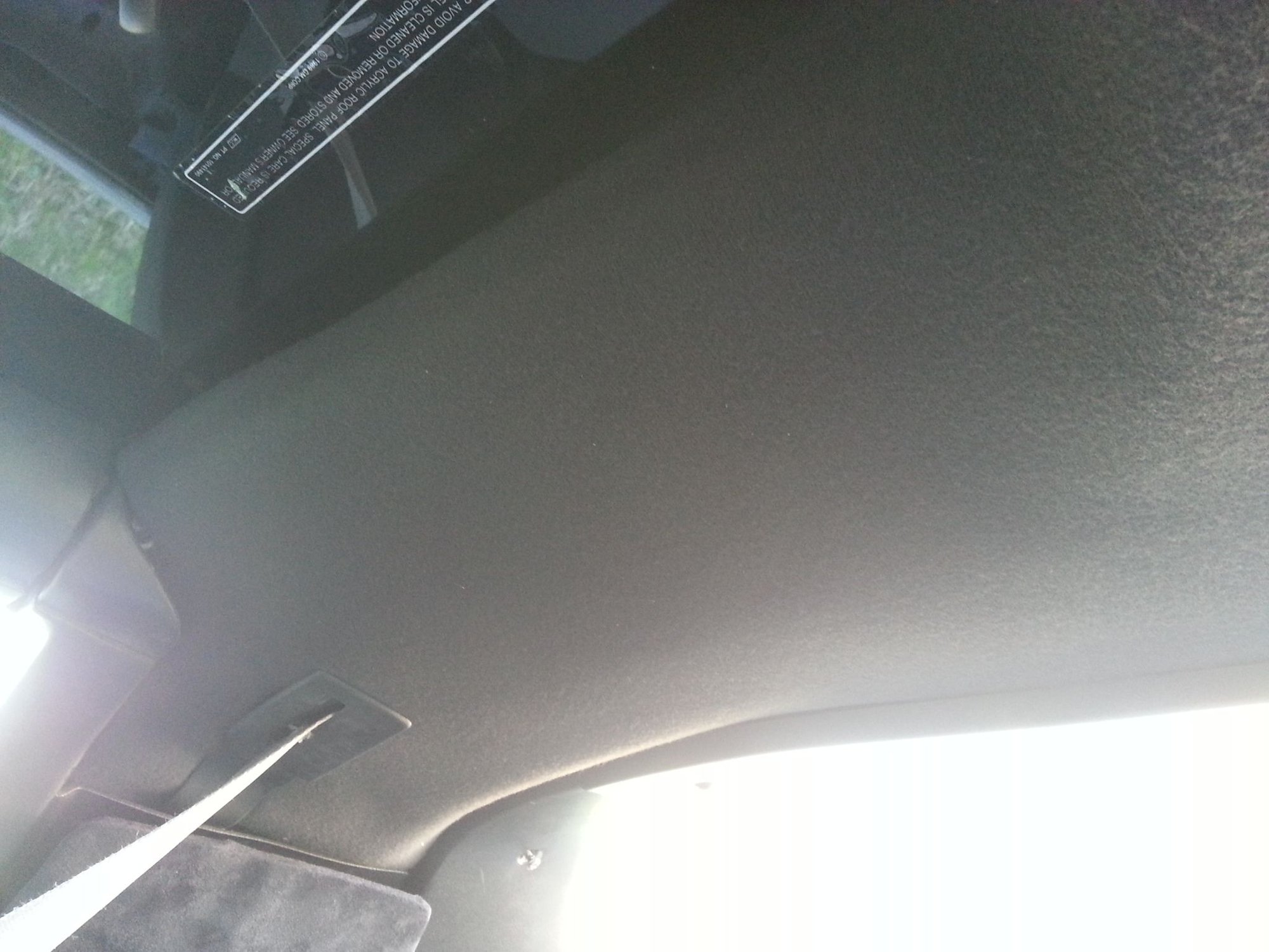

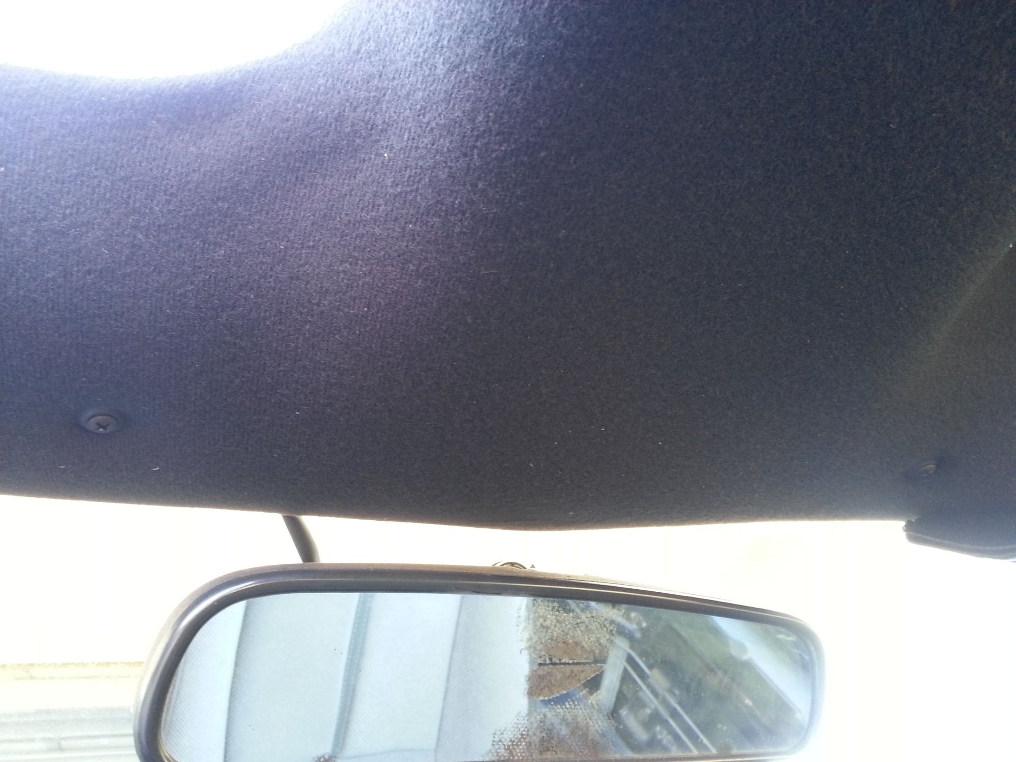

I got headliner material with the foam backing, and took out the old liner, took off the old material, and put the new on the original backing. I did the same... I took the backing, laid it on the new material, cut it out with extra to overlap, but when I glued it..... the cutout for the tops got really tight on the bends so I made little cuts so it would bend.... And when all was said and done, the corners came out like crap. Is there some type of molding I could put around the whole border?

Im with 87WS6. I replaced my trashed headliner with a unit from Next Generation. It was ABS with the cloth already in place. Installation was not hard and it came out perfect. Cost about $180 eight years ago. Prob more now but worth it. Even came with extra cloth for the B pillars. Thought for a second about fixing the old one but it was way trashed. Came out in peices.

I remember talking to 1A-auto about those abs headliner and there all made from the same company .. i think it was called ACME or something. but i recommend dealing with 1A-auto. they shipped it out quick and fairly priced compared to the thiefs at year one and Classic industries.
Now the Fitment is ok every where but behind the T-tops. it sags a bit and you can see the plastic underside when the tops are off. I went to Wal-mart and Bought some heavy duty velcro and used that it helped a little bit but not perfect. Also your gonna Need a Dremel or some kind of cutting tool if you plan on cutting and not destroying the material..

Re: T-Top Headliner Replacement!
I just replaced my crappy headliner with a sweet new one from stockinteriors.com (better priced than hawks). They mounted the headliner to a rigid plastic molded frame. There were holes cut in the plastic for the visor mounts, dome light, and seat belt mounts, but it was up to me to cut the headliner in those spots and open it up (nice if you don't want a dome light or visors I guess).
The thing didn't fit perfectly at first. I had to widen the holes for the visor mounts to get it just right. It took a couple tries, but once I got it in place, it looked really good.
Also, the old headliner had clips that supported it just left and right of the rear view mirror. The replacement one claims that you don't need them since their product is rigid. I found that not to be the case. It needed to be fastened somehow. I tried to superglue the clips to the plastic. I tried epoxy. It kept cracking. I really wanted a hidden fastener, but ended up driving 2 trim screws threw the new headliner. It actually doesn't look out of place at all.
I'll post some pictures of the new one installed when the sun is up.
