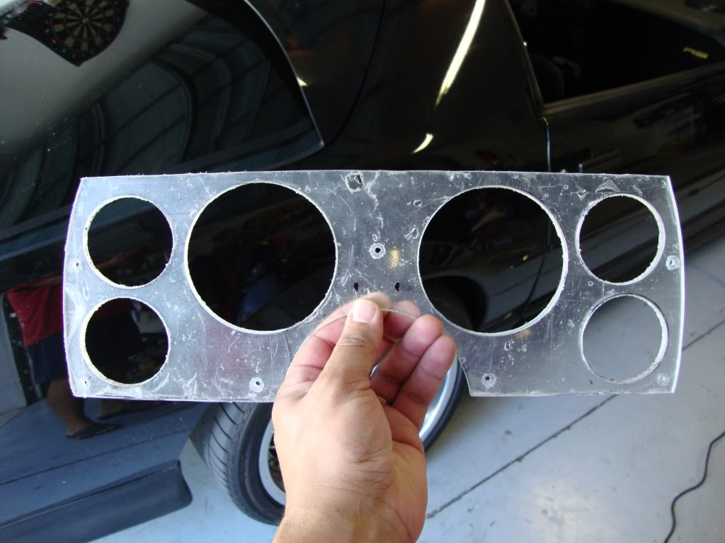

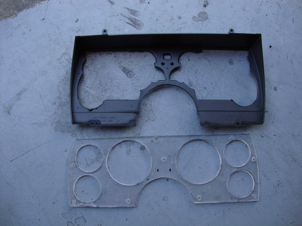

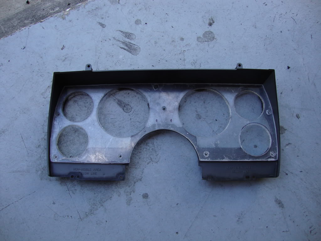

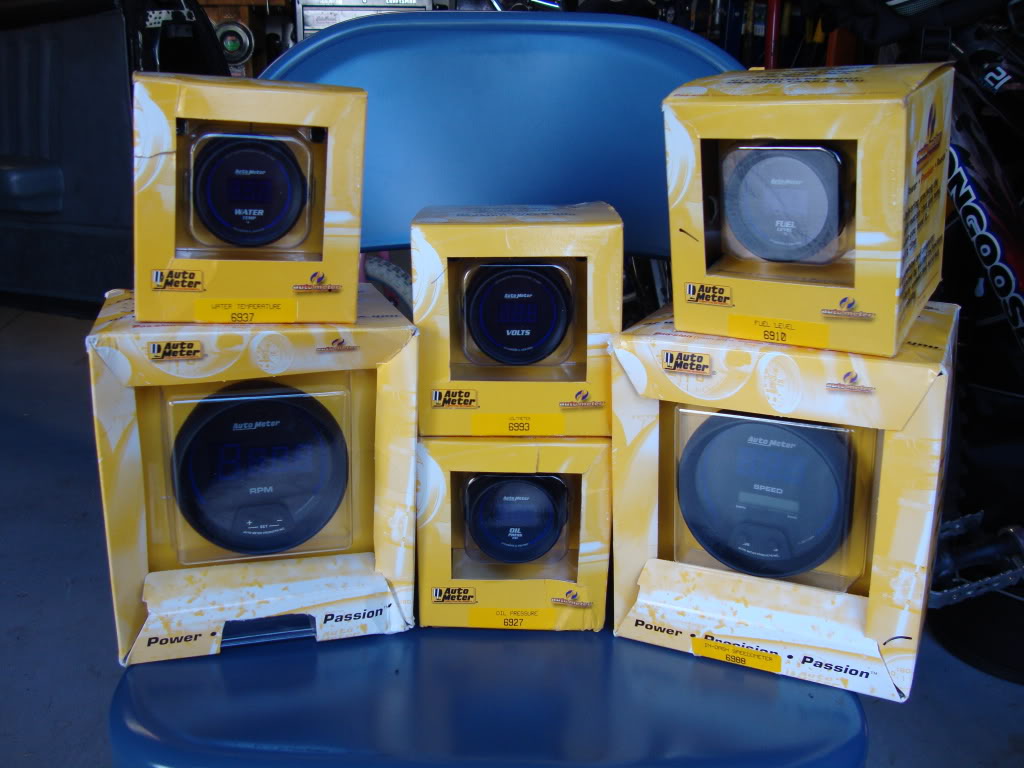

Ok yall some of us has done this mod already so I thought I would share my version. The panel I'm using is made of plexiglas and I used an adjustable hole cutter to make the holes for the gauges. The gauges I will be using are Autometer's Cobalt Digital gauge line. Fuel, Volts, Oil, Water Temp, Tach and Speedo. Tach and Speedo are 3 3/8" and all the others are 2 1/16". So far so good. I'll keep posting pics on the progress.
